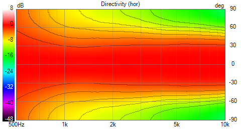

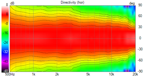

Regarding comparing infinite baffle vs in box differences,
Here is the infinite baffle sim
Here is the waveguide in finite baffle sim

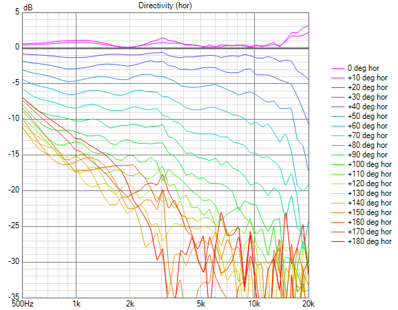

It seems like the 3kHz narrowing occurs due to the box..
I had also tried with a smaller waveguide, less deep waveguide and 25mm rounding at edges. Here is the result for that

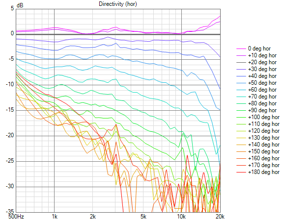

A simple way to look for where directivity features or issues are coming from is by looking at the off axis line curves rather than the polar heatmaps.
You should be able to see at what angle the frequency response is affected, and work out which part of the cabinet is causing the change. I also would not put too much effort in trying to fine the DI where 0.5 dB differences are seen, particularly with 3D meshes. The liklihood that all those tiny features make it through in real life to make the exact same curve is miniscule.
Also a 90 degree pattern waveguide will match up quite well with a big woofer at some range of frequencies lower down. To match a cardioid radiation the wall angle needs to be wider otherwise the difference in directivity between high and low frequencies will be large. Width, depth and wall angle are interelated, you can only pick two then the other is already set for you.

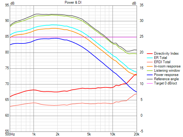

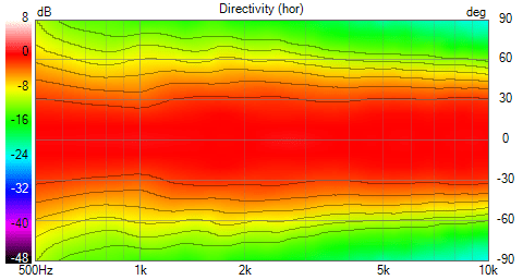

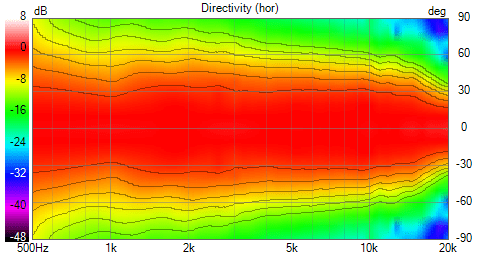

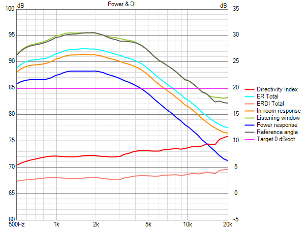

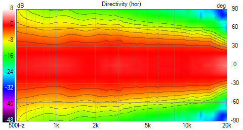

I simulated a rounded cabinet of the same depth (310mm) as in the earlier case integrated with the waveguide..
It is hard to observe any differences between the results in the two cases.
Here are the results..
In all below results, the flattening of axial response has been done w.r.t 20 degrees off axis..
Device width x height = 376.00 x 324.00 mm (14.803 x 12.756")
Device length = 120.00 mm (4.724")
Regular cabinet with 25mm rounding and 310mm depth
Curved cabinet with 25mm rounding and 310mm depth
Side-by-side comparison between regular cabinet and curved cabinet (if at all it appears side by side in the browsers others are using.. 😀 )
Regular cabinet (left) Curved cabinet (right)

Yeah, it is a matter of the depth/width ratio, baffle-edge rounding and frequency. How I understand it it is all about how to reduce diffraction and back wave cancellation. The best results where received with a complex trapzoidal T-shape enclosure, if I remember correctly. But I don't know who did it.
  • Thank You
Reactions: vineethkumar01
Yeah the backside effects are mostly beyond 90deg off-axis. Sound would need to diffract all around the box to show up in the front, or any diffraction backwave from back corner so these are second or third order effects with greatly reduced amplitude, thus minimal effect in toward listening window. Sound expands outwards so the immediate surroundings of any transducer has most effect.
Also, the box seems to be wider than deep so there isn't that much to diffract from the back edge as sound that got there has relatively long wavelength. if you made the box narrow and deep you'd see more ripple below 90deg angles as well.

Yeah ~1db response wiggle is quite good already. There seems to be 0-axis hump around 1kHz, dip about 2kHz, another hump about 3kHz, so there is secondary sound source with roughly 17cm extra path length and opposite polarity, so it's the mouth that diffracts and sends the secondary soudn that makes the ripple by interfereing with direct sound.
The extra "slap-on" roundovers are not effective because curvature of the waveguide changes rapidly there, and diffracts. The roundover needs to be the same continuous curve as the main waveguide to avoid this.
edit. here simple example for continuous curve closed back very low diffraction waveguide https://www.diyaudio.com/community/...-design-the-easy-way-ath4.338806/post-7231463
I think there are some renders somewhere there for a hint what such thing looks like but the backside can be customized some without much problems in listening window. By backside I mean anything beyond the waveguide curve has made full 180deg freferenced to on-axis. As comparison the infinite baffle script and sim ends the curve at 90deg, so you need to continue to make a rollback to improve the mouth diffraction performance.
Basically, simulate a freestanding waveguide in ATH with t=1 setting, and then just enclose it as you wish, or even better try to imitate curve you get with t>1 to make it continuous much further. But as said you already have quite good performance.

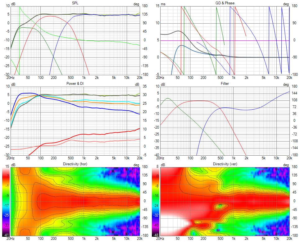

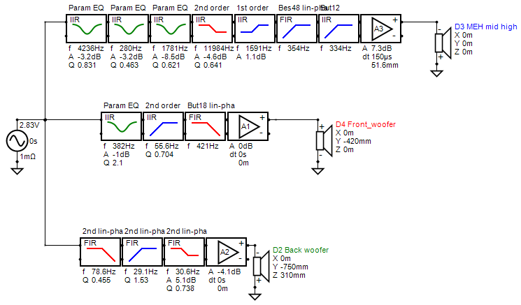

I was curious about how it will all fit together to form a system.. Well at least in simulation land..😀
Here is a quick stitching of the MEH-waveguide described above without the curved cabinet and the dual 15inch woofer system with a sample crossover system implemented..
I have assumed that there will be one more cross between the mids on the MEH and the CD in it and it is not shown..
Another assumption is that the mids (closed back configuration) on the MEH waveguide will acquire whatever directivity the waveguide gives at lower frequencies
Directivity/horizontal polar pattern looks nice on paper/screen I think... 😀
