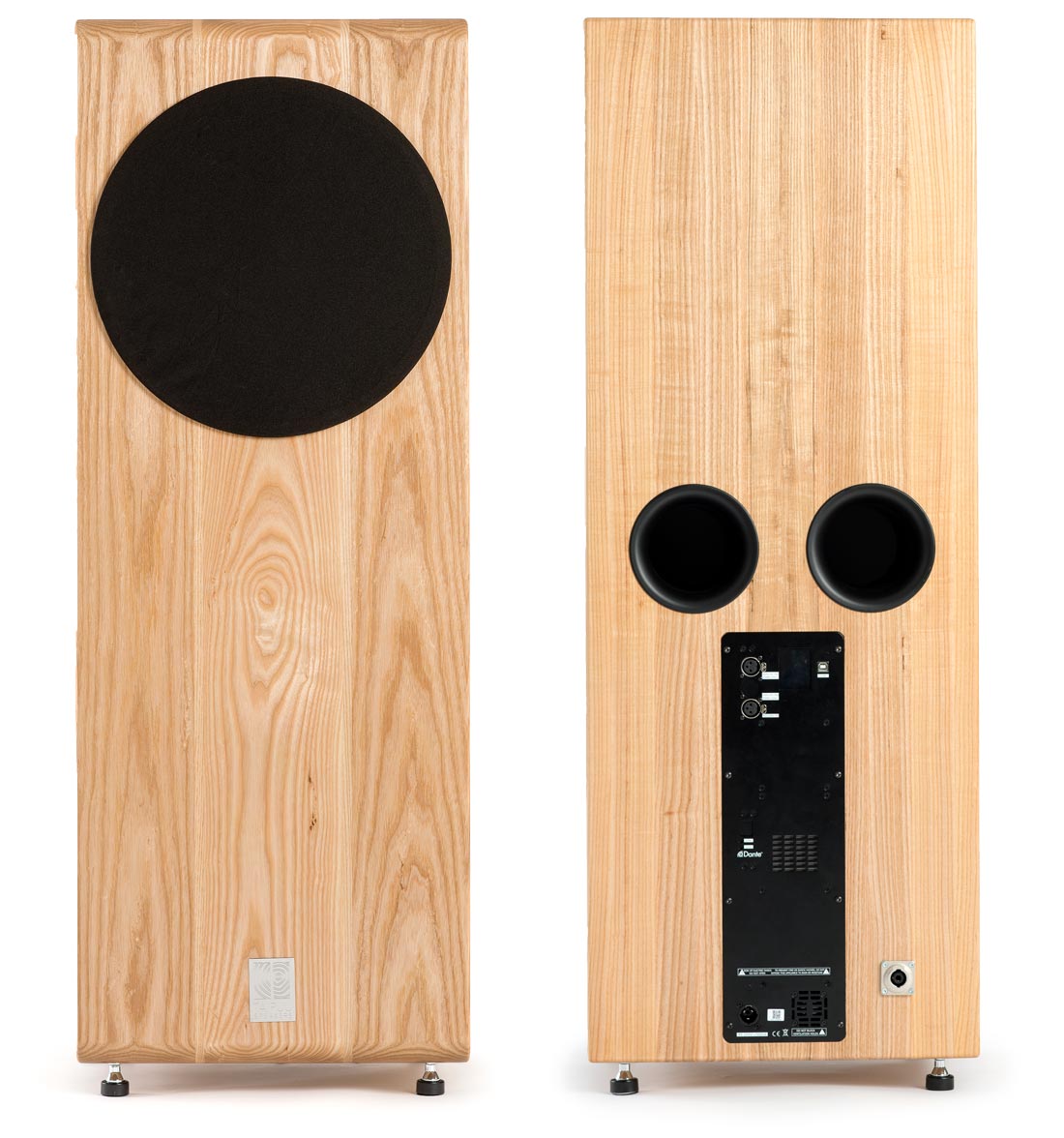

Crossover is 2950Hz. So if the drivers are 6 inches (big IF, because I can't tell from the photo) c-t-c it is a 1.3 multiplier.

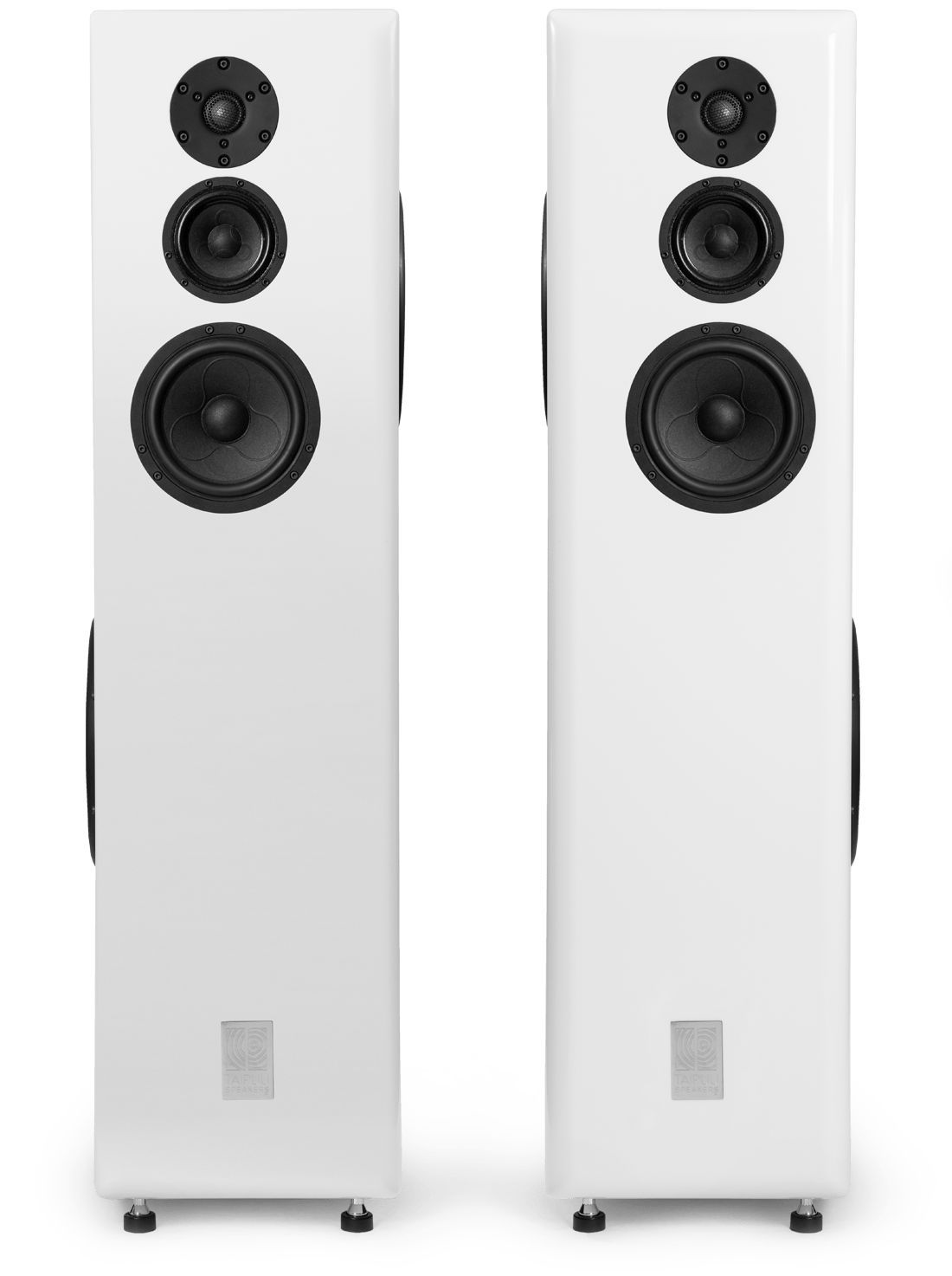

Technical information:
Operating principle: 2.5-way, passive radiators
Elements: Purifi Audio 6.5" bass-midrange 2pcs, Purifi Audio 6.5" passive radiator 4pcs and SB Acoustics 29mm Babyllium cap
Dimensions (W x H x D): 210 x 1000 x 300mm
Volume: 28 liters net
Case material: MDF
Playback range: 33 - 24000 Hz, -6dB
Split frequencies: 310Hz (lower bass-mid tone) and 2950 Hz
Amplifier power: 245+245+245 W, treble protection level 100/140 W RMS/peak
Connections: Analog XLR, AES/EBU XLR, USB type B (equalization)
Power connector: IEC C14
Cooling: Passive (no fan)
Cognitive correction: with the FourAudio System application, Windows or macOS
Made in Finland
https://audiokauppa.fi/products/taipuu-kero-l-active-pro-lattiakaiutinpari

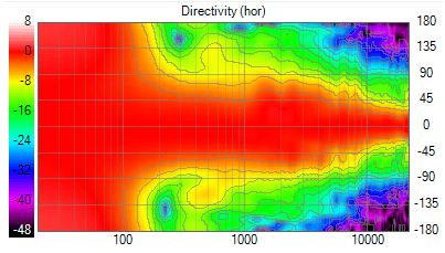

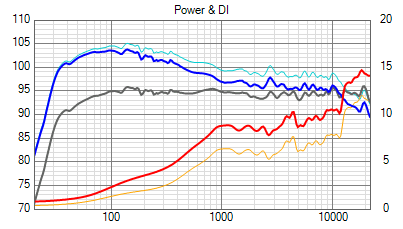

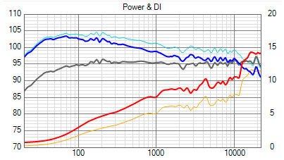

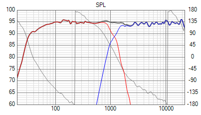

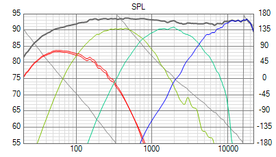

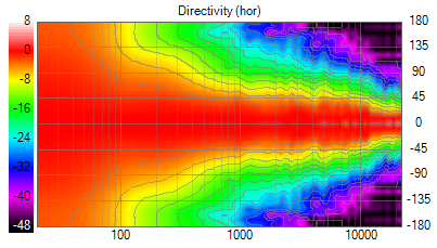

Kimmosto's Taipuu 2.5 Purifi design is 180 degree polar pattern. Similar to his other conventional tweeter Taipuu 4-way design he looks like he focused on achieving smooth down-sloping total ER and power response but with different deflection points. https://taipuuspeakers.fi/en/taipuu-speakers-dsp-active-speakers/
4-tie_v2.pngTaipuu_4-way_PowerDI-1.pngTaipuu_4-way_Directivity-1.pngTaipuu_4-way_SPL-1.png
He also has a Taipuu 90 degree two-way polar pattern design with a compression driver waveguide (coaxial woofer cone).
taipuu_21_24_1100px.jpgTaipuu_2-way_PowerDI.pngTaipuu_2-way_Directivity.pngTaipuu_2-way_SPL.png
And a Taipuu 90 degree three-way with a compression driver waveguide (coaxial woofer cone)
taipuu_3tie-2018_1100px.jpgTaipuu_3-way_PowerDI.pngTaipuu_3-way_Directivity (1).pngTaipuu_3-way_SPL.png

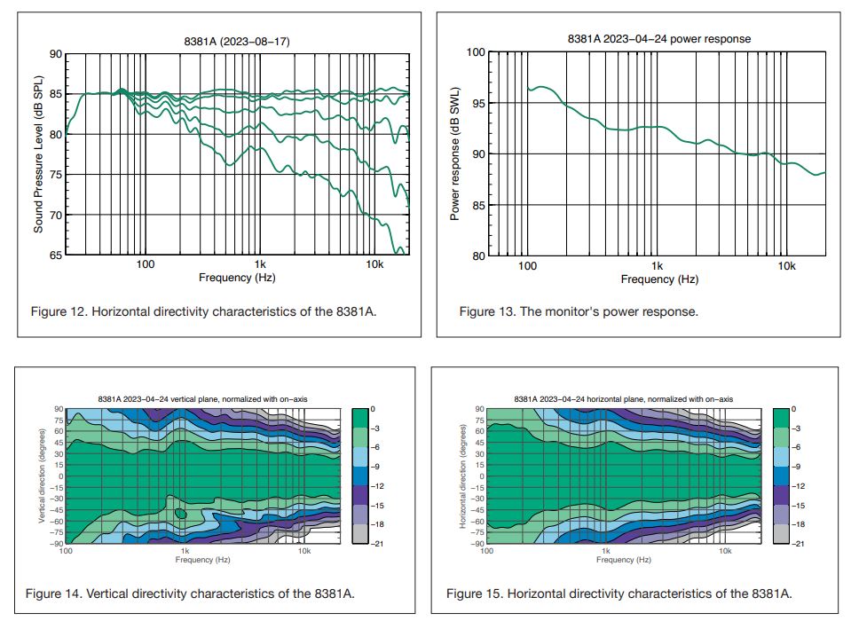

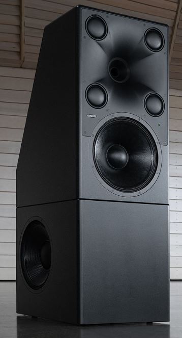

In addition, here's the Genelec 8381A.
A set of top rate no holds barred examples from Finland to analyze.
