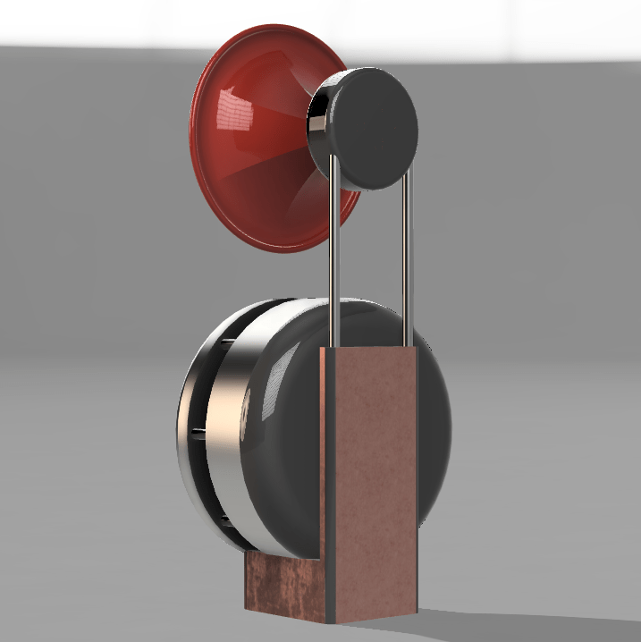

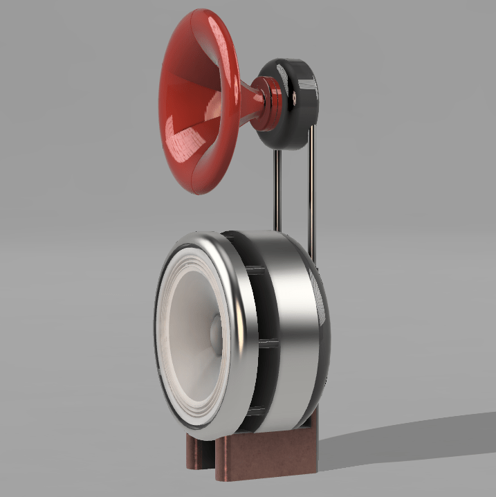

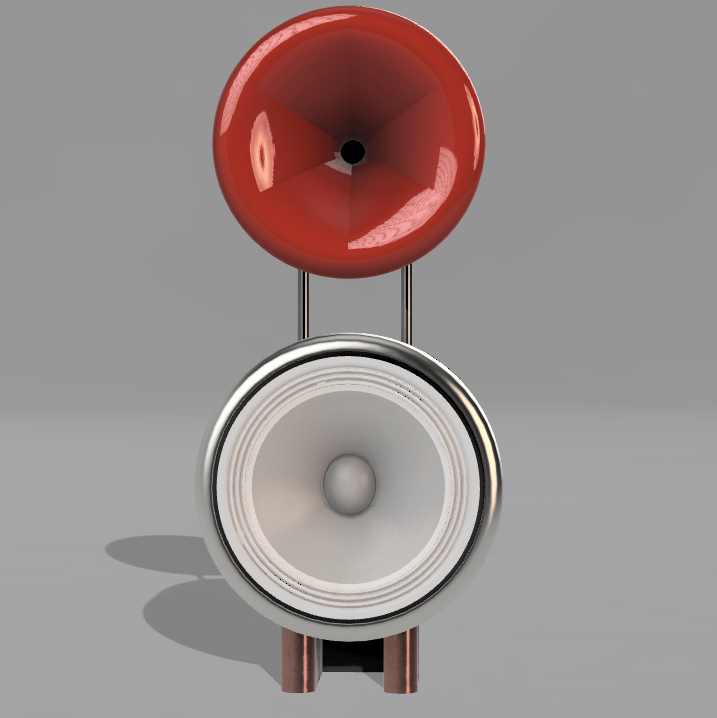

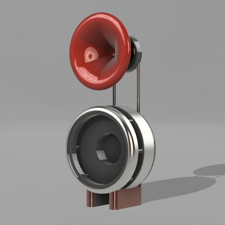

Design iteration v2 for the big cardioid box (for 15PR400) + EXAR 400 waveguide 😀
The box is only about 26cm deep from the 'baffle surface'
I like the looks of this 😀
Alright, here is one secret as you probably discover it soon 😀 you could mount the woofer from the magnet. This would reduce resonances in the system, and likely simplify the construct/manufacturing, depending how complicated you want and need the magnet mount. If you want, you could leave the driver naked to simplify even further, or attach a rim/roundover to the driver rim, like you have now. The spokes on the "hole" to attach the rim to hte back "enclosure" are not needed anymore, except perhaps holding the damping material in place.
Before doing so check for basket resonances, just hold the driver magnet and knock the basket. Some drivers sound like bells!you could leave the driver naked

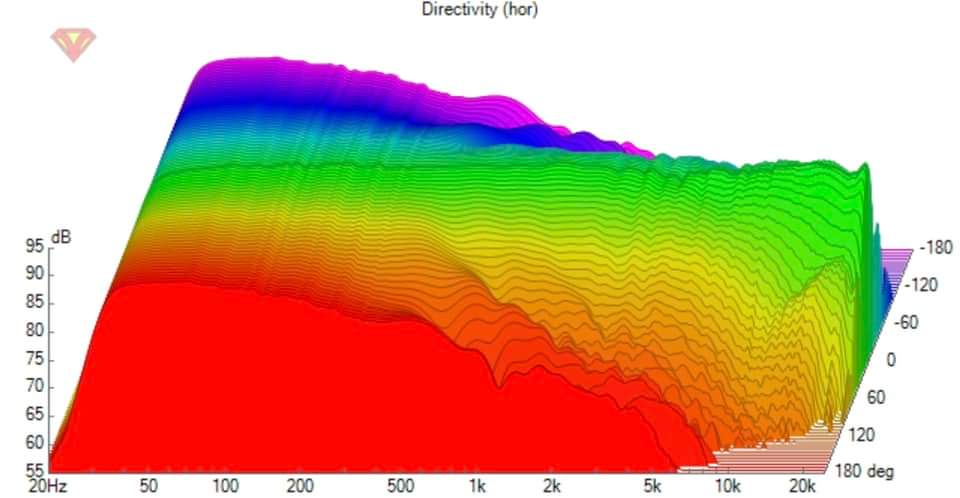

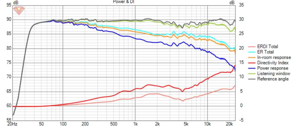

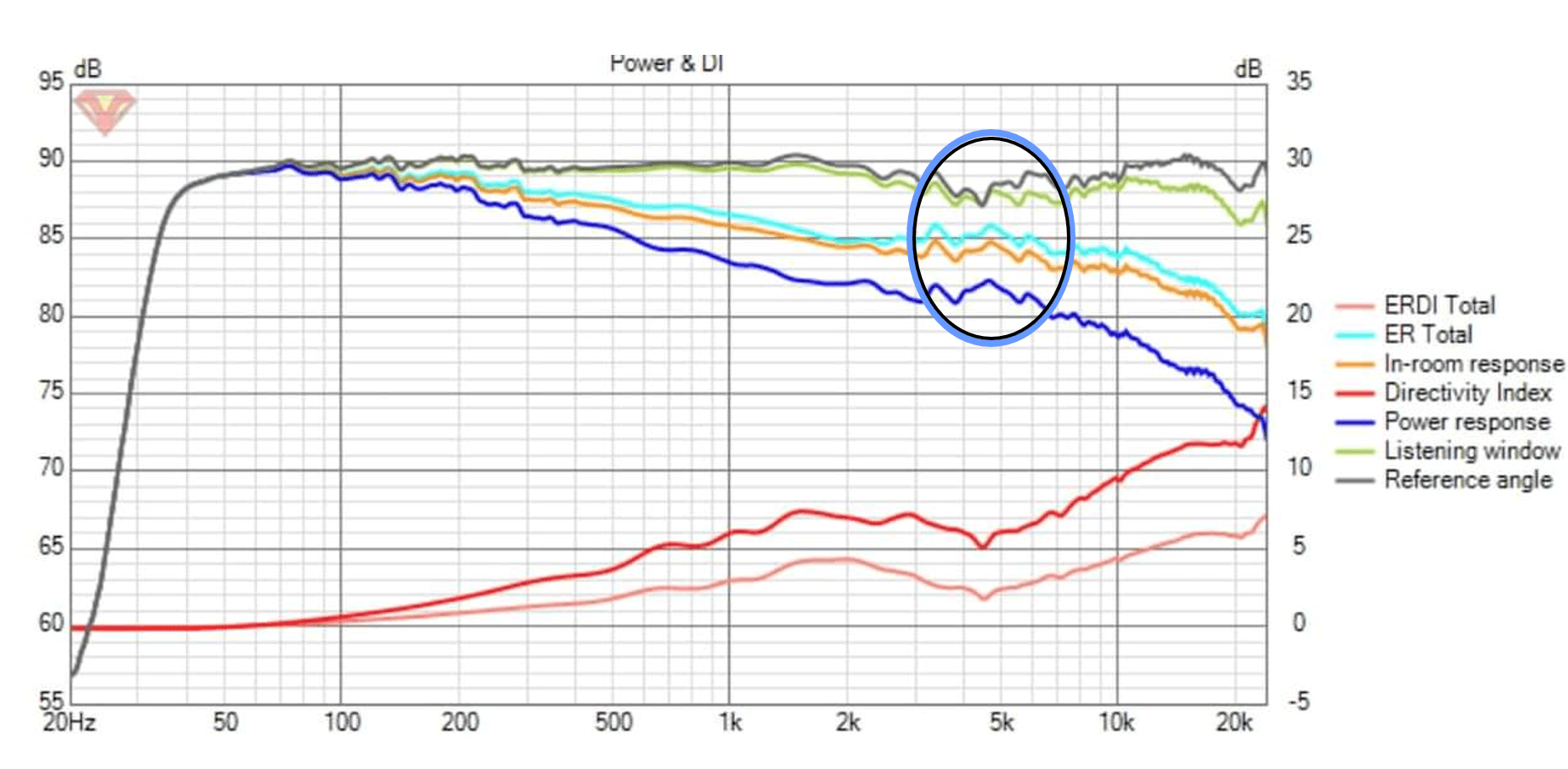

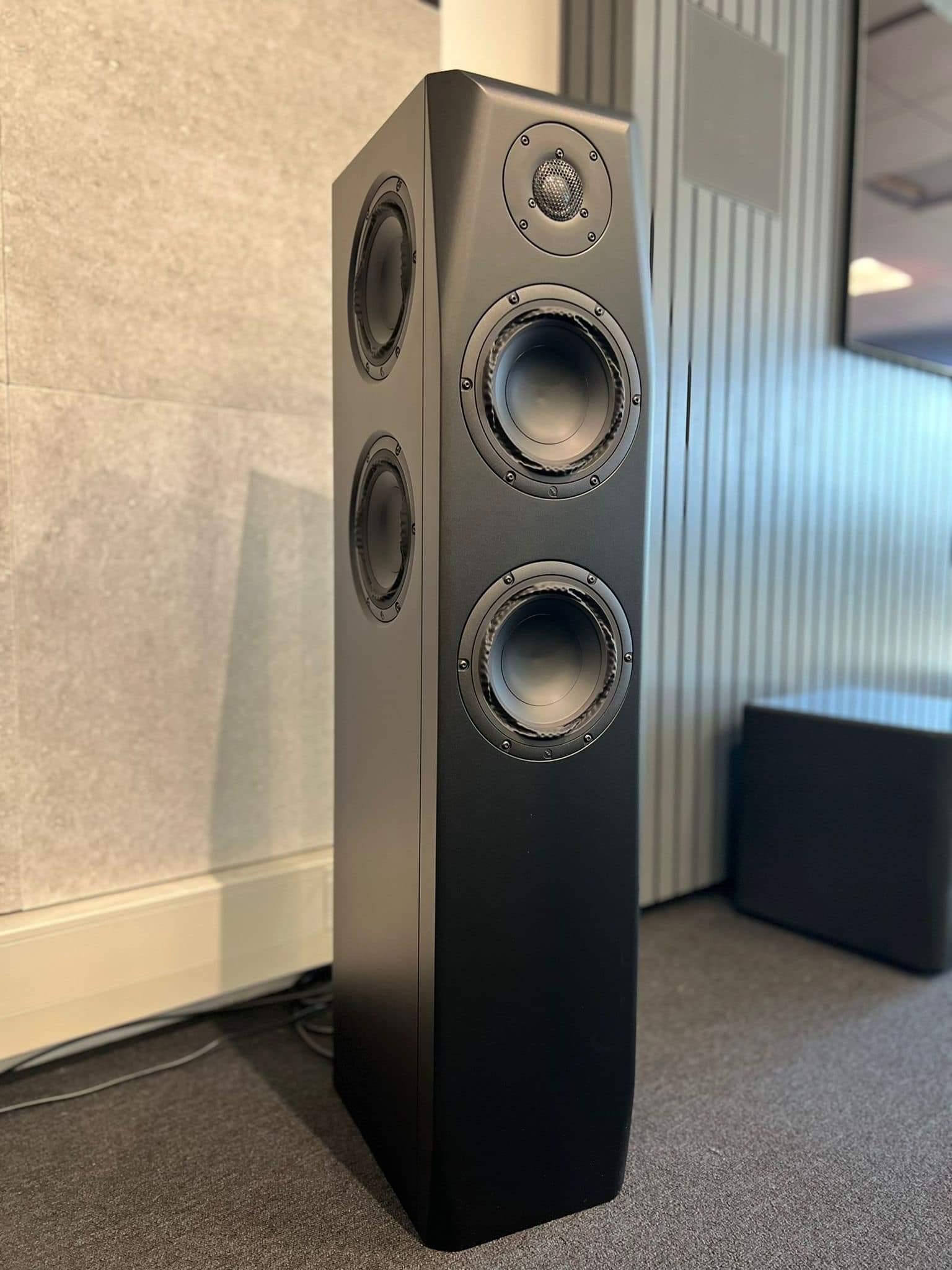

This post has nothing to do with my speaker build(s).
But I am posting the details from one of Kimmosto's designs (that I got from the internet) for reference, learning purposes and discussion.
The Speaker
and the curves
and Kimmosto's response to someone who commented that the directivity can be improved:
"Of course, but fortunately it's just indirect result of calculation, and significance is low compared to "direct" magnitude responses, different power averages, whole concept including level of directivity, quality of components, timing etc. Designer and many listeners happens to prefer conventional tweeters so visually perfectly linear DI response is not primary target with 6.5" mid-woofer."

My first impression is that it is very good. The prediking bit is what i do not understand. Is this because of limited bandwidth?
This feature is interesting to me, and it is something I have incorporated into some of my designs.
There is an on-axis dip of about -2 dB from 3k to 6k. This dip allows the power response to have a smoothly decreasing slope over the whole range. If the on-axis was flat, the power response would have a + 2 dB peak from 3k to 6k.
I have found that a rising power response in the region from 1k - 8k can make a speaker harder to place in a room... It becomes more finicky about placement.
I agree with his comment on directivity index. I have concluded that a smooth DI is important up to a point. Wild swings in the DI curve (5 dB or more) will usually have a negative impact on the sound quality. But small +/- 2 dB variations in the DI curve don't seem to matter very much compared to one which has been optimized to be very flat.

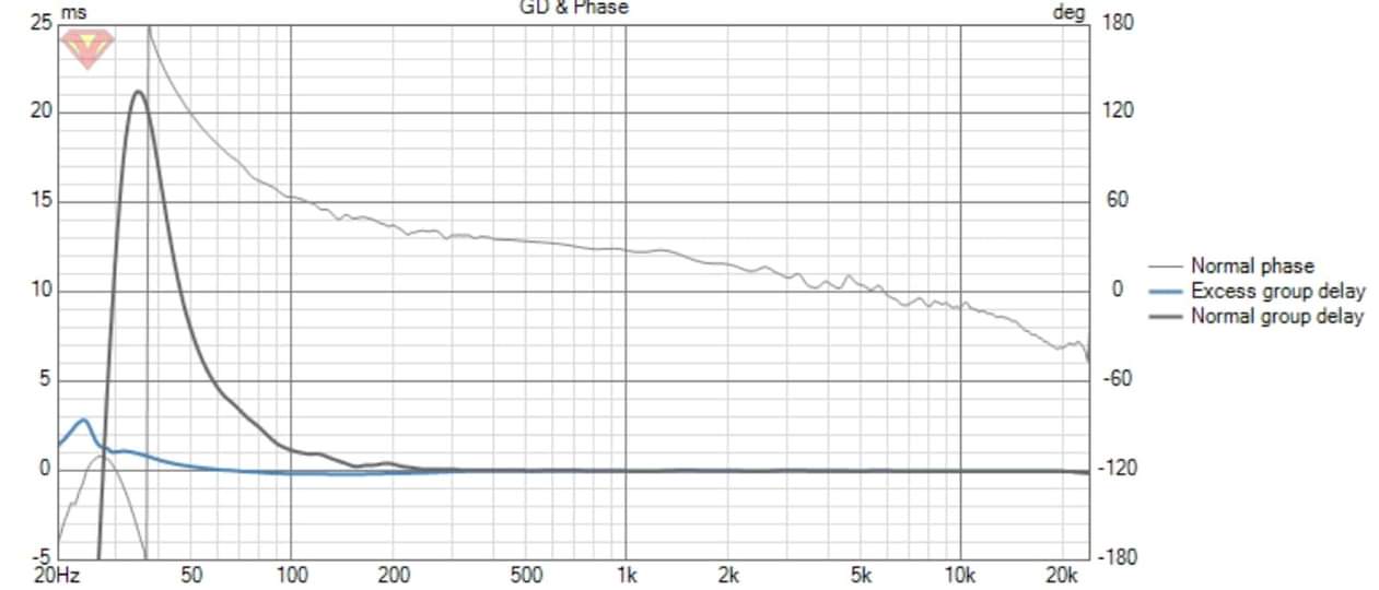

Very interesting speaker. He is able to maintain excess group delay to less than 0.5ms all the way down to 50 Hz, which is very impressive... not sure how he does that. But that is why he is Kimmosto, and I am merely me...
Step response and excess group delay look like there is linear phase filters, so you can do it as well with processor that has FIR filter capability!🙂Very interesting speaker. He is able to maintain excess group delay to less than 0.5ms all the way down to 50 Hz, which is very impressive... not sure how he does that. But that is why he is Kimmosto, and I am merely me...
Well that is comforting.... I thought this was a passive crossover design, and I was thinking "Good Lord, I have A LOT to learn..." 🙂
Yes i ment pre-ringing. Is this a passive system or active?@JanRSmit: If it is "pre-ringing", I am don't know about it too..
I only know that some of it can arise from the crossover transfer functions not being fully complementary.
