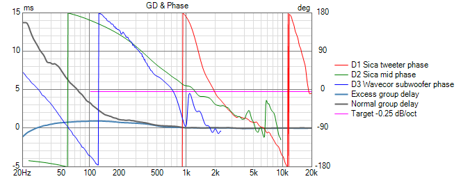

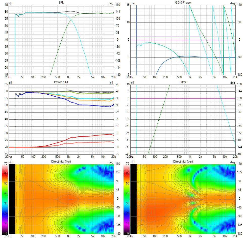

First thing that came to my mind was phase alignment mid/tweet. I personally try to get phase to align well, and over as broad range as possible at XO. I find it helps with 'depth' perception in the sound. The mid phase is a bit hard to follow in the graphs, adjusting the delay in the generator could make it easier.
A cap and resistor over the mid coil could be tuned to suck out the resonance at 5k too.

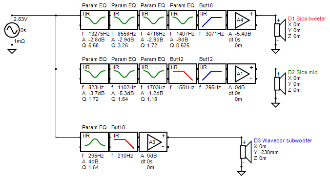

Today is linear phase crossover testing day 🙂
Crossover under test

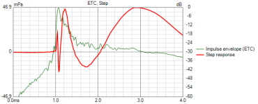

4ms gated

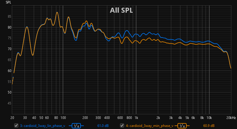

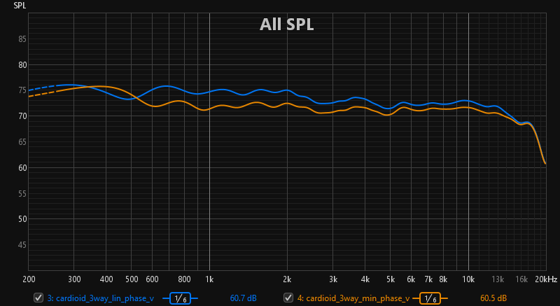

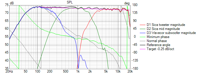

Today, I tried to hear different tracks and understand if I can pick out differences between linear phase & min phase crossover
Min phase crossover
Linear phase crossover

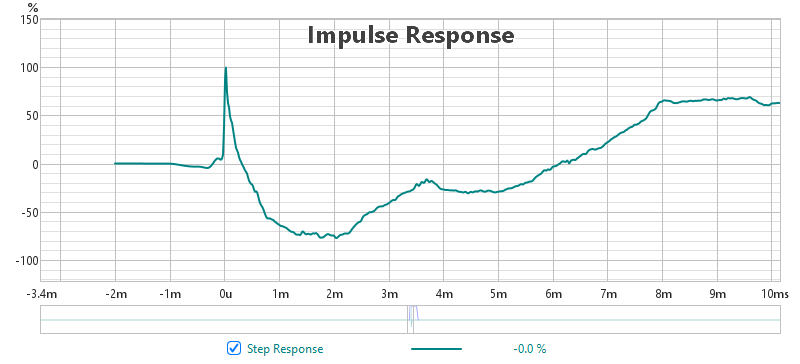

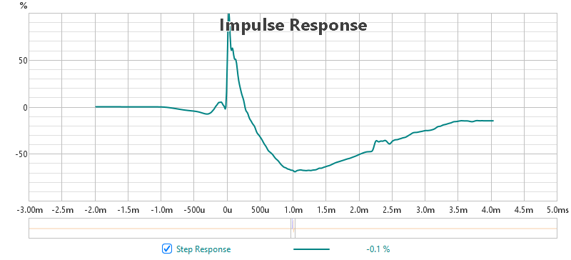

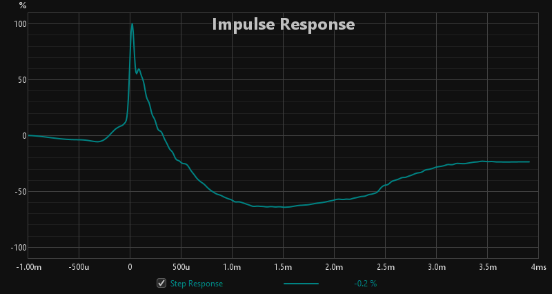

Impulse response comparison between the two crossovers
Min phase crossover
Now the measurements of the two crossovers from about 1m away (20 degrees off axis).
This is also the same distance at which I sat in front of the speaker for listening.
same measuremrent as above but 3.9ms gated

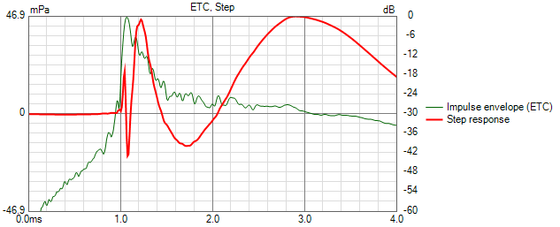

Impulse response: Min phase crossover
Impulse response: Linear phase crossover
This was all easy to do..
Now comes the hard part where I tried to listen and find differences 😀 where I tried switching between min phase and linear phase crossover multiple times while a song was playing (Please note that this was a test where the responses themselves had a little level difference above 500Hz. So this is not an apples to apples comparison either).
I could find out the effect of level differences in songs with female vocals. Try as I may, I couldn't find out anything which I could attribute specifically to the impulse response differences 😀
Then I think I heard something with tracks having just kickdrums. With the linear phase crossover, the sound of the kickdrum was a little tighter (don't know if this is the right word to use). But with minimum phase crossover, I could hear a little bit of extra boom at the end of every drum beat. I repeated that in a loop. This particular difference, I could make out again and again.. It was sort of once I heard that extra boom, I couldn't unhear it. But in tracks with many other instruments and vocals, I couldn't make this out as clearly as earlier..
Now I don't know, if this is how it is supposed to be in terms of the difference between the impulse responses. But in regular listening, it is very very hard to pick out one over the other for me.. 😀
But I still keep the linear phase crossover just because I heard that extra boom, thinking that it is "better" 😀

Your room will add enough on top to hide many of the differences. I expect that the FR differences will be larger (easier to hear) in your case.
Personally, I like linear phase. I went out of my way to get it to behave like that at the listening seat. I compared apples to apples, the phase being the only difference and having the exact same FR response in both cases while doing listening tests. Audibly (and subjectively) it's more attention grabbing than not correcting for this i.m.h.o. It's my personal preference, up to anyone to make up their own mind. I went with a minimum phase behavior of the entire speaker bandwidth, meaning the crossovers were linear phase, but the roll off on each side of the frequency spectrum was untouched.
I had a similar impression listening to linear phase Linkwitz-Riley.
CORIGLIANO, J.: Conjurer / Vocalise, track #6 Skin. They beat big drums throughout the track, I guess that's why they called it Skin. To my ear, the flop of the big diaphragms on the initial strike was clearer. I wondered if that was what people mean when they talk about "tight bass" because I have no idea what they mean by that phrase. In addition, linear phase also performed better with spoken voice movie dialogue.
However, the clarity is far more noticeable with linear phase LR-48 compared to linear phase LR24. I don't know what to make of that because the charts aren't much different to my eye. I'm disappointed linear phase seems to sound better because I wanted passive crossovers. I keep rooting for regular LR24s to perform as well as the linear phase LR48s but they don't.

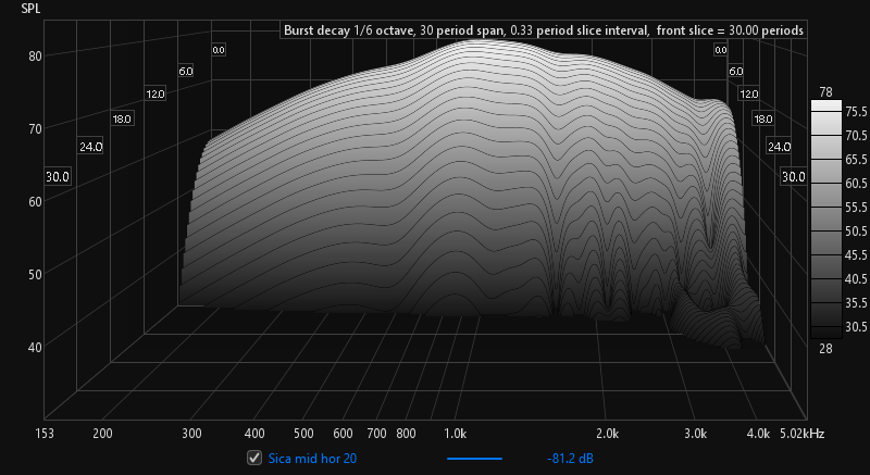

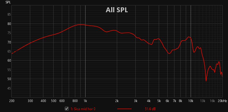

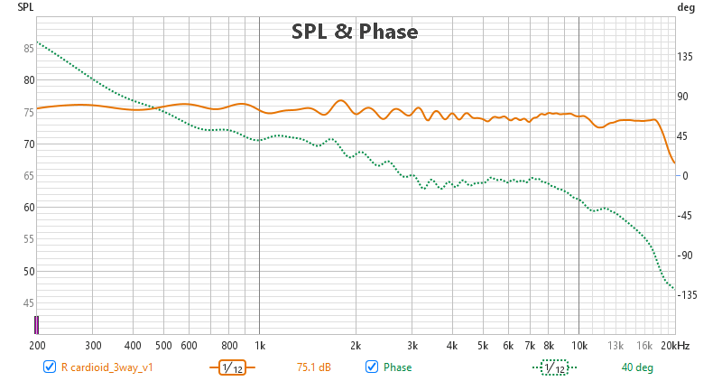

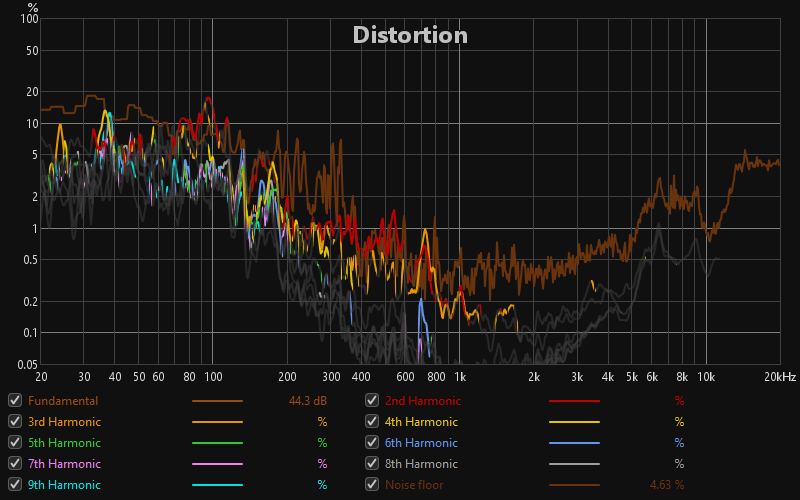

@JanRSmit: Here are plots of the unfiltered mid driver (taken for crossover work)- On axis response
Noise floor on the distortion measurement was high though & my audio interface connected to the mic had its own distortion issues. I also don't know if my mic is able to capture distortion correctly
Burst decay with a 55 dB dynamic range on y-axis

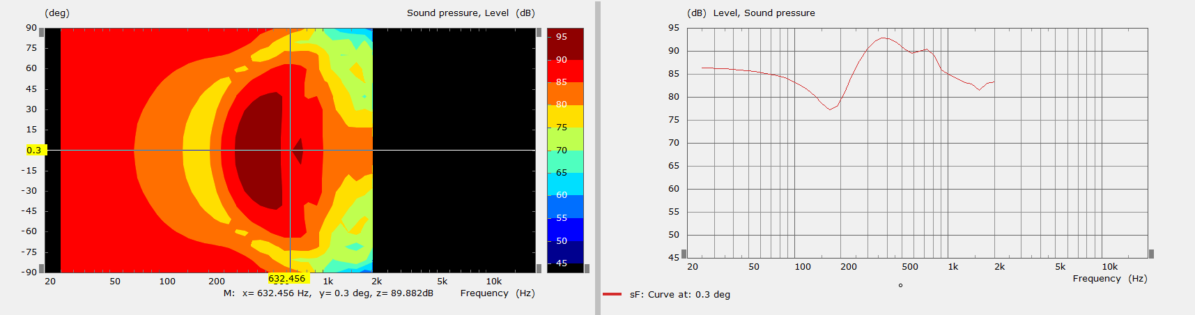

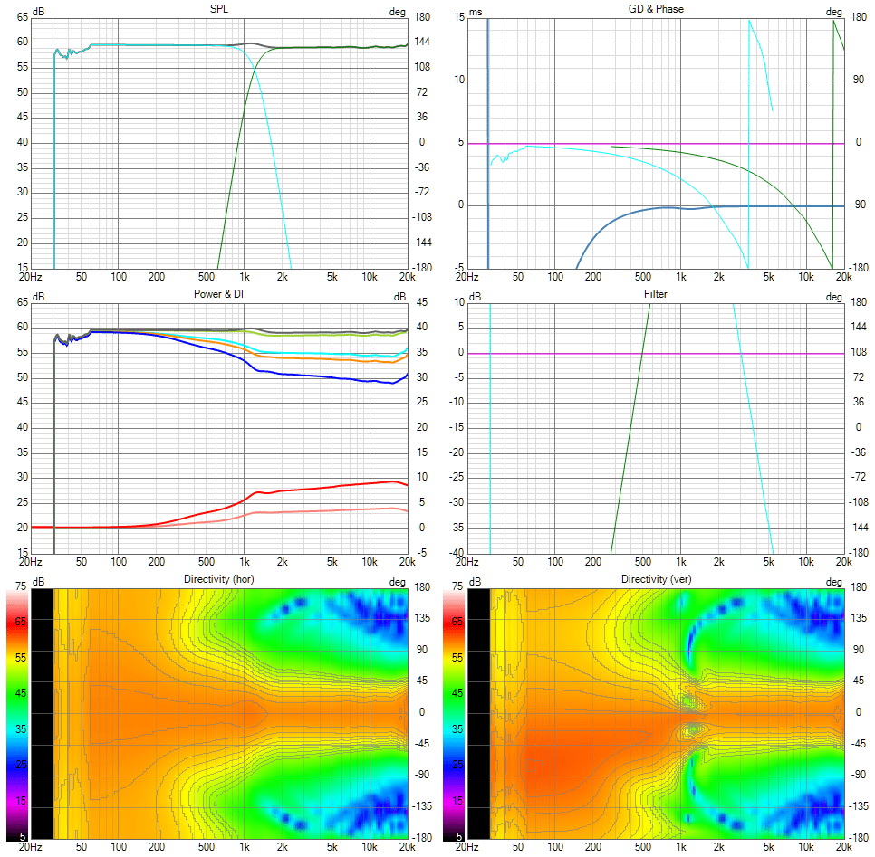

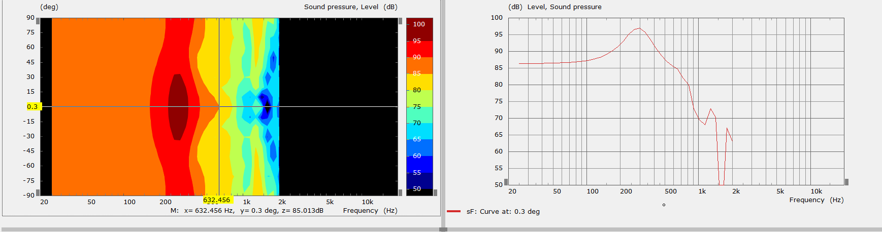

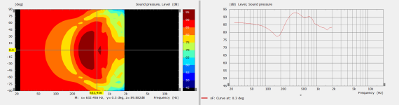

You could try simulate all of it with ABEC. Here is my 60x40x30cm bass box 10cm from wall, and there is peak right about at crossover (which is about at 200Hz in my system) but this is no problem for me as I've got DSP and the peak is rather uniform to all directions. And, it's much better than the same box, woofer towards listener butt against the wall. Gotta remember though that this is only one wall of six in a cubicle room and there is furniture near by, and so on.
Additional issues with it:
hard to measure at home and verify the performance, be it better or worse than something else. Making ideal anechoic response in simulator based on measurement of the boxes only doesn't exactly apply as the wall is now part of the "speaker" so it's bit of uncovered territory.
Additional bonuses:
don't have to recess the woofer or mind about it's looks as it's hidden. Acoustic low pass filter means less "noise", which ought to mean cleaner sound as also distortion is low passed, if it was audible in the first place.

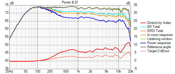

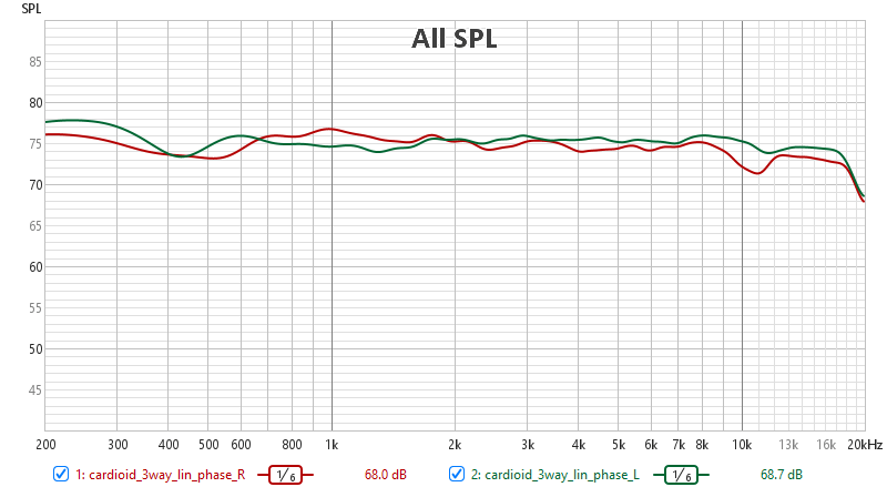

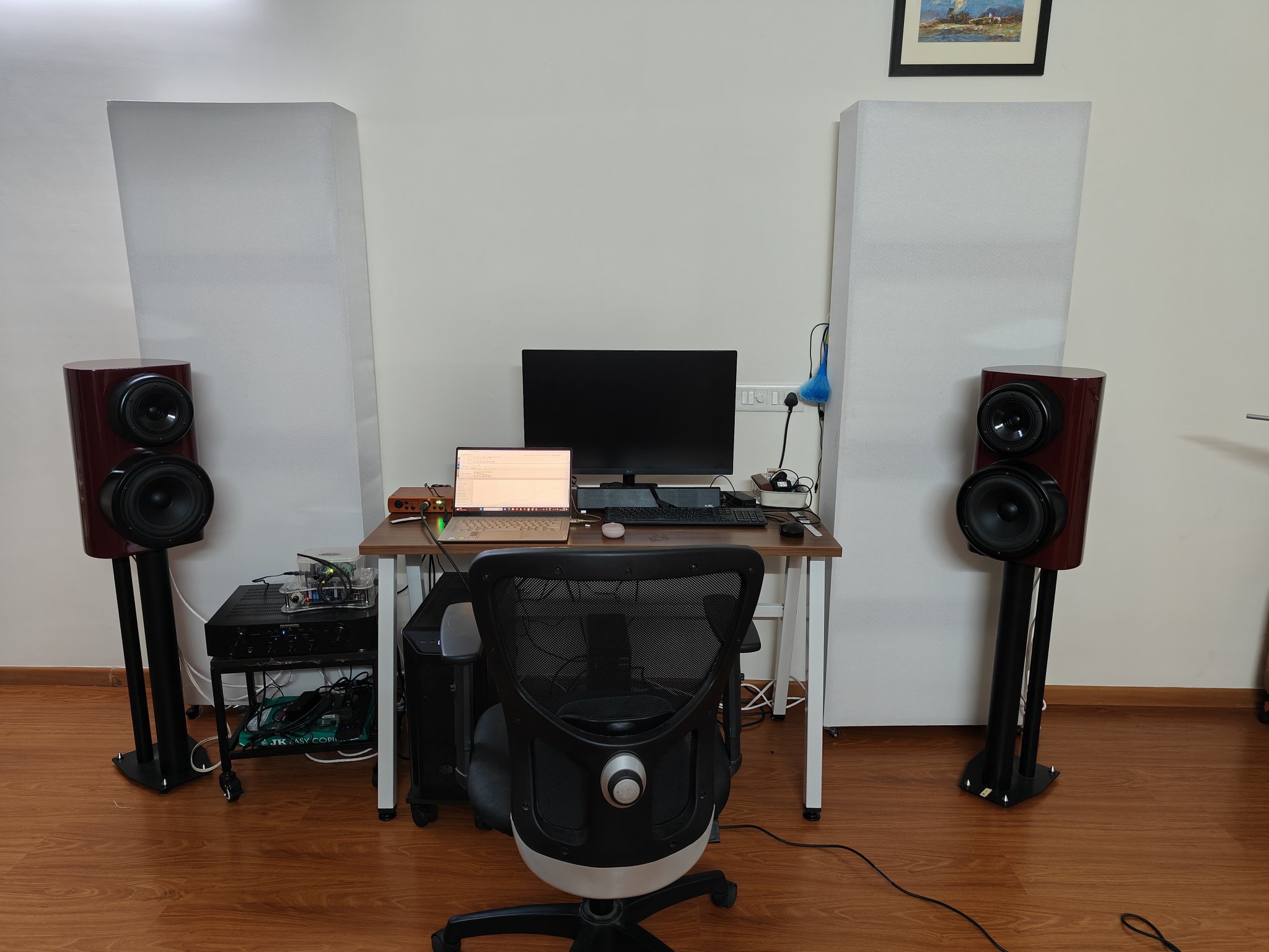

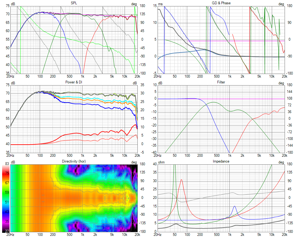

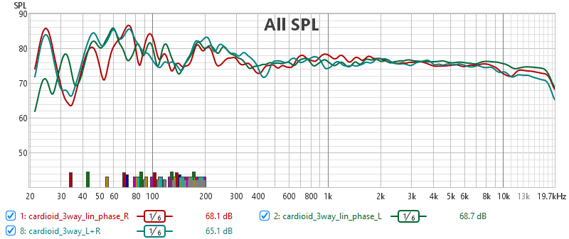

Work on both the speakers is complete now.. 😀
Here they are (for now) 🙂
4.2ms gated measurements of the L & R speakers (each taken at 20 degrees off axis)

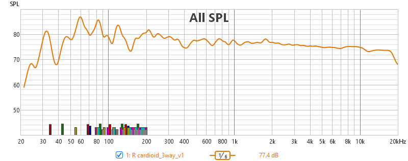

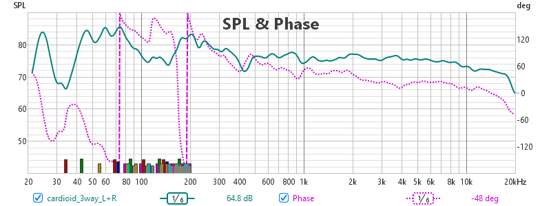

Measurements of L speaker, R speaker & L+R speakers from listening position (on that chair)

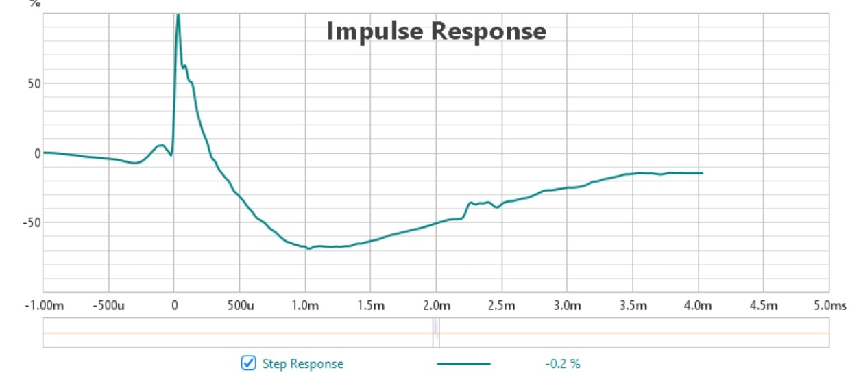

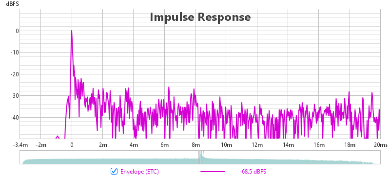

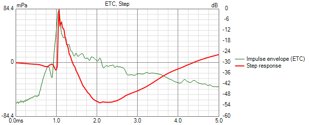

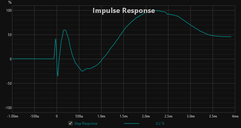

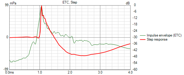

Step response at listening position for L+R speakers 🙂
Frequency magnitude & phase response at MLP
ETC at MLP
On the chair, imaging is superb... It feels like sound is coming from behind the monitor in front of me 😀
Time to seriously listen to some music now.. 😀

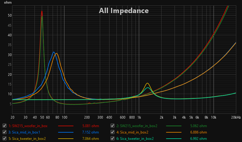

Some more data and impedance curves for both speakers
I have been noticing the transition between 'direct sound' & 'room sound' (as @tmuikku had been calling it earlier) as I move back away from these speakers.
It is pretty easy to spot the change in sound character.
On the other hand, it was more difficult for me to identify such a transition with my bigger speakers.
I wonder if this has something to do with speaker directivity interacting with the room, especially for speakers with directivity control extended lower down in frequency.
From my limited experience so far, I don't think I will return to lower directivity (below 1kHz) speakers. There are clear and hearable differences in the sound near the speakers as well as further away from them especially in the vocal region. I wonder how much of it is due to the effect of the coaxial drivers and how much of it is due to the closeness of MLP to the speakers also. But one thing I am certain is they sound very different from earlier bookshelf speakers I used to have (which probably had very different frequency responses too).
The overall tonality of the speakers is very similar to my in-ear truthear crinnacle zero IEMs except a tiny bit of elevated treble in the speakers. As of now, I am happy with the speakers' sound as is. But as a next step, I will try to level the response a bit more, dial in a little bit of Room EQ and see if it makes the sound any better 😀
