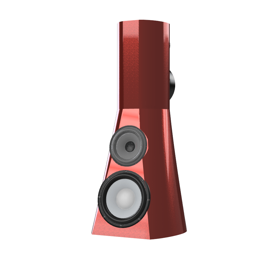

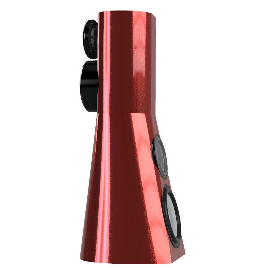

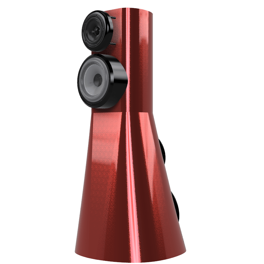

A 3 way design study
They’re practically headphones! And I thought I had my speakers wide. I imagine this is very correct though, as I often see cancellations when I get the chance to sweep my systems. It’s super fun seeing your projects come together. It sounds great through my earbuds, and I wonder if not being able to see them adds to the illusion. They‘re almost too fabulous to hide. Your builder does fantastic work.

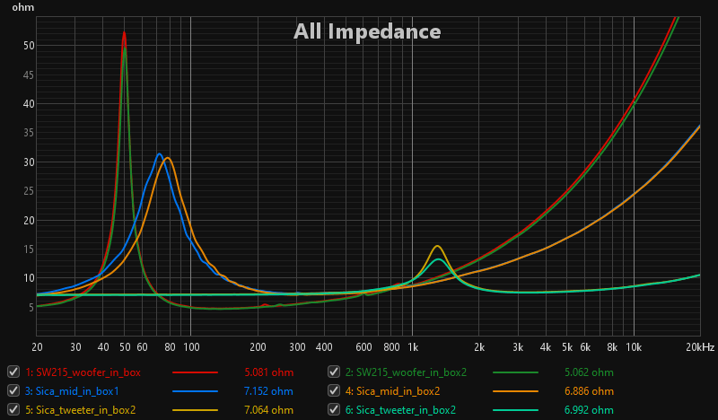

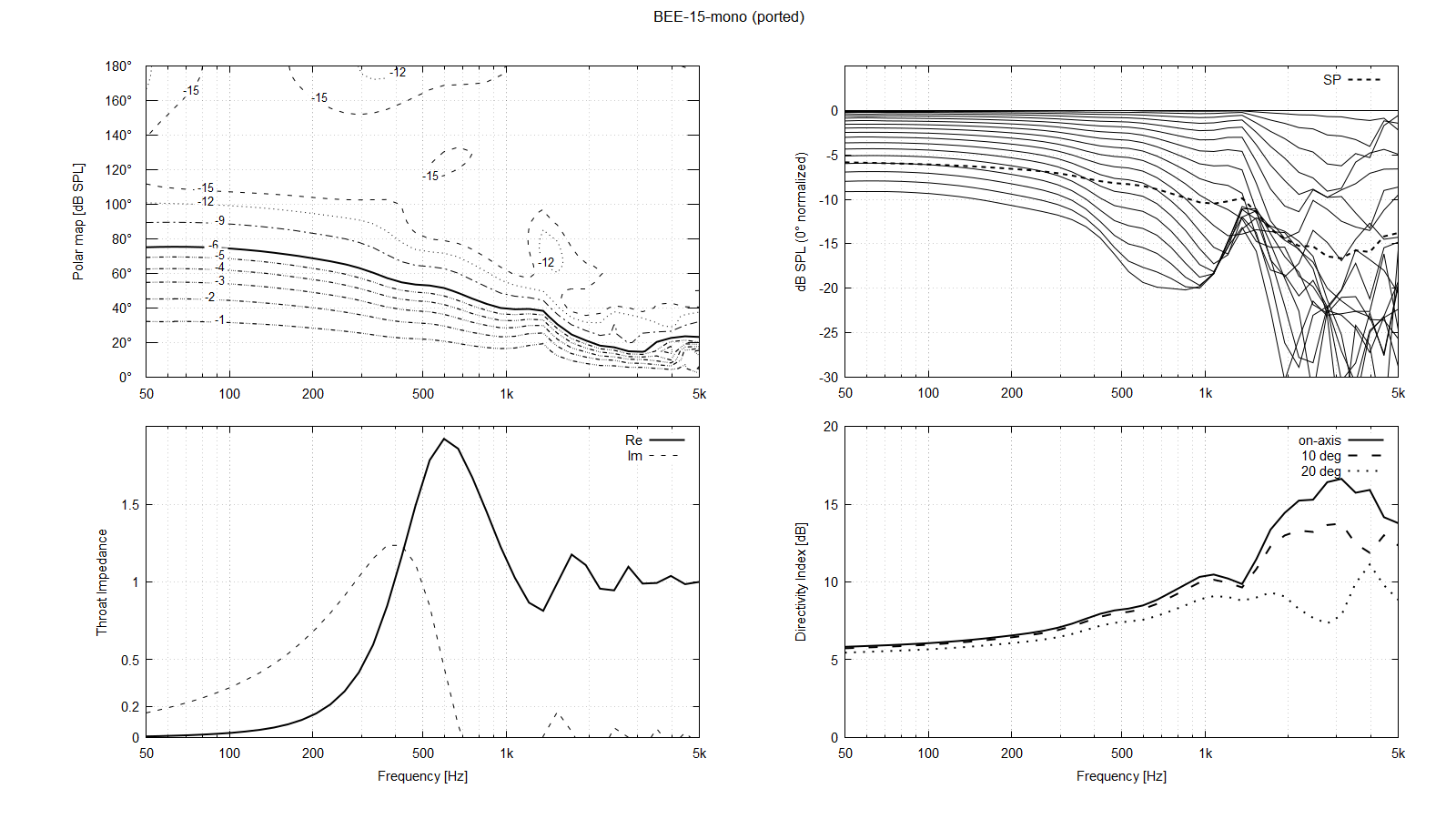

Some more data and impedance curves for both speakers
I have been noticing the transition between 'direct sound' & 'room sound' (as @tmuikku had been calling it earlier) as I move back away from these speakers.
It is pretty easy to spot the change in sound character.
On the other hand, it was more difficult for me to identify such a transition with my bigger speakers.
I wonder if this has something to do with speaker directivity interacting with the room, especially for speakers with directivity control extended lower down in frequency.
From my limited experience so far, I don't think I will return to lower directivity (below 1kHz) speakers. There are clear and hearable differences in the sound near the speakers as well as further away from them especially in the vocal region. I wonder how much of it is due to the effect of the coaxial drivers and how much of it is due to the closeness of MLP to the speakers also. But one thing I am certain is they sound very different from earlier bookshelf speakers I used to have (which probably had very different frequency responses too).

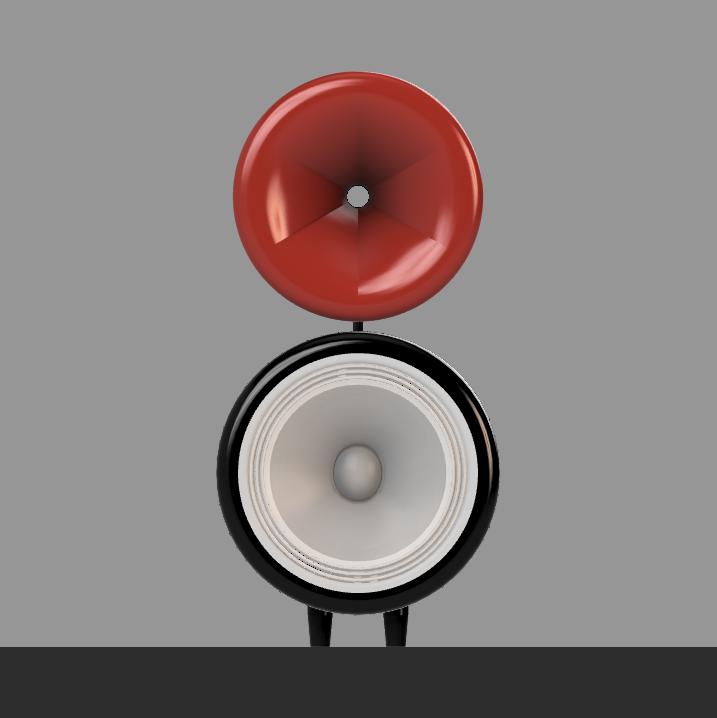

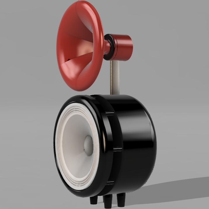

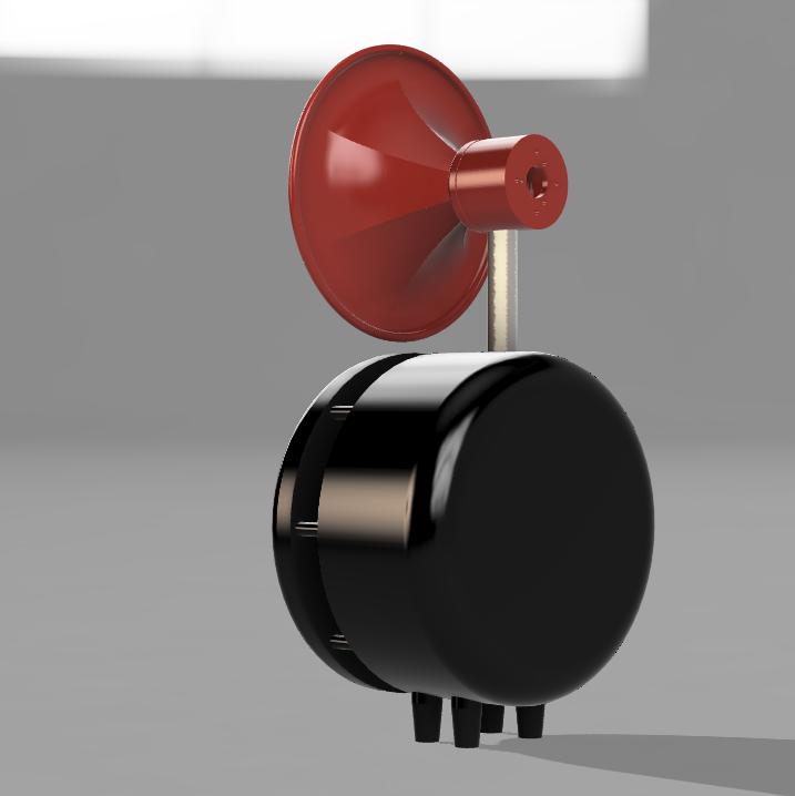

I am still listening and getting used to the speakers.. 🙂
But I just couldn't stop myself from doing this.. 😀
An 8-ish inch woofer at the back for potential active cardioid configuration of the upper bass to low mid & a 12ish inch omni radiating subwoofer for real lows 😀
Not that I am planning to build or anything.. 😛 but just exploring a potential concept 😉 😀
So I was taking stock of speaker things I have pending and saw the big old 15PR400 drivers occupying a lot of space in a cupboard 😀
I thought I could design a simple system (should also space saving) around that and thought about the following concept 🙂 (Please ignore those bad-looking feet for the woofer box.. 😀 )
The 15inch driver in a cardioid box like we have put the sica driver in and cross it to Mabat's petal shaped waveguide, cross it somewhere in the 600 to 800Hz range. For CDs I have the BMS 4550 inch or can adapt the SB audience 65CDN-T driver which I have in hand to make it a 1inch exit driver.
One can add a sub for below 100Hz too. I have 4 x Satori WO24Ps which can be used as makeshift subs from my main system
Please let me know your opinions about this concept.. 🙂
Starts to look what I've had few years now 😀 except bigger, I've got ST260 and 8" and then 15" monopole as third way.
This one, try it, you might need to play with the openings for the cardioid. Did you try this in ABEC as well?
I suspect why your 5" cardioid worked so well from the get go is that it's right dimensions. Here the chamber behind driver has much bigger volume, also the openings are much bigger, distances around the system differ, everything much bigger than with the 5". The bandwidth is different here, but still. Anyway, it ought to work as long as you just get it in tune.
ps. I've had some dreams about making a commercial product, hence not sharing too much about my whole system. Everything I have on my system is in my posts though. And my progress has been so slow, even though I've got few more tricks over this one you'll catch up soon 😀

I instantly think something like Verity Audio 🤓
https://verityaudio.com/product/lohengrin/
At the moment I'm considering the possibility of making a cardioid with a KEF coax. But wondering whether it can be done like on Blade or LS60, with the woofers on the side, close by.... like this:
https://www.diyaudio.com/community/threads/3-way-floorstanding-with-kef-coax-active.385321/page-5
Are the benefits worth it, compared to the more traditional placement?
Reactions: vineethkumar01
@tmuikku: Thanks for the feedback 🙂
I haven't tried in ABEC recently. But I had done something inspired by mabat sometime back during the initial simulation days. I think mabat had also posted some results for a 15inch driver and open enclosure cabinet like this
Something tells me that this might work as well as the 5-inch in real world too.. 😀
By the way, I randomly noticed this thread and inspiration for the system comes from here:
https://zelfbouwaudio.nl/forum/viewtopic.php?f=15&t=12263
Here, the horn used will be this, if at all I am able to get it printed:
https://www.at-horns.eu/exar.html (the EXAR 400)
I learnt a lot from your cardioid prototype experiments-related posts in several threads here.
Wishing you all the best for your commercial product aspirations 🙂 I am sure you will make great sounding speakers
I wish I got a chance to work in some real loudspeaker engineering as well.. or maybe not..
Commercial attempts might dictate a lot of constraints, which I may not want to deal with as it might spoil the fun that I am having with all this doing things at my pace etc..
