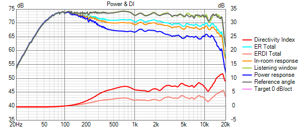

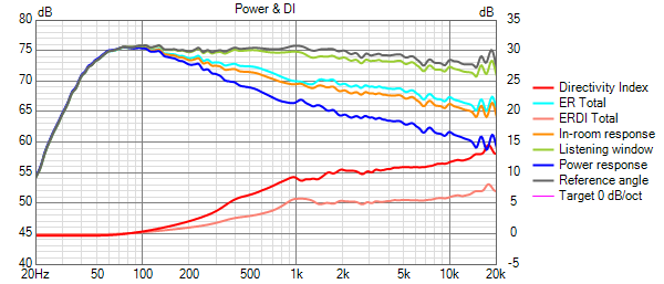

It is just that there is a feeling that the resolution in the highs is not somehow not matched by the frequencies lower down from the lows to mids. One of my hypothesis is that this could be due to large directivity step from about 200Hz to 2kHz range ( close to 10 dB). For reference here is the response of my main system
Whereas with the cardioid system, it looks like this

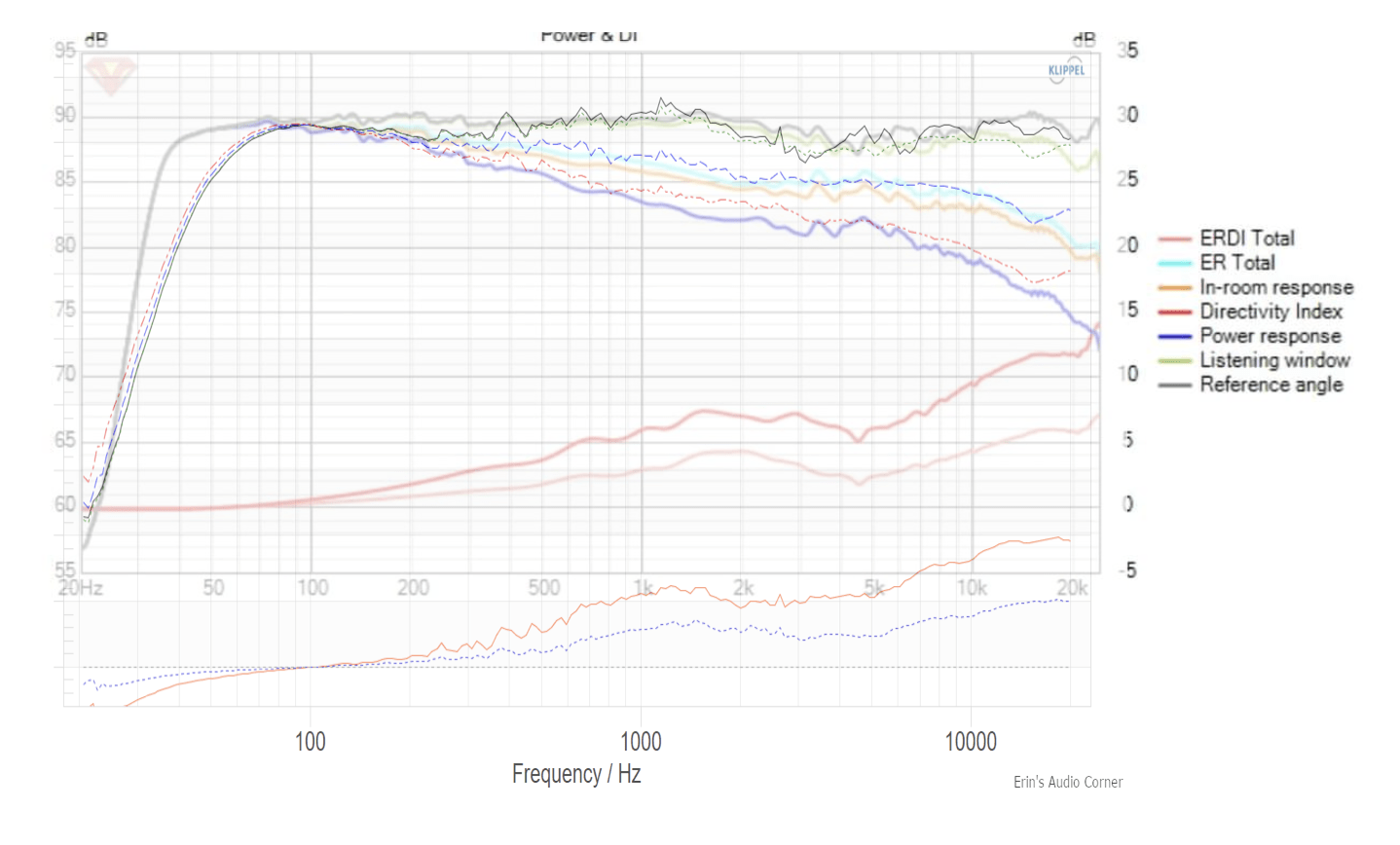

If you align the scales between the Vituix style and Klippel style, there are some striking similarities between the Kero and the Ascend
The DI graphs don't line up but the rest do
