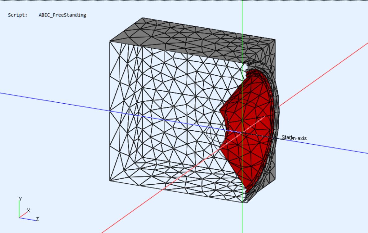

Here's an ATH config file (attached ZIP) for an 18 inch woofer in an enclosure. You can modify Source.Contours to match your 15 inch woofer diaphragm in an enclosure then simulate front and rear noise cancellation in VituixCAD. Or add an ATH horn around a woofer in an enclosure. But you can only modify the enclosure by footprint so it won't simulate the rounded enclosure like you show in your design.
  • Thank You
Reactions: vineethkumar01

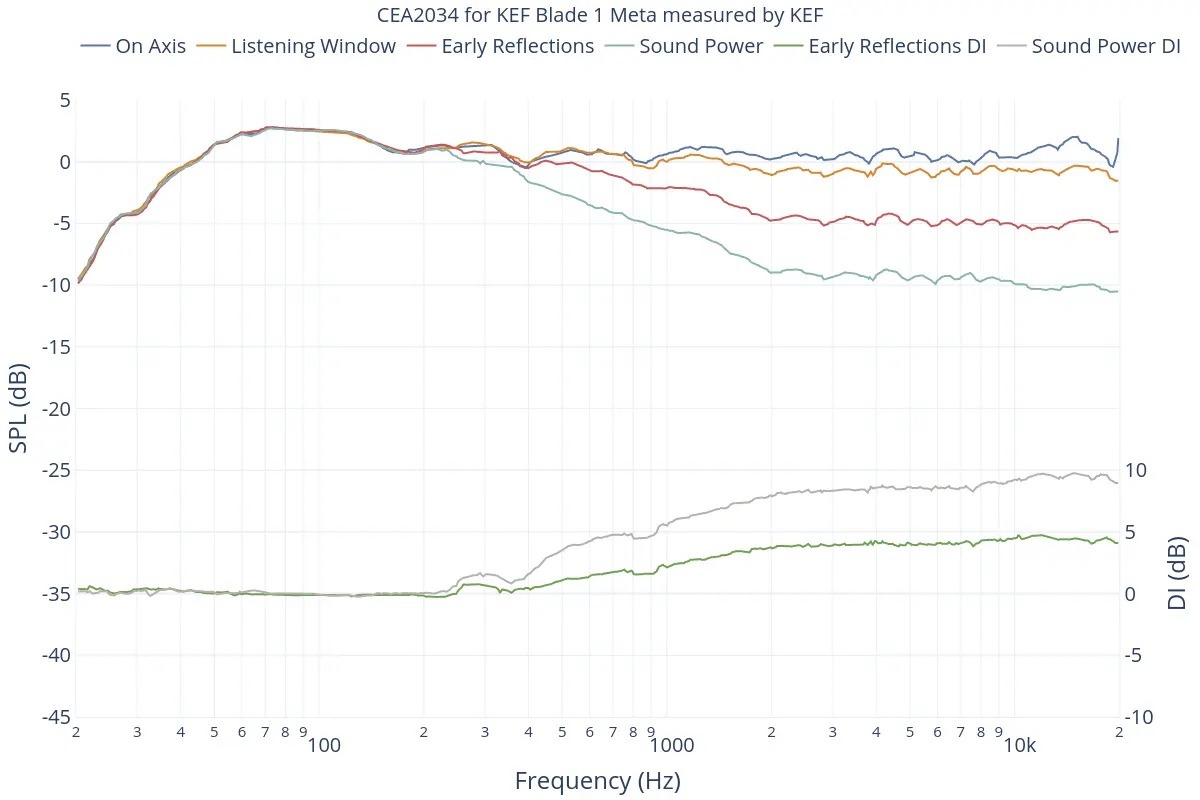

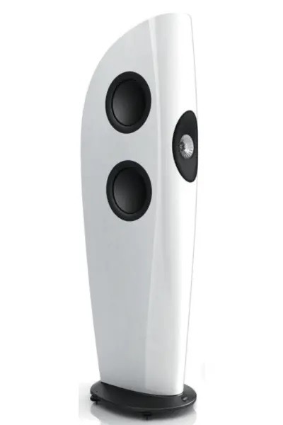

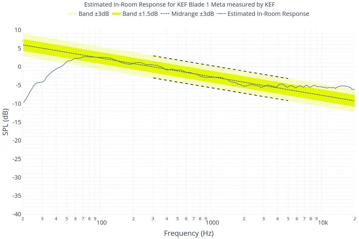

pps. if you start the thinking route, you'd likely arrive to synergies. "issue" with synergies is that it's gonna be big if you want good pattern control to low frequency. If you can accommodate big, then go for it, otherwise gradient system is what can do some directivity in a smaller form factor. It's all about compromises, and having clear goal / set of priorities help you take set of compromises you can be happy with at the end.
KEF Blade doesn't extend directivity index as high or as low in frequency and doesn't have the dynamics of a synergy but they also don't have the deep waveguide. I wonder if Kimmosto would prefer the KEF over the synergy in a home environment. Has anyone tried to DIY a Blade yet?
Vineeth has coaxial experience and rigid foam skills under his belt. I was really impressed by the visual draw of his coaxial enclosures. He has the ability to successfully shape an enclosure as complex as a Blade and refine his ABEC simulation skills in the process. My suspicion is there is more home Hi-Fi sonic value in KEF's strategy than copying a synergy build. Kimmosto mentioned he uses KEFs (in addition to JBLs and some small full range Scan-Speaks) in his own home. So I'll come out as one vote in favor of urging Vineeth away from continuing down his path toward synergies 😛.
After that project Vineeth would only be one step away from being capable of designing a Blade / Kii Three mash-up. Also, Vineeth has 3D printing skills. Patrick Bateman worked on the KEF Meta rear chamber silencers and ATH software is able to shape that black portion around the KEF coaxial that connects it to the enclosure. The more I think about it Synergies seem like kind of a waste of his knowledge, skills, and abilities. Synergies don't even seem like the type of creativity Vineeth chases. The exception to everything I've said is if Synergies create the kind of sound he prefers.
https://www.spinorama.org/speakers/KEF Blade 1 Meta/KEF/index_vendor-v2-20230503.html

I think I’d sooner take the take the Reference and put 1.5” round overs on them, over the Blade. 😱

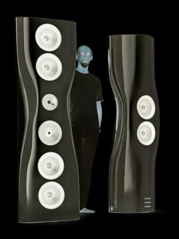

Maybe that is why a diy version of a KEF muon kind of speaker with a bit less art and more acoustically sensible design choices makes sense.. 🙂
So IMHO It’s definitely about the learning, the creation, the journey. The sharing.
There is no destination. Perfection is an illusion that keeps us going.
And besides, be aware that it could be just the brain.
The brain likes novelty. This is evidence based.
Thanks a lot 🙂
Edit: The muon looked assymetric to my eyes till now. But when I looked at other photos, it looks symmetrical. That was one of my gripes earlier. Anyway KEF knows better than me about making speakers 😀

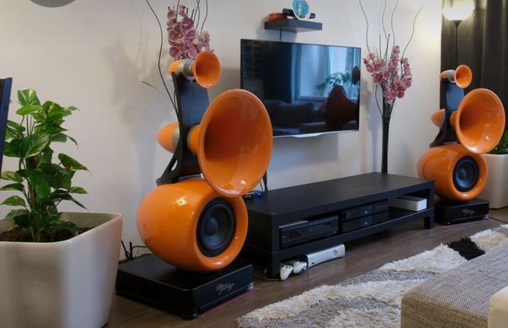

Speaker design language-wise, I will prefer something like this in the living room compared to a KEF muon monolith. My wife might like it better too 😀
Well, we change the color, make the woofer large and cardioid, lose the topmost small horn and have a downfiring subwoofer integrated with above system.. Makes it also easier to move to a Synergized horn, if needed later.
Let me try if something can be done along these lines.. 😀
