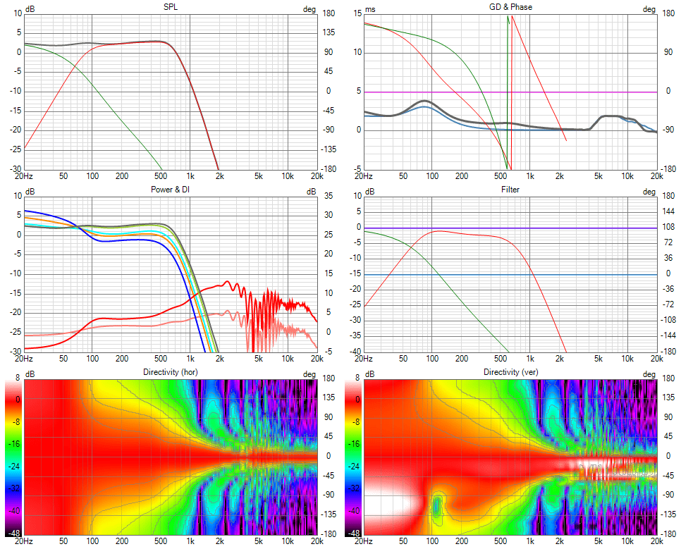

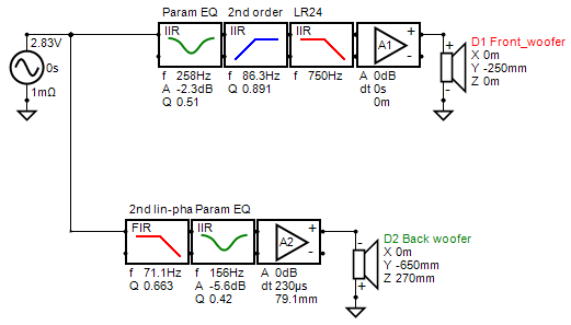

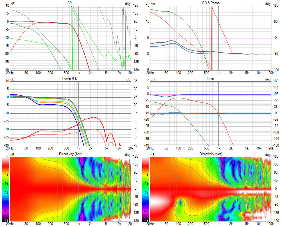

I tried something like @fluid mentioned in VituixCAD. 15inch woofers on a rectangular baffle one 800mm tall and 450mm wide.
But with one woofer playing mids on the front and one at the floor near the ground to get some boundary gain.
Here is a sim showing the results.
Something is happening like the on axis response is below power response below 80Hz.
Yes because most of the output below that point is coming from behind the speaker 🙂
In reality it may end up being better to design for a smoothly increasing power response than a flat on axis result. Or it may not matter as that is where the room is in complete control and in room EQ is likely to be helpful in taming the overall response.
Easy enough to check with an active system if you build one.
If you really like the circle look you could probably stack one on top of each other one facing forwards one facing backwards and end up at a similar point.

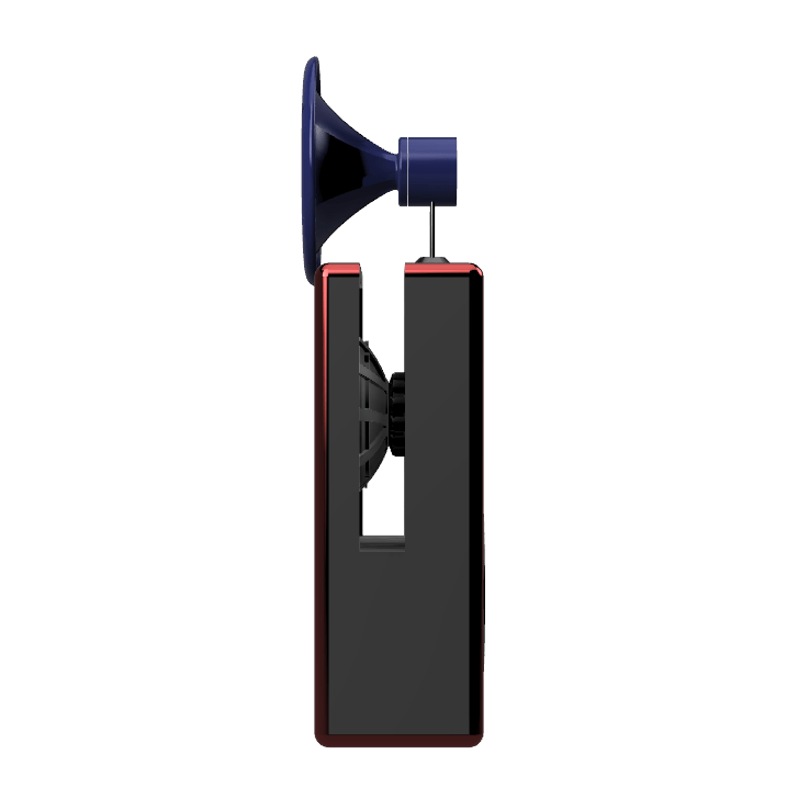

Just drawing the concept to see how it all looks 🙂
The mini fridge-sized 3-way speaker
Box of size 45cm width by 80cm height by 28cm depth. Internal volume to be estimated.
Currently front driver is in a slotted cardioid enclosure (can also be converted into sealed to accommodate the concept discussed in above posts) and back woofer in sealed enclosure.
Next iteration, I can try to see if something wilder can be drawn 😀
I'm not sure that you will need the slots, the waveguide will be higher directivity and having the woofer rise up to meet it will make the transition smoother. Use a diagonal separator between the drivers to separate them and brace the box at the same time.

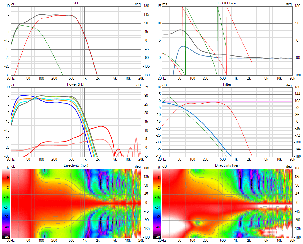

@wesayso: As per the recent posts above, and as fluid pointed out, I dont need a slot in the box for cardioidish radiation, The woofer on the 45cm baffle has about 5ish dB directivity down to about 300Hz. Above that most of the pattern control is probably done by the baffle/woofer size itself and it makes the woofer directivity rise up to meet the waveguide.
Below 300Hz, the dual woofer setup appropriately bandpassed and delayed give about 4.5ish dB of directivity down to about 100Hz. So this thing should work with just two sealed woofers.
But still, I am confused about the box size and shape etc. Especially about the comments that people say about "boxiness" of sound when that 15pr400 kind of woofer is put in small volume boxes. Maybe it has something to do with ineffective resonance control. I am not sure though. The hope with the slotted open cardioid enclosure was to eliminate that boxiness aspect and to get decent pattern control. Once the wavelengths become woofer sized, there is probably no advantage with the passive cardioid enclosure anyway..
I am still thinking about which direction to go with this 2x15 inch woofers + EXAR 400 concept. I dont have the space to accomodate a dipole radiating speaker as there is close wall at the back of the final placement of this speaker nor is there enough space to pull out the speakers into the room by more than about 60cm from the wall. This is sort of guaranteed even if I move to another rented accomodation in future. One thing that I am sure of is that I want to reduce the space occupied by the speaker... 😀

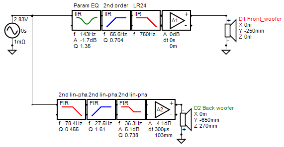

Did one more sim with the 15PR400 & SB 15inch nero sub in 45L sealed cabinets. Diffraction response on a 48cm baffle for both drivers were merged with their 2pi in box response. The nero was kept 220mm above the floor at the back of this 48cm wide box with 27cm depth and total 90cm height

Because they want to use it in a 2 way without a sub driver. In a small sealed box there would be virtually no bass. In your application this is exactly what you want. The sub driver needs to be able to go quite high so it's frequency response isn't a problem in the overlap region.

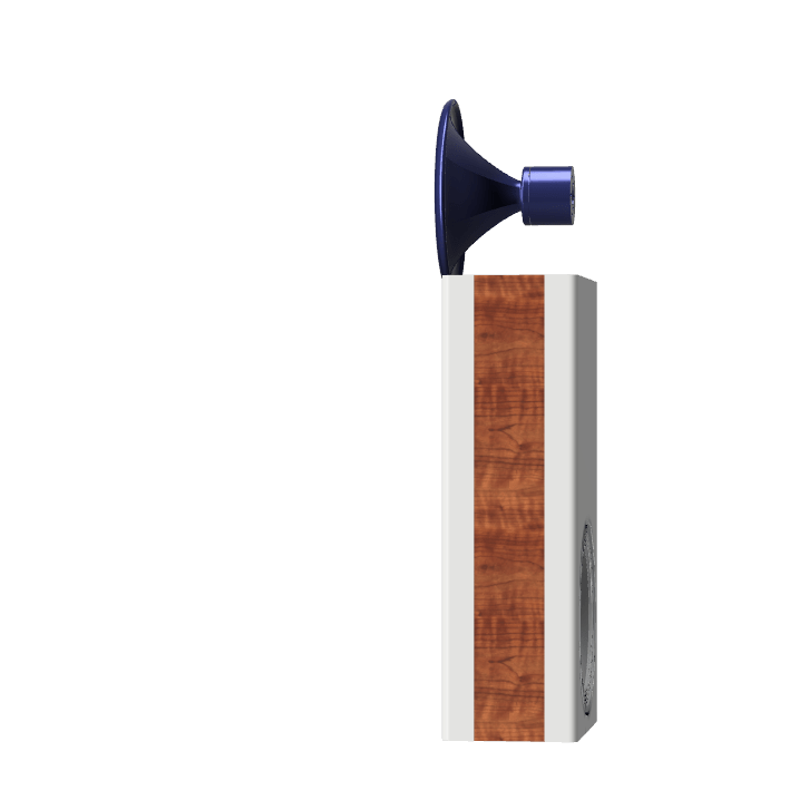

View attachment 1240871View attachment 1240872

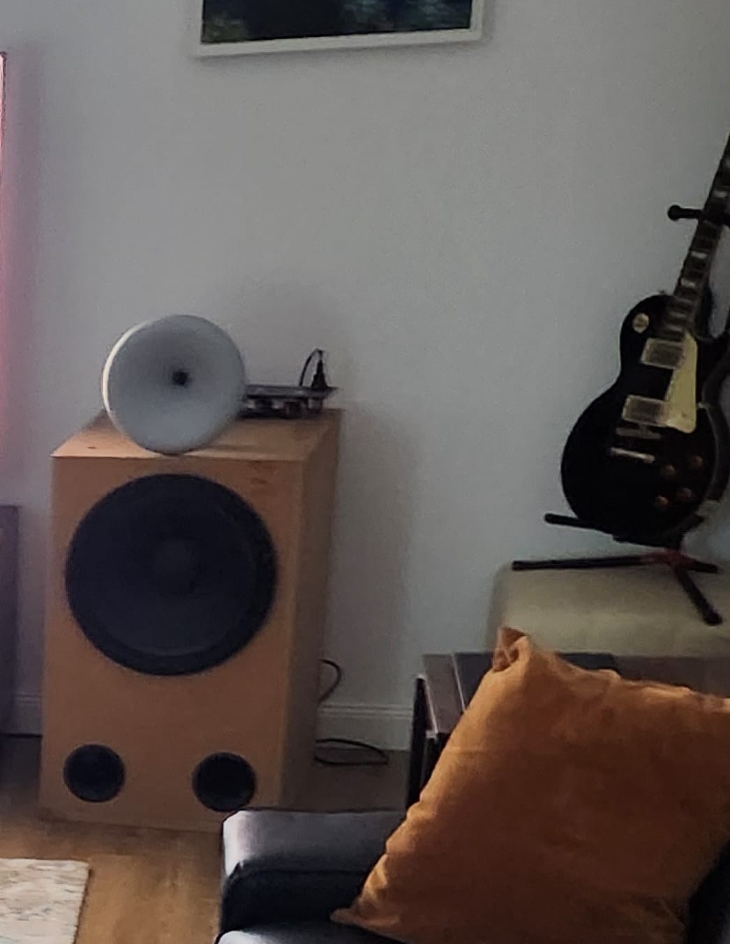

This is my setup,(not finished yet)the components are: Faital 15PR400 & Faital HF10AK in a custom waveguide crossed at 750hz, powered by DSP Hypex plate amps.
I can't attach the measurements as I don't have access to my laptop right now, but if anyone is interested I could do that.

I would go with a significantly smaller volume for the rear woofer. This woofer's radiation cancels the front woofer to create cardioid response. To get max low end extension in this scenario, equalize the front woofer down to 20 Hz or so but high pass the rear woofer at 50 Hz. If you are doing that, it doesn't need so much volume or volume displacement. With equal volumes and more elaborate DSP scheme, you could arrange rear woofer to be phased for cancellation above a transition frequency such as 50 Hz and in phase for support below that frequency. Transition frequency might be related to distance from front wall.
