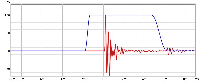

I noticed you said you were using a 10 ms gate window... looking at your impulse response, I think your gate should be about 4.5 ms. There is a wiggle there at ~ 4.5 ms that is probably your first reflection.
This is normal of waveguide/horn response, the Faital has a little bit of Tractrix to it, so the on on axis is a little flatter than it would be in something designed for more constant directivity.In the above plot, we can see that the horn's response droops down slightly after 4kHz eventually ending up about 10dB below the level at which it started around 4kHz.
Some relevant information I posted here
https://www.audiosciencereview.com/.../revel-m105-copy-diy-build.29465/post-1030095

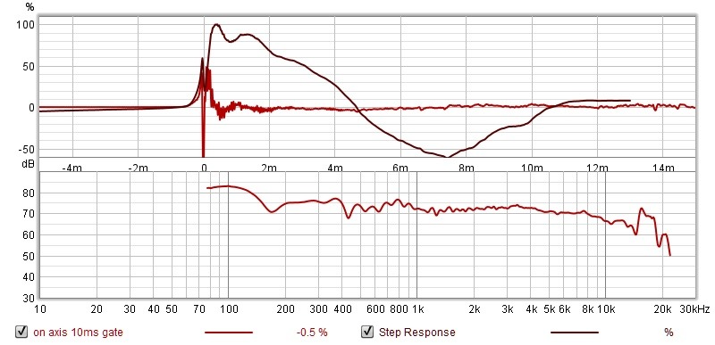

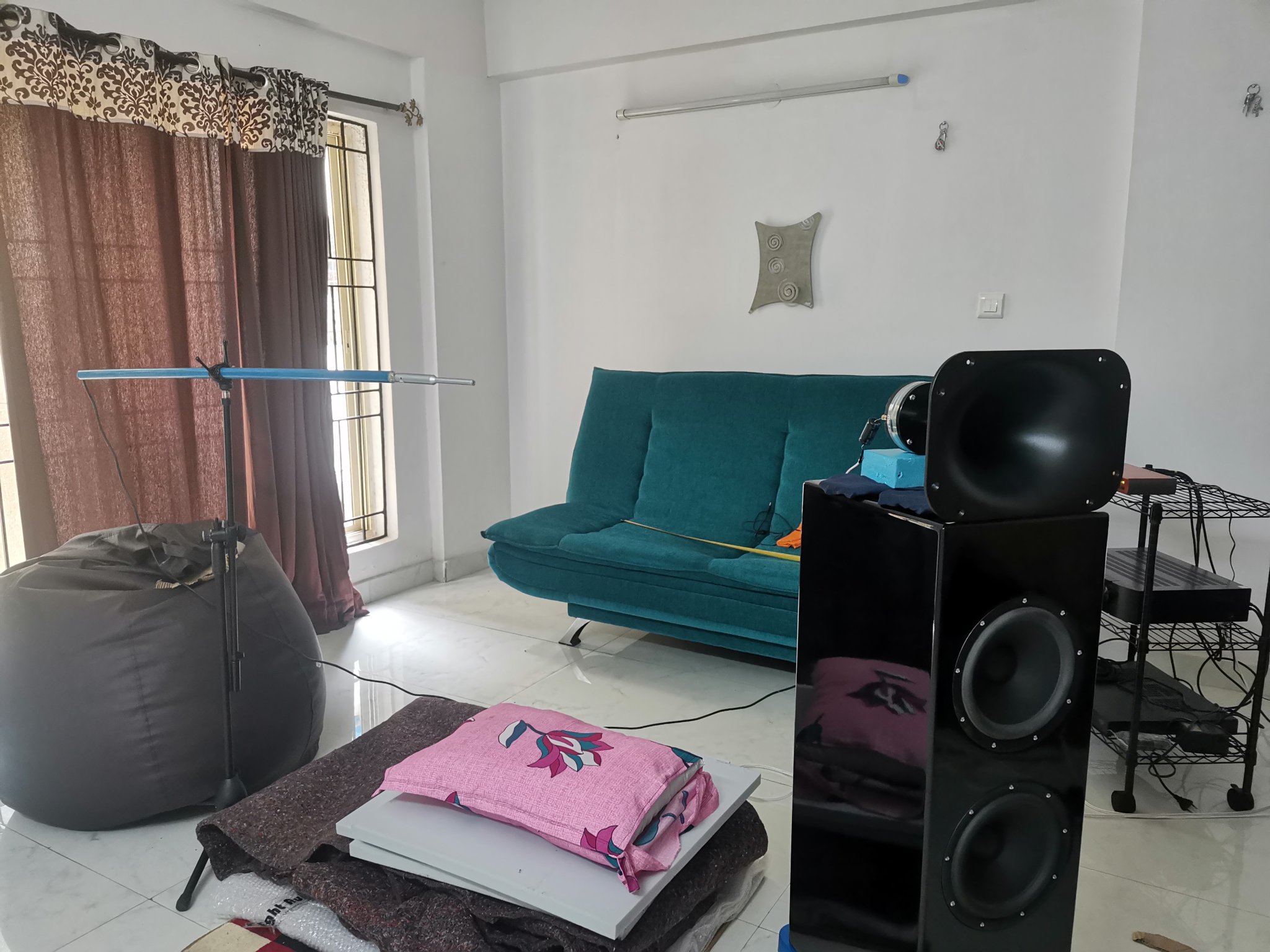

I don't see the value in a 1.3m measurement with the speaker on the floor that close to other boundaries. It will not give either an accurate anechoic or in room response.
Thank you for pointing this out. I had actually noticed this small wiggle but thought that its impact is relatively less due to its lower amplitude in the impulse response plot.I noticed you said you were using a 10 ms gate window... looking at your impulse response, I think your gate should be about 4.5 ms. There is a wiggle there at ~ 4.5 ms that is probably your first reflection.

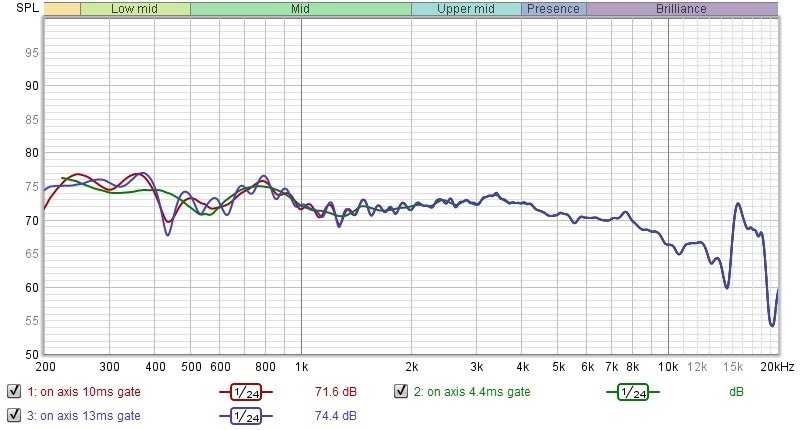

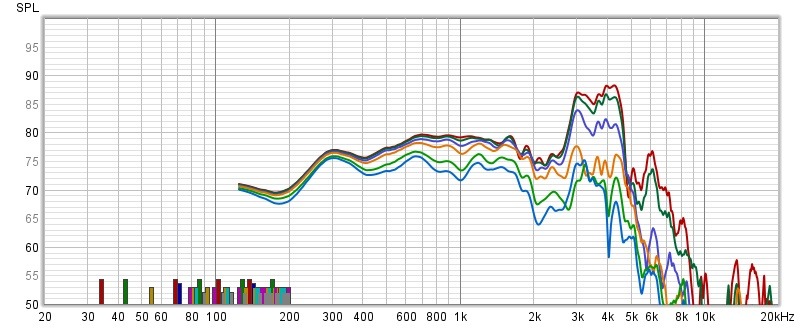

I compared the different plots at 4.4ms,10ms, and 13ms. Here are the frequency responses corresponding to above gate durations overlaid on top of each other.
impulse response plot showing low amplitude reflections upto about 13ms
All frequency response plots seem to be close to each other especially above 1kHz and even down to about 600Hz. I was more interested in the above 1kHz response in this case to learn more about the horn's response. 🙂
In this measurement scenario, the horn's center is 103cm up from floor, 180ish cm down from the roof, 200cm away from one sidewall and 250+cm away from the other side wall.
I was thinking that the relatively low amplitude of the reflections from boundaries and their impact on the above 1kHz range response was due to the amount of sound absorbing material i had put on the floor, the relatively larger distances to other reflecting boundaries, and the relatively high directionality of the horn ( due to which, above 1kHz, radiation to larger off axis angles are significantly attenuated compared to a wide radiating mid+tweeter type design) and hence creating only low amplitude reflections to arrive at the mic
I have gone through the post. I will go through the white paper also..
How much distance would be a good distance to measure for this speaker?
I had been hearing that greater than 3-4 x baffle width is a good distance. This is why i tried to take 130cm distance measurement which is greater than 4 x baffle width (30cm). With the floor being the closest boundary (103cm) out to 90 degree off axis angle both vertically and horizontally, i thought having significant amount of absorption might reduce the floor reflection. The roof is about 1.8m up from the center of the horn and the sidewalls are atleast 2m away from the centre of the horn.
When i try to do angular measurements next, first, in this same room (if it doesn't work out, i will have to take the speakers upto the roof of the building), i was thinking to get the centre of each driver to about 120-130 cm up from the floor with significant amount of sound absorption material put on the floor. I was planning to do measurement with mic tip about1.5m away from the baffle.
No absorption on the floor would not work at lower frequencies. However, if you're interested only in the response of the horn then a mattress on the floor should do. You could also use similar material to enclose the speaker from the sides, so as to increase the ratio between the direct and reflected sounds. Putting the speaker on a platform (bed) would get it closer to the ceiling.
To get into the far field of the speaker the rule of thumb is often given as 3 times the longest dimension of the cabinet.How much distance would be a good distance to measure for this speaker?

For the horn measuring at an equidistant point between floor and ceiling without absorption would maximize reflection free time, but you could contrast with the absorbent as you had it and the horn lower to the ground to get the longest gate you can. 4.3ms is not too bad but more would be better.
For the woofers you could try a ground plane measurement as you have tiles and it looks like quite a big room. With a tilt of the right angle this can be quite accurate at high frequencies too.
Measuring the woofers as you had it set up just seems odd to me, the absorbent is in the way of the bottom woofer more than the top and it's neither anechoic or in room, and to me representative of nothing useful either for crossover design or tonal balance.
As the woofer box is separate from the top you can measure the top box (or currently just the waveguide) alone about at 1 meter distance. Such measurements would have some error due to woofer box missing (or you could use it as a stand if you wish) but it is heck of a lot easier process to rotate small construct and measure at one meter than try find large space and measure big one higher up. Although accuracy would perhaps be better.
Yes the woofer measurements are not useful with the setup I had taken yesterday. As you pointed out, the absorbing material was almost directly in front of the bottom woofer and the bottom woofer was very close to the floor. My intention was to get some useful data, if possible for the horn. This is why I tried this setup. Next time I do measurements, I will keep all these aspects in mind.. 🙂Measuring the woofers as you had it set up just seems odd to me, the absorbent is in the way of the bottom woofer more than the top and it's neither anechoic or in room, and to me representative of nothing useful either for crossover design or tonal balance.

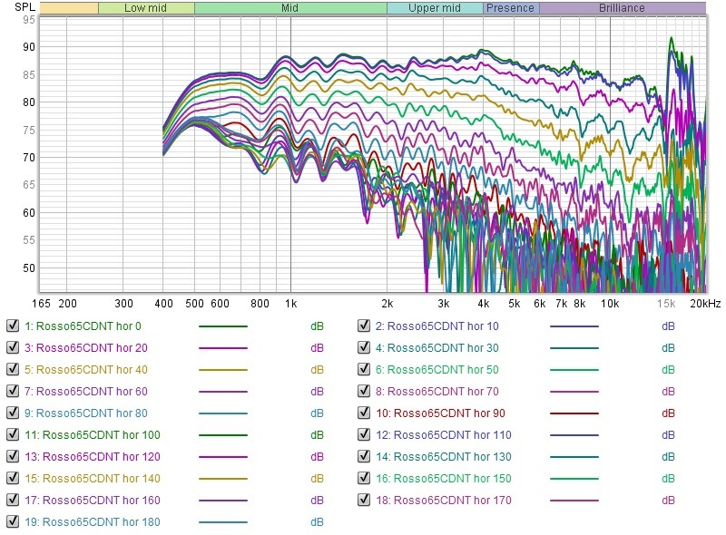

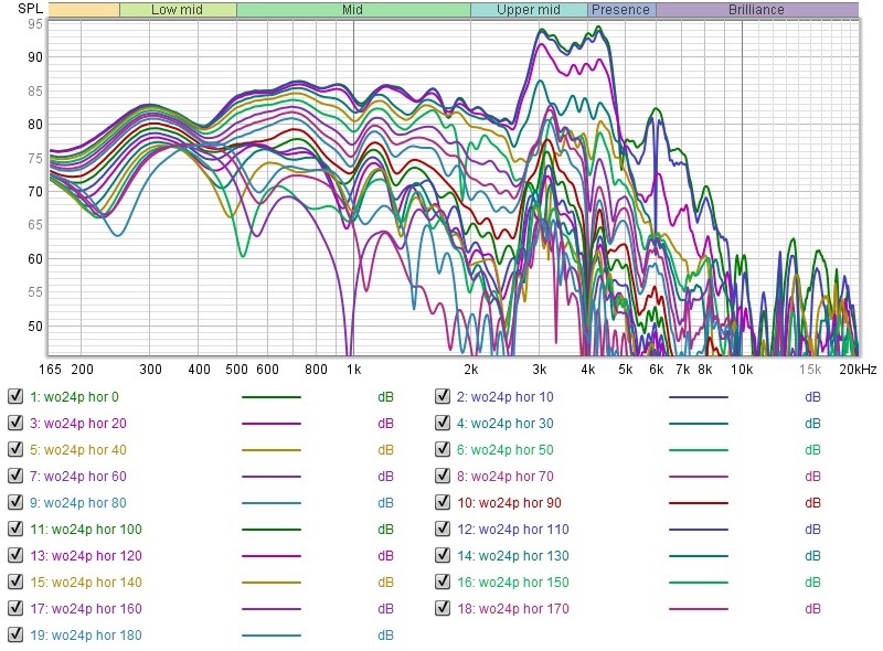

I started taking polar measurements and got till this point, measuring the top woofer. I took upto 50 degrees off axis from 1 metre away
I was happily cruising along taking measurements. Then disaster struck. REW started crashing again and again after a sweep. Then finally when i resolved it, now loopback is not being detected whatever i do. Dont know if it is sound card issue, or some software issue. I am also getting errors with messages mentioning some "Java null pointer exception " something.
Tried a lot to rectify it but to no avail. Maybe i need to take a break and come back to it again. I may even need to change my laptop since its keyboard is malfunctioning now.. 😀
On the good side, I am able to get upto a clean 6ms gate time before significant reflections arrive at mic using a combination of absorption material and positioning of the speaker in the room. 🙂
Hopefully, i get to complete this soon.

After a real lot of hard and boring work, this is the best i could do regarding taling measurements 🙂
Measurement session in progress

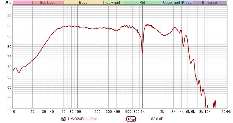

Top woofer nearfield
Top woofer farfield polar
Rosso65CDNT on Faitalpro LTH142 horn polar
I can't take far field measurements of the bottom woofer. Tried a lot. But couldn't. Problem is I am unable to lift the cabinet high enough now to take measurements with center of the bottom woofer facing the mic at about 1m height. Anyway I am going to cross it over around 350Hz eventually. I may try to take a ground plane or nearfield measurement for it. And I will have to do some vituixcad adjustment for it.

I am in the same situation. I am unwilling to lift my system high enough to get a far field measurement of the lower woofer. Our situations are very similar.I can't take far field measurements of the bottom woofer. Tried a lot. But couldn't. Problem is I am unable to lift the cabinet high enough now to take measurements with center of the bottom woofer facing the mic at about 1m height.
I feel that if the near field measurements of the upper and lower woofer match, and they do for me, I am willing to make the design assumption that the far field measurements of the upper and lower will be close enough. I use the upper woofer far field response to merge with the lower woofer near field response. This means the upper and lower woofer merged responses are very close to the same.
This is not ideal, perfect, not a best practice, but it is good enough for design purposes, in my opinion.

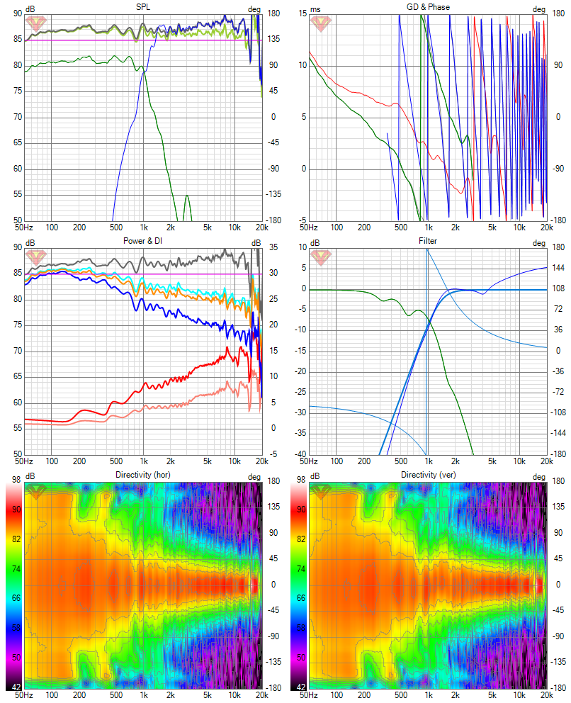

First attempt at crossover.. 😀
This is to get an idea about what can be done with this.. 🙂 The vertical polars maybe wrong. I will try to study and use some document related to same that FM decibel had posted long back in VituixCAD thread and try to see what can be done. As next step i will try to simply the signal processing and the filter blocks involved. 🙂

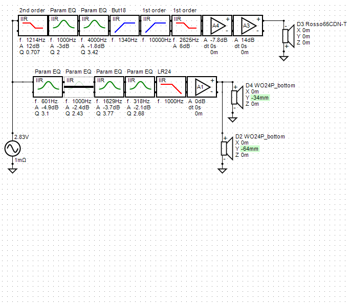

I am curious why you use two active amp stages on your horn, one with +14 dB gain, the other with -7.8 dB gain. I have not seen this technique used before. Is there some advantage to it?
I also noticed your "y dimensions" on your woofers are -34 mm and -64 mm. Perhaps you meant -340 and -640 ?
Top woofer at only -34 mm and bottom woofer at -64 mm ? Did I missed something ?
I just added that 14dB amp block to model that difference in sensitivity between the compression driver and the paralleled woofers.. Just modeling to see what can be done with that delta. 🙂 It is just a dummy block. I will measure and adjust amp volume to compensate the sensitivity delta later when i am ready to apply the crossover on the system
Other blocks are the actual frequency response shaping blocks.
@jcga ,@hifijim : Thank you very much for pointing this out the 34mm and 64mm issue. It is a mistake on my part. Just because i am used to the 'cm' convention, I mistakenly put the numbers there..😀
I will adjust the numbers and work on it again
