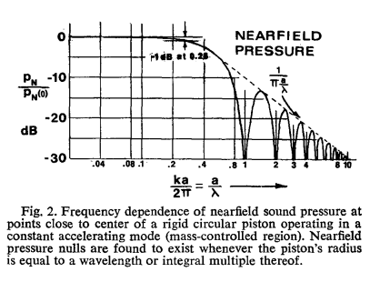

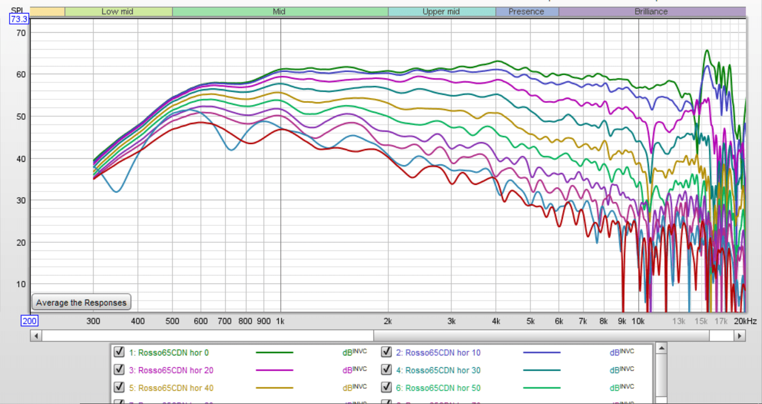

Isn't this supposed to be a 3-way speaker? Don't waste energy on that 1kHz dip!
Maybe I am not explaining myself very well, it shouldn't be a surprise that the surround resonance occurs at the same place as the nearfield nulls do as they are related to the size of the wavelength of the piston's diameter.This plot I got from hificompass. normalized nearfield for the same driver. It shows a deep notch around 1kHz similar to mine.
Here is a graph from Don Keele's nearfield paper showing the nulls. The same ones appear in your and Hificompasses measurements as expected.
@tmuikku : Yes i do plan to make polar measurements.. 🙂
@Juhazi: I went behind this "issue" just to understand more about it.. 😀
But fluid's answer now makes it all clear to me..
@fluid: Thanks a lot.. Now what is going on is clearer to me 🙂
On to next round of experiments and finishing up work related to this woofer box.. 😀

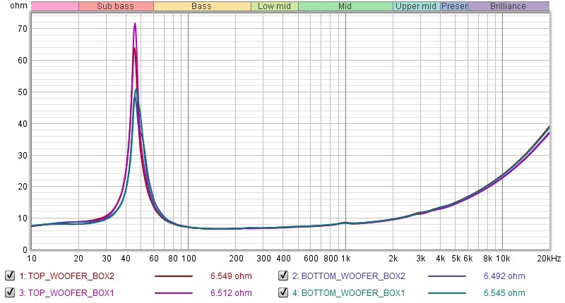

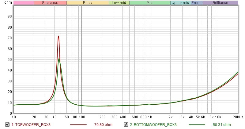

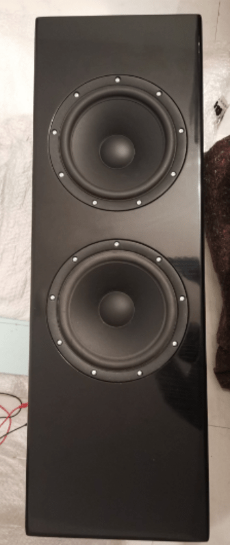

Round-2 box measurements
Now I put both the woofers in the box and took each woofer's impedance measurements. All holes in the box were sealed.
Here is the pic of the setup:
Here are the impedance plots for the top and bottom woofers in the box.
Looks like the impedance peak of the top woofer is higher but both woofers have the same width for impedance peak.
The top woofer box tuning frequency is about 45.6 Hz and the bottom woofers tuning is around 46.3 Hz.
Overall, the values look close. But is there something that needs to be done about the height of the impedance peaks, to bring them approximately to same level. If so what can I do?
Does the 0.7Hz difference in tuning frequency matter?
In general are the above things worth loosing sleep over/digging deeper into? 😀

Have you got the free air impedance sweeps for both drivers to compare ? It isn't that unusual for drivers to have variations in parameters.
You can try to break the drivers in by running low frequency tones through them for a while to loosen up the suspensions.
Nothing there to lose sleep over. Are you going to power them separately or run them in series or parallel?

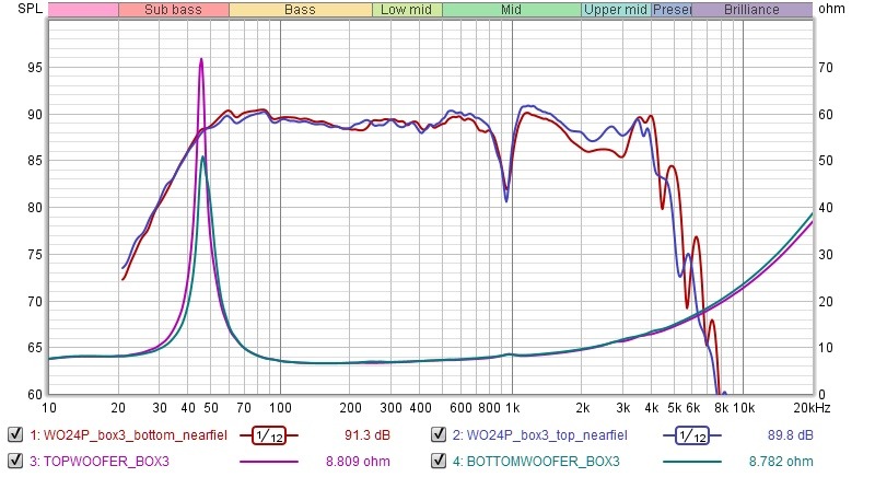

To round out the measurements, here are the impedance and nearfield frequency(baffle step not adjusted) responses of both woofers overlaid.
There was a slight variation of about 1dB difference in sensitivity between the two drivers at the moment i think. These two woofers were from different production batches and were purchased almost 1 year apart.
In above plot, i offset the level of one of the woofers by about 1.3 dB or so to get the above frequency reaponses. i think there is also a difference of a few mm between the two woofers centre and the mic when i took frequency response measurements.
Impedance measurements were taken using dats v3 as usual.
I had taken the free air impedances of all 4 woofers. But i didn't take them today. I will try to take them/find the existing ones and post here later 🙂Have you got the free air impedance sweeps for both drivers to compare ? It isn't that unusual for drivers to have variations in parameters.
Ok. This I will try to do.. and then take measurements again.You can try to break the drivers in by running low frequency tones through them for a while to loosen up the suspensions.
I am planning to have a separate dsp channel and amp for each driver. 😀Nothing there to lose sleep over. Are you going to power them separately or run them in series or parallel?
Is it a good approach?
If you have them available it won't do any harm 🙂I am planning to have a separate dsp channel and amp for each driver. 😀
I thought the problem with series connection is that i will loose some sensitivity. With parallel connection, the minimum impedance will go around 2.5 ohms. My amps will never handle below 3 ohms.If you have them available it won't do any harm 🙂
So i thought to go with separate amps and dsp channels for each driver. I am planning to setup 8 channel dsp.
I thought this will also give the freedom to play with different configurations like these woofers in a 2.5 system in addition to the 3 way configuration along with a horn top and other top modules .. 😀
I usually break-in a woofer with 20 Hz sine wave, with enough voltage to get +/- 5mm displacement... this is usually between 3 and 4 volts. I run them for 15 minutes.
But I can't see any benefit either. Unless you need extreme spl levels.If you have them available it won't do any harm 🙂

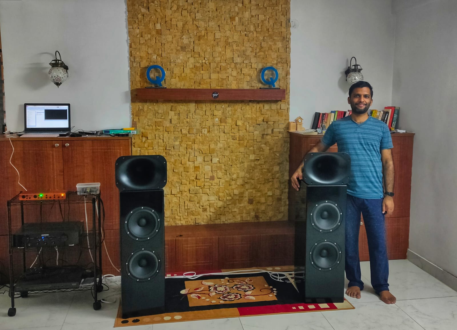

Round-3 assembling full system and making it play before taking polar measurements due to curiosity 😀
So i assembled the entire thing, paralled the woofers per cabinet, used the prototype crossovers i had developed for the foam box system and finally made it play as a 2 way system (SB audience Rosso 65CDN-T on Faitalpro LTH142 horn as the top module).
Here is me and my current system. The 6 channel amps are yet to arrive for 3/2.5 way crossover.
I have no words.. It is so good 😀 Just happy even with the way it is playing even now.. 😀

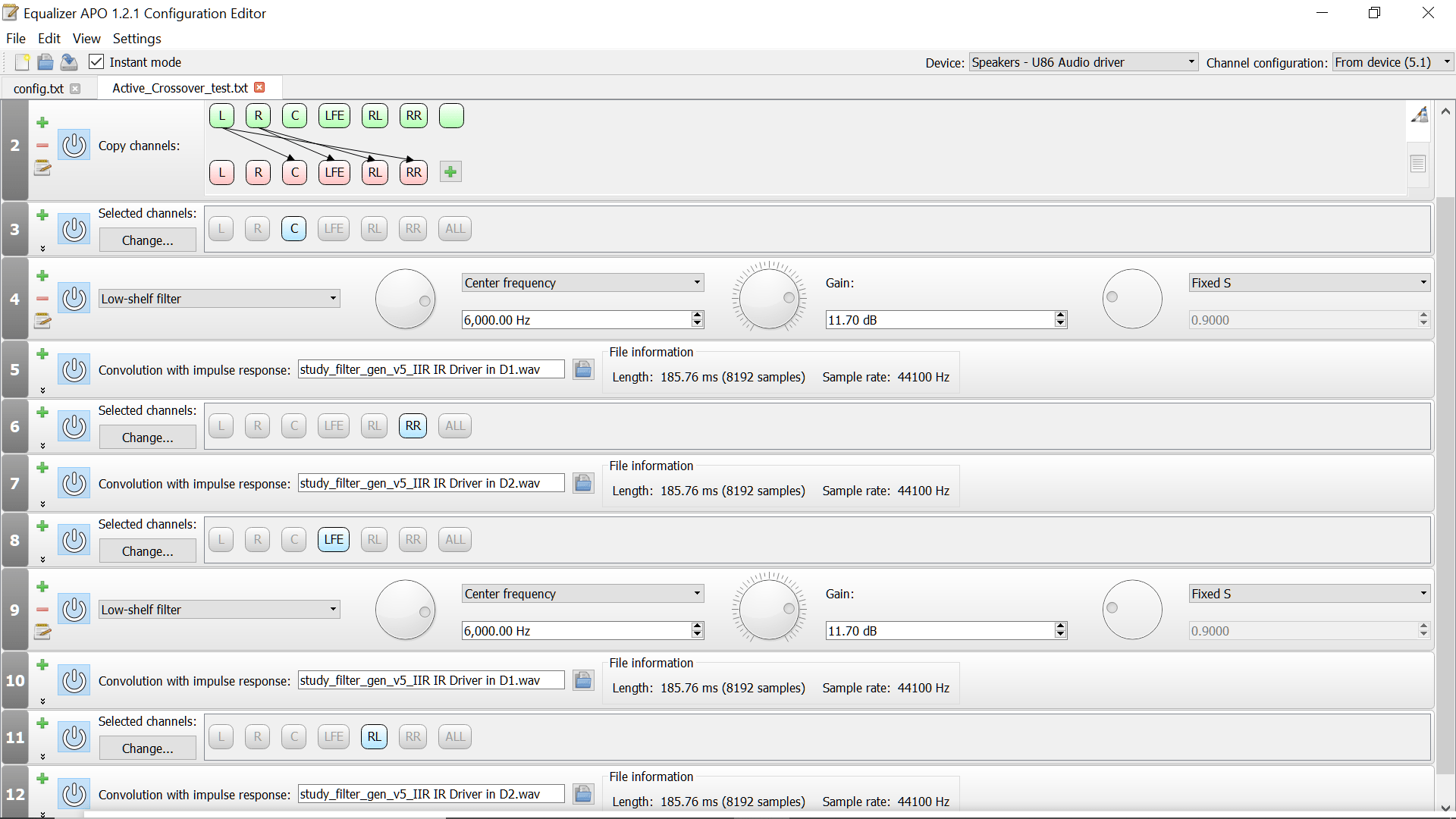

Just updating a few more details.

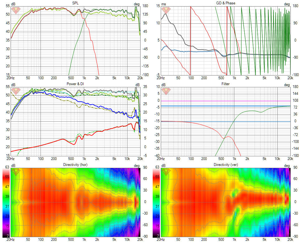

Current impedance plots of all 4 woofers in their boxes
Current 2 way crossover in Equalizer Apo

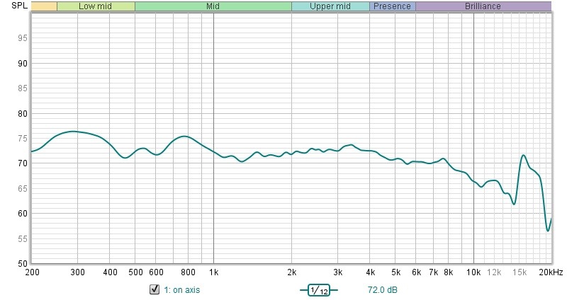

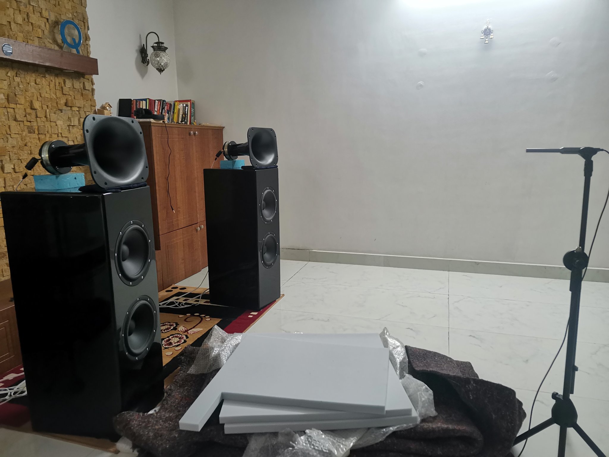

So i did this today to start figuring out what the system is doing currently and before i get time to do full measurements for individual drivers. 😀
On the stand is minidsp umik-1. on the floor are probably 20cm thick acoustic wool and on top of it are 3 sheets of basotect melamine foam.
Mic stands at a height of 103cm from floor and aimed at the centee of the compression driver and at a ditance of 130cm from baffle surface.
Here is the on axis single speaker frequency response (with current crossover) i got with a gate time of 10ms

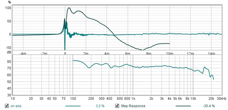

Here are the time domain plots
Is it worth shelving down the entire response by about 10dB so that it becomes flatter till about 15kHz?
I will try to do polar measurements anyway during next week or so but wanted to get an idea about the kind of on axis i should aim for..
Also here is the previous prototype xps foam box based full system responses
The current on axis response shape looks pretty close to the previous one above.. 😀

In the above plot, we can see that the horn's response droops down slightly after 4kHz eventually ending up about 10dB below the level at which it started around 4kHz.
Even in this build I will be crossing the woofer to CD+horn somewhere around 1kHz. So unless i do something to shape the overall response of the horn, i am probably going to get similar horizontal polar response for the overall system above 1-2kHz.
Hemce the doubt about whether i need to shelve down the horn response such that it looks flat from say 2kHz to 14kHz.
Also the compression drivers sensitivity is 109dB/1W/1m.
The woofers even in parallel are going to give me at the most 88dB +6dB = 94 dB/1W/1m

But even once it arrives, the first configuration i want to experiment with is a 2.5 way where the bottom woofer is highpassed and slowly rolls off around 350Hz while the top woofer goes and meets the horn at around 1kHz.
