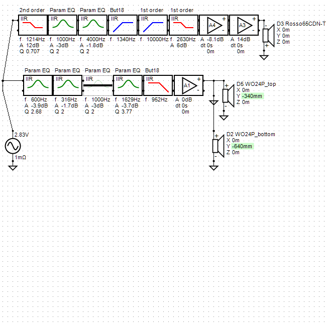

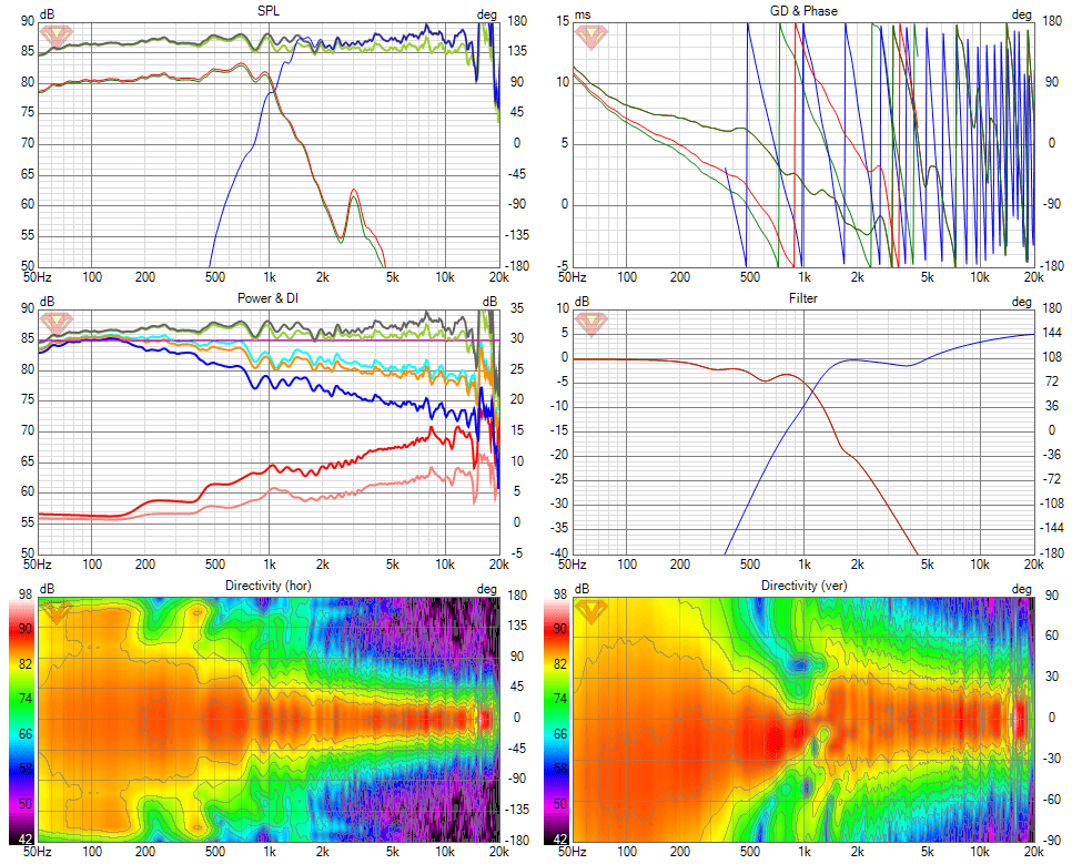

First attempt at crossover.. 😀
What's that 1st order high-pass at 10k, is that correct?
Crossover updated 😀
Probably, i think i will get a bit more energy and reduce cancellation and nulls around crossover in the vertical response, if i make this entire configuration 2.5 way and roll off one woofer earlier around 350Hz. The 2 woofer responses itself causes some lobing around crossover in vertical direction.

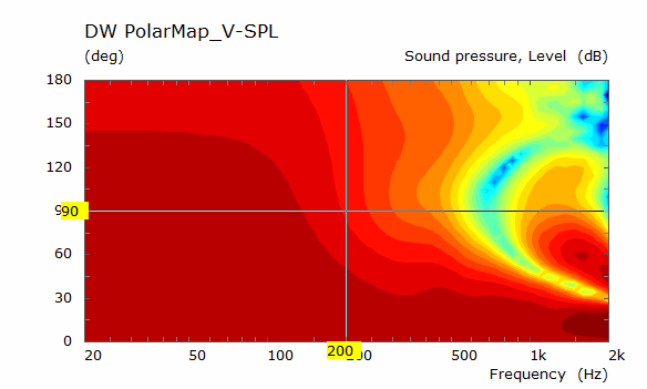

The two woofers themselves are causing some lobing around 1kHz
Fluid had shown something similar to this long back in his sims for twin woofer configuration as shown below if i understood it correctly
It was to bring the horn response down to flat from a sloping down response from 1kHz to 10kHz 🙂What's that 1st order high-pass at 10k, is that correct?
Is there any particular advantage if a high-pass is used in place of a low-shelf ? Wouldn't that also reduce the number of biquads required to implement the filter ?
One probably wants some kind of high pass for the tweeter, perhaps even a capacitor despite DSP to protect it for fault conditions and accidents. For the rest of it it doesn't matter mucho which filters to use as the acoustic response is what matters in the end, with resulting group delay and phase stuff no matter what filters were used to get the response.
Very high low pass is neat trick, Geddes used one years ago and perhaps others before him and is quite easy to come up with in VituixCAD as well. Small cheap capacitor, good response and protection. Works very well with ~constant directivity waveguides and compression drivers, not too well with direct radiating tweeters as they are quite flat already, hence you don't see this implemented too often just because the constant directivity speakers are still a rare thing.

As far as i know, a single digital biquad can implement upto any second order transfer function. In this case I have used a 1st order high pass filter which can take up a single biquad. Does a low shelf filter not require a biquad?

Also the current response and crossover that i showed above is just a prototype that i cooked up in 15minutes. I will refine it further. As you pointed out, in a real hardware dsp implementation, biquads are limited, FIR capabilities are scarce. Hence we need to implement most of the things with IIR filters. In such a scenario every biquad should be carefully used.
In fact, the type od crossover blocks i used are to be used with IIR filter based DSP implementation. With FIR capability, to utilize it better, i should have done it smarter.. 🙂 But it doesn't matter given that i can change crossover design any time and Vituixcad can get me the impulse response files for convolution of any arbitrary transfer functions that i want.FIR or IIR. 🙂
In fact i already have a 150uF capacitor in series with the compression driver. I can try a smaller value if required.. 🙂 All measurements of the compression driver on horn that i posted above include this series capacitor also.One probably wants some kind of high pass for the tweeter, perhaps even a capacitor despite DSP to protect it for fault conditions and accidents. For the rest of it it doesn't matter mucho which filters to use as the acoustic response is what matters in the end. This is neat trick, Geddes used one years ago, perhaps others before him and is quite easy to come up with in VituixCAD as well. Small cheap capacitor, good response and protection. Works very well with ~constant directivity waveguides and compression drivers, not too well with direct radiating tweeters as they are quite flat already, hence you don't see this implemented too often just because the constant directivity speakers are still rare.

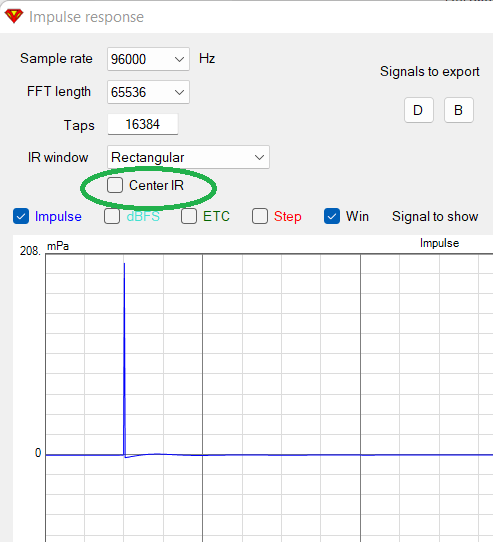

There doesn’t have to be any delay in a minimum phase FIR filter. If the peak of the impulse response is at the front instead of centered. A 65,536 tap filter can be 1 or 2 ms latency.Currently I run 8192 tap FIR filters per driver. Each FIR filter transfer function can contain all the frequency shaping features needed for Driver passband linearization, crossover filters and phase linearization if required. This will result in about 185ms of delay as per EQApo but at the moment my music collection is in harddrives and laptop and hence delay is a non issue.. 🙂
Often the high pass is more like 20K for a waveguide to compensate the mass rolloff. You might be able to undo the effect of the 150uF cap in Vituix to see what you could do with just a small cap for the high pass.

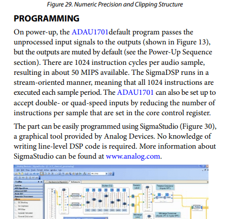

ps. checked out ADAU1701, about the cheapest DSP chip, and it has 1024 instructions per sample, what ever that means. I suppose it could be 1024 filters, divide for 4 outputs and one could have 256 per channel. Even if it was 10 instructions per filter it would be still 25 filters per channel, plenty to knock out any peaks and dips from any reasonable system without any extra cost in sound quality as long as the EQ was on things that don't make things worse, IOW for good reason.

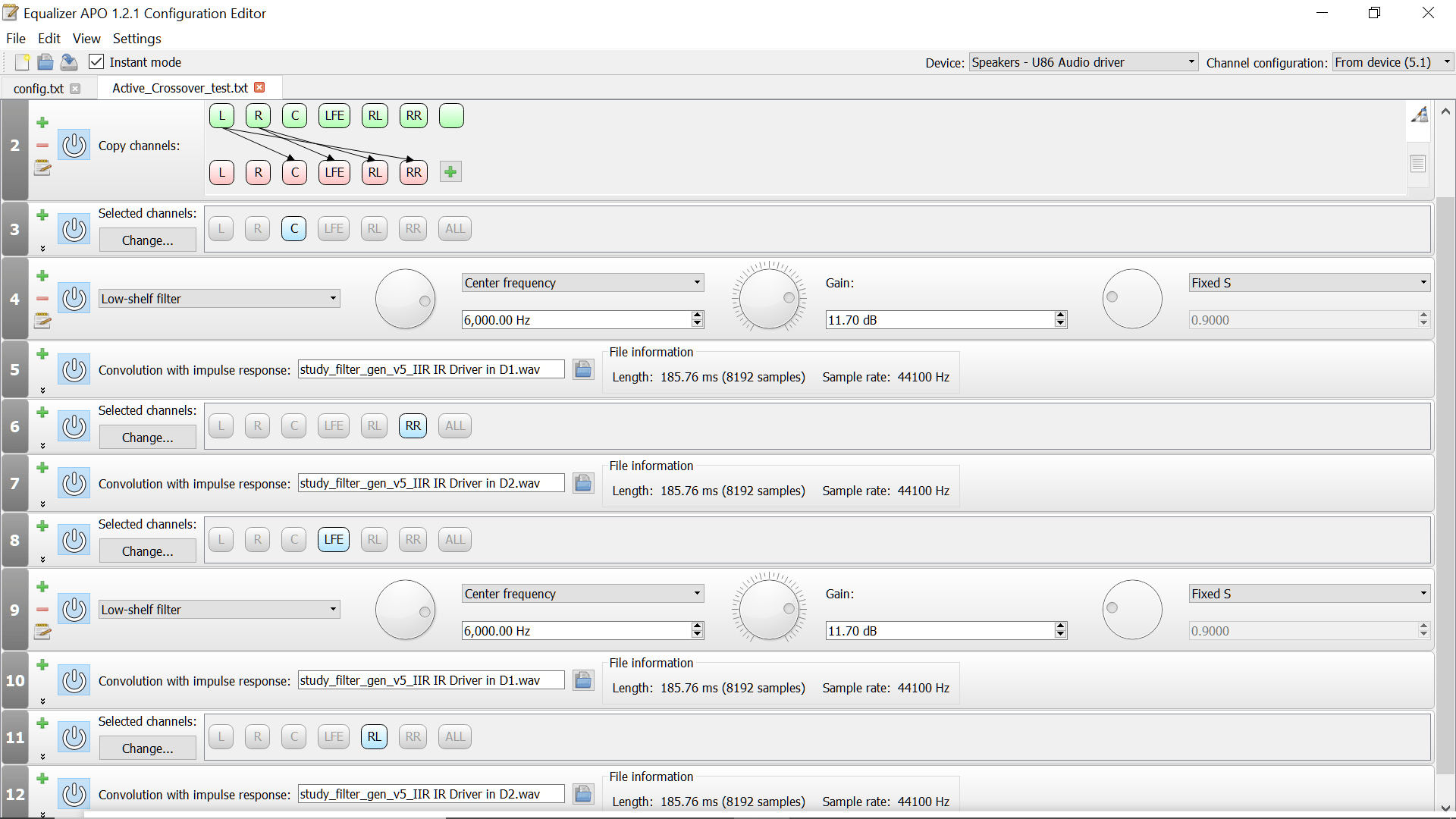

@tmuikku : With Equalizer Apo and VituixCAD, one advantage that we can make use of is we can just design all filters in VituixCAD and see its effects on the driver responses first (including driver passband linearization and crossover filter).
Then VituixCAD can create the impulse response of a "super filter" for each driver that includes the effects of all filters in the driver's signal path and dump it into a file. Now this file is the only thing that we need to use in Equalizer Apo along with any Pre amp blocks/shelving filters, channel mapping, if required. So there is no need to go and again specify all the filters as we designed in VituixCAD in the DSP software. So the interface looks clean.. 😀
This is how my DSP interface looks like on PC:
each of the '.wav' filters in above snippet is an FIR "super filter" for each driver 🙂
So if 2 way system, we just need to mention the 2 impulse response files per speaker (let's say left channel). Copy the entire thing for right channel as well. DSP done 🙂
No biquads or anything need to be used in the DSP implementing software if designed this way. EQApo can also be used in the traditional way where we design filters in VituixCAD and then copy all the filters and create it again in EQApo with appropriate plugin like traditional DSP. And there are other convolution softwares as well which might have more flexibilities.

@fluid : Can you please point me to a resource where there is some discussion on FIR filter design with impulse peak in the front instead of centered?

In Vituix untick Center Impulse and your done

ADAU1701 .......has 1024 instructions per sample .... could be 1024 filters ... Even if it was 10 instructions per filter it would be still 25 filters per channel, plenty to knock out any peaks and dips from any reasonable system.....
