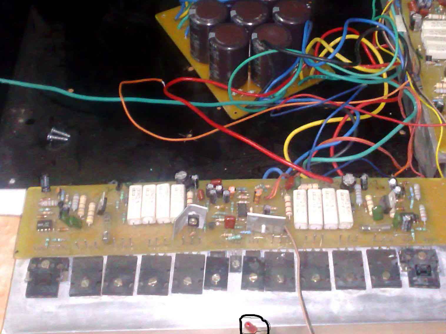

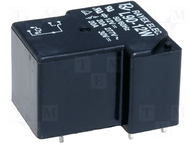

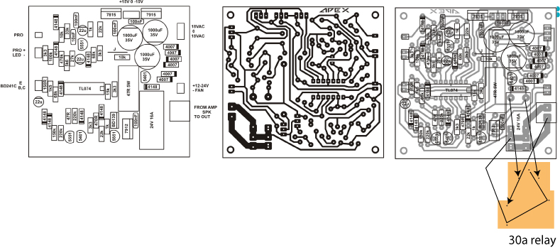

can i use this 30a 24vdc relay for h900 protect pcb.?
i know its not fitting to the protect pcb.
Nazir,
measure the coil resistance. Check that it pulls in with either polarity of supply. Some relays only pull in with one polarity.
Measure the switching terminals for zero volts. Normally Closed pair will read zero ohms. Normally Open pair will read open circuit.
Apply power to relay. The NO will now read zero ohms and the NC will read open circuit.
The common terminal is the one of each pair that is common to those zero ohm readings.
