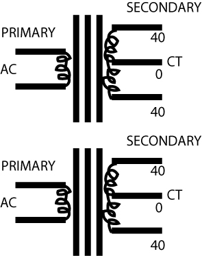

I have two 40-0-40 transformers, so how i connect two transformers in series to work h900?
see the image.
pls draw and show.
thanks.

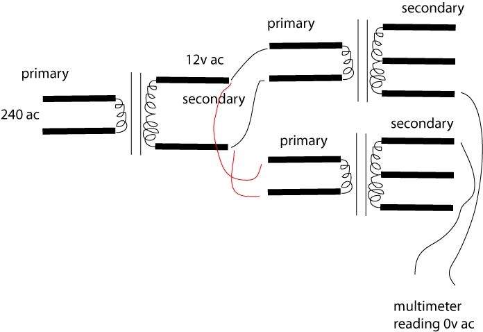

make sure you get the phasing correctly....
you can connect the secondaries in series as angel said.....
connect that to a low voltage ac source, say a 12 volts and then when paralleling the primaries, connect one side together, measure the voltage on the free ends, it should be zero, otherwise reverse the leads and then you can finalize the connections...
make sure to mark the ends of the leads so you know which goes to where...
is this method correct tony.
