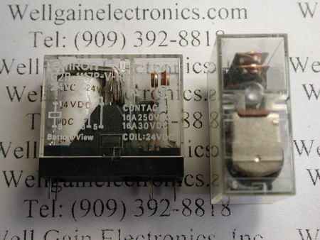

hi andrewlebon,
chestap said there are two type of relays can use.
can u give the relay information of both relays and how many pins,.
other question is can i use black relay for h900 protect board and if u can give pin details to board.
thanks
thanks
Naz,
note both example relays are rated to 30Vdc.
A high power amplifier can easily exceed 30Vdc in fault condition.

relay
hi nazirdigi
greetings well for h900 protect pcb the first relay the transparent one
but the relay pins should match pcb no use buying a relay and later find out
its pin do not coincide with pcb holes take the pcb and see if relay pins fit pcb
1 please follow SIR ANDREW T advice VOLTAGE AND CURRENT CAPACITY OF RELAY
warm regards
andrew lebon

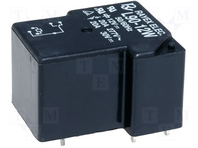

thanks for reply andrew t and andrewlebon,
i know h900 protect board not fit to black relay, the 16a transparent relay is very expensive, black one is cheap, can i wire h900 board to black relay?
can u show me how to wiring of h900 board to black relay pins.
if its ok black relay for h900 i can edit h900 protection board .
