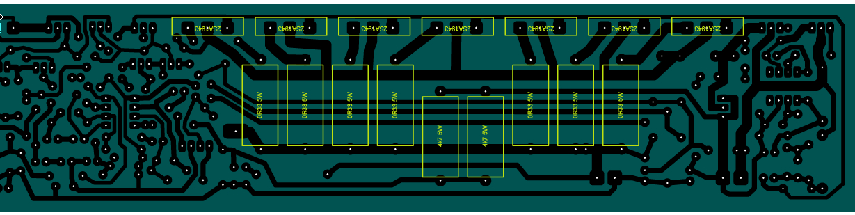

Do you have two channels (boards)? Post better pictures and some measurements.
Dear Apex, thanks for reply
yes i have two channels but i test one by one with one 750va transformer , voltage at DC side 110-56-0-56-110 , clipping found when voltage try to step to high rail(voltage measure at both fuses +/- 58v to 65 when clipping)
I use uf4007 instead of BAV21 & MUR1560 in circuit.
sorry for poor english

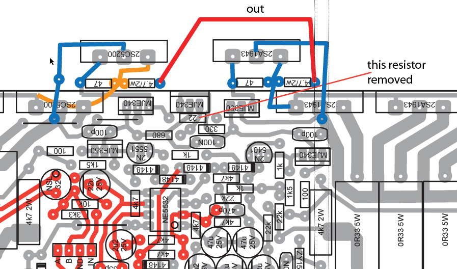

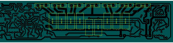

HI APEX SIR,
i edited with 7 pair. only right side finished.
pls check for errors.
i put two 4.7k/5w resistors in parralel to reduce the heat.
is it ok to drive 7 pairs with this drivers.
there is error transistor place c5200 instead a1943.
