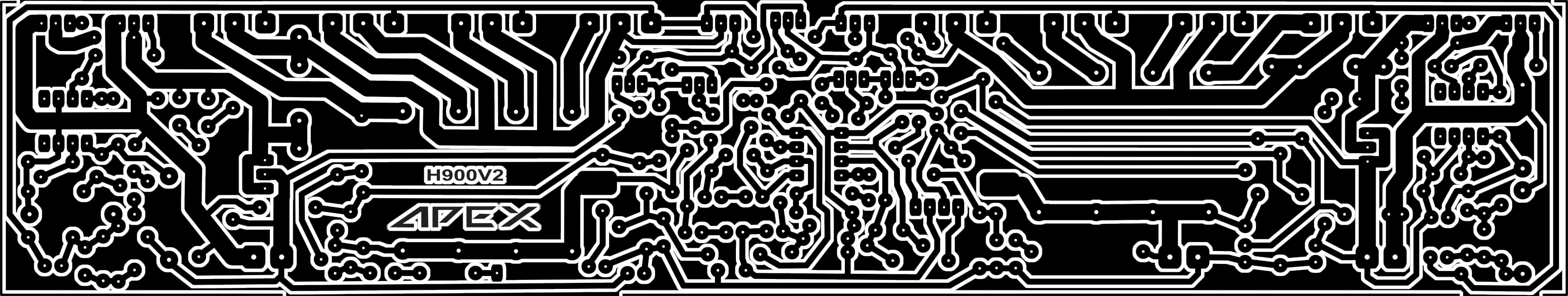

hi apex sir.
is this edited pcb correct?
so not wasting copper.
