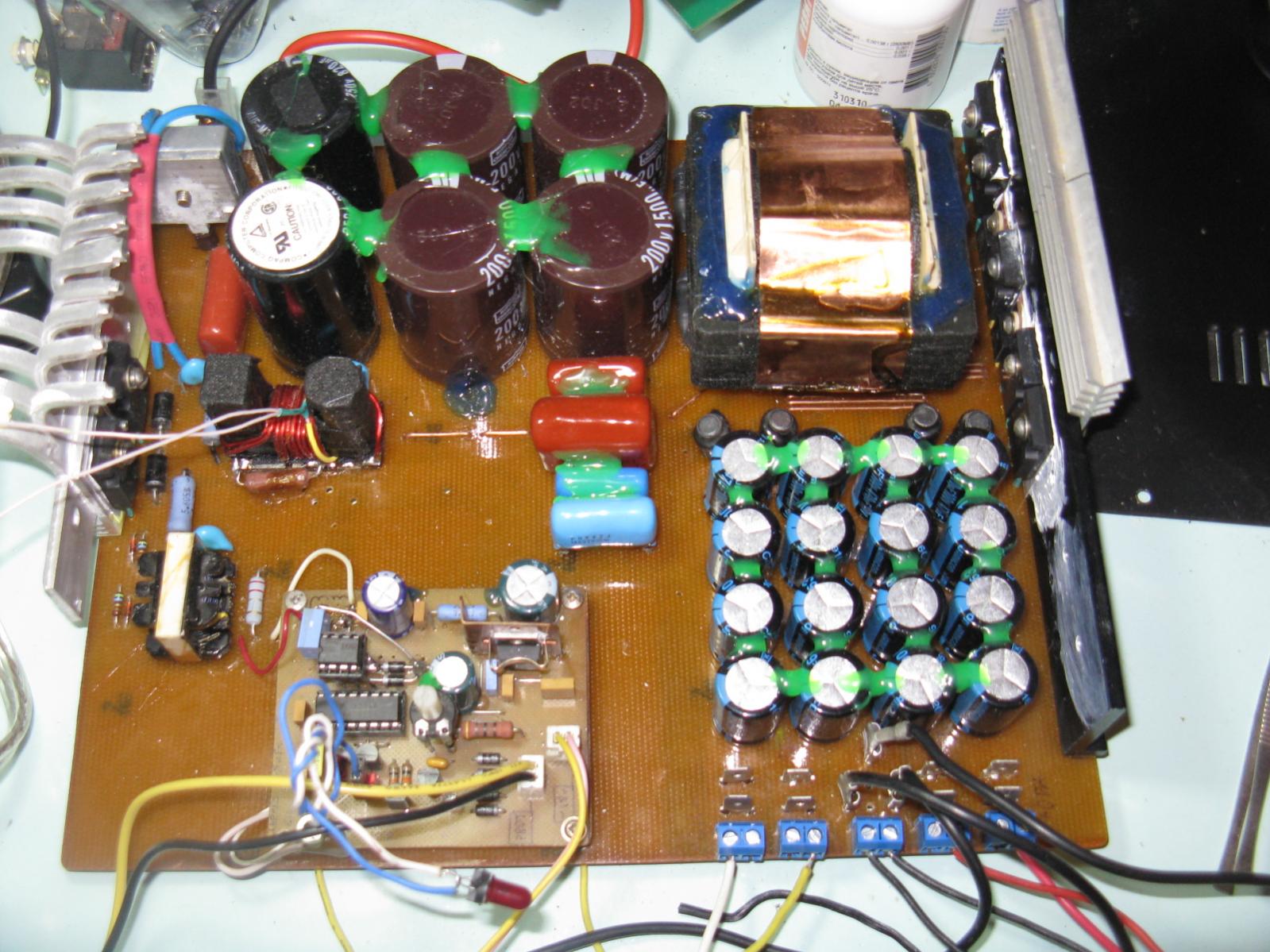

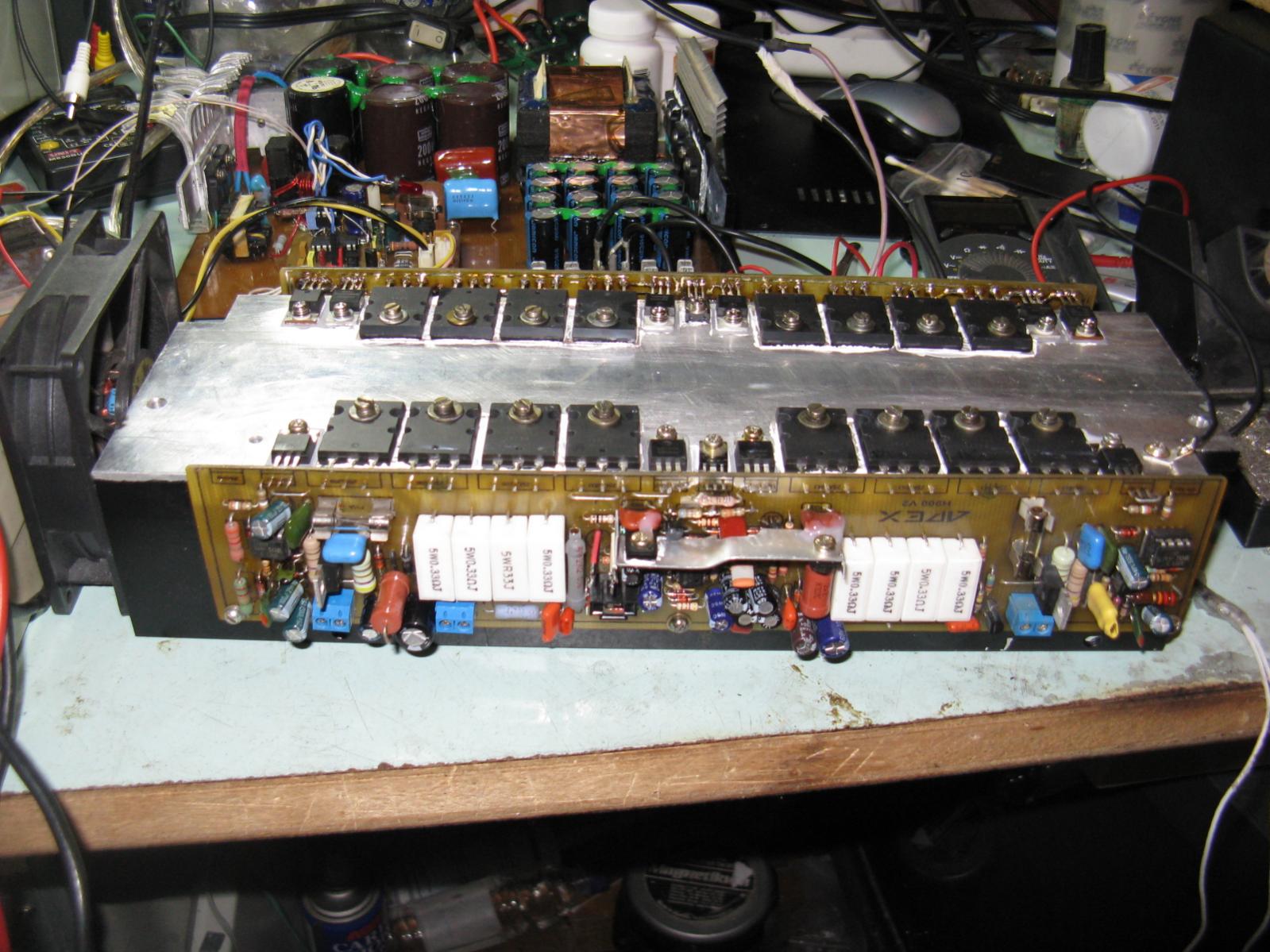

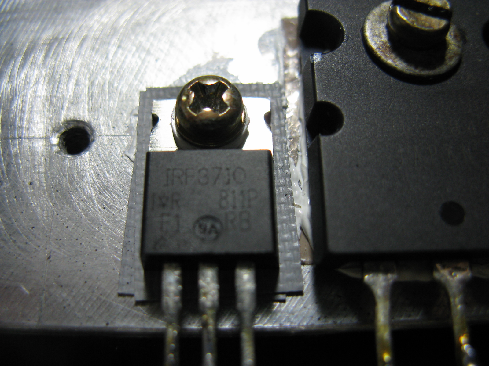

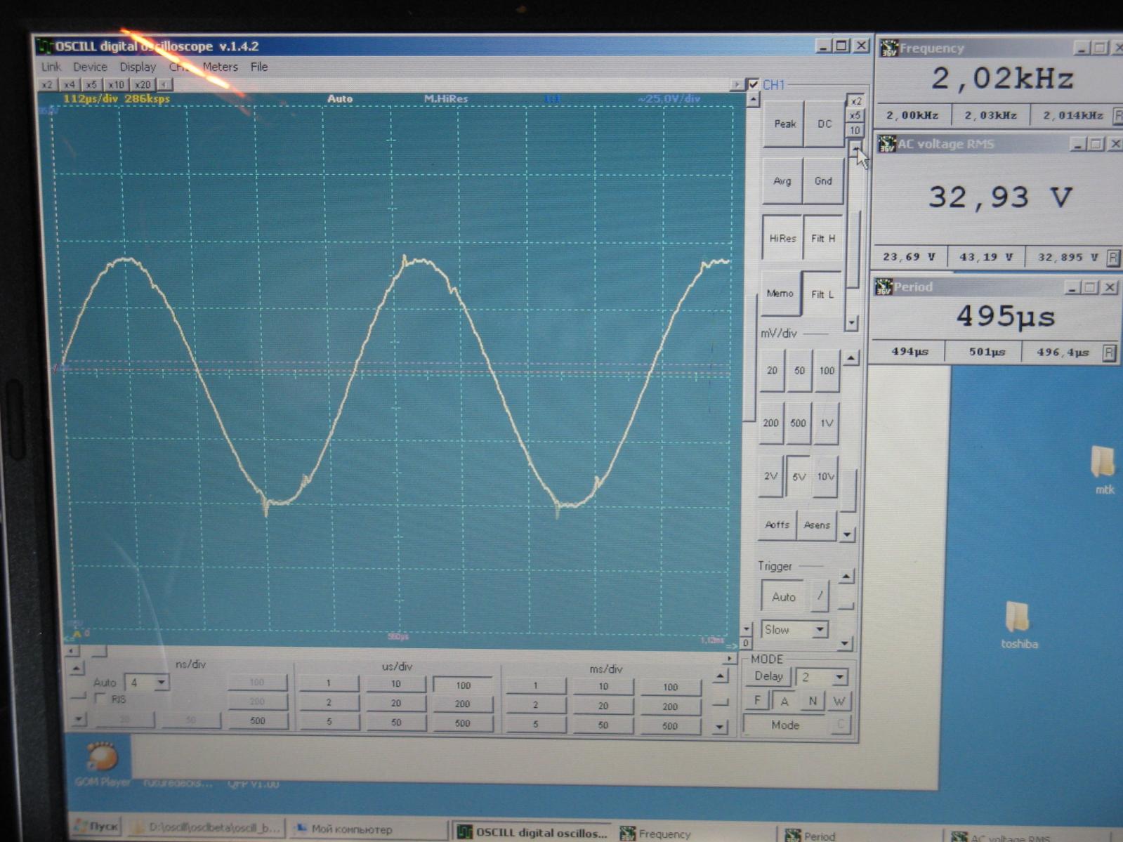

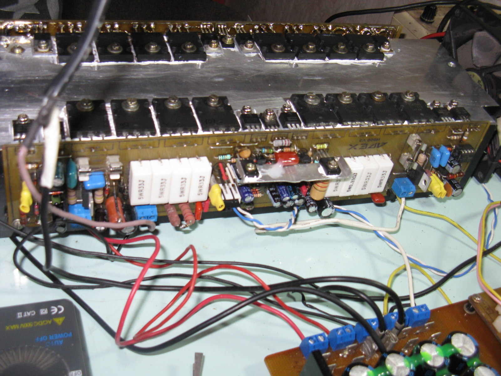

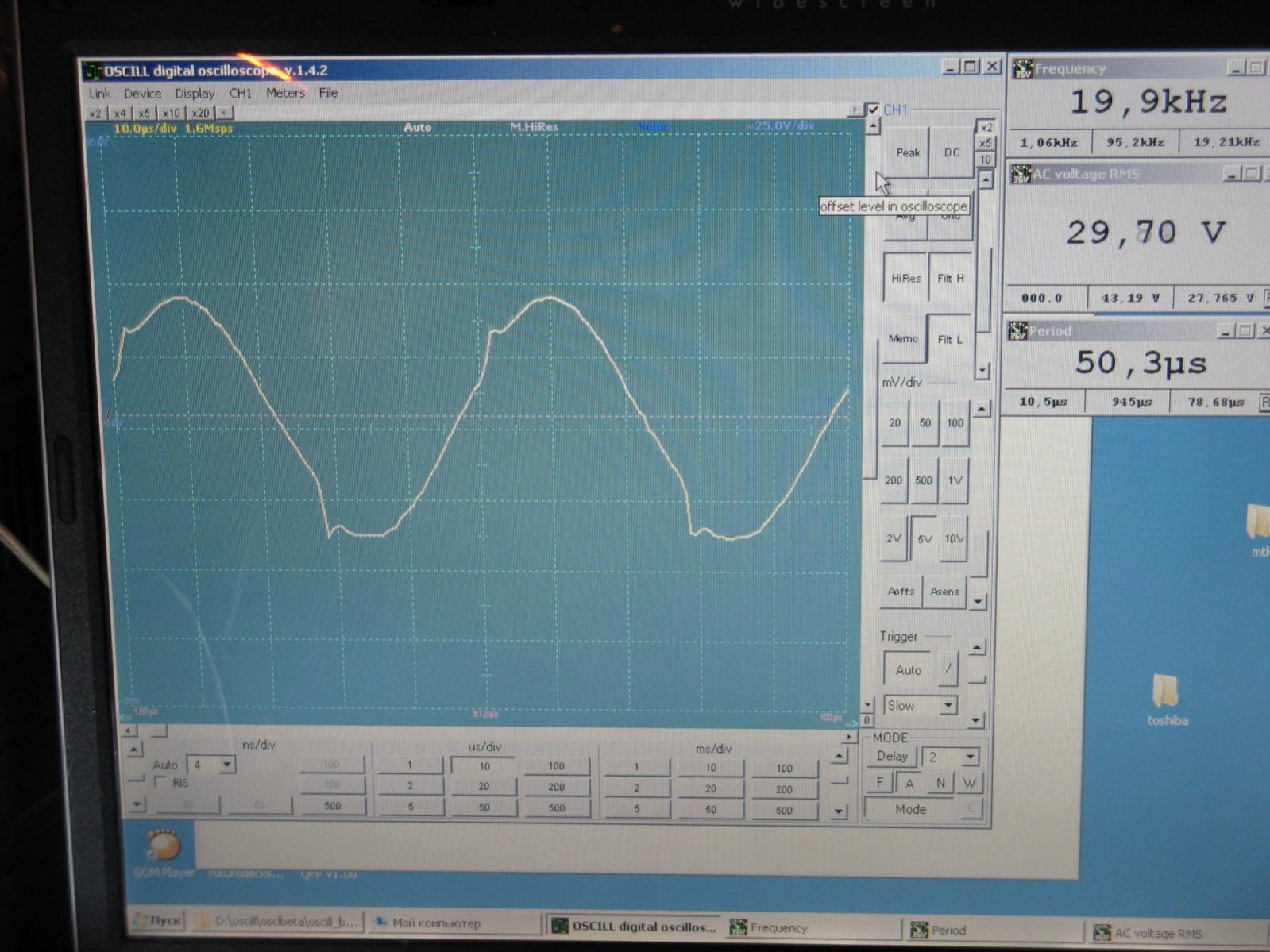

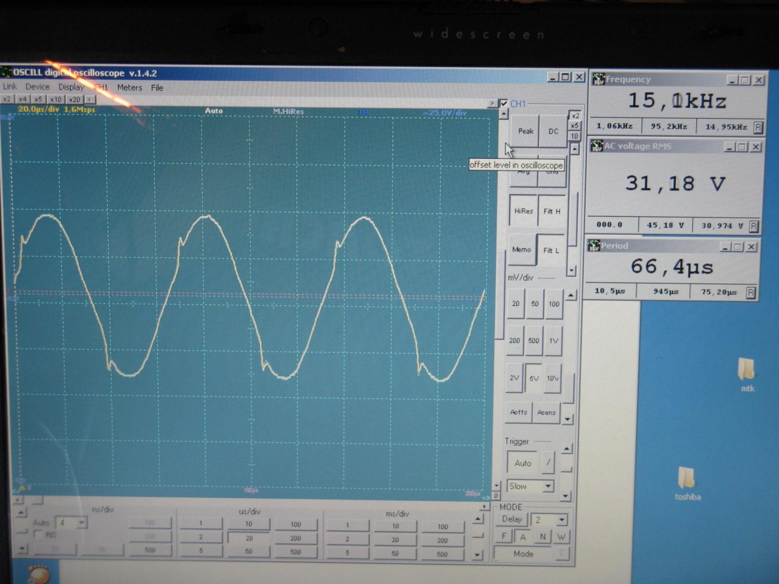

Hi everyone! I've already finished 2 module Apex h900, but there are some performance issues switcher h-class.
YouTube - Apex amplifier

Who has the waveform, I want to compare. http://www.youtube.com/watch?v=yDeoWq8Cw7s
The step driver is not good. what step driver that you used TL071?
Step driver its ir2117.
