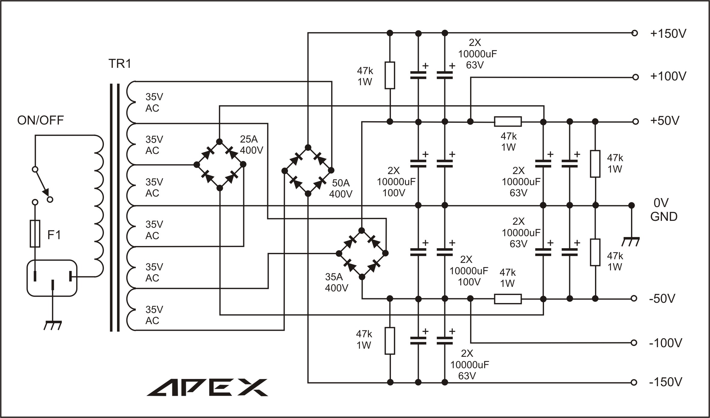

Vertex PSU
this was posted by Apex Vertex Power Supply
I'm interested in this Nmos design
Sorry, I dont know cant help you, dont have built H900, ask APEX or other DIYer
I can only say,.... very satisfied with NMOS amp its a really performer and bass like earthquake

Hello! Is the attached schematic works, or is it only work-in-progress? Do you have PCB for it?
Thanks in advance!
yes but you have to change 2sc5200.2Sa1943 to MJL4282/4302 and ic stabilizer for ne5532...
But better ask mile for sure,,, for me i have to stick on what voltage given to the amp and change 5200/1943 to mjl then higher the amperes of the trapo..
Yes but cost will increase for MJL4282/4302 x 4 /pcs.
have seen a lot of commercial amps... 150 - 170 V DC and 3 Step Class H with 5200/1943
and have seen commercial class AB amp 145 V DC and 5200/1943 output devices
well im not an expert im just DIYER it's up to you if you push it too hard,,it's not big problem ..all i just want is the safety margin of those trannies

Do you think the H900 will work of Dc 136 68 0 68 136 or there is any few changes?
thanks
if you want more power, then build yourself several amps.....why put all your eggs in one basket....
if your one big amp fails in the middle of a disco dance, then that would be a shame...
otoh, the chances of several amps failing all at once is very slim....
i have received several inquiries about modding amps to use higher rails.....and for me, this is one practice i would like to discourage.....😀
