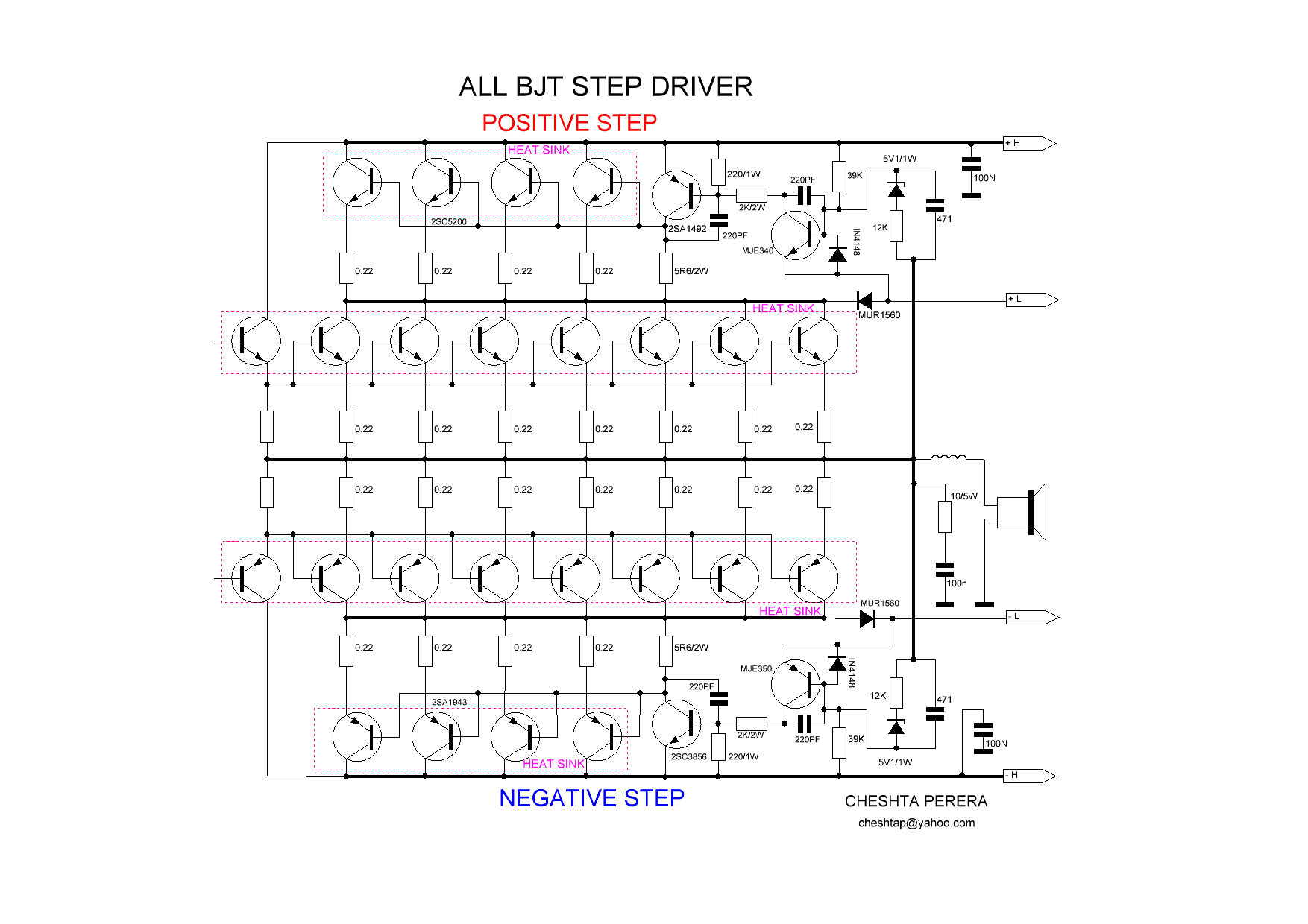

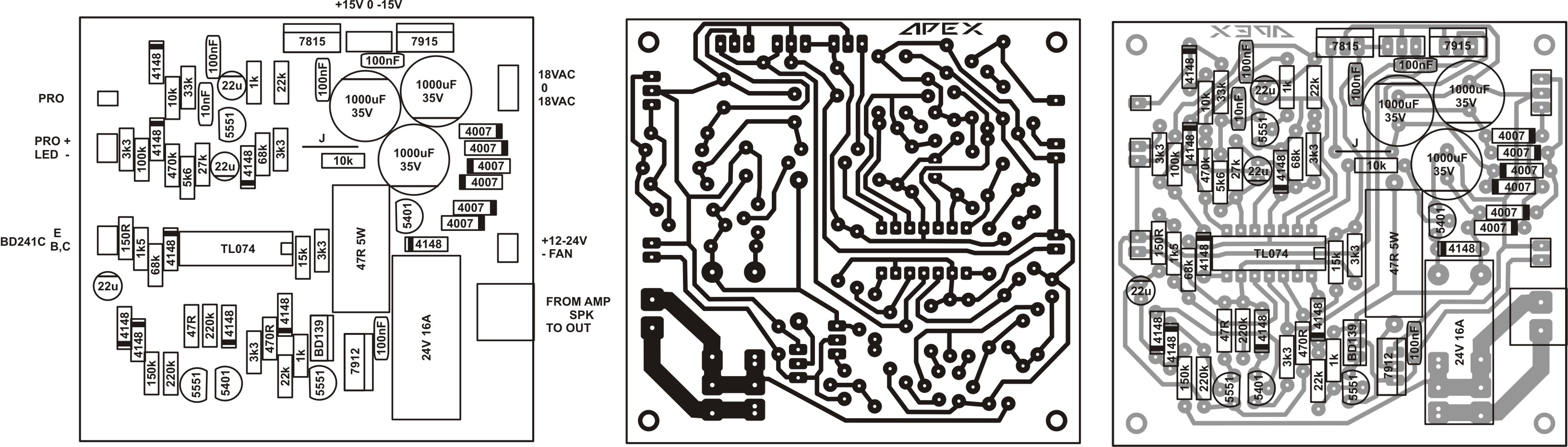

check this schematic

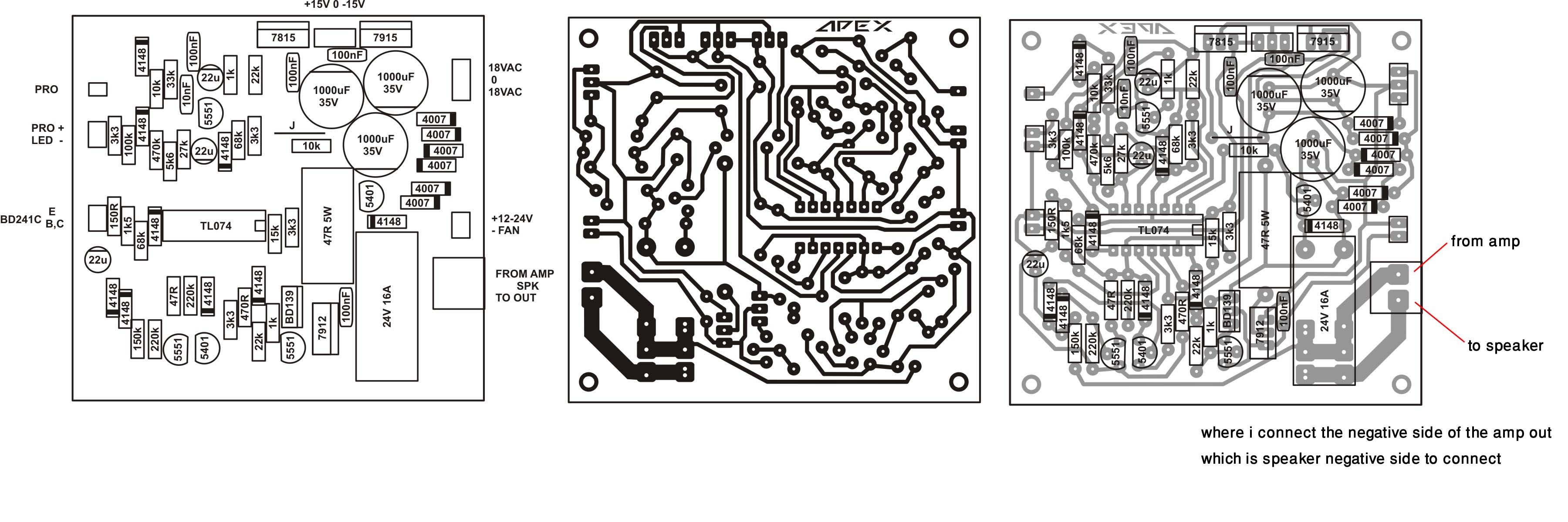

Dear nazridi
1. +/-15V for external use not necessary to connect only connect 18-0-18 AC for protect circuit supply.
2. connect 24 VDC fan
3. amps speaker + o/p connect to 'FROM AMP' side & 'TO OUT' connect direct to speaker + connector. Leave the negative ,it should be connect directly from amps negative.
Dear nazridi
thanks for reply mkubawat.
i didn't understand, can u check the image, is it correct?
