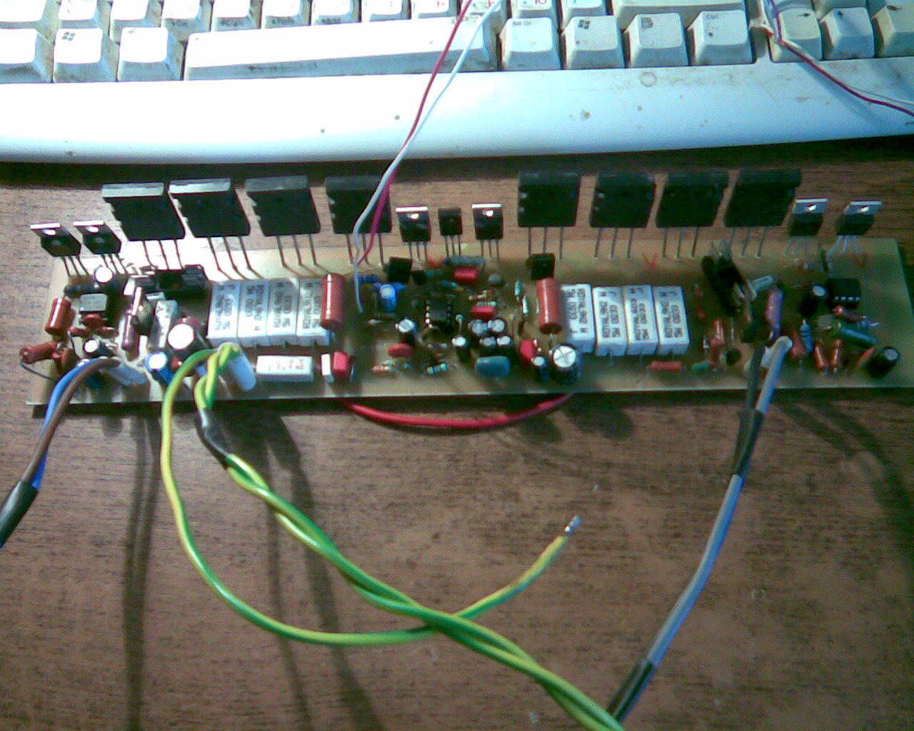

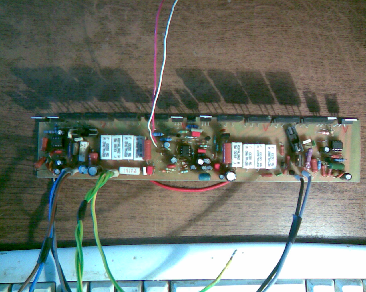

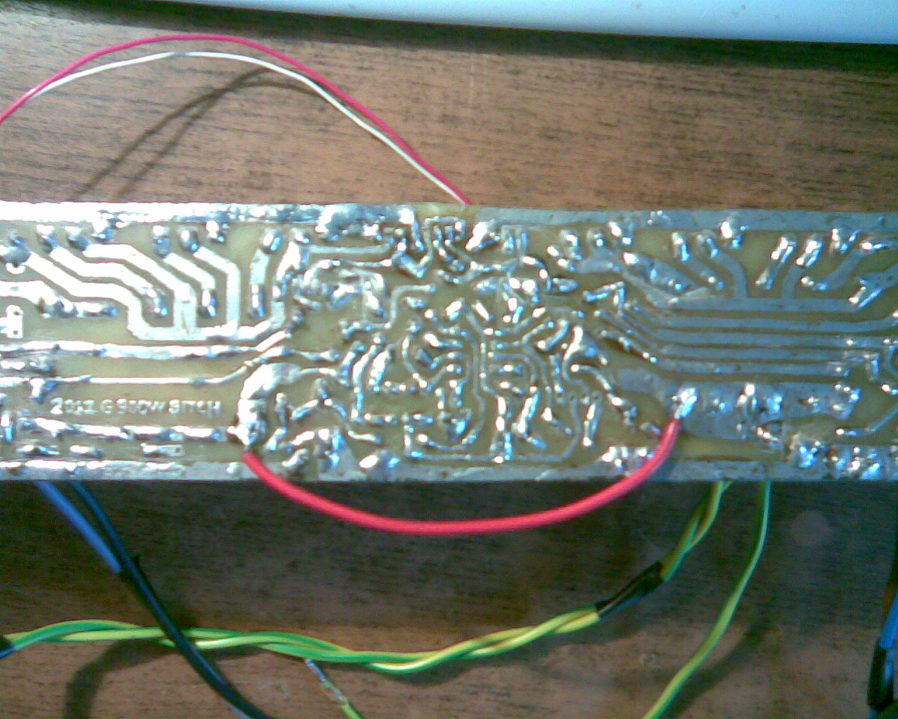

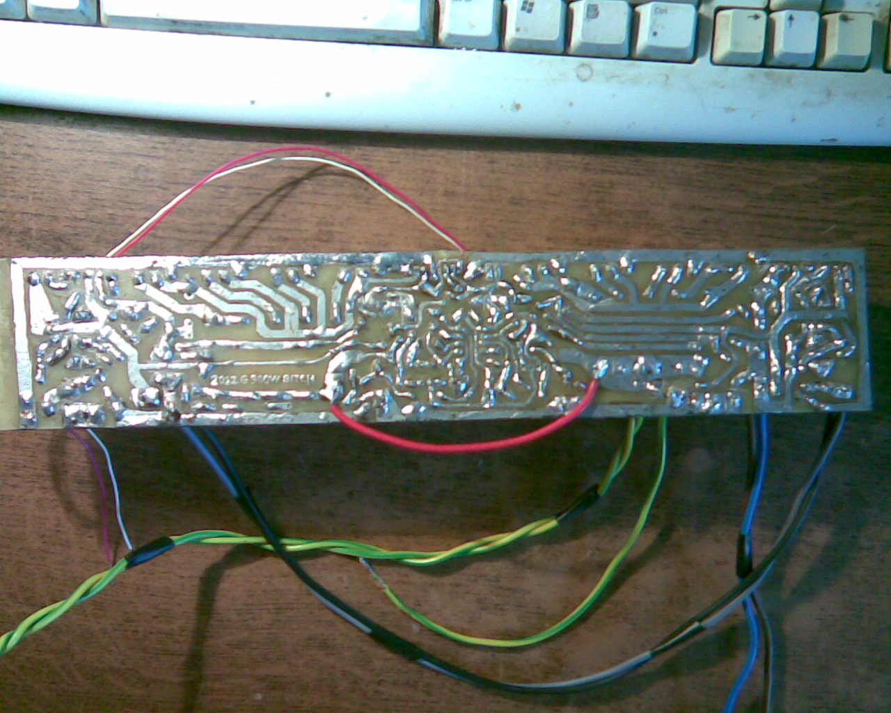

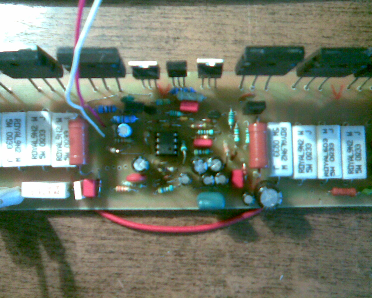

Hi could someone direct me to solution, I have checked the pcb for error found none, double checked everything, voltages on bias are good, 1.8v on collector-emitter on bias transistor and so on, but when i switch the device on from the start everything fine, even the waveform comes ut just as nice but then when i make the input signal higher like some 0.7v sine wave about 1khz the output trannies just get opened and fail with sparks and smoke, basically what i am dealing with is that the base voltage of the output trannies just suddenly gets high and opens them and they just blow, takin sometimes some irfs and the driver transistors mje 15033 and 34 with them. Could someone give me some advise?

Use 150R/10W resistor instead primary fuse for test amp, and post pictures...

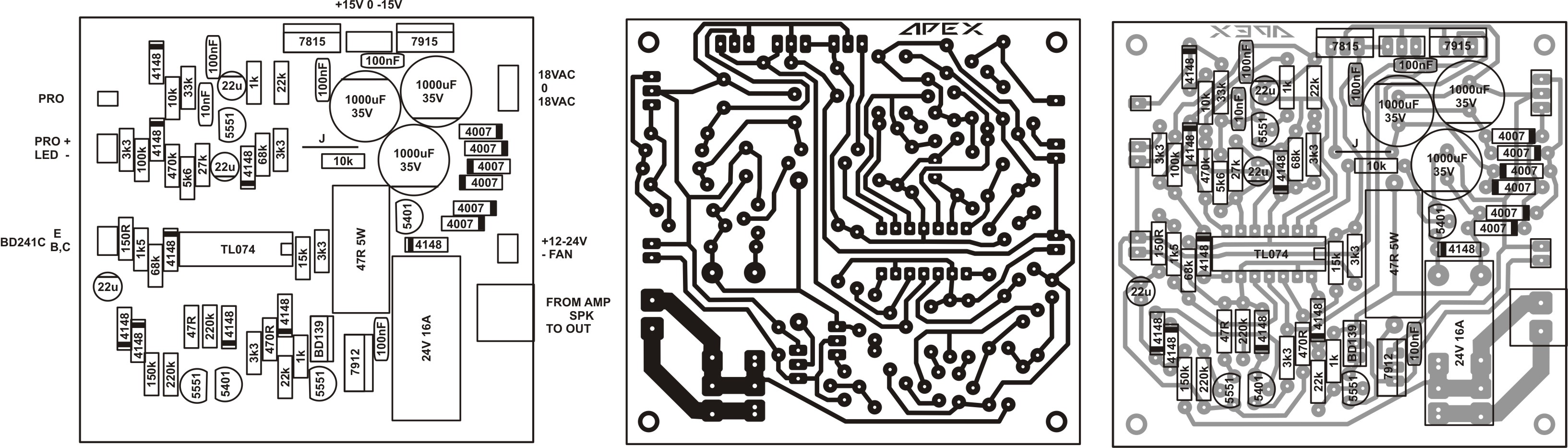

Sorry for the bad picture quality itš from a mobile phone.
Hope you can see if there is something wrong in the pictures with my pcb 🙂🙂
Thanks for help in advance.

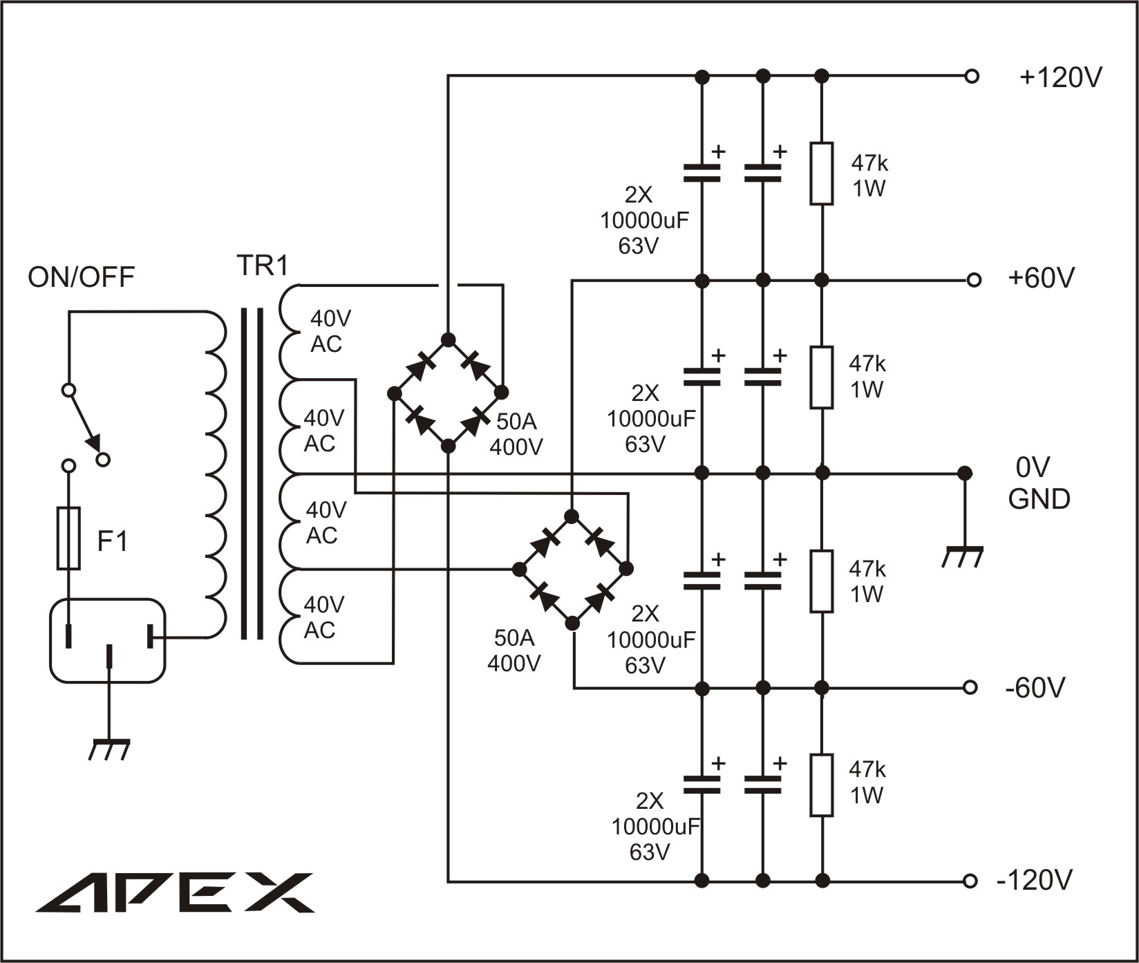

plz.... send me h900 psu measurement........... & any speacker protection ckt...............

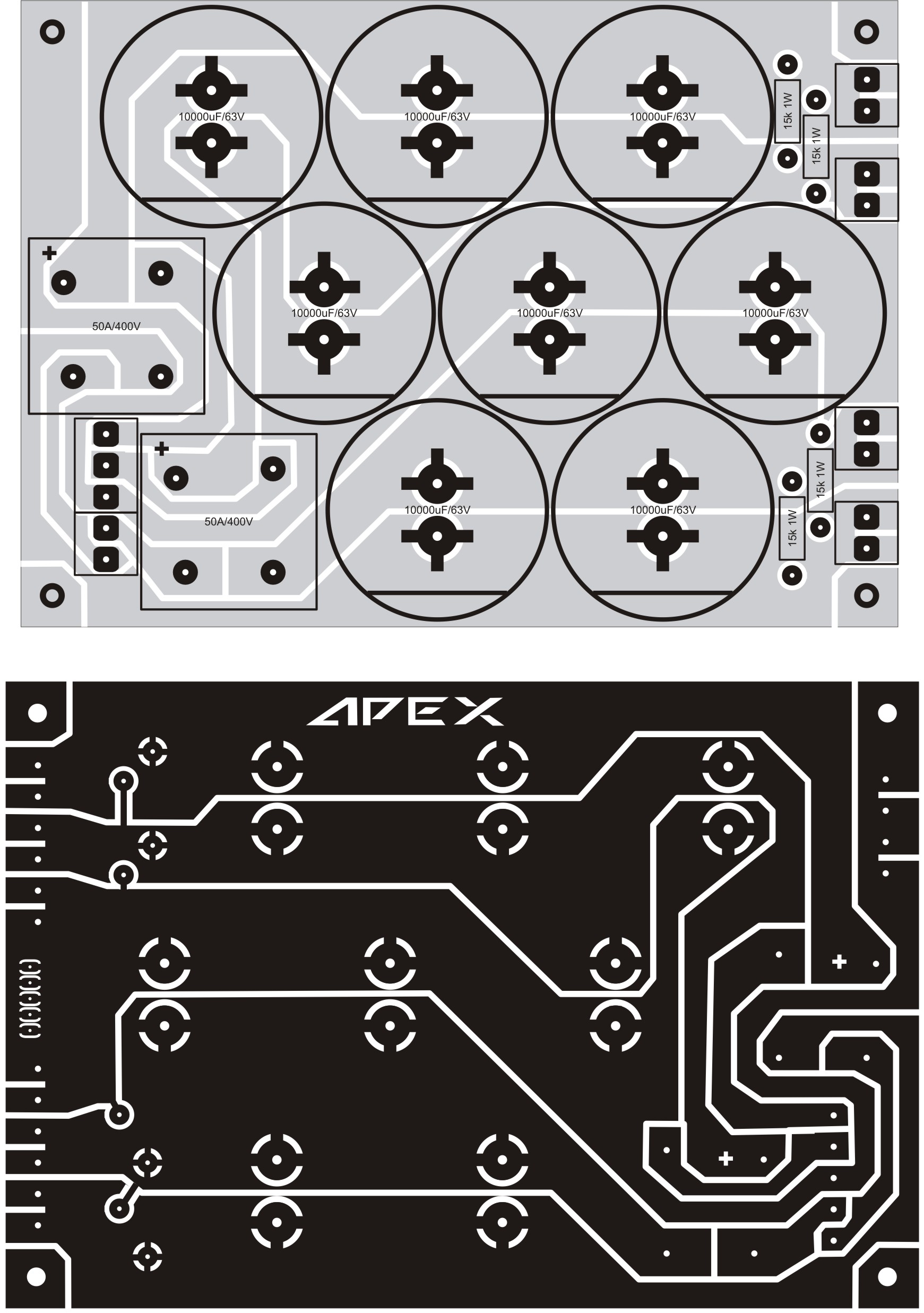

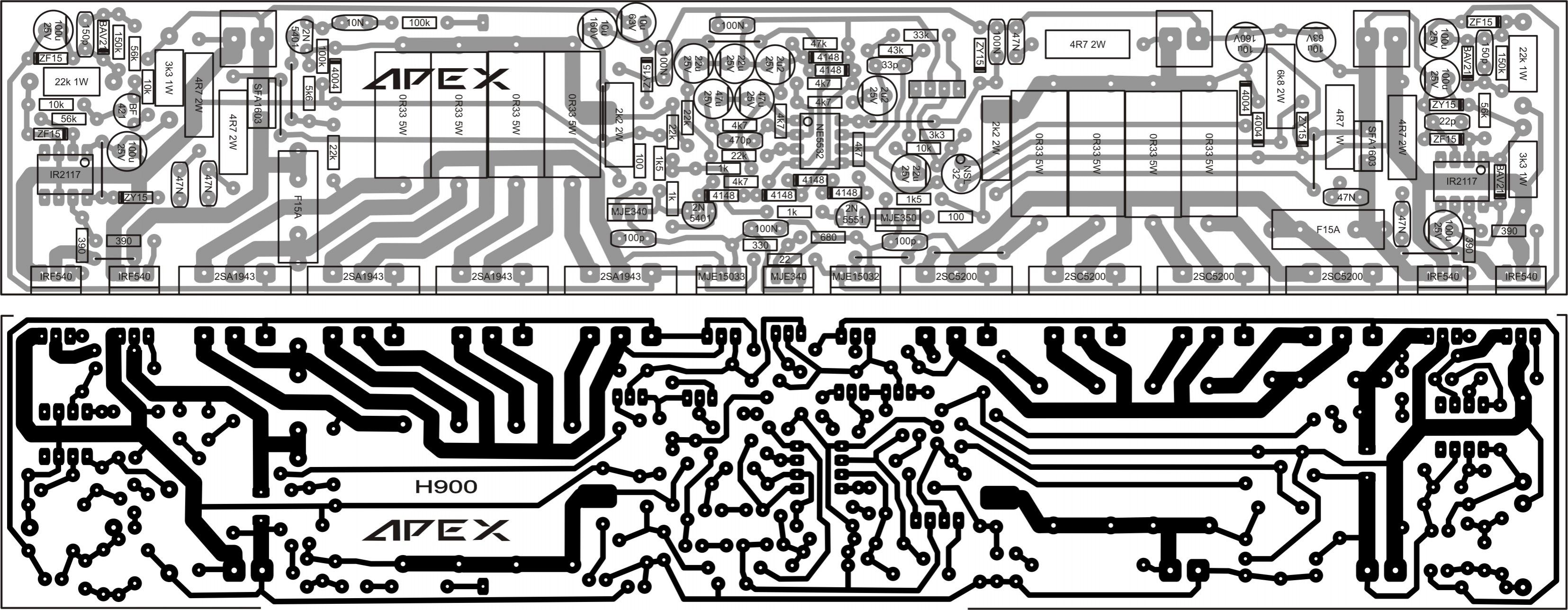

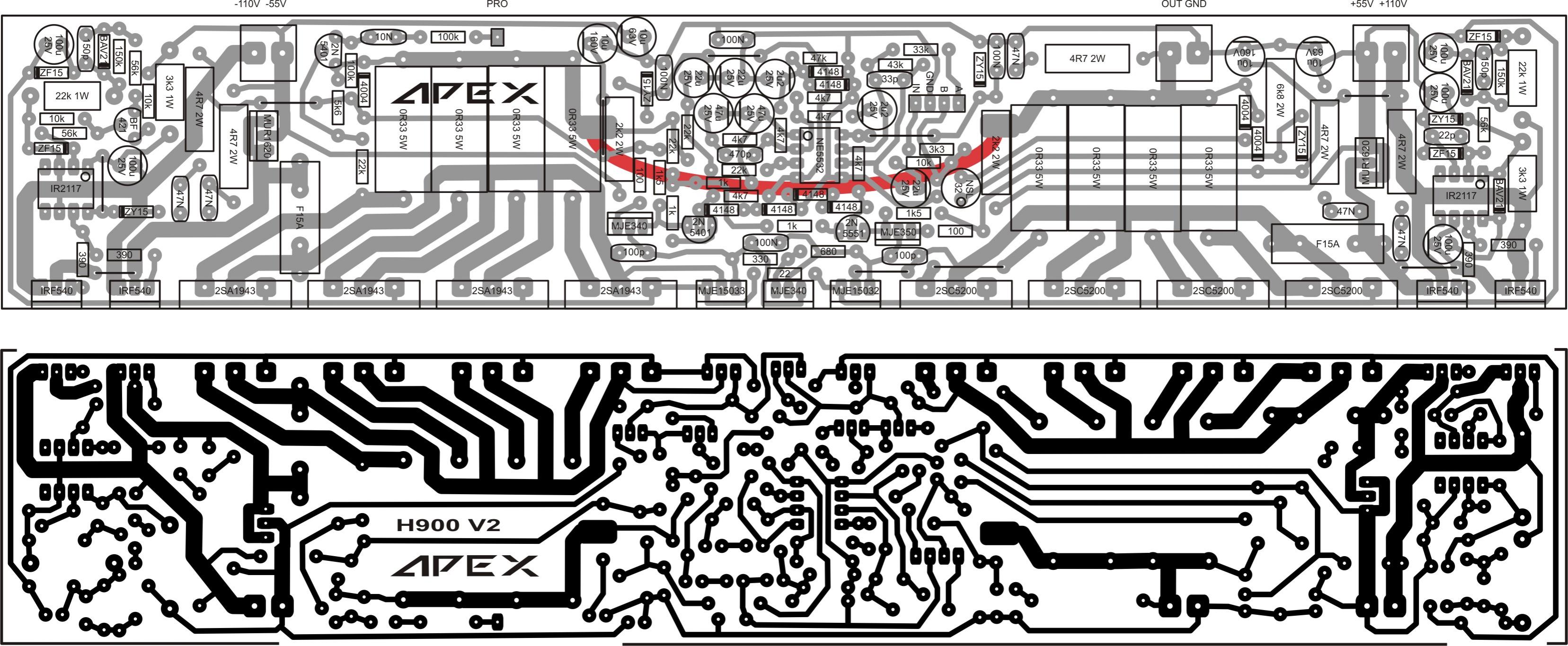

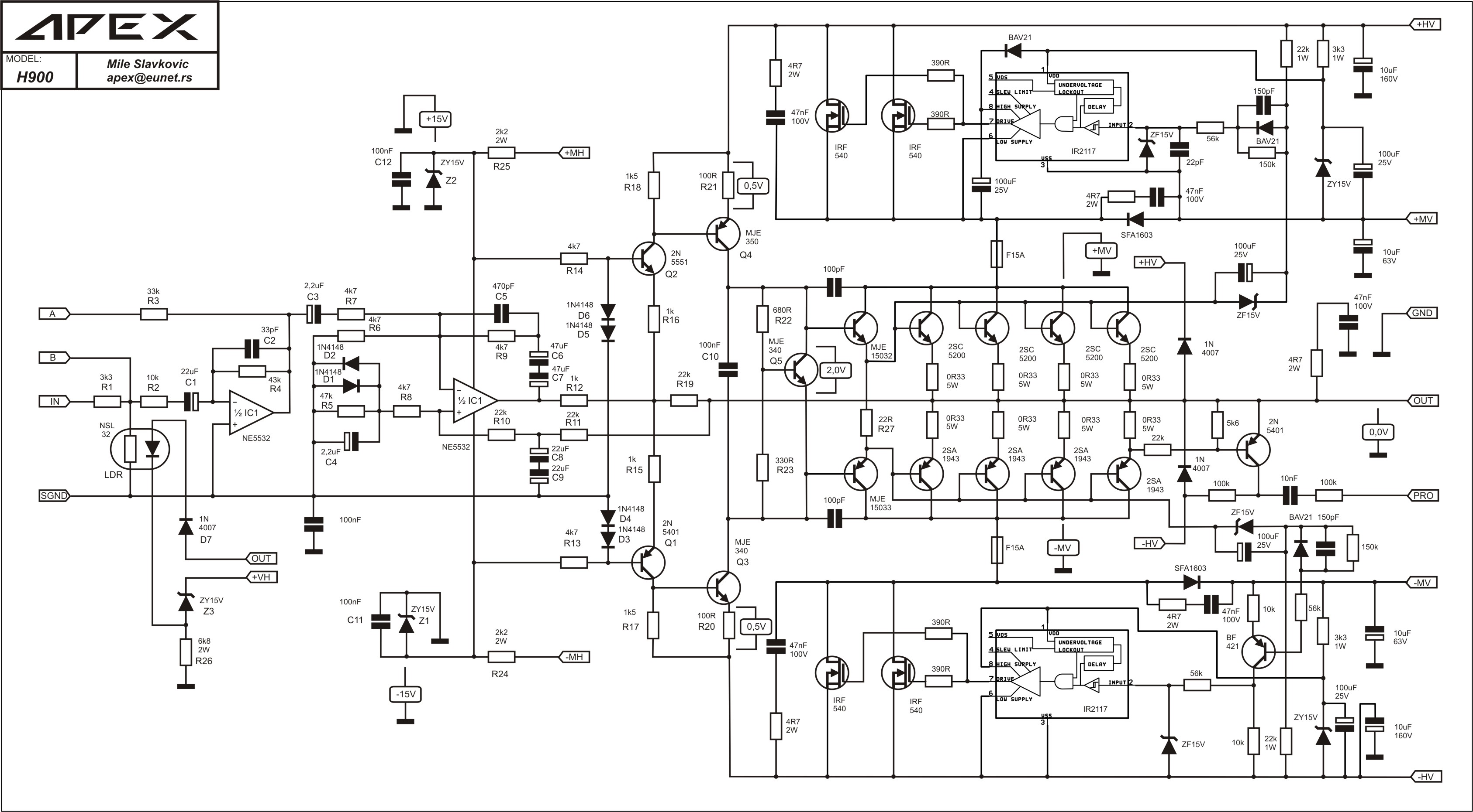

Input gnd must be connect to psu gnd... post picture with input wireing.

I have input gnd connected to psu gnd only you can't see it here because the pcb is taken out of the box where the powersupply is mounted.
That isn't the problem.
Maybe you have some other thoughts on what could be wrong.
Thanks in advance Sir Apex.

hello sir apex cam i use MPSA42 instead of BF421? and also can i use FMGX12 instead of SFA1603 thanksInput gnd must be connect to psu gnd... post picture with input wireing.
Regads
thanks very much...and once question again..can I use 1n4148 in series to replaced BAV21..Yes and use 8 pairs of outputs.
hello sir apex i had allready finish my project h900, my rail voltage is 66 47 0 47 66vdc, offset .4v, idling .7v, sounds very nice, but my problem is Mv- 47 cannot inter the diode sfa1603 going to collector of 2sa1943, it takes supply from hv-66, so the other side is -66 collector, and the other side is +47 collector not balance and very hot after 1 song, what would be the problemInput gnd must be connect to psu gnd... post picture with input wireing.
