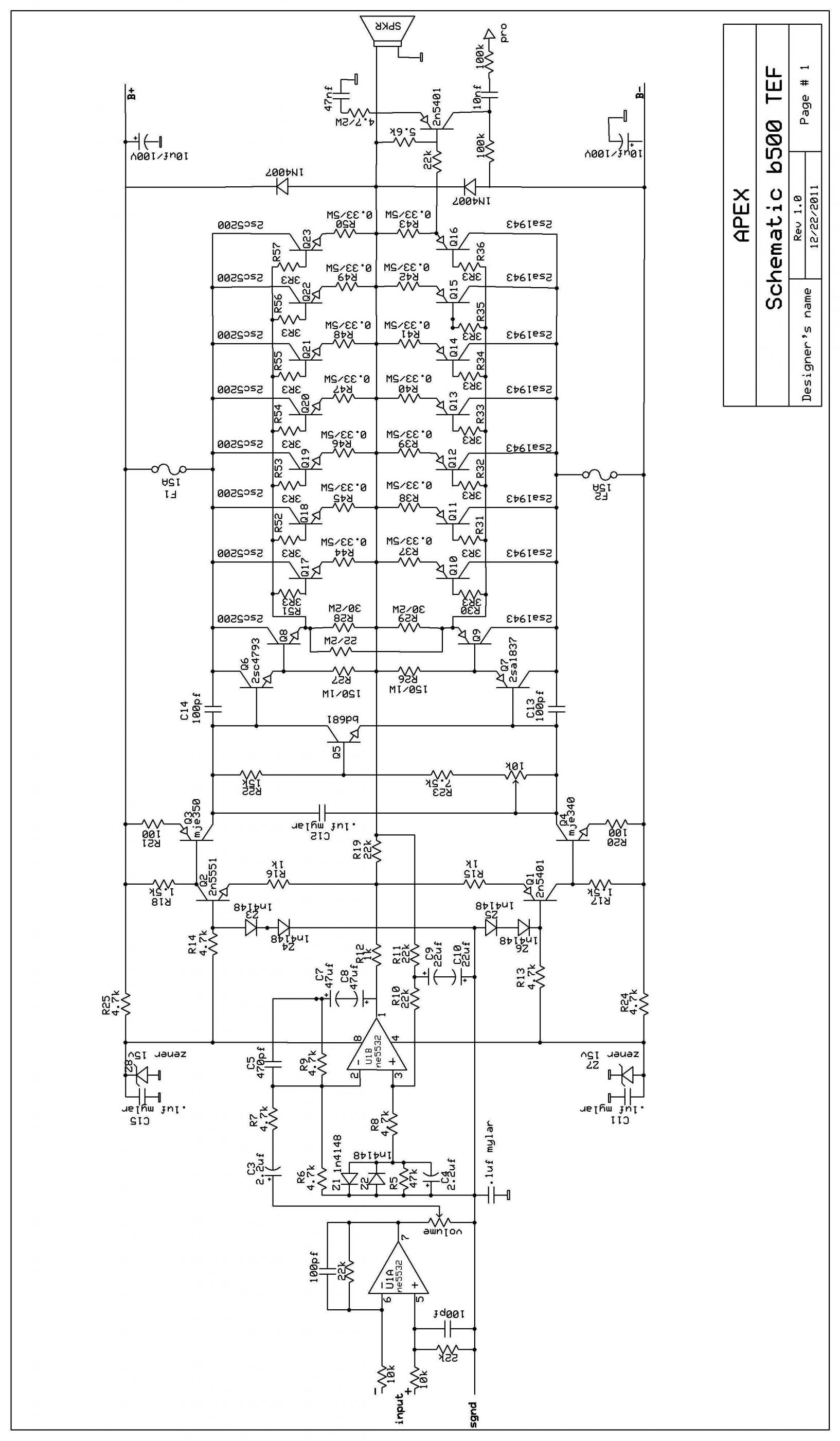

thanks for the reply sir,
is this correct for triple darlington?
what is the emmiter resistor bias voltage?
It's correct, set 5-10mV on the emmiter resistors.

schematic of b500 tef use for reference to h900 tef add limiter as per sir miles this schematic is correct according to sir miles

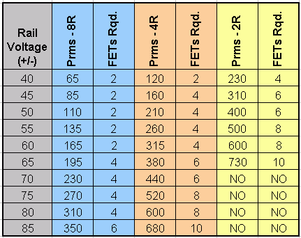

Hi apex
thanks for H900 design..
can you prepare some table like the ones I attached ? that is for quasi nmos350 + (power rating of transformer and obviously lines current).

B500 and H900 use OP amp for DC servo, no need to adjust DC offset.
