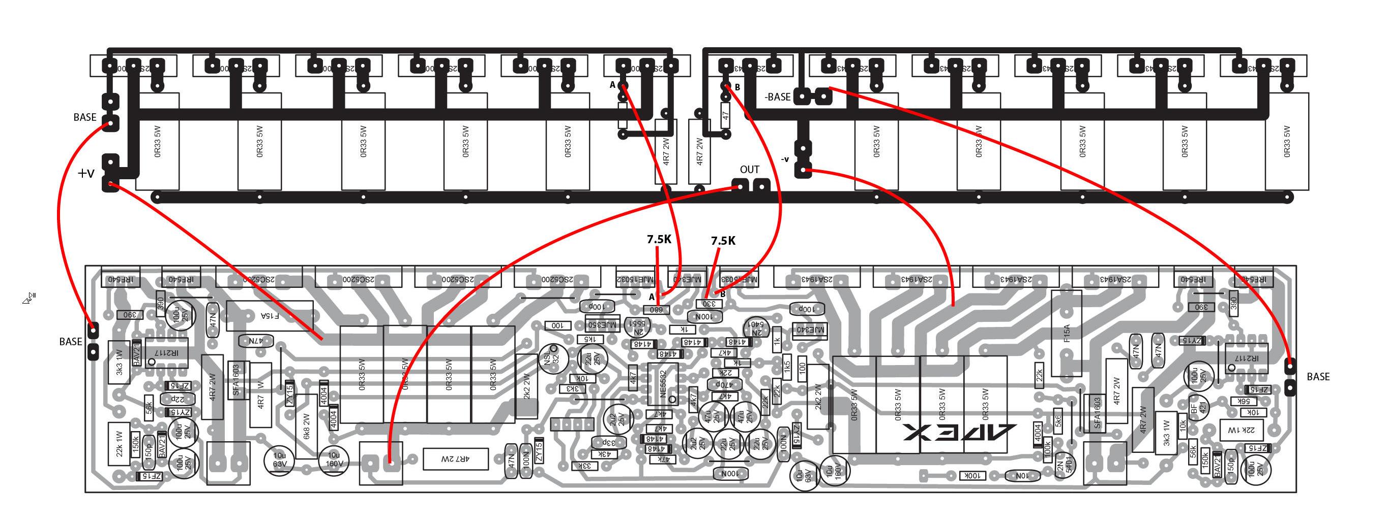

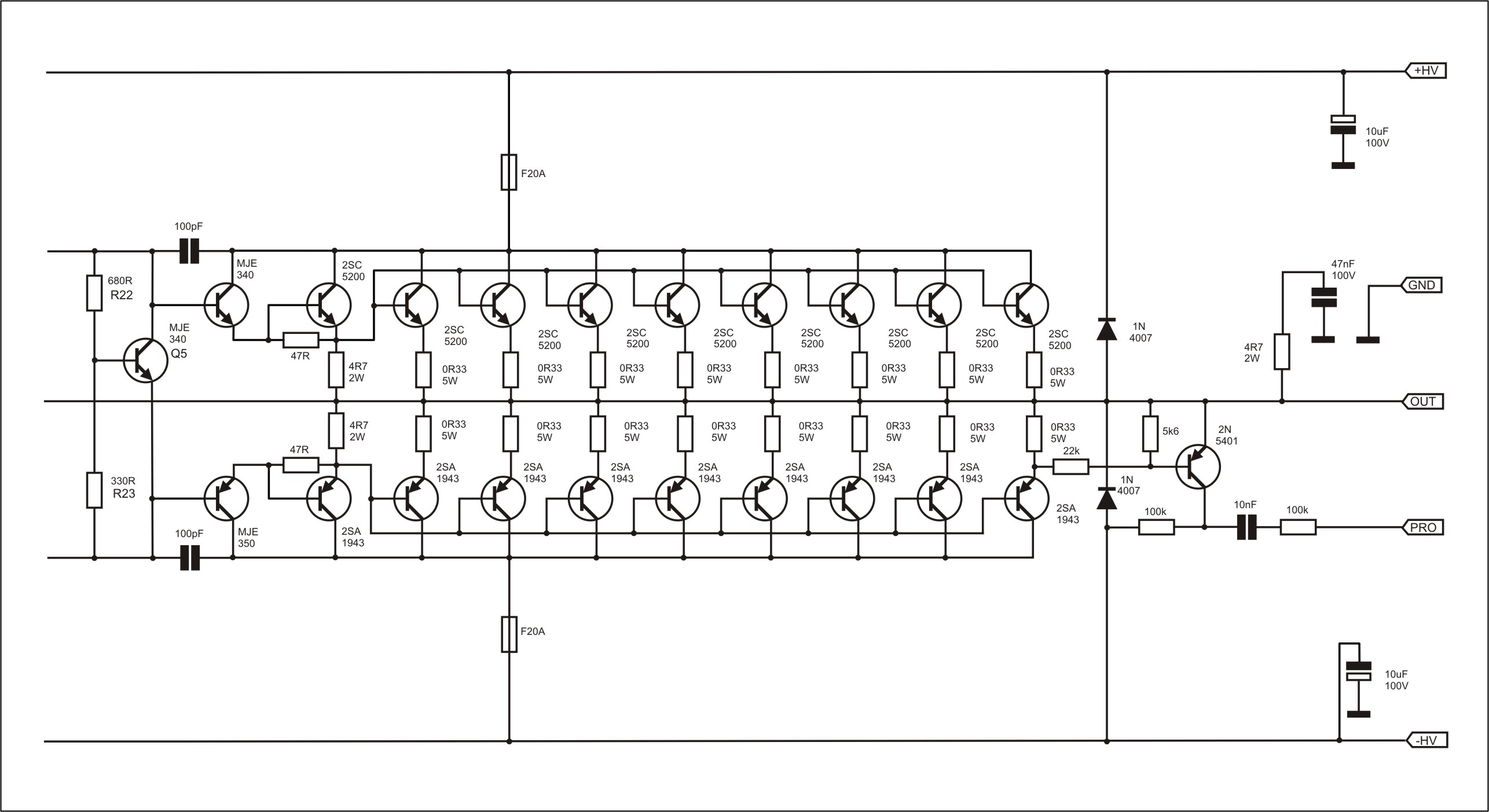

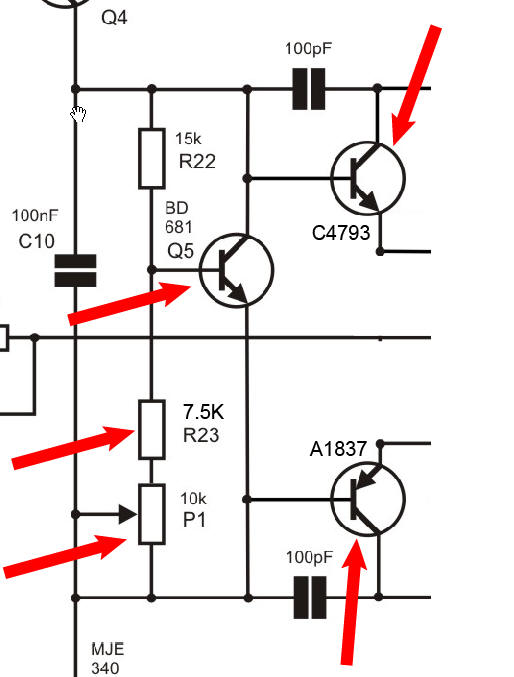

hi apex sir,
i already asked some questions from u in h900 thread, but u didn't reply, pls reply to this.
which schematic h900 triple darlington u suggest for PA, with the bias pot 10k or 1k pot or without pot.
and r23 7.5k, can u share the correct schematic, i know u already shared that, but i dont know which post is that.

Use 1k pot (or without pot) with MJE340 for Q5 (Vbe multiplayer bias transistor). 10k pot use with darlington for Q5 (like BD681...) i dont know which post is thats schematics.
