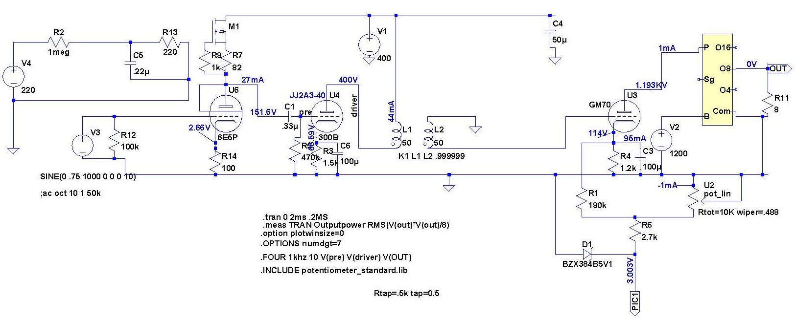

I have made before two amps with 6e5p ccs low Z driving the 6c33 and other driving the 211, but the 2a3 driving the 211 is too much better. The space felling is wonderful.

How did you couple the 2A3?
I tried it several ways but ended up with a Monolith Mag. IT transformer, it was far better than RC or LC coupling
I coupled many times the 6e5p 30mA ( triode ) by CCS low Z to 211 or 6c33, I though if 6e5p can why not the 2a3 at 45mA, in my opinion the 2a3 give a big extra sound to 211, only that 2a3C is a little microphonic ( very big glass) I have ordered the Psvane 2a3b ( small glass) to check witch one is better.
By cap ( Audyn Copper ) from CCS low z.
Try an IT if you have one handy, a Hammond 126 will do better than a cap in this scenario but you'll have to lower the operating load (which isn't a bad thing) a bit so it doesn't saturate. A plate choke will also do better than a cap as well. In order of preference- IT, Choke, Cap
Unless your doing a CCS on the 2A3? I'm having a little trouble interpreting your topology.
Here is the driver circuit I am using now. I posted it awhile back but under a different title.

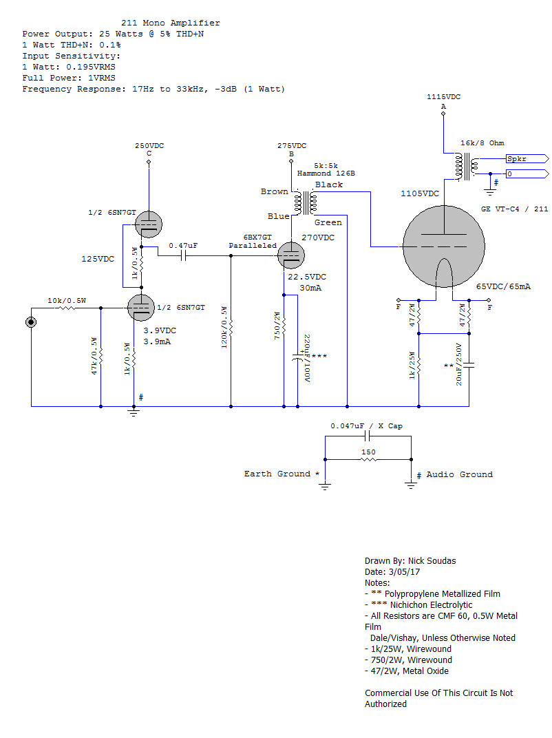

Attached are the current circuits for the interstage version of the 211 amp.
The 211 definitely likes an interstage transformer.
Not have space for more transformer :) and cap sound very good,
