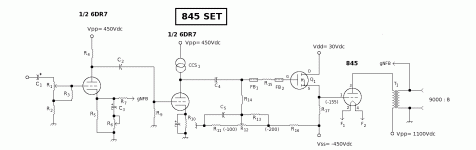

Here's a preliminary design I'm working on that makes use of the 845.
This one uses the 6DR7, a dissimilar dual triode for use as a vertical deflection oscillator/amp. The small signal half is a high-u triode that gives a decent gain margin for this. The large signal section can stand up to the high voltages that the large input swing (310Vp-p) that the 845 requires. Active plate loading here maximizes the output swing and linearity.
These DHTs have a nasty habit of pulling grid current even before Vgk actually swings positive. To handle that, and also source the current needed to charge up Cgk + Cmiller + Cstray, as well as handle the occasional transient clip, use a source follower as a grid driver.

Stay away from a driver that is RC coupled to the 845 / 211. An IT or cathode follower driver will provide sufficient drive for the output tube. Sounds much better.

3.2K is low for an 845. It likes to see an OT of around 7K ohms. 16K ohms is good for the 211. Higher OPT impedence reduces output power only slightly and it reduces distortion quite a bit. It also increases damping factor. Both of these things are good.
If you are doing this single ended you will have problems with filament hum on the big triodes. Getting a low noise filament supply will take some doing.

Thanks for all the reply's.
I am not necessarily against mixing different technologies, but would like to stay all tube based for this experiment. No problem with hum from my 211 / 845 DHT amps, just have to have a good (beefy) filament x-former, good caps and a decent DC circuit.
I am working my way up to using other tubes for the final driver, but wanted to start off with basic tubes and see (and hear) the results . Circuit 2 is driving the 845 as is referenced in the RCA 845 data sheet, except the x-former is supposed to be 3.4k. Extrapolating the data for the plate voltage and bias points I used, 19.5 watts RMS is right on target using the low impedance OPT.
Yes, more primary impedance is better, but I wanted to verify the Chinese 845 operating points by using this configuration. Seems like the Chinese 845 are close to the originals as we all have suspected. Not a bad tube for the money.
At 1 watt, the 845 output THD (with driver circuit 2) is only 0.2%. Not bad for a couple of common octal tubes.
