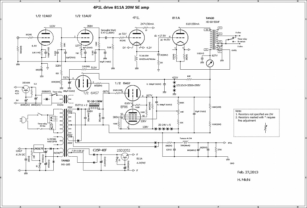

Revised 811A SE amp employing 4P1L driver
I re-built (trial) the third version of 811ASE amp employing 4P1L choke-loaded cathode follower (capable to drive even to minus region without minus DC) replacing conventional regulator tube driving (CF+CCS) method, and have got excellent result in the sound quality as well as its measured figures. 4P1L is running under almost maximum dissipation level. I hear the sound is quiet and better in bass response while keeping brilliant high range. Maximum output is 20W which is the same as the predecessor. The distortion level is considerably lower; 1.6% at 20W, 0.68% at 10W and 0.032% at 1W. The frequency response measured is; -1.0 db at 20Hz and -3.1 db at 100 KHz and the dumping factor is 1.9.
Additionally, I tried to separate PSU; a) for output power stage, b) for voltage amp stages by employing a 6AS7 (twin triode: one for output power stage and the other for voltage amp stages) as for HT regulators. Expected benefits are: a) lower impedance, b) separation between output stage and voltage amp stages and c) capable for gradual start up avoiding extra high voltage (friendly to capacitors).
Attached are 1) photo of the 811A SE amp (third version trial) and its schematic.

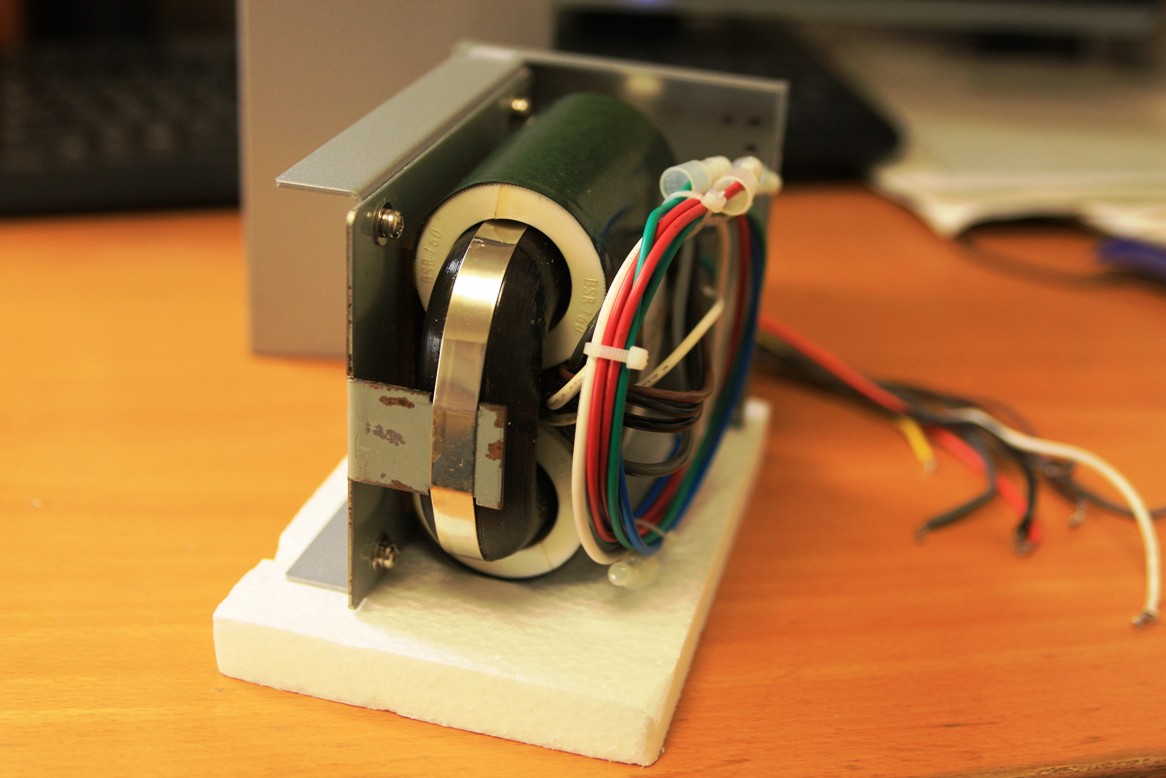

I've worked up sort of a "universal" output stage for Class A2 tubes. It works very well and lends itself to experimentation. It’s very flexible because of the parafeed design. It’s easy to change load lines by swapping out the OPT. The plate choke with cathode feedback stays in the circuit. One of the more interesting things I found while refining this idea is most transformer winders freak out when you ask for a plate choke with a 15% CFB winding. However, they are more than happy to wind you a 6.6K to 150 ohm OPT - LOL! They are one in the same.

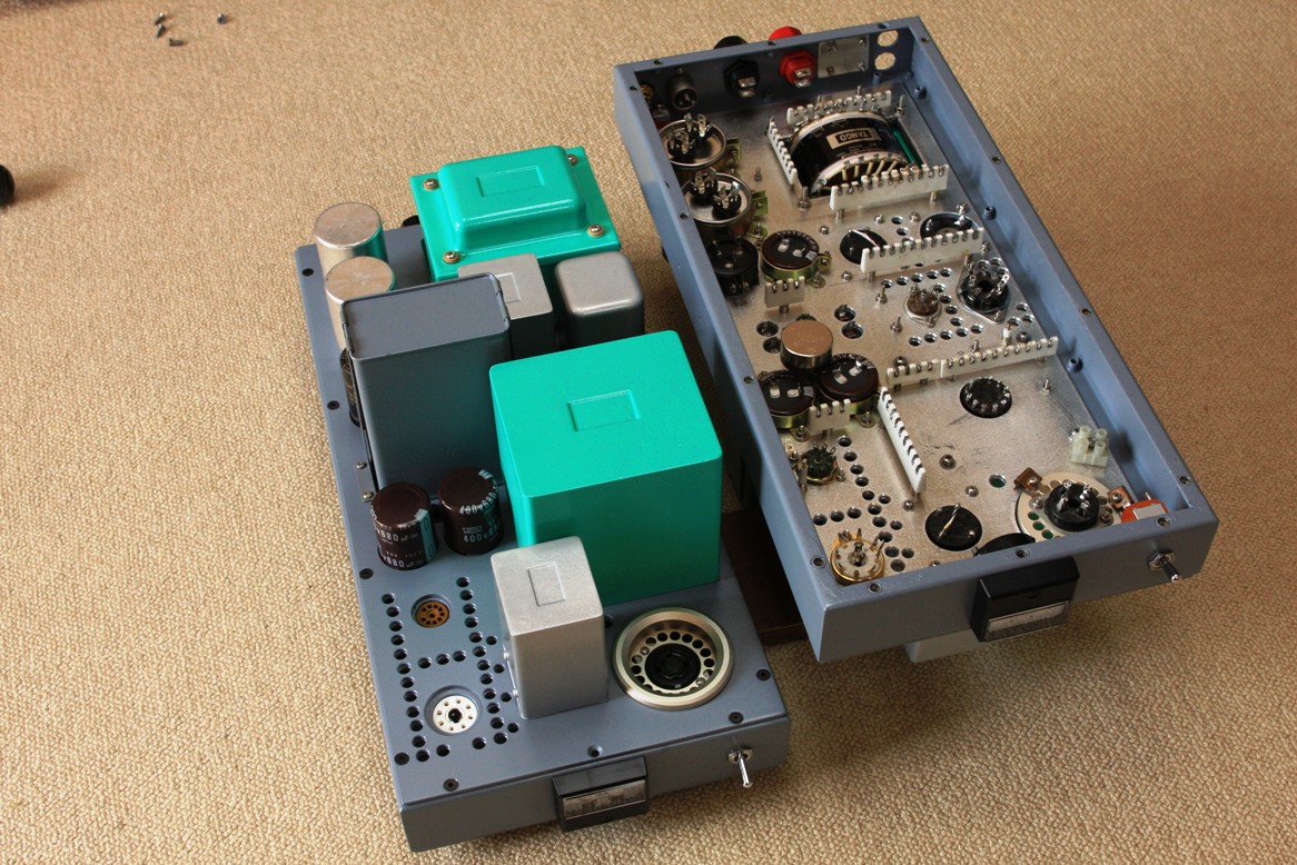

The third version of my 811A SE amp
The third version of my 811A SE amp (4P1L choke-loaded cathode follower drive) had been working from the beginning of this year was finally accomplished.
The sound is warm and mild. As the distortion level (THD) is so low that I can listen to any kind of music in peace.
Attached are: just before wire, work in listening room and the latest schematic.

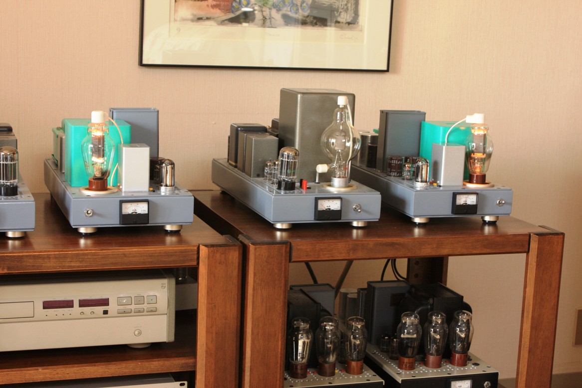

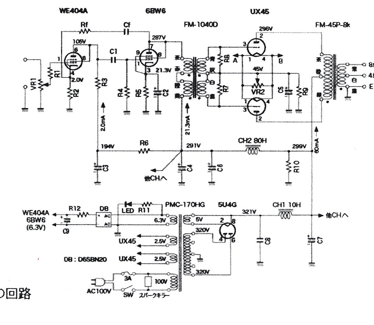

Last Sunday I had a chance to hear 45pp amp employing amorphous OPT (FM-45P-8K) and inter-stage transformer (1040D).
The sound was fantastic and felt very easy to sleep!
BTW, My Softon RW-40-5 OPT was probably special case. I suspect that the core might be touched (no gap) due to production failure.

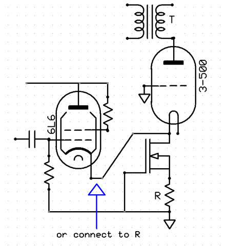

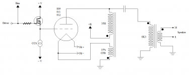

hi µ triodes are connected with grounded grid in rf amps. why not use it ?
this way the driver is working always to constant type of load
connecting driver to R it will have even higher gain
The whole point of the cathode winding.
On one of the Russian-language sites is a separate issue on cathode windings ÔÎÐÓÌ ËÞÁÈÒÅËÅÉ ËÀÌÏÎÂÎÃÎ ÇÂÓÊÀ. I took out a diagram conversion pentode volt-current characteristics to triode volt-current characteristics by the introduction of the cathode winding.
BTW, I was surprised to hear you have snow in UK now.
Yes, that's really funny weather!😀
In my county it is fine, temperature is acceptable and we have sunny spells these days.
It raises the output impedance (of the output stage) to huge readings and the circuit can not be anymore used without GNFB.
But if plenty of GNFB is acceptable, then it is OK.

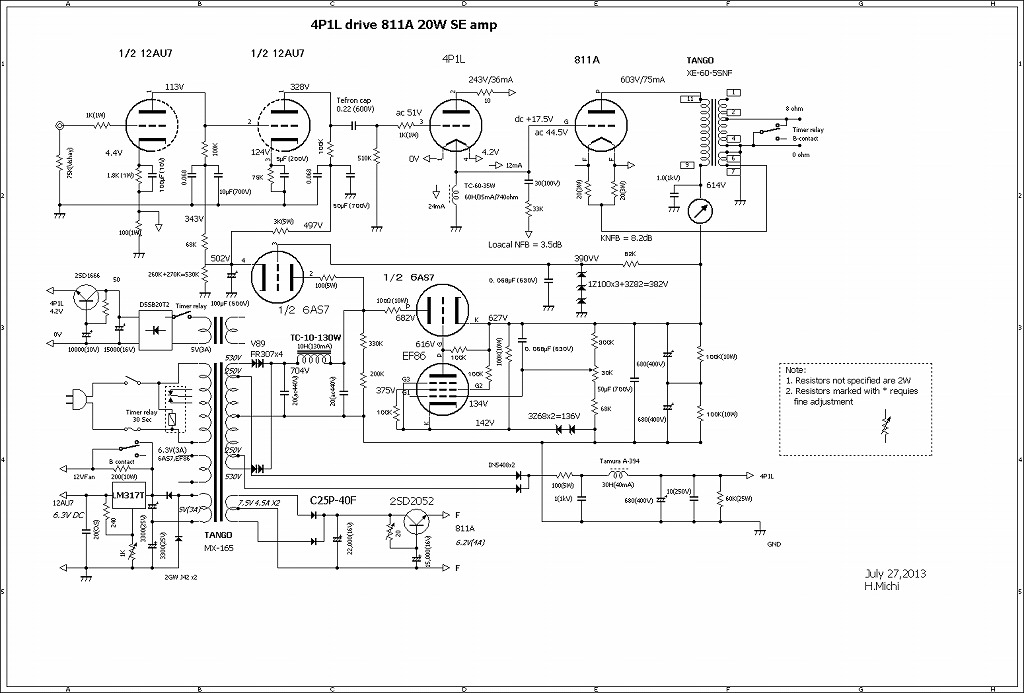

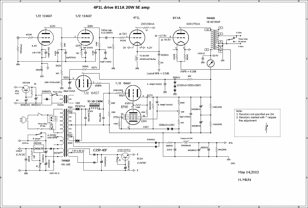

811A SE amp driven by 4P1L choke loaded cathode follower
811A SE amp (20W) driven by 4P1L choke loaded cathode follower
Almost two months past by since I replaced to 4P1L cathode follower drive from a decade used regulator tube drive to 811A SE amp, I have come to a certain feeling at improving THD level and father natural sounding.
However there is a miner concern of exceeding max. plate dissipation of 4P1L.
The maximum plate dissipation of 4P1L in triode connection would be around 8W.
Now the dissipation of 4P1L is 243V x 0.036mA=8.7W
So far it is working nicely.
The circuit description
1. Cathode choke is a Tango TC60-35W (60H/35mA, DCR: 730 ohm) which is originally designed for the plate choke for the small power tubes.
2 The operating point of the 811A:
Plate voltage: 600V, Grid bias: +17.5V, Plate current: 75~80mA,
Load impedance of OPT: 5.9K ohm, Max. driving voltage:45Vrms at 20W output. The grid current for the 811A is 12mA at resting condition, so that actual current through the choke is 36-12=24mA.
3 Consequently the grid bias for the 811A become: V=0.024x730=+17.5V
4 To obtain above condition, the fine adjustment of 4P1l plate voltage is necessary.
5 OPT is Tango XE60-5SNF: 30W (40Hz), primary impedance of 5K ohm with 36 ohm 3rd winding. Cathode NFB is 8.2dB(measured)
6 The 30 sec delay relay installed in the filament circuit of the 4P1L is to avoid rush current occurred to 811A during start-up time.

Nice design 🙂
I'm concerning matching on impedance. Can you tell me how much are Zout of 4P1L and Zin of 811 ?
