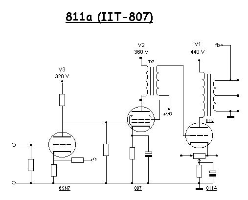

too much?
Hi Jim,
So, you have the 33k resistor generating -33 volts of grid bias for the EL84, in addition to it's connection to a fixed bias source? Seems like you will be very far from class A with this tube, won't you?
jim said:Joel,
The current through the 33k resistor is approx. 1 mA.
The 280k resistor goes to the bias supply (adjustable between
5-30V)
Hi Jim,

Joel,
The EL84 is biased by a separate bias-supply connected
to the 280k resistor.
This voltage biases the '84' to about -10,-12V at 25mA.
Jim

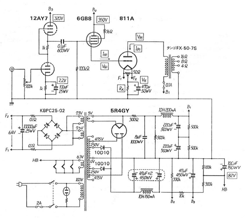

I just found the schem of the WAVAC 805 (designed by the late Nobu Shishido) and thought I'd post it for some inspiration, especially as you mentioned possibly using an IT. The IT in the WAVAC is configured so that a large part if the DC bias flux will be cancelled (smaller gap, increased primary L), and IIRC has a step down to get better drive.
Enjoy.
I guess Brett's schematic came from Shishido's book "Sohshinkan Niyoru Single Amp Siesakushu" which I don't have. But on this book I undrstand there are a number of IIT including the 811.
BTW Brett, thanks for the schematic since I was looking for it, but never asked!!!

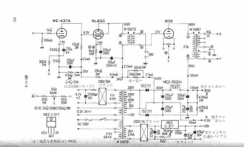

Now the problem is where to get a 437A. (at 1/10 the asking price I may add). The price of this tube will account for 1/2 the cost of the amp!
apassgear said:I guess Brett's schematic came from Shishido's book "Sohshinkan Niyoru Single Amp Siesakushu" which I don't have. But on this book I undrstand there are a number of IIT including the 811.
I don't actually have this book, I found the schematic on the web somewhere, and as is my habit, I saved it. One day I will buy a copy of Shishido-san's book but it's $US65.
He was a great designer.
I'm glad you liked the schematic. I also had the one for the WAVAC 833, but lost it when my HDD died.
Now the problem is where to get a 437A. (at 1/10 the asking price I may add). The price of this tube will account for 1/2 the cost of the amp!![]()
Use a 6C45pi (possibly even a better tube) until you come a cross a stash of 437s.

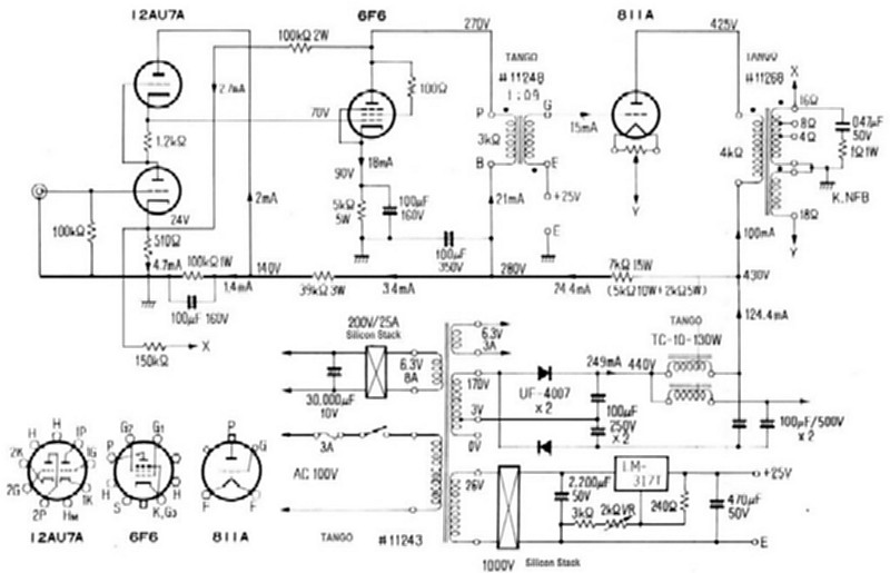

Re: 811A Schematic #3
In this design without a path from G1 to ground, I'm intrigued as to what stops the 811 from "running away"...
Hi,Kuei Yang Wang said:Konnichiwa,
Here another rather low quality scan....
Sayonara
