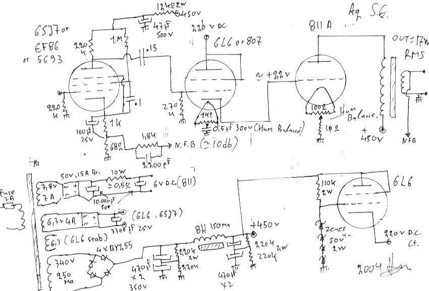

I have built this:
The voltage amplifyin stage can be 6AU6 or practically any sharp cut-off pentode.
680k trimmer resistor is used to adjust the 1st. stage to minimum distortion.
Hi artosalo. Nice looking circuit. How does it compare to a design utilizing an interstage transformer?
I have not tested with a transformer.
In such case, however, a low impedance driver stage is needed, so the use of transformer does not give any advantage.
One possibility is to replace the (6N1P) cathode follower with NMOS-fet such as IRF-820 etc.
The dynamic input resistance of 811A is about 1 kohms and required driving voltage some 10 Vrms ( @ 15 W out).

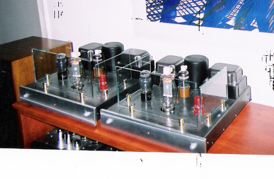

I have made lots of 811A PP amps, nothing comes even close. You get more than 100 watts with less than 600 volts. The 811A's last much longer than any other tube. ,I biult a pare for a friend he is still using the same tubes after 17 years. Uses 6gu7 as voltage amp and phase splitter, 6GU7/ 12BH7 as driver, 6BL7's as cathode follower, 811A's draw 70 mills. You do need good outs: 2.2kP-P Can scan circuit if any interest.

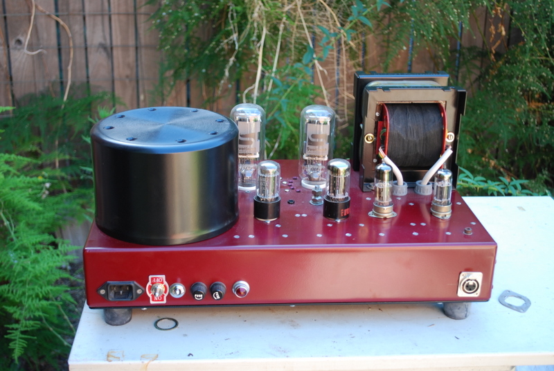

I have been playing with a 811A SE amp for 10 years.
Attached is the latest schematics for your reference.

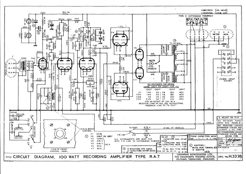

I have scanned the original Grampian 811A circuit, record cutting amp.
I saved the parts for this amp from going to the tip, plus a heap of western electric Se 300B amps which i sold to Japan.
I have simplified the amp, there is no need for the EF86 pre-amp.so the first tube is the 6GU7/12Bh7. I also removed all the caps for stopping oscillation, only used the filter on the first 6GU7; I use 4.7K and 500Pf. The original used 26Db feedback so it needed a lot of compensation, I have found 6Db feedback plenty. The original partridge c core out put transformer 2.2K A-A weighs 9 kilos.
The power supply uses Mercury vapour rectifiers and choke input. I have made some of these amp using choke input, but with a silicon bridge rectifier. You need two 6.3volts 6 amps for the 811A’s; I use Dc but hope to use Rod Colemans Filament regulators . You need a separate 6.3v 4 amp winding for the 6BL7 and a 6.3v 3amp for the two 6GU7’s. I have found you don’t need Dc for the driver tubes.
I have built the amp using separate power supplies weighing 50 kilo’s. The mono block pictured uses a toroidal transformer and a 5K A-A with cathode feedback.
I used a Sowter 2.2K out put transformer similar to the one used for 4 x 6550’s but without the ultra linear taps. The Hammond 1.9K A-A would be a lot cheaper. Purchased two but have not had the time to try it.

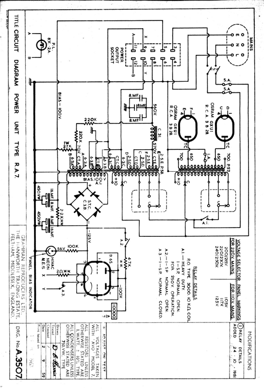

I can send you the details for the power transformer, using silicon rectifiers.. You need about 590 volts Hi tension. Don’t go any higher as the 811A must have 70Ma current draw. You can use the 572-160 at higher voltages. 100 wats is plenty with this amp, friend of mine uses an 811A amp with speakers that recommend 200 watts solid state and it handles it no trouble at all, he has used the same tubes for 17 years. 6550 amps running 100 watts would be lucky to last two years.
You must have a delay relay or HT switch to allow the heaters to reach full temperature, before turning on the HT.
