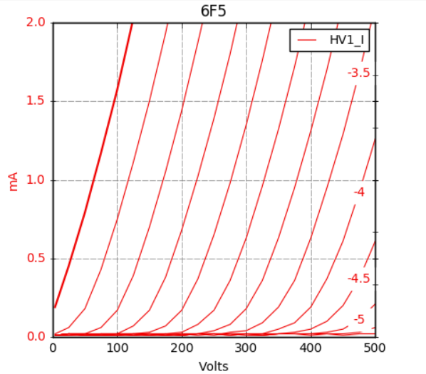

I made a mental error, did not see the heater pins are switched between 6F5 and 6SF5, so using both in this amplifier will require a simple adapter. I've decided I will build it for 6F5 natively, they are equivalent, however much more variety and availability of 6F5 / 6F5G / 6F5GT / 6F5M over 6SF5.

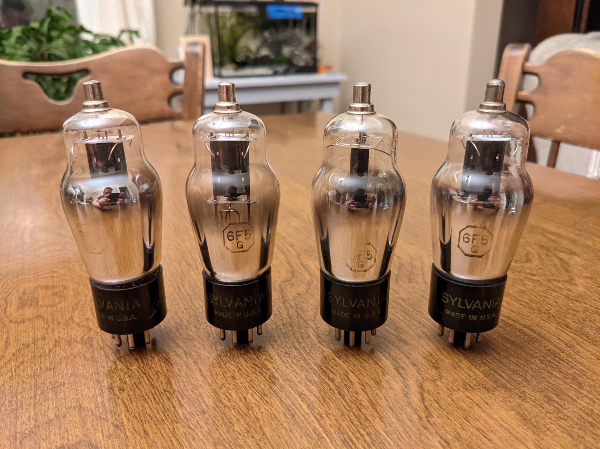

Got my hands on a set of Sylvania 6F5G, shouldered type. They sound great.
Impressive linearity, like the 6SF5.
Very pleased I came across these and they work well in this design. Going to try and finish the chassis design this weekend.

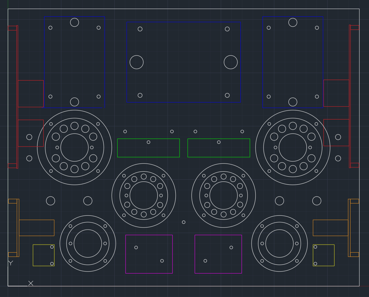

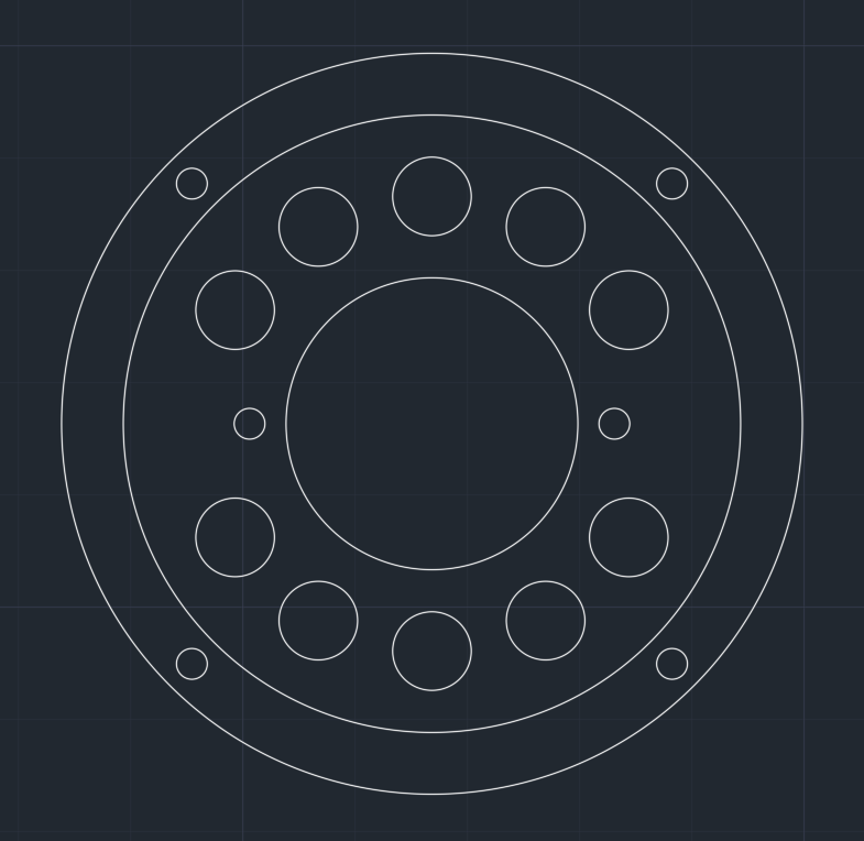

What kind of fun, Hearinspace? The good kind or the bad kind? chassis design is coming along in AutoCAD, I've decided I will recess the sockets and do the ventilation like so.
Yep! 6F5, 6SF5, 6SQ7....all pretty good. I tend to avoid top caps but if that doesn't bother you it's good stuff.
I'm okay with the top cap, I'm going to shield the wire, noise floor is essentially identical on the measurements. I like the variety of the 6F5, some interesting options like the MOV H63 or French-made 6F5M. Also some Russian equivalents with very impressive internal construction

I've made great progress this morning on the chassis design, the top plate is nearly complete, which is the most difficult. When designing this way, since all drilling / machining will be done by my friend Dave at Landfall, I include stick diagrams of internal components to scale to optimize the layout. There is just one more thing I need to fit that I had forgotten...it is an iterative process

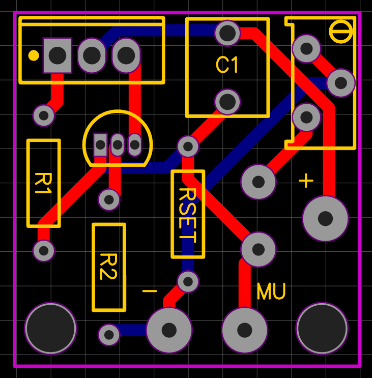

I put together a nice compact 1mA CCS load for 6F5, IXTP08N100D2 / LND150, 1"x1" footprint.

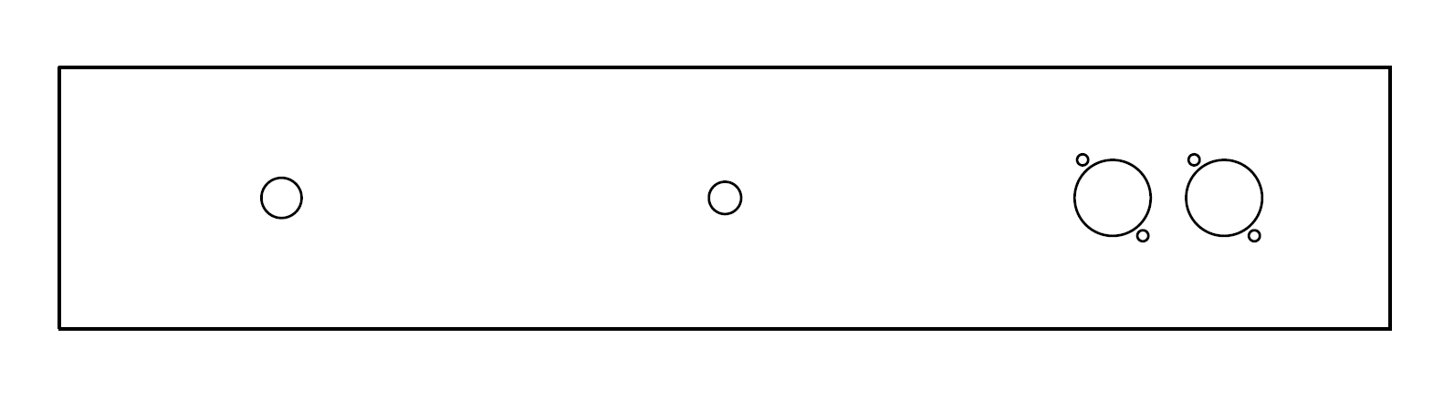

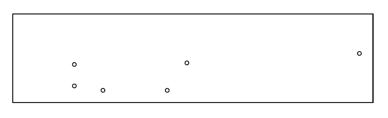

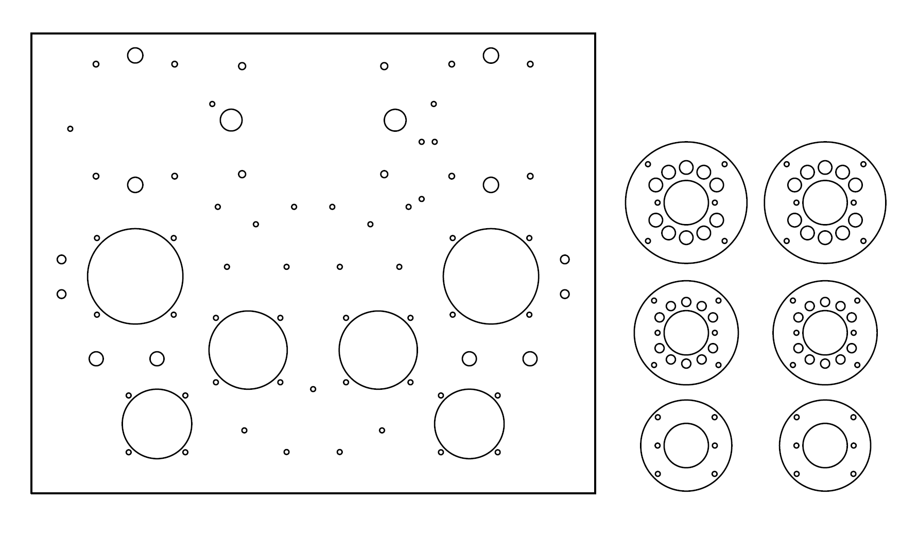

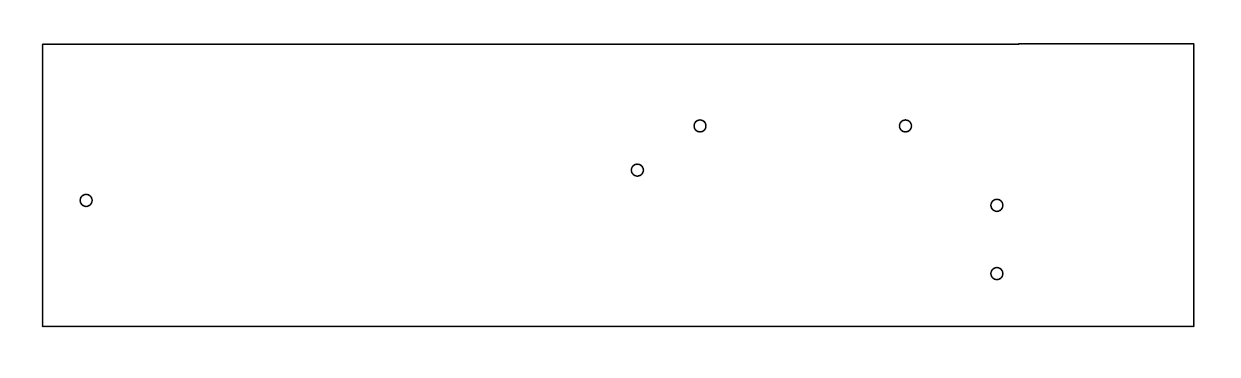

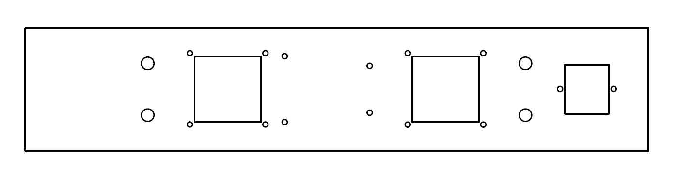

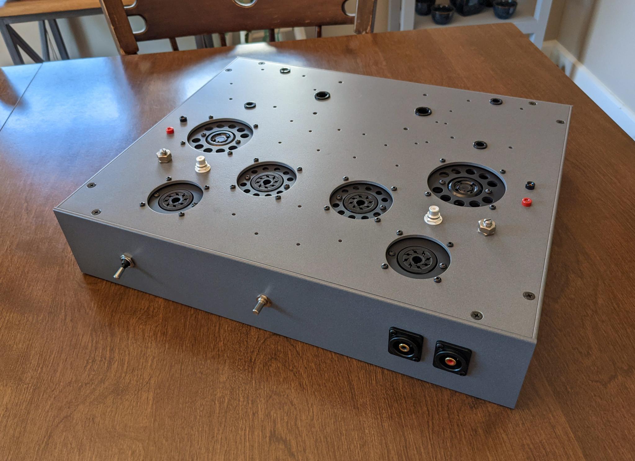

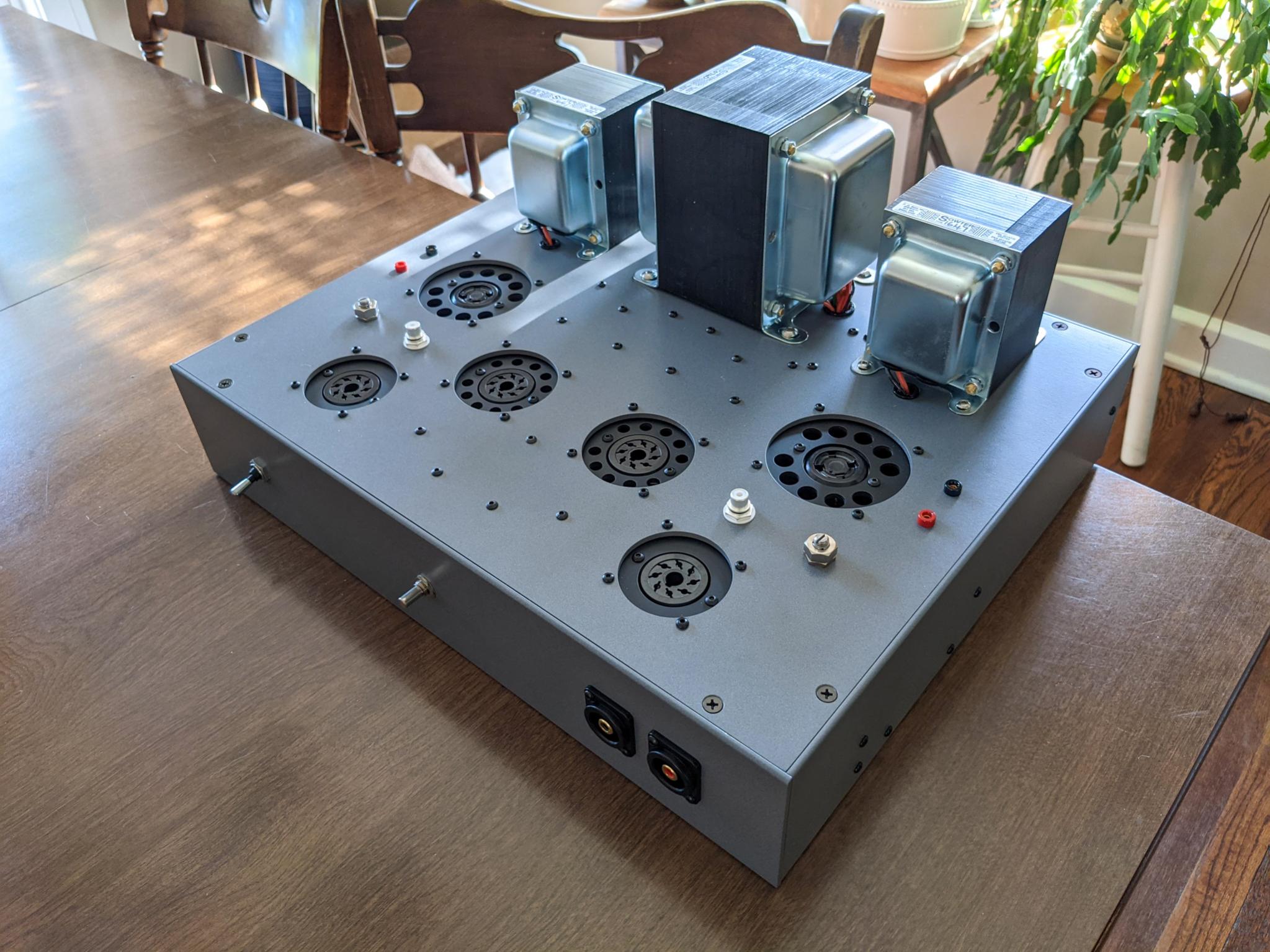

After several hours of work, I finished the layout and chassis design, dimensions are 3.25" x 13.5" x 16.5".
Top plate and recessed socket plates.
Front panel.
Rear panel.
Side panels.
The main chassis will be powder coated in a semi-gloss medium gray, the recessed socket plates will be in matte black. Just need to review my old color choices to be certain I won't have a change of heart.

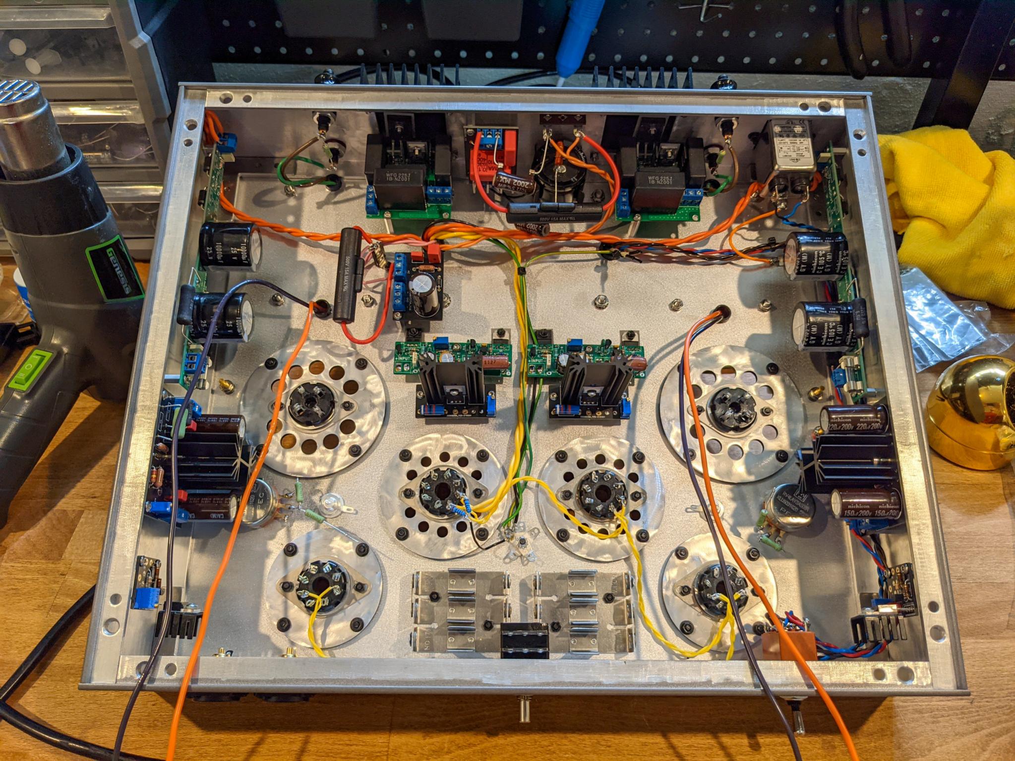

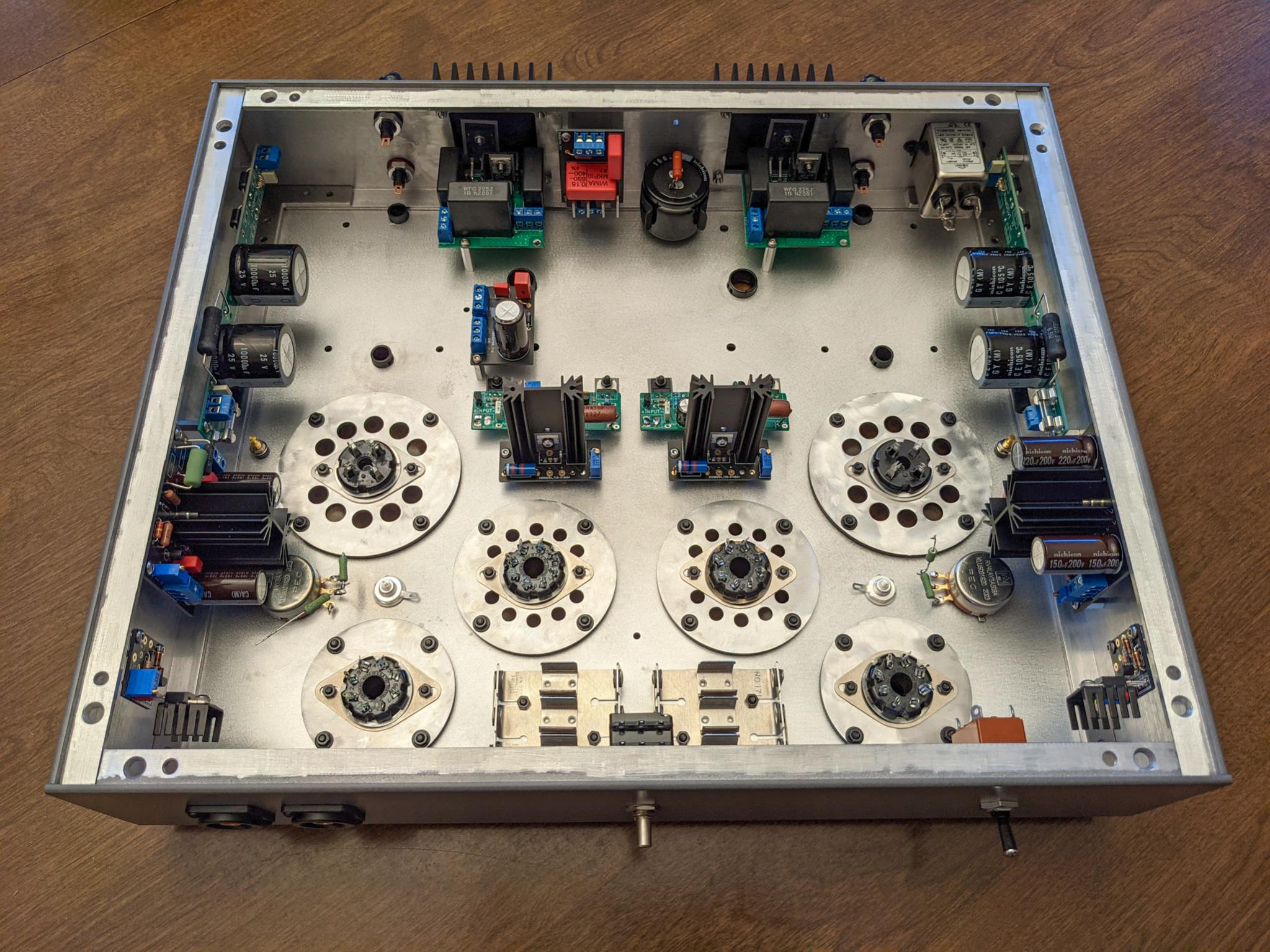

Based on some measurements I was seeing, I've opted to use two Maida regulators, one for each channel. Given the dynamic load in A2, I found this helped keep the operating voltages nice and stiff out to a full 7W into 8ohms. Will halve the power dissipated in the power FETs as well, each will have its own external heat sink mounted on the rear panel.

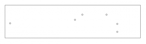

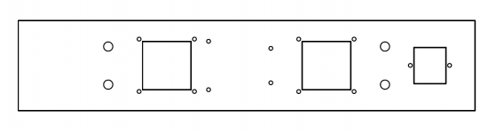

Front panel.
Rear panel.
