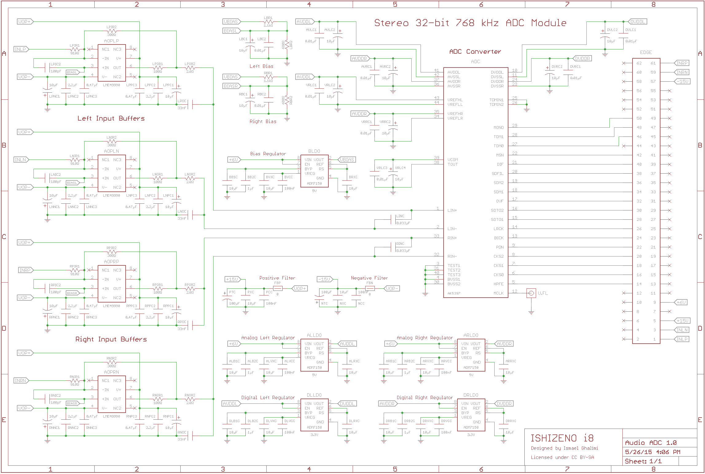

The DB2132000L used for D1..4 is marked as "End of Life" by Mouser. Any recommendation for a suitable alternative?
And how on Earth can a brand-new evaluation board use EoL components? This is beyond me...
AKM does not seem to do a very professional job like AD, TI, Cirrus, etc. Their documentation is relatively poor in comparison. I am sure it has something to do with the size of the company as well. I've noticed they have a strong made-in-Japan preference where you will see them select parts from Japanese vendors unless they absolutely can't. Panasonic makes good parts, but I'm not sure they have the same commitment to lifespan that some of their competitors do.
I don't really understand the point of it, but these are close matches at Digikey:
NXP PMEG3020BEP,115
Toshiba CRS09(TE85L,Q,M)
It's probably there for reverse voltage protection and can be omitted.
Regarding R7...
From AK4499 Data Sheet page 9, pin-105:
EXTR - input - External Resistor connection pin. This pin should be
connected to 33 kΩ (±1 %) to AVSS.

Great catch. I should have thought of reading the chip's datasheet... And I confirm that this is the resistor found on the board. Somehow, I had missed it.
Do you understand the particular symbology used for this resistor on the datasheet (the two sets of two concentric circles)?
And do you understand why all these resistors are mounted so close to the edge of the board near the board-to-board connector? Is it just to get some clearance from the large capacitor in order to facilitate assembly, or is there another (more important) reason for that?

You mentioned that earlier, and the longer I am studying their documentation materials, the more I appreciate your comment. There is a clear preference for domestic components, and some parts of the documentation could have used a bit more love and care...
The schematic of page 58 that was made to look like an actual circuit is really, really hard to read (unconventional layout and poor PDF rendering). I am trying to draft a more conventional version that should make it easier to understand how the circuit works, because so far, I am a bit lost...
And thanks a ton for the diode recommendations, this is really helpful.
Could simply mean that the value was unknown at the time they finalized the current version of the document.
The 10-ohm resistors might be at the edge to make it easier to test adding more caps on the dac chip side of the resistors, also might make it easier to try testing with different value resistors.
R7 might be near the edge to make it easier to add it later in the assembly process. If I were to take a guess, I would say it might be a reference resistor to set the output level of the dac chip so that multi-mono dac chip designs will see the same output level from each dac chip. Otherwise there could be some chip to chip variation in output due to manufacturing tolerances of the internal switched resistor networks.
I see. So, if I understand all this correctly, the location of these resistors does not matter much as long as they are on the same board as the DAC chip. If so, I'll prioritize the capacitors, oscillators, and operational amplifiers, probably with this set of priorities:

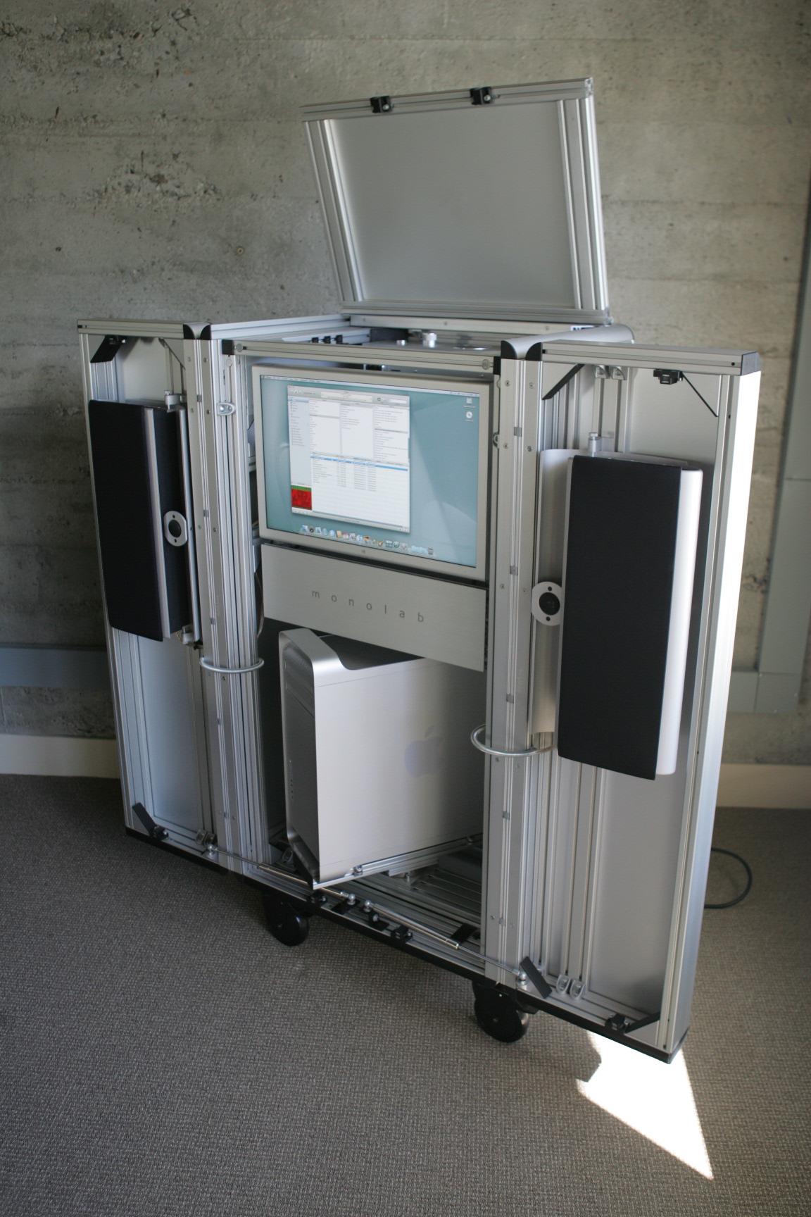

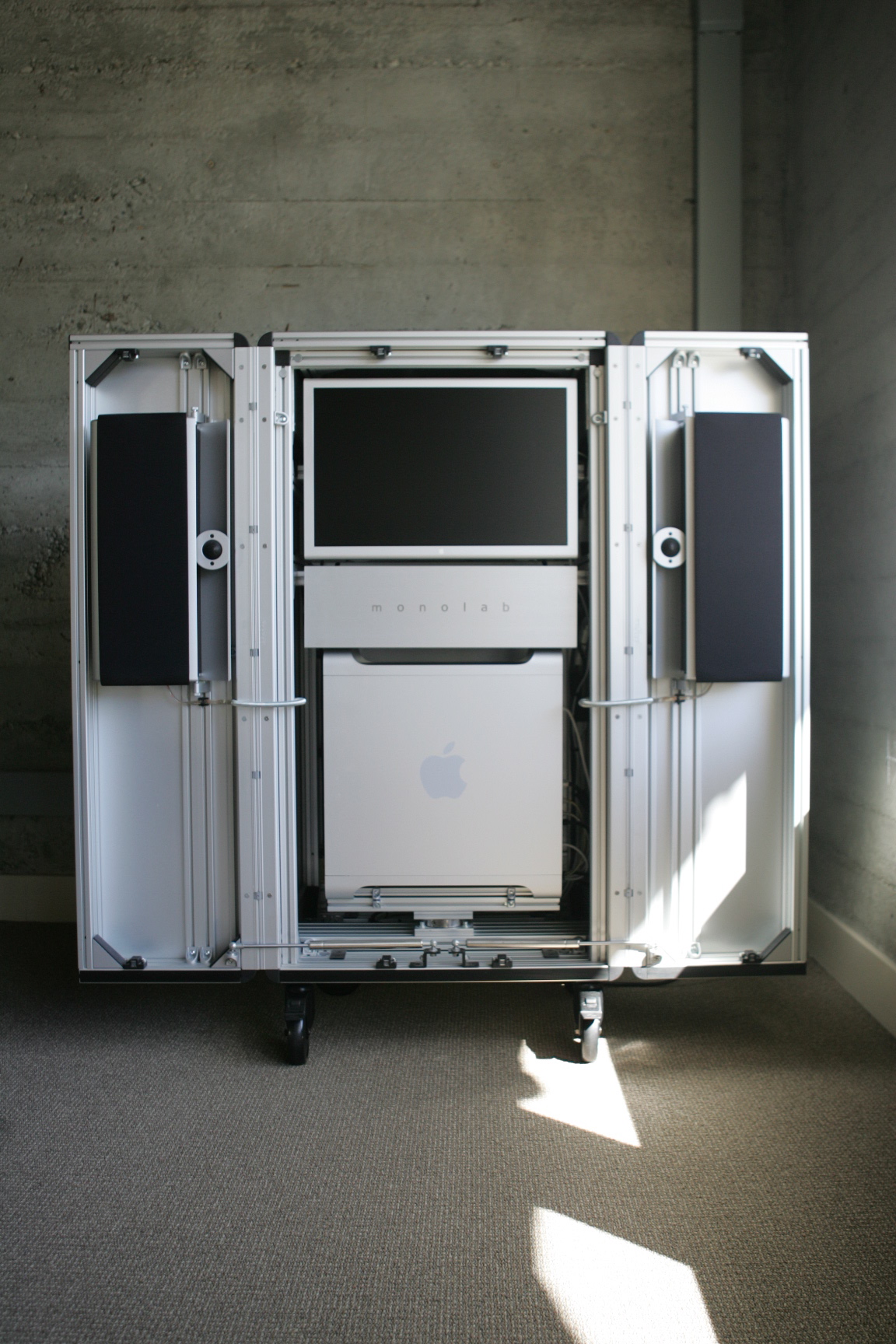

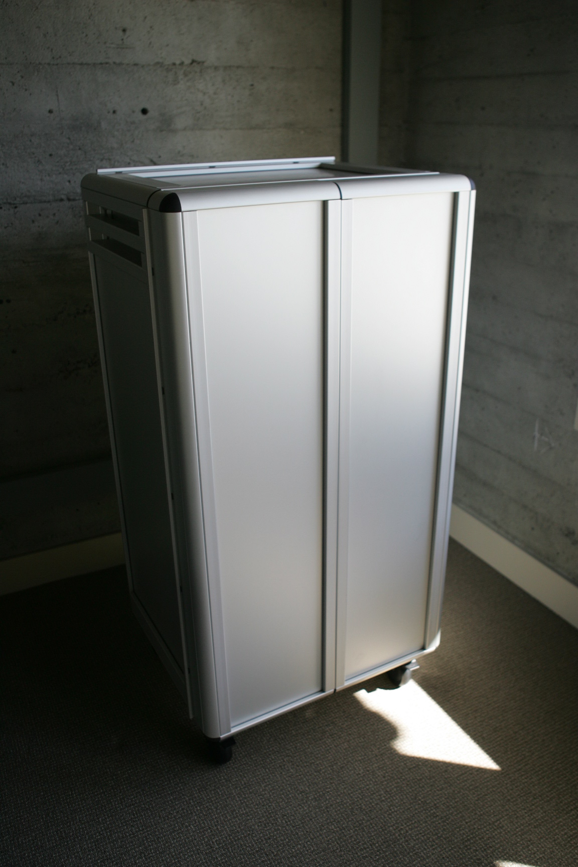

Here is a funny story about my rather unusual learning process.
Fifteen years ago, I got married. The minister at my wedding was a friend and happened to be the guy who designed all the electronics for the first iPod. He then went on to run Apple's mobile electronics group, up until the fifth-generation iPhone, managing about 1,000 engineers. One of the nicest guys you'll ever meet. A common friend of ours was a member of the mechanical design team for the first aluminum Power Mac G4.
At the time, I was interested in learning about aluminum profiles. Not just the profiles themselves, but the entire system that is built around them, especially the fasteners. Item in Germany makes the best components that I know. So I decided to give myself an insane project that would give me the opportunity to learn a lot about this system, while making some kind of tribute to my friends. The idea was to build an iPod on wheels (see pictures). Yes, it was as crazy as it sounds...
The whole thing was made out of aluminum, and when the doors and top panels were closed, you could not see a single fastener from the outside. The Power Mac was mounted on a miniature version of the ball bearings used for the rotating ladder on a fire truck engine. And the doors, themselves mounted on geared aluminum profile hinges and softened with pneumatic pistons, could be unlocked with the same keypad used to protect access to an airliner's cockpit post September 11. A pretty decent integrated amplifier was mounted vertically on the back of the aluminum display, and the loudspeakers themselves were made out of milled aluminum.
The whole thing ended up costing more than an entry-level car, and was over 400 pounds.
From a product design standpoint, it was a total disaster. The whole thing makes absolutely no sense at all. It's ridiculous, bordering on the obscene. But it was one of the best learning experiences I ever put myself through. Why? Because in order to make it work (sort of), I had to learn everything about every single product sold by Item (there are literally thousands of them). I had to develop a really deep understanding of the different fastening techniques, the pros and cons, and when to use them. And I got to do that because I started with an insane set of constraints (like no visible fastening elements).
This monstrosity was nothing more than a science project, but it taught me some really valuable engineering lessons. And it gave me a really good feel for how to work with aluminum.
