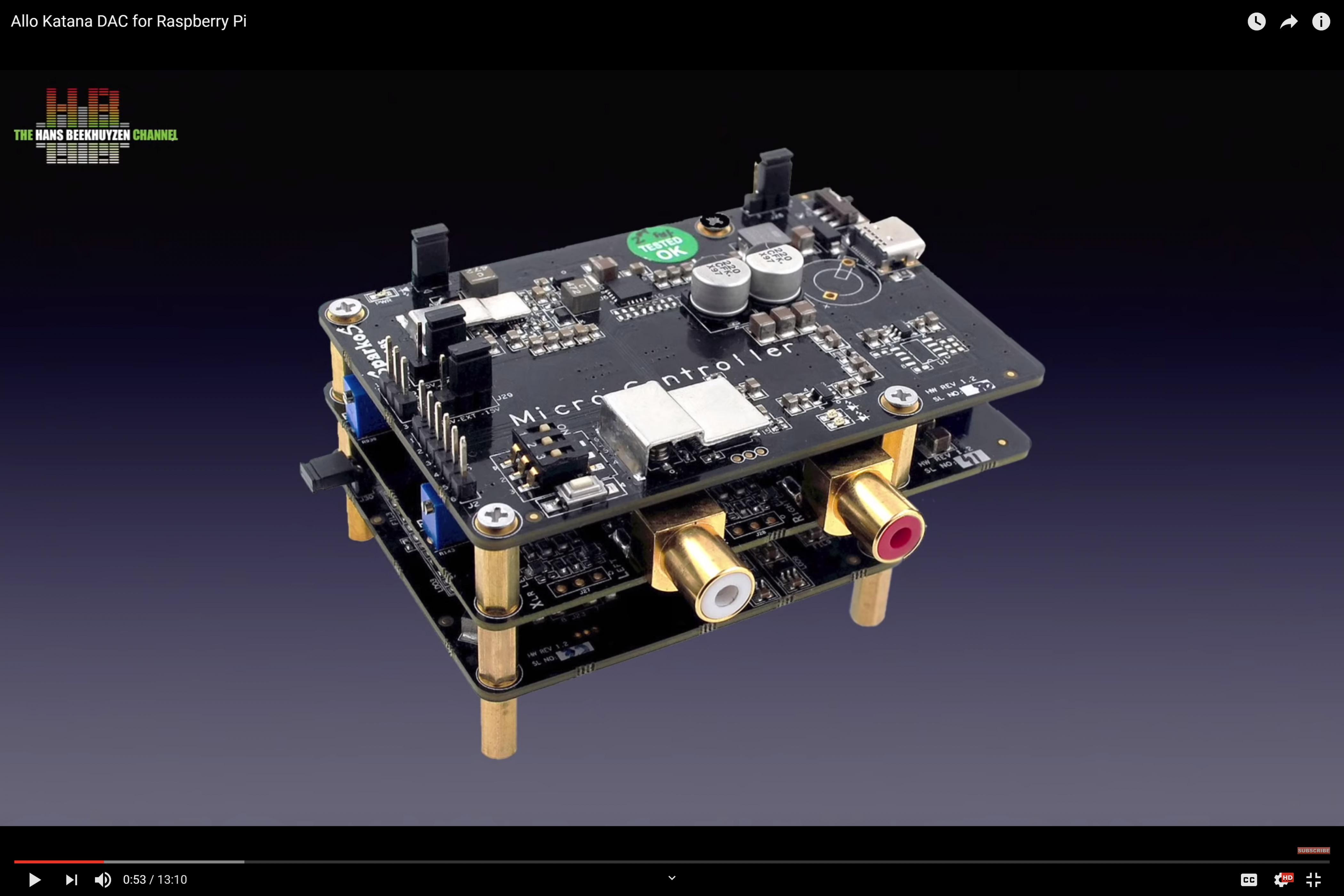

Maybe it would be helpful to take a look at how Allo designed the compact and somewhat modular Katana dac. There is a dac board which includes shielded clocks each with a dedicated voltage regulator (in fact most of the dac board does local voltage regulation and filtering), then there are some connectors which go down to the RPi board where files are stored, and connectors going up from the dac board to the output stage board. Some more connectors attach the output stage board to the next board up in the stack which is the MCU control, incoming power supply, and power conditioner board. That type of organization into modular form makes good sense from an EE perspective. I know for a fact they studied Ott carefully and still do. The lead engineer on the project says he has read Ott three times from cover to cover, and keeps a copy of The Art of Electronics next to his bed. Not a bad idea to help learn how this stuff works.
Both books are in the mail!

Katana Board Video
This video is a great introduction to the Allo Katana DAC. I took several screenshots that I will add to dedicated posts. A lot can be learned from this setup indeed. Thanks a lot to Mark for pointing us in this direction. It should be super helpful.

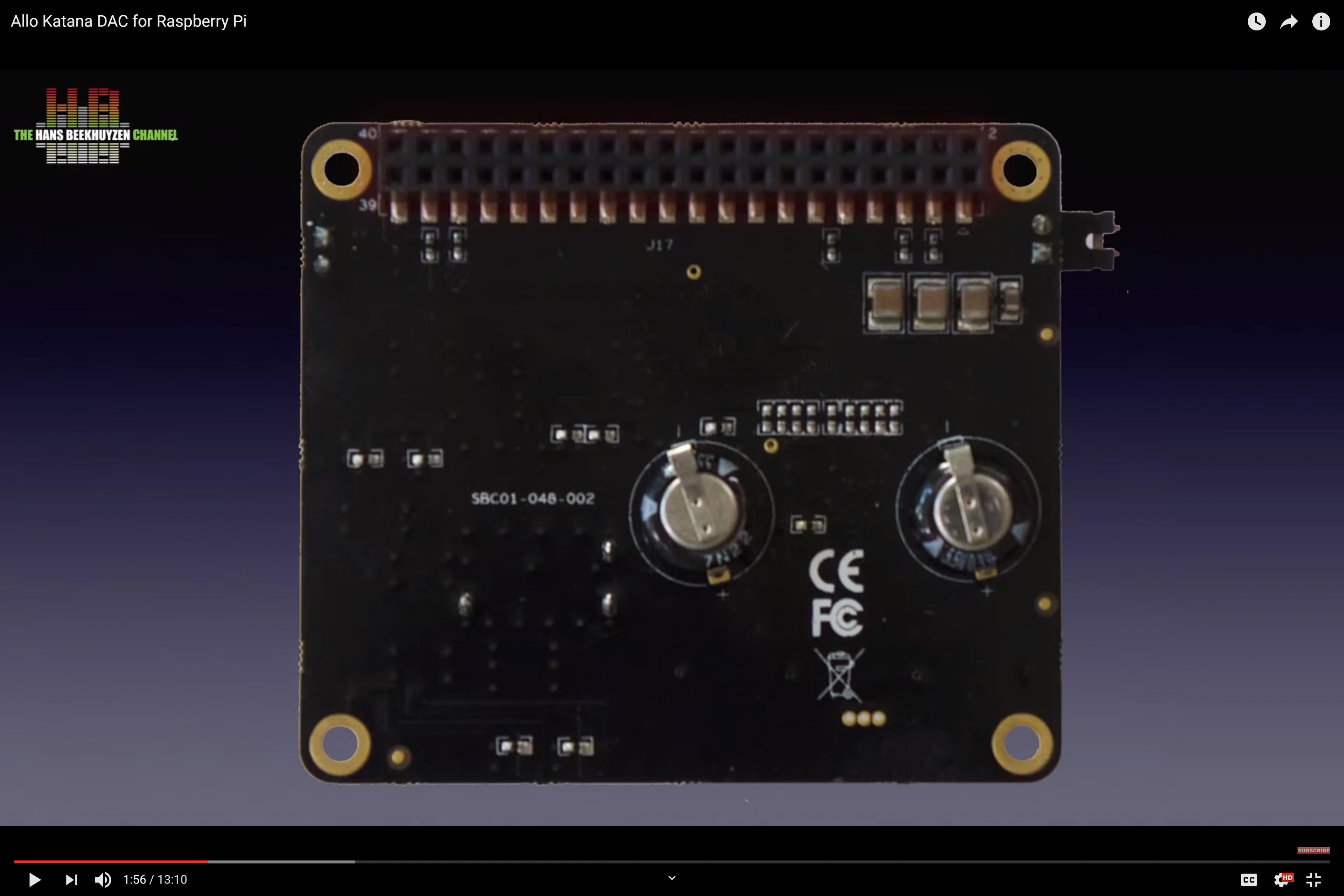

Katana DAC Board
This is the Katana DAC board (top and bottom), which is the lowest board on the Katana stack shown on the previous post. The ESS DAC is on the left and the NDK clock oscillator is on the right, both with its own shield. Conclusion: we should mount the clock oscillators on the same board as the DAC chip, and we should shield both. The clock oscillator should have no problem fitting between two 470µF capacitors.
...The clock oscillator should have no problem fitting between two 470µF capacitors.
Well, except perhaps that it first needs to be decided how the USB board will be clocked. Clocks are often located on it and used to help with re-clocking signals post-galvanic isolation. Or, clocks may be located externally from the USB board and the board configured to signal which of the two external clocks is needed to be enabled at any particular time.
This area is one where Katana differs from many dacs. Katana uses an ESS dac chip operating in master I2S mode, whereas AKM dacs don't support acting as I2S master.
