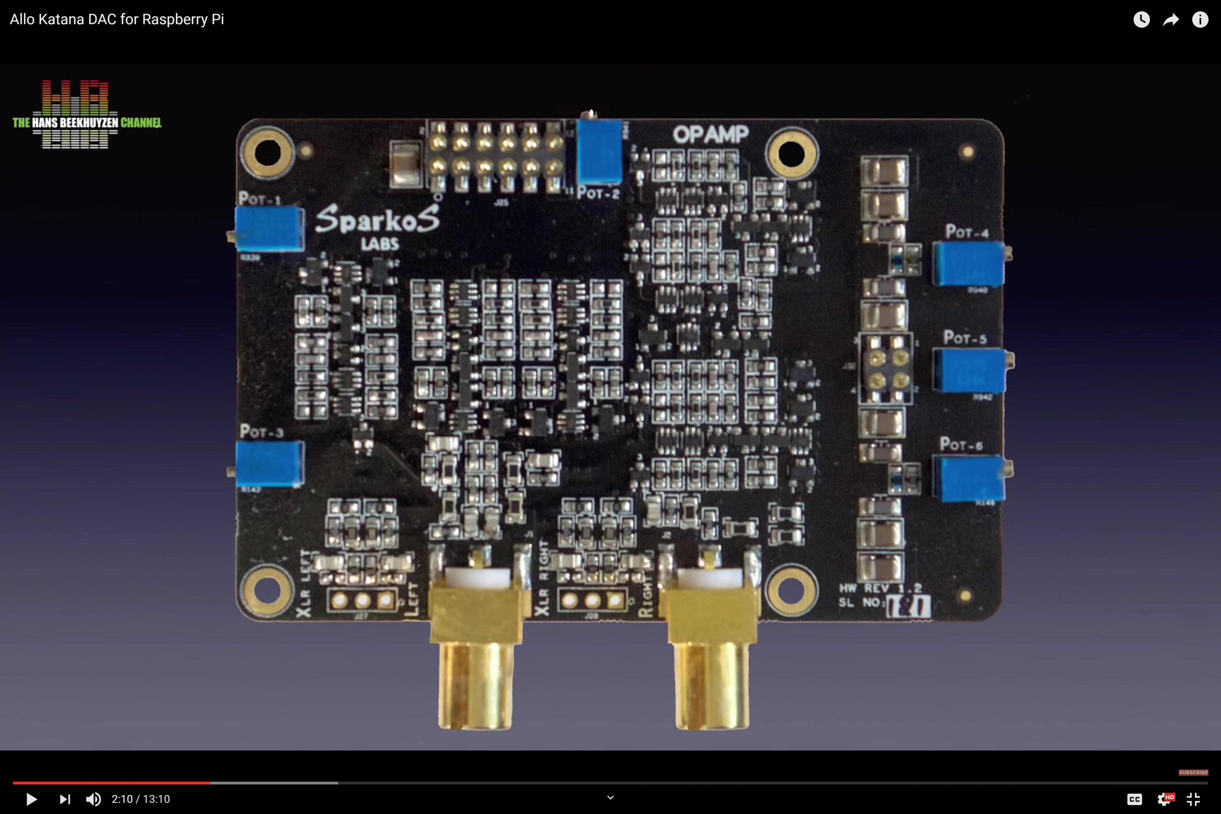

Katana Operational Amplifier Board
This is the operational amplifier board for the Katana (middle board on the stack). This board uses discrete circuits instead of integrated circuits. This is great for what they are doing, but we can't afford to do that (yet), so we'll stick to the OPA1612. What's interesting though is that the entire circuitry is on a separate board from the DAC board. Therefore, this answers a question that we had yesterday: we can put the op amps on a separate board without fearing too much degradation of the signal (as long as we believe that the Katana design works).

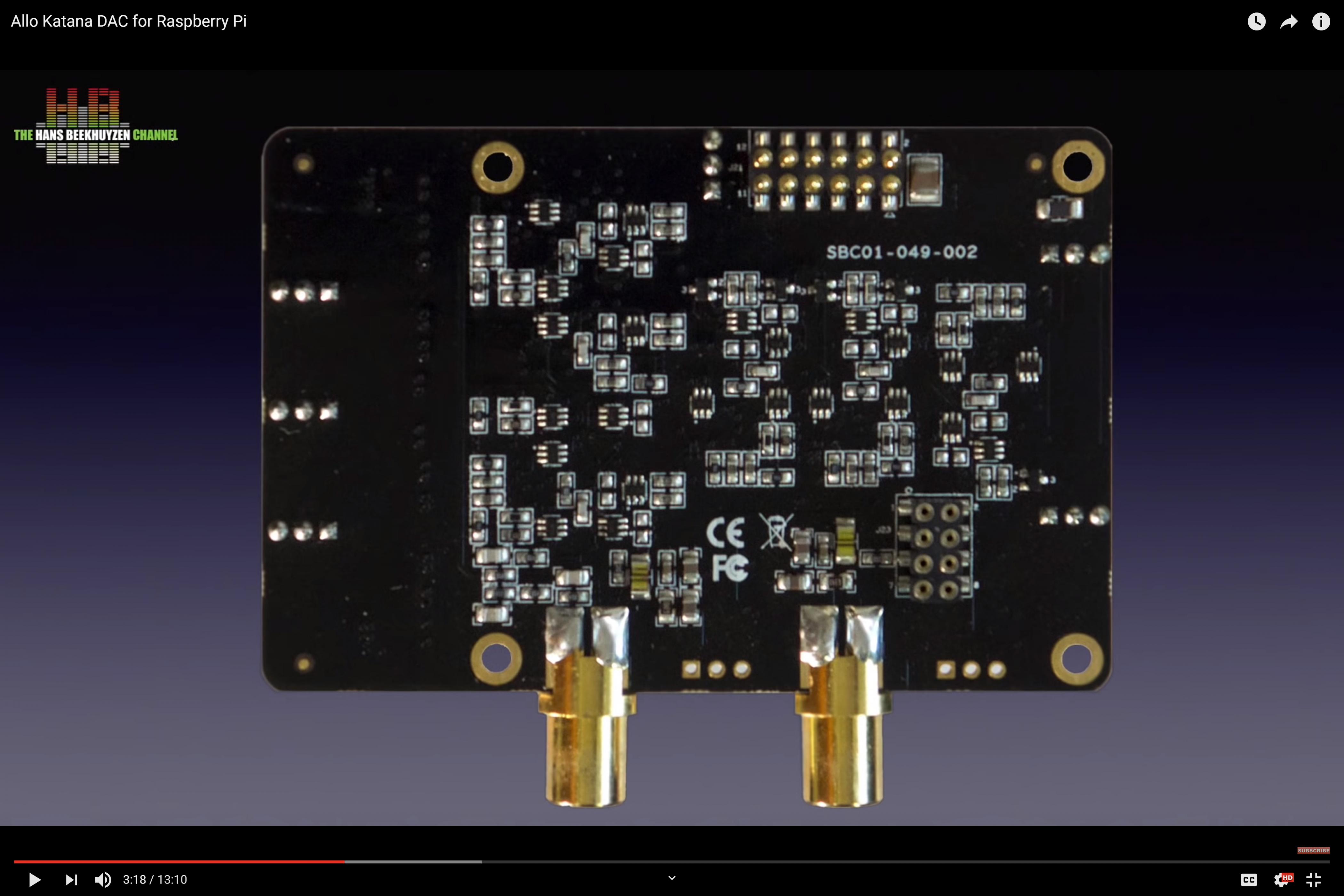

If we want the op amps to be on the same board as the DAC chip, the only way that we can make them fit is to put them on the bottom side of the board, right underneath the DAC chip. But that means that we'll get a via to go from the DAC to the op amp, and another via to go from the op amp to the connector leading to the XLR board. Is that acceptable?
