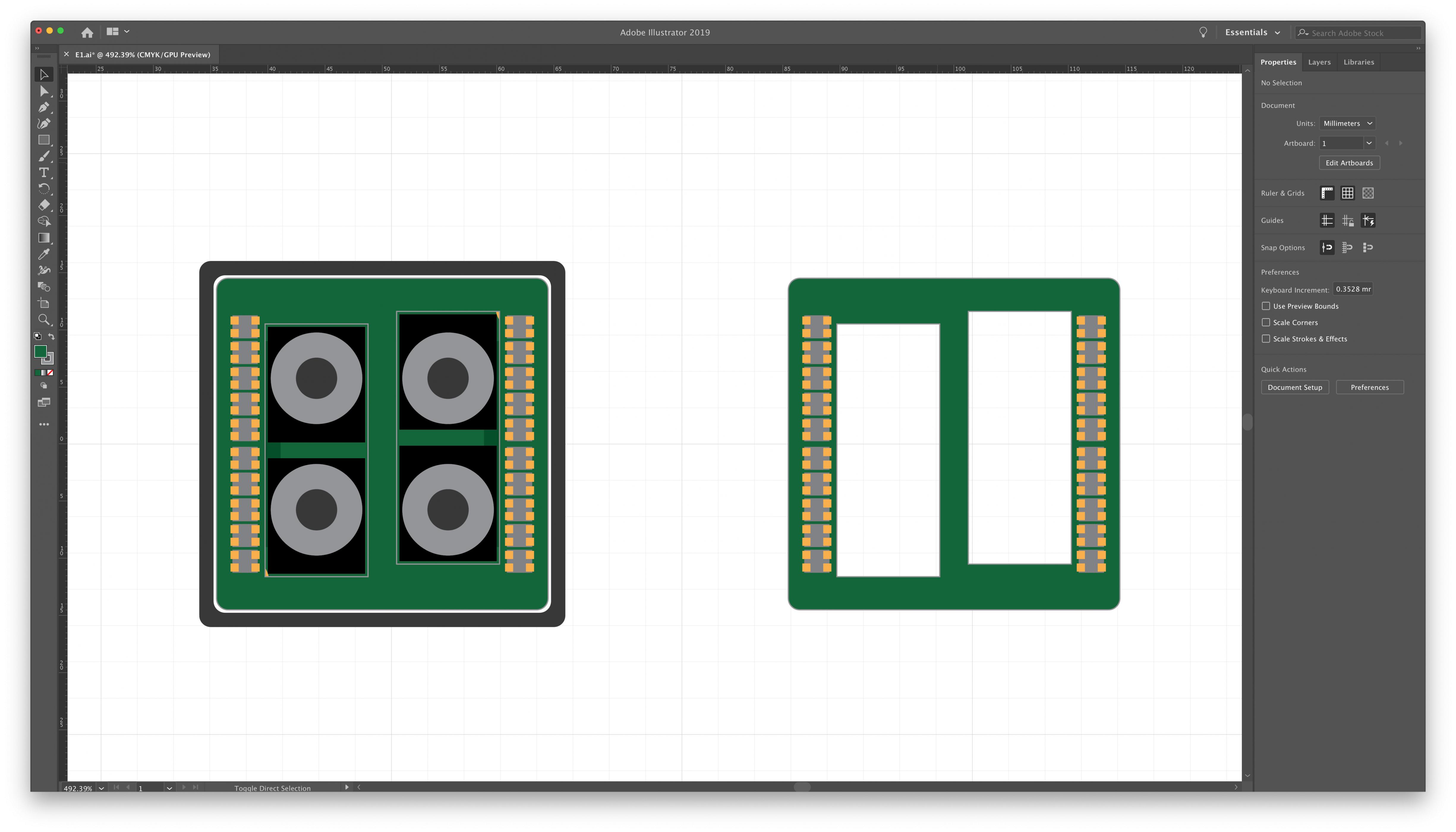

Here is what I have in mind for the VU meters: this brick would have three boards:
- Base Board on which the jacks are soldered.
- LED Board with the four VU meters using 4 × 5 × WS2812C-2020.
- Top Cover Board.
The sketch shows the Base Board + LED Board assembly on the left and the LED Board only on the right. The Top Cover Board is not shown (it won't have anything special on it). This board will be mounted directly on top of the TRS connectors and secured with their respective nuts. Therefore, it won't need any interconnect with the LED Board. But the LED Board will need an interconnect with the Base Board, which remains to be specified.

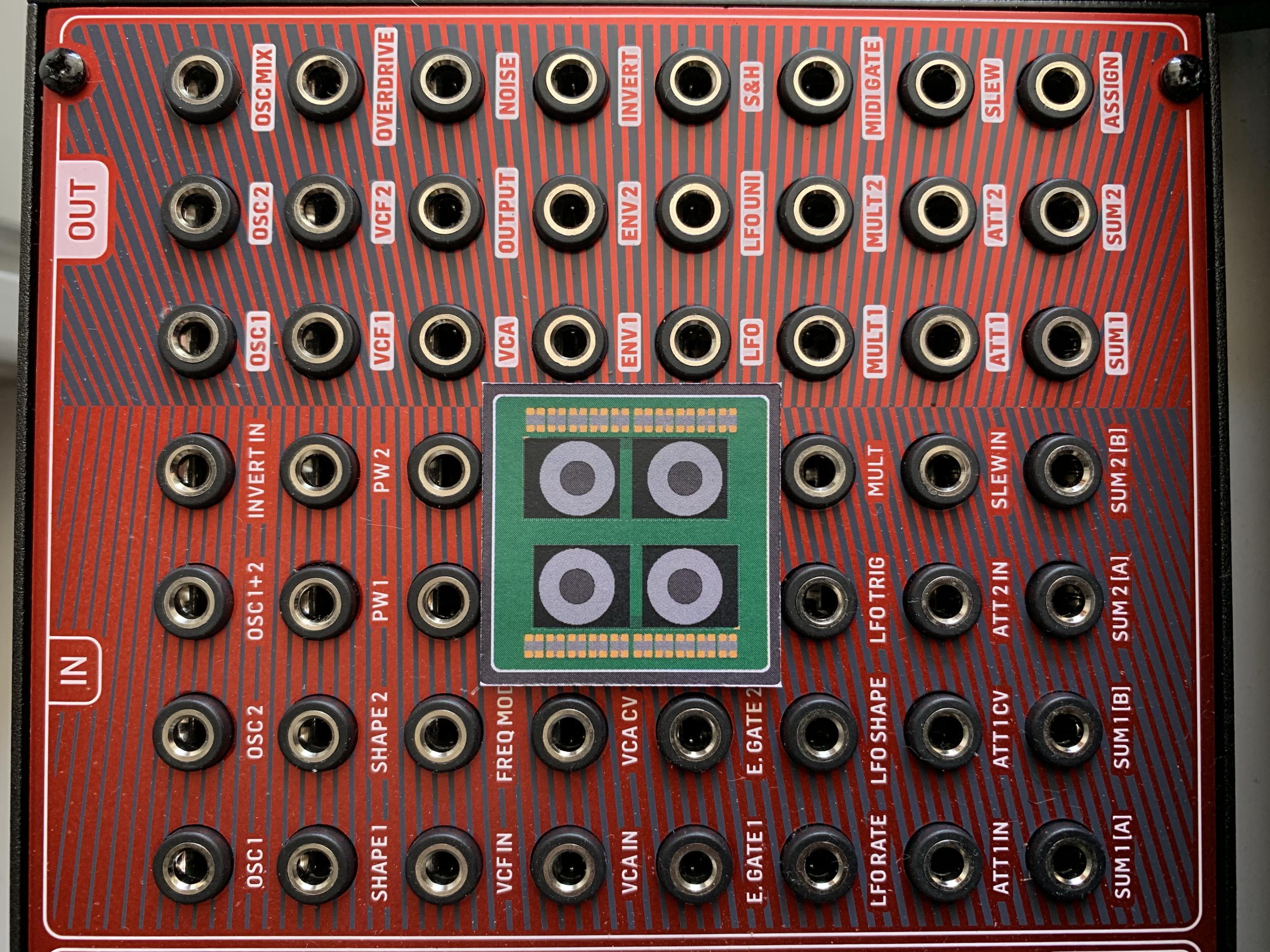

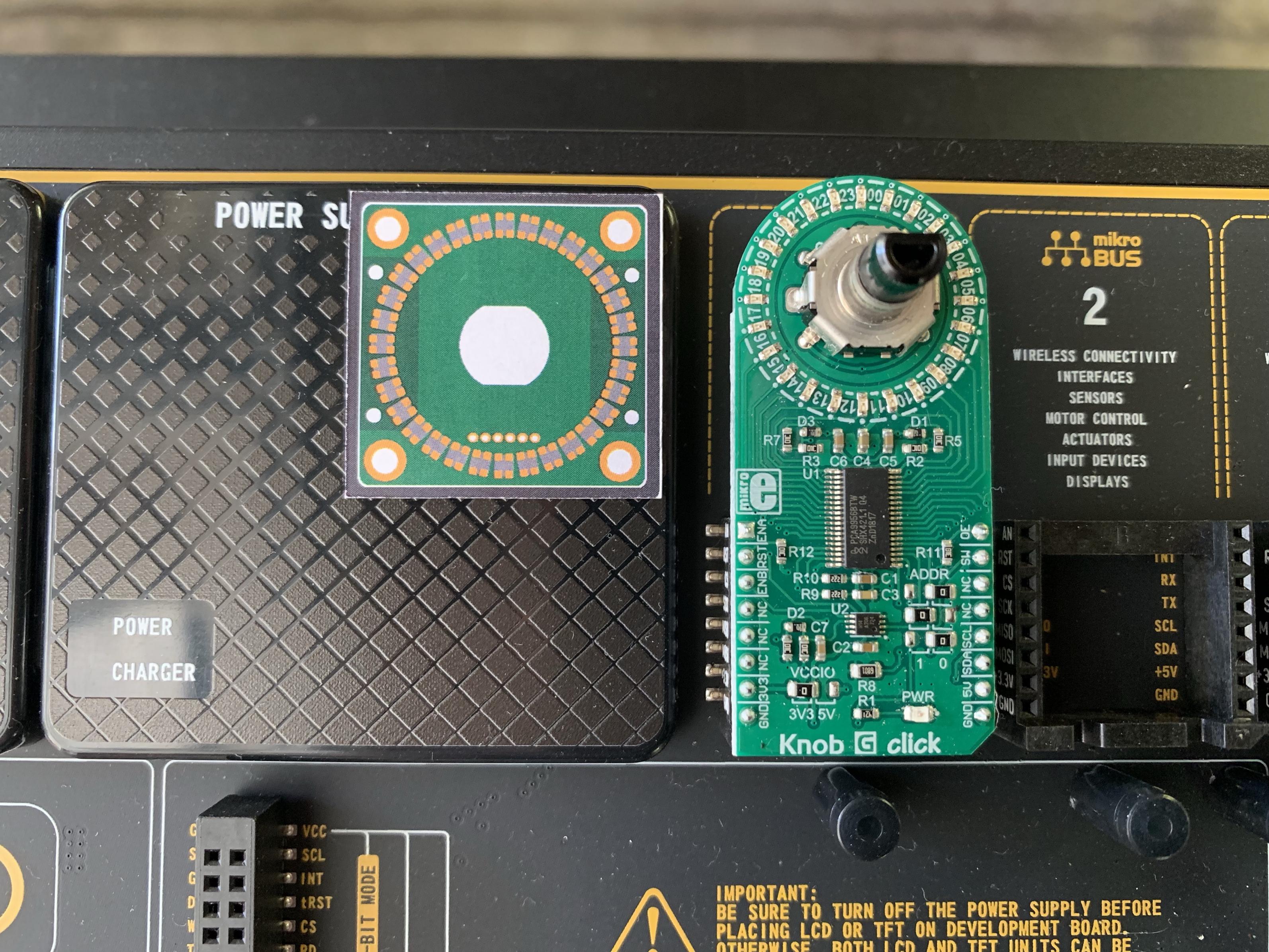

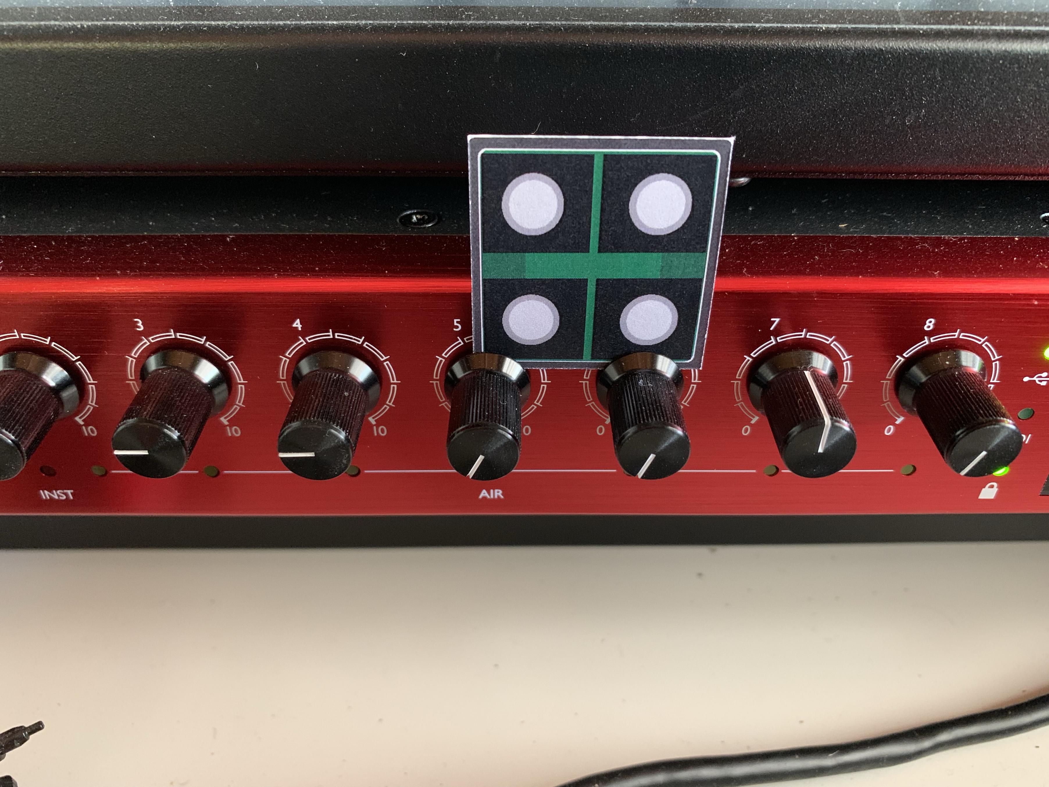

Sizing Mockups
Here are some sizing mockups for the E1, E4, and P4 bricks.
The first one is for the E1 single encoder brick, standing next to the Knob B Click. Our LED ring will be a tiny bit wider, which is nice. Other than that, this is a pretty straightforward brick as far as user experience is concerned.
The second one is for the E4 quad encoder brick, standing on top of the Focusrite Clarett 8Pre. Here, the encoders are clearly much closer to each other and will need really thin knob caps. This brick should be evaluated in relation to much smaller knobs, such as the ones used by the six small potentiometers on this instrument.
The third and last one is for the P4 quad port brick. This one is standing on top of the Behringer Neutron synthesizer. Here, the ports are slightly closer to each other, but not by much, and this should be totally manageable.
Bottomline, I think we're still good to go with this design.

LED Board for P4 Brick
Yesterday, I posted this picture of the LED board that will be installed within the P4 brick, directly mounted on top of the base board and underneath the top cover board. This board has 4 sets of 5 WS2812C-2020 serially-controlled LEDs. The board is shown on its own on the right, and mounted on top of the base board with four TRS ports on the left.
Now, if this was not already obvious, I should point out that this middle PCB will wrap around the four vertically-mounted TRS connectors. And because the WS2812C-2020 is running on 800kHz, this might create some unwanted interference. Therefore, I am planning to split the LED board into two separate sections that will be isolated from each other. Therefore, since the WS2812C-2020 needs four circuits (VDD, GND, IN, OUT), we will use two sets of two 2.54mm headers, with one pair for each side of the board. That way, the board will stand on top of four dual-circuit headers (one on each corner) and no high-frequency current should wrap around the TRS connector.
Granted, these ports will be used for modular audio synthesis, which really does not need any kind of Hi-Fi treatment. Nevertheless, we'll still try to follow some best practices. And if there are other things that we can do to make things even better, please let me know.
Of course, we could use regular LEDs, but these would require a dedicated IC for driving them, and twenty is not a good number for RGB LEDs (most drivers go up to 48 channels, which means 16 LEDs), and 5 levels are a lot better than 4 (subjectively speaking, a lot better than 25%, because it gives you three normal blue/green levels, one orange, and one red).
