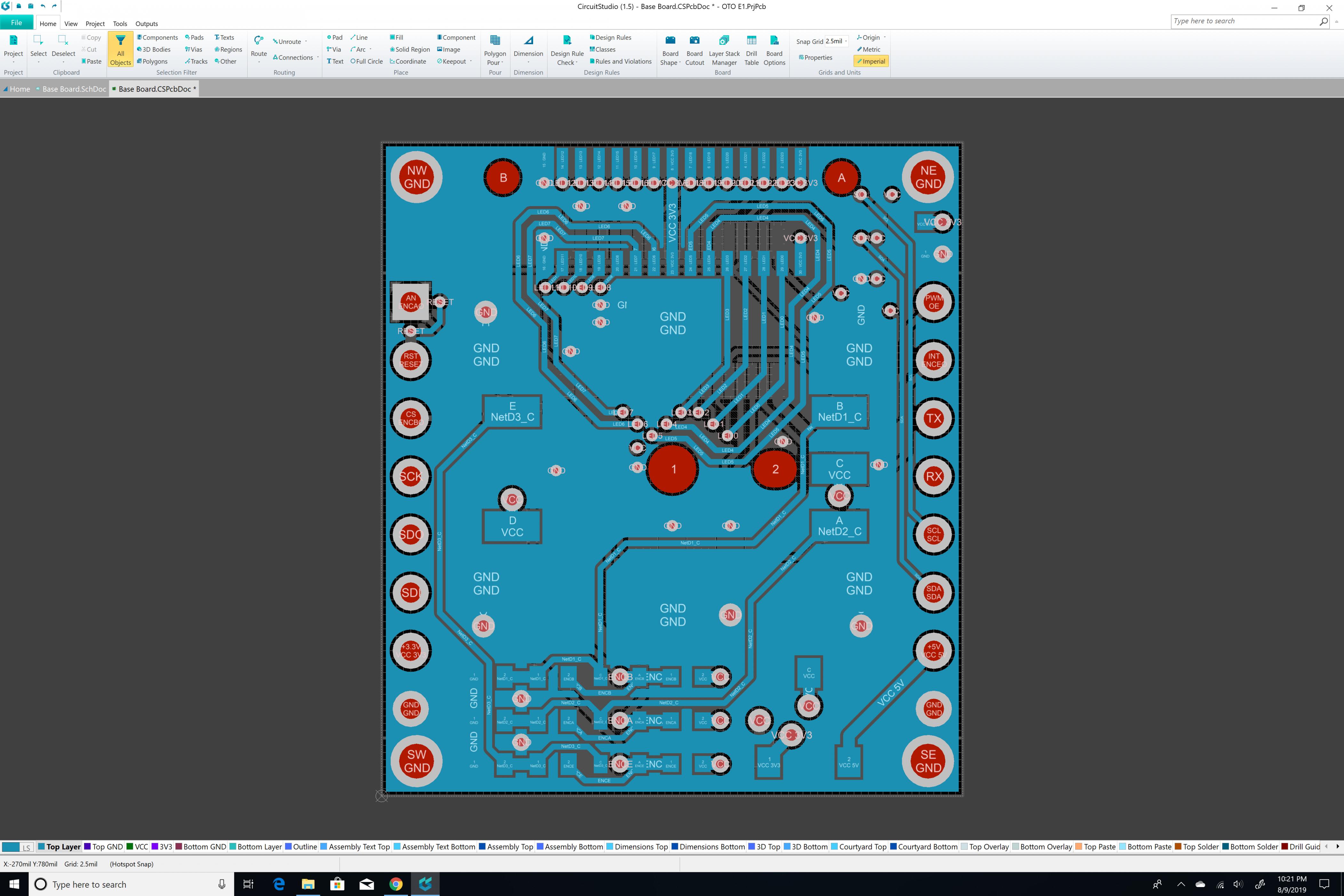

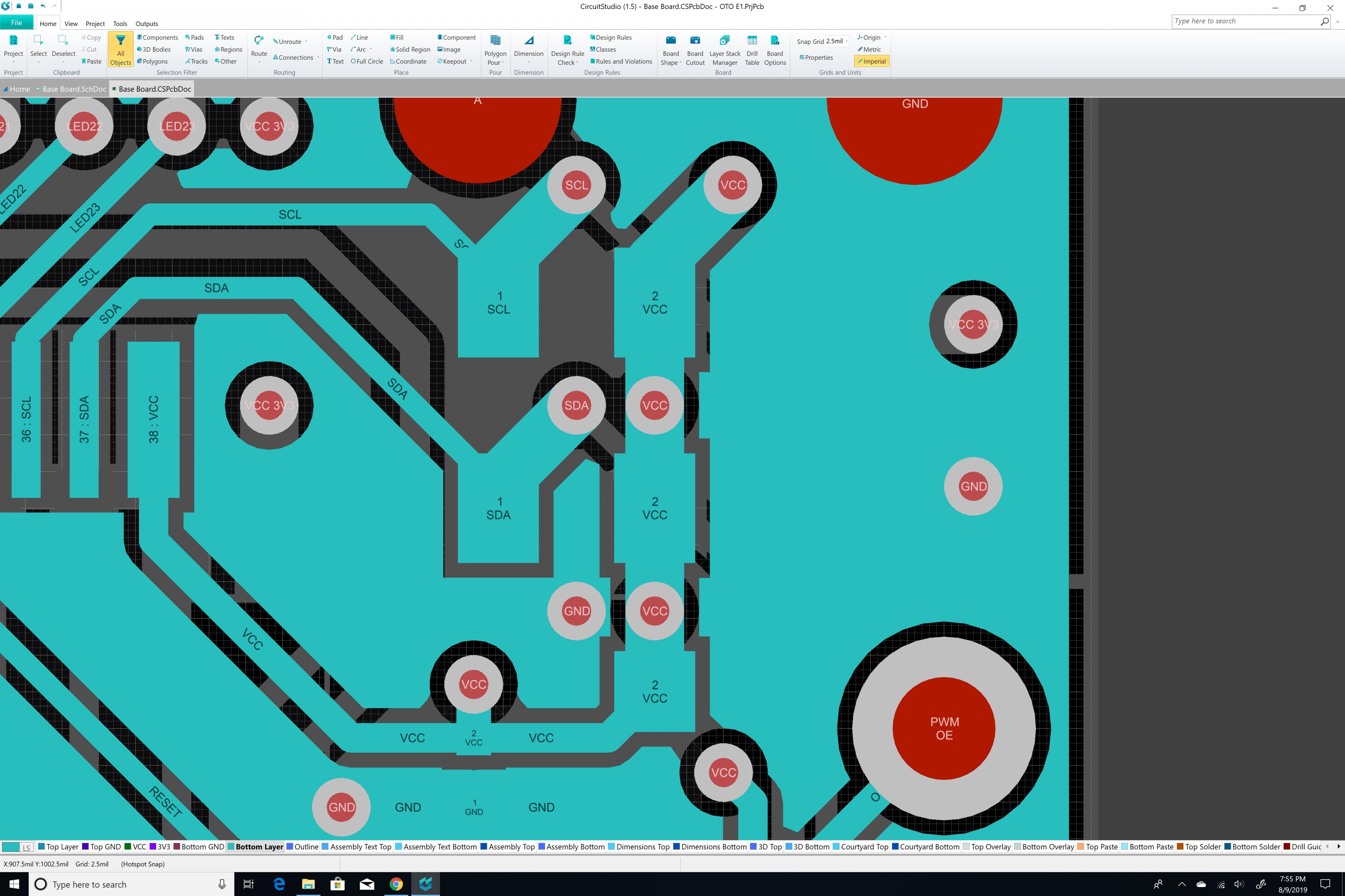

Over the past couple of days, I have learned two first-order lessons:
1. Vias are cheap. Use them whenever you need.
2. Layers are cheap (to a certain extent). Don't be afraid to go with 6 layers. It makes everything a lot easier.
I also re-learned a second-order lesson that I already knew but became even more apparent: a board design should be done in an iterative fashion. Of course, we do that already by breaking down the design into two main phases: schematic and PCB. But that's not enough. Once the schematic has been done, a rough PCB design should be done on paper, to make sure that the main constraints can be resolved. Otherwise, a lot of EDA time might go to waste...
And this is especially important for boards that deal with user interfaces, because these have very strong mechanical constraints, and dealing with the interplay between mechanical and electrical constraints is where the challenge lies.
Also, I have a much better appreciation for two things:
1. Parts should be selected very, very carefully.
2. Components should be added only when absolutely necessary.
Unlike software features, hardware features are really expensive and have a lot of side effects. Therefore, before adding a feature, one should seriously consider whether the feature is absolutely necessary or not. And if it is not, it should be discarded.
In other words, it's all about learning how to say "No!"

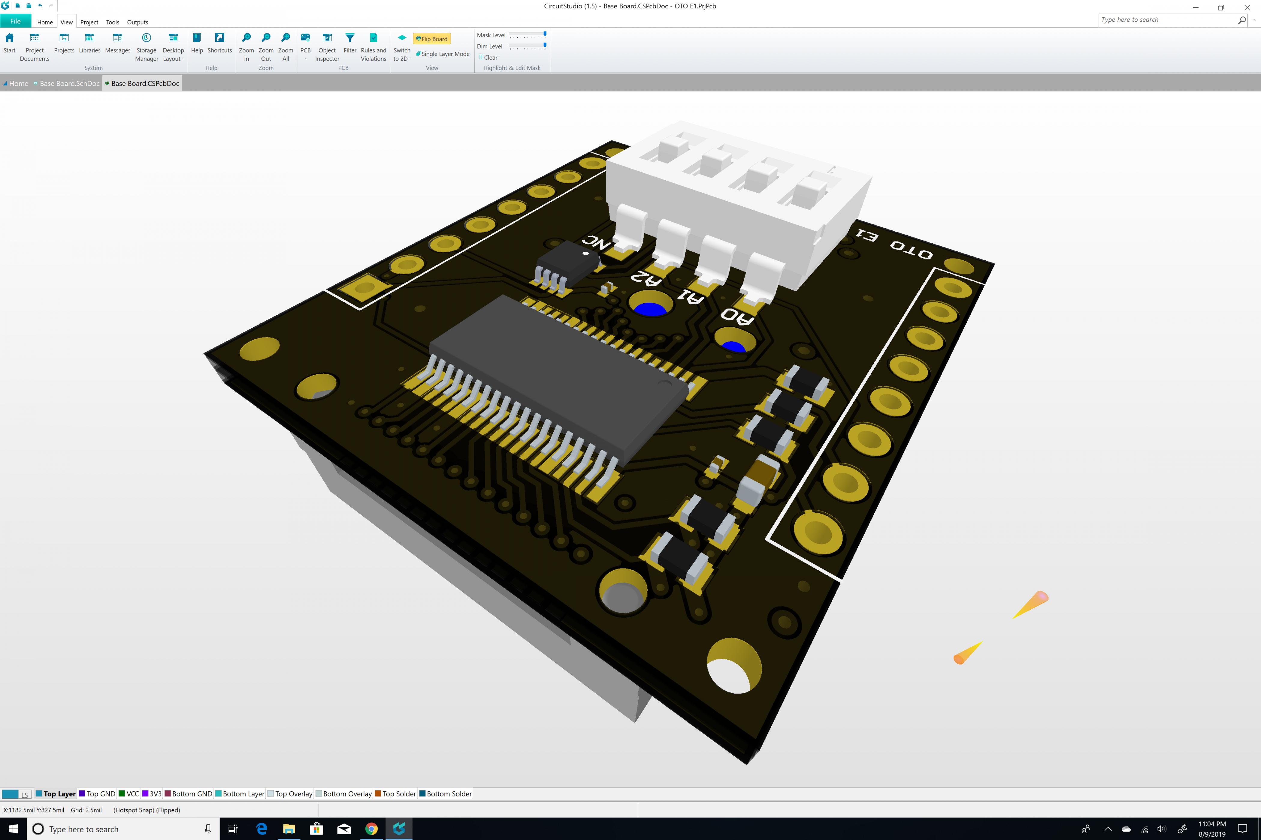

Unintended Consequences

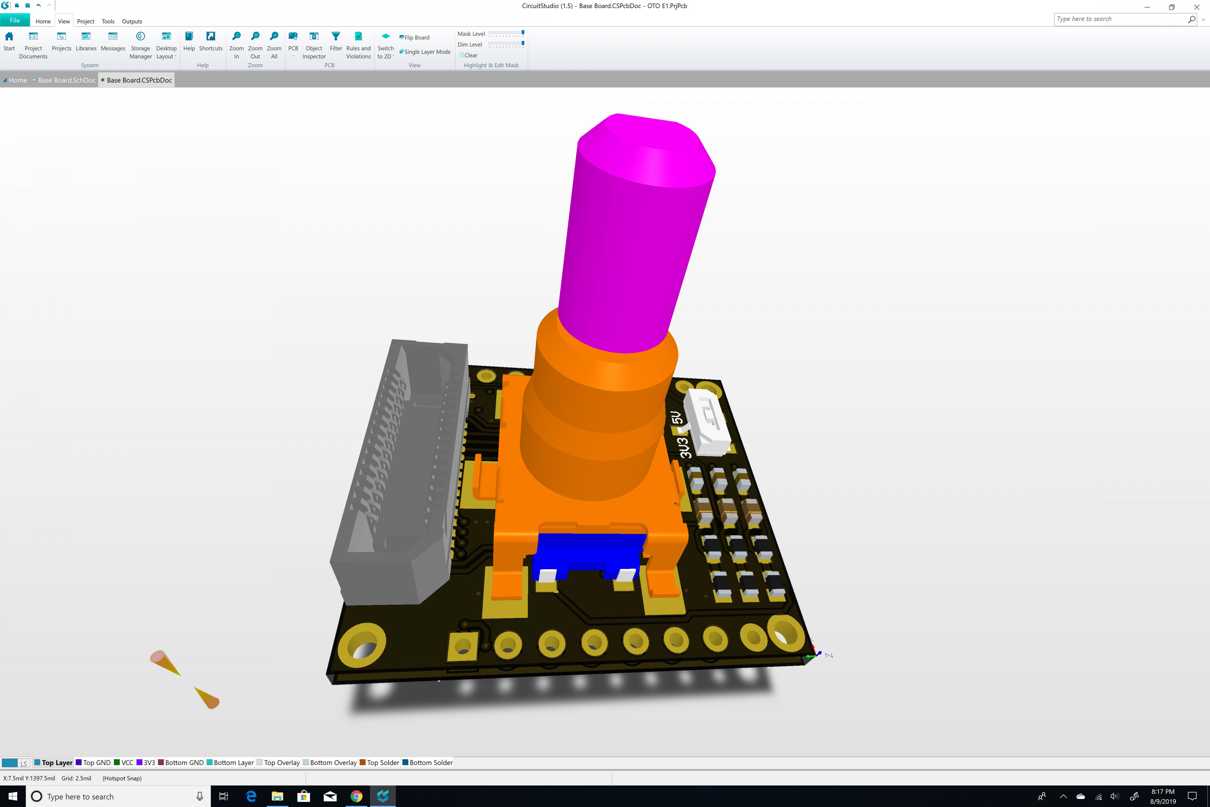

Here is a great example of the interplay between seemingly unrelated mechanical constraints: yesterday, we found a way to center the rotary encoder on our board. This was great, because it made it super easy to center the encoder on the brick itself, both horizontally and vertically. But this came with a totally-unintended consequence: it reduced the maximum diameter of our LED ring. Let me explain why.
As you can see on this screenshot, there is not a lot of space between the Hirose connector for the mezzanine board on which the LEDs will be mounted and the shaft of the rotary encoder. In our previous design, the encoder was rotated by 90 degrees and was mounted further away from the Hirose connector. But when trying to center it on the board, we had to mount it in a rotated fashion, and we had to bring it as close as possible to the mezzanine connector. At first, this seemed like a great idea.
Unfortunately, we later realized that it would come at a cost: the Hirose receptacle on the base board has to be matched by an Hirose plug on the mezzanine board, and this plug will itself be quite close to the encoder's shaft. As a result, the space we have for our LED ring between the connector and the encoder will be quite limited, and it certainly won't allow us to use as large a knob cap as we expected.
Fortunately, this does not seem to be a deal breaker: all we'll have to do is push our LEDs as close to the Hirose connector as possible, and settle on slightly smaller knobs. But this is a good lesson for the future: whenever we make an Engineering Change Order, we should give very serious thoughts to all its side effects, be they electrical, mechanical, or financial.
Engineering 101...
Engineering 101...

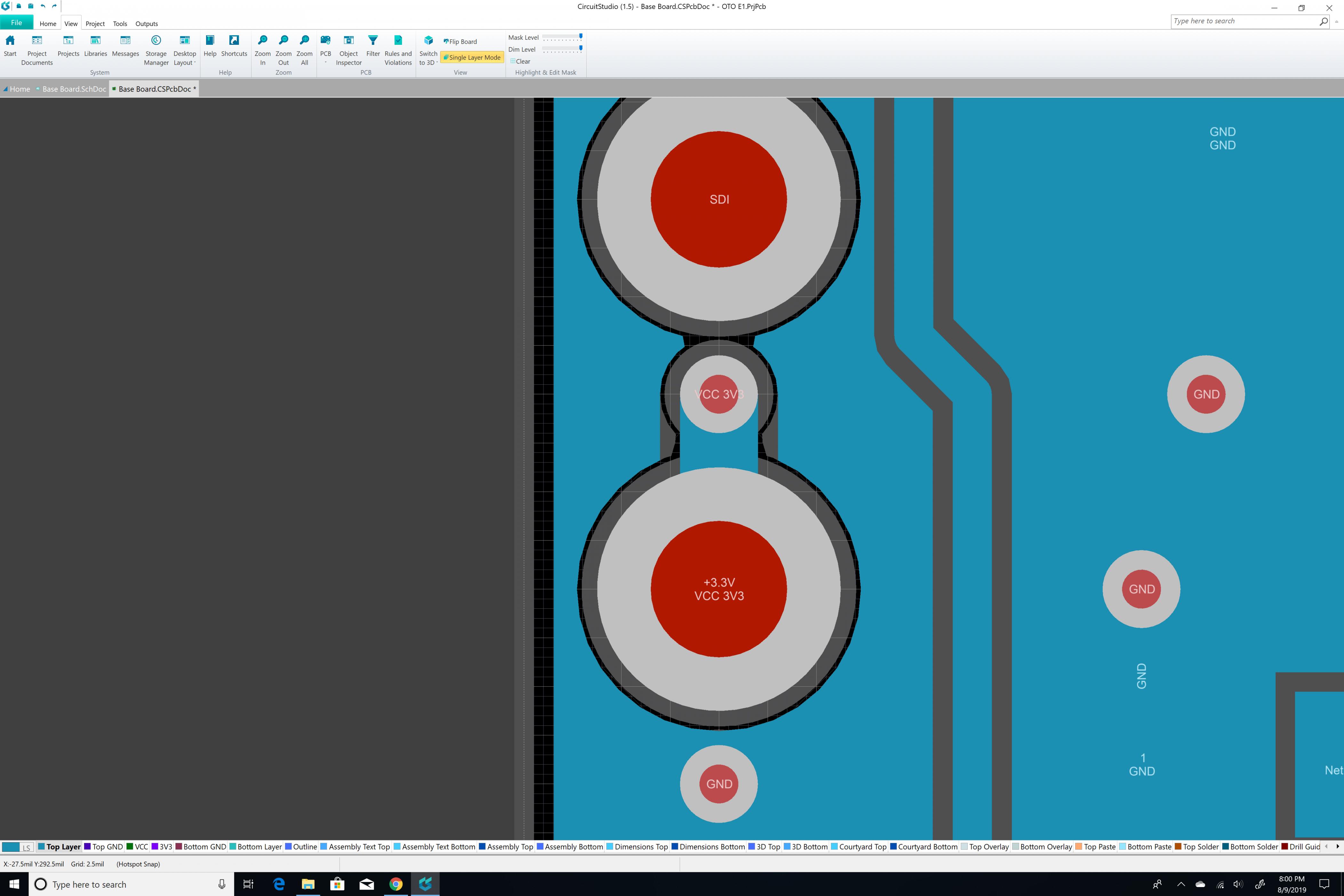

When you get there to order the pcb, you will certainly need to generate Gerber format output files.
Check those files with an external viewer tool (like freeware : "gerbv").
Note: internal plane layers usually come in negative (inverse) in gerbers. If you use internal planes, use them only for power, don't use it for any routing!
Yes, of course. I am using internal planes only for VCC, 3V3, and GND.
Thanks a lot for the heads up though, much appreciated!
