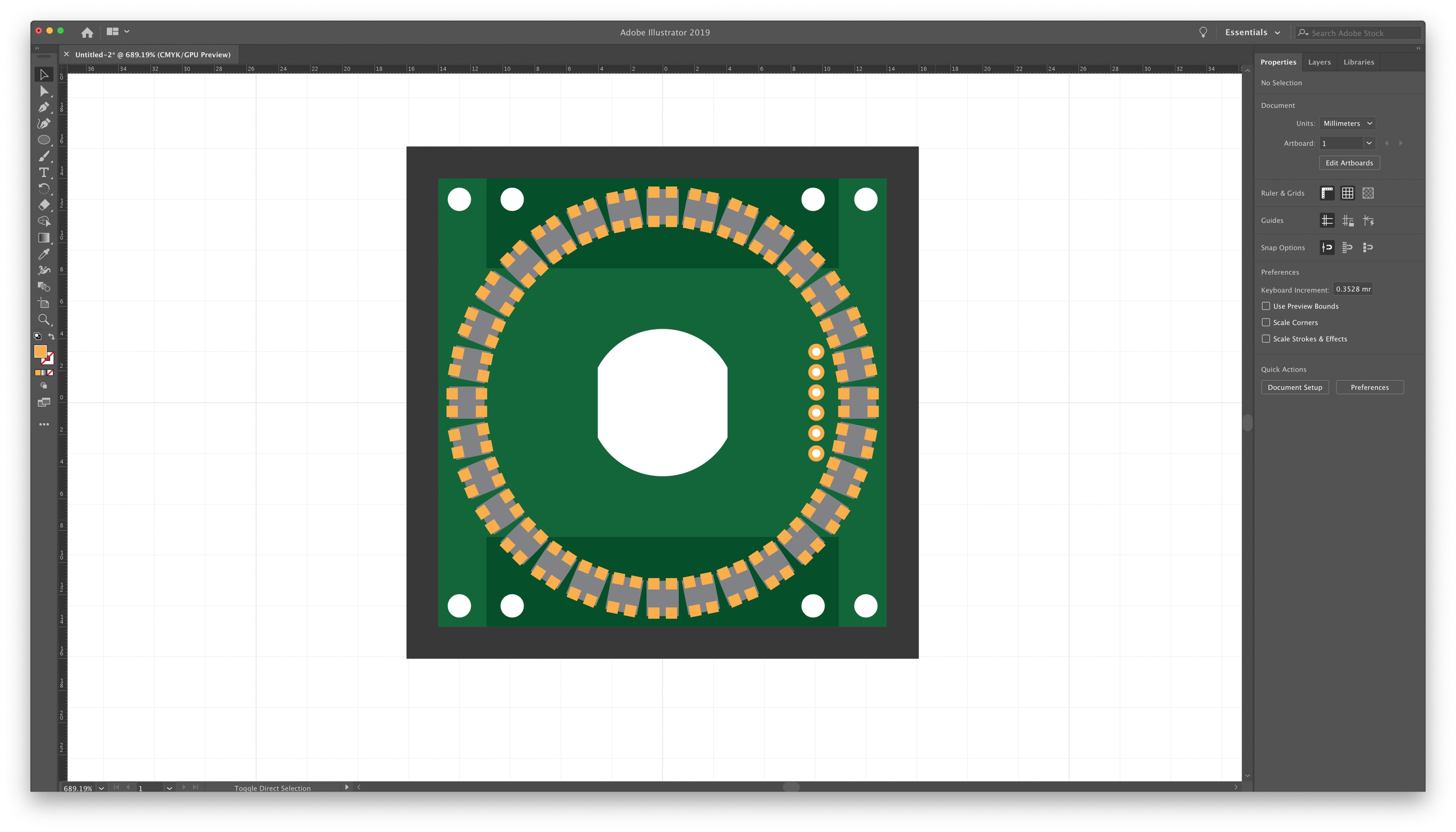

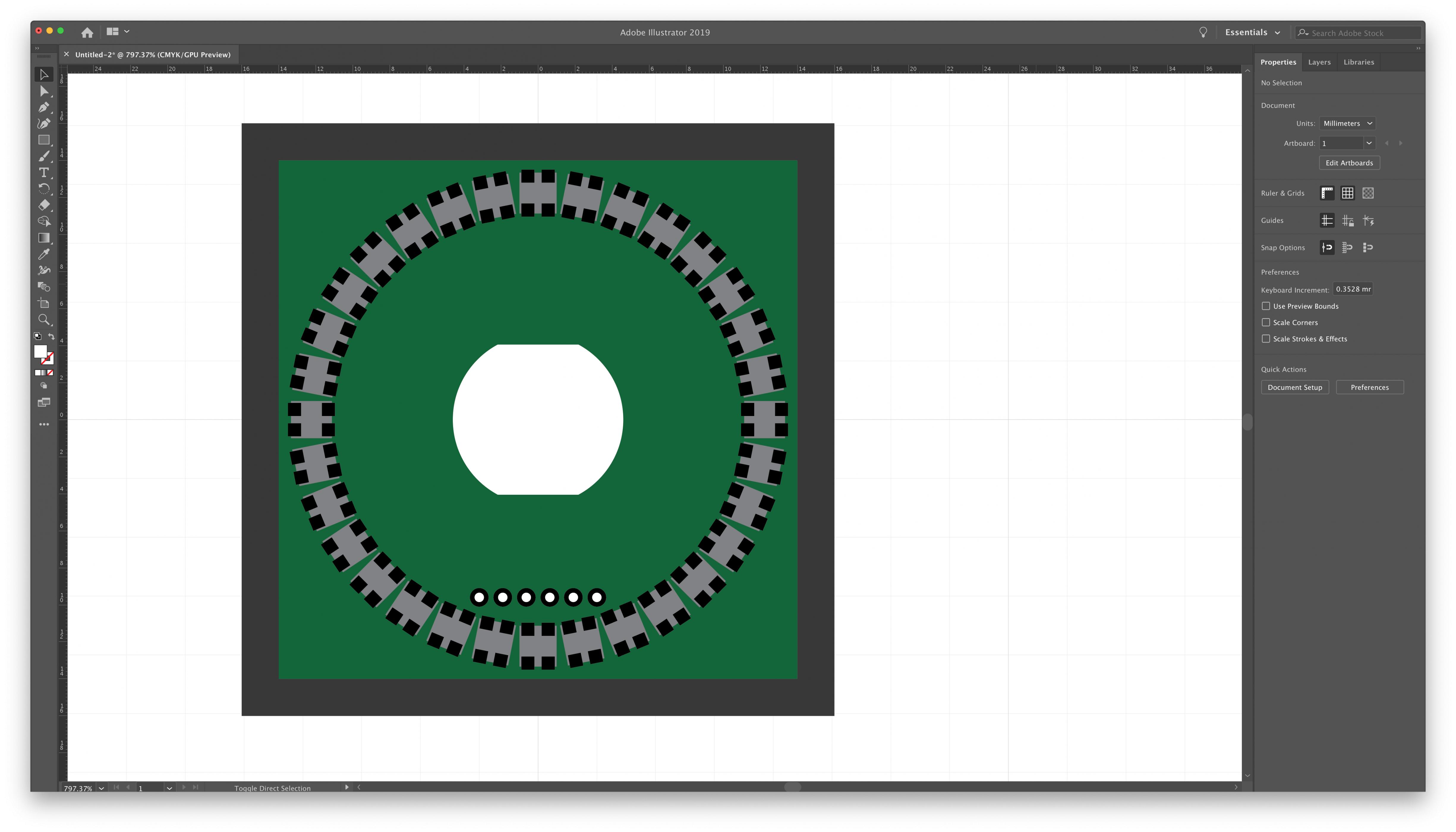

RGB LED Ring
Here is an outline of the LED ring with 32 × WS2812C-2020 RGB LEDs. Surprisingly, the 2022 package has a smaller footprint than the 1515, so we will stick with it. The ring has a 27mm diamater, which will fit comfortably on our 28mm × 28mm board. Each LED needs a 100nF capacitor, which will be placed on an inner ring, and we should not have any problems making them fit either.
As far as I can tell, this should work...
As a sidenote, this pattern creates a nice optical illusion making the rectangles look like trapezoids...

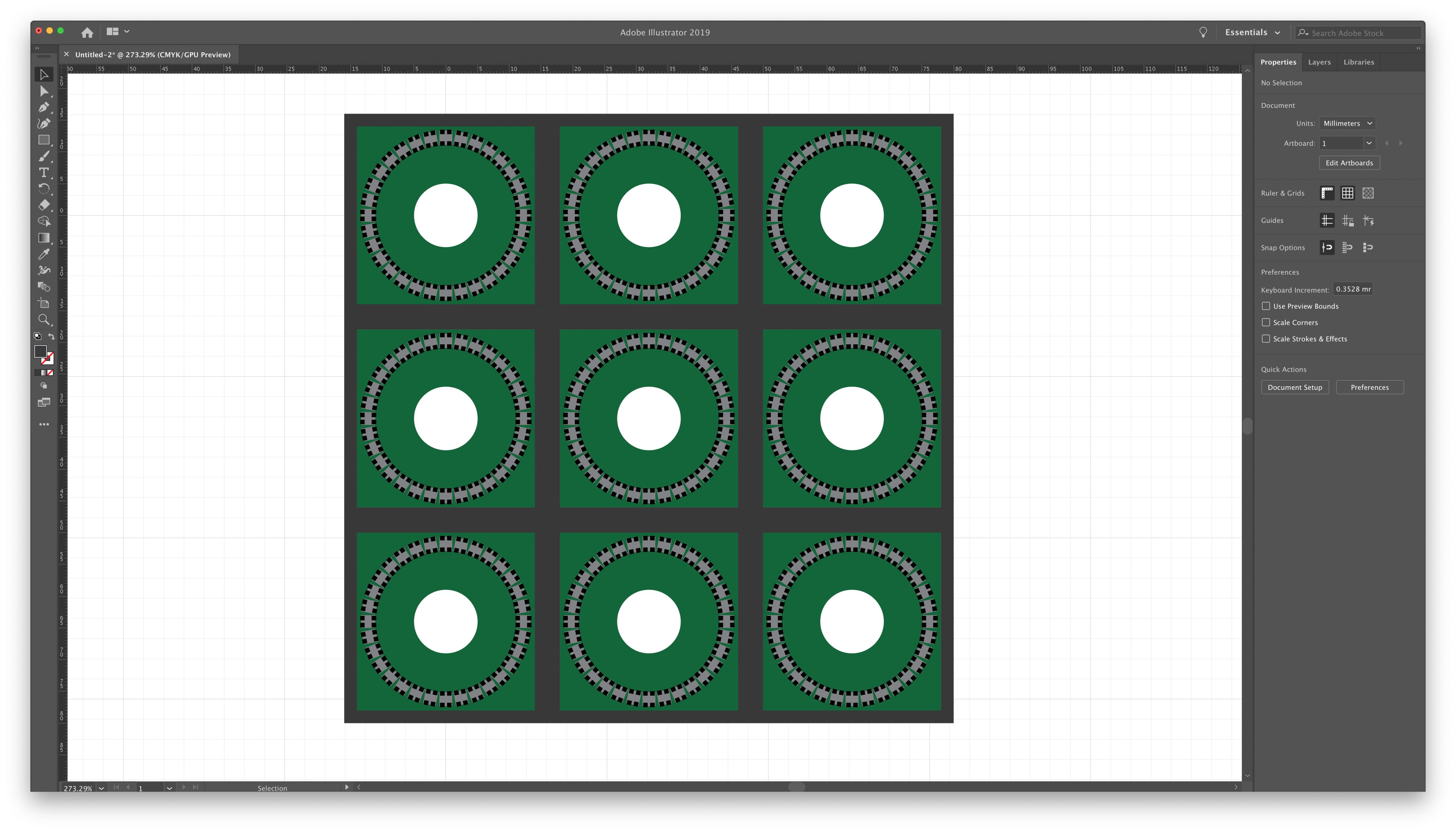

9 E1 Bricks on a Plate
Here is another interesting sketch: this one shows 9 × E1 bricks on a 96mm × 96mm plate. The boards are 28mm × 28mm and the bricks are 32mm × 32mm. This sketch demonstrates that the rings will not be too close to each other. Also, the round holes have a 10mm diameter and will let the shaft of the encoders through. This shows that we will be able to use this brick with knobs that have a 20mm diameter (in fact 22 or 23mm would still work). And this layout still leaves plenty of space in the corner for conventional fastening hardware.

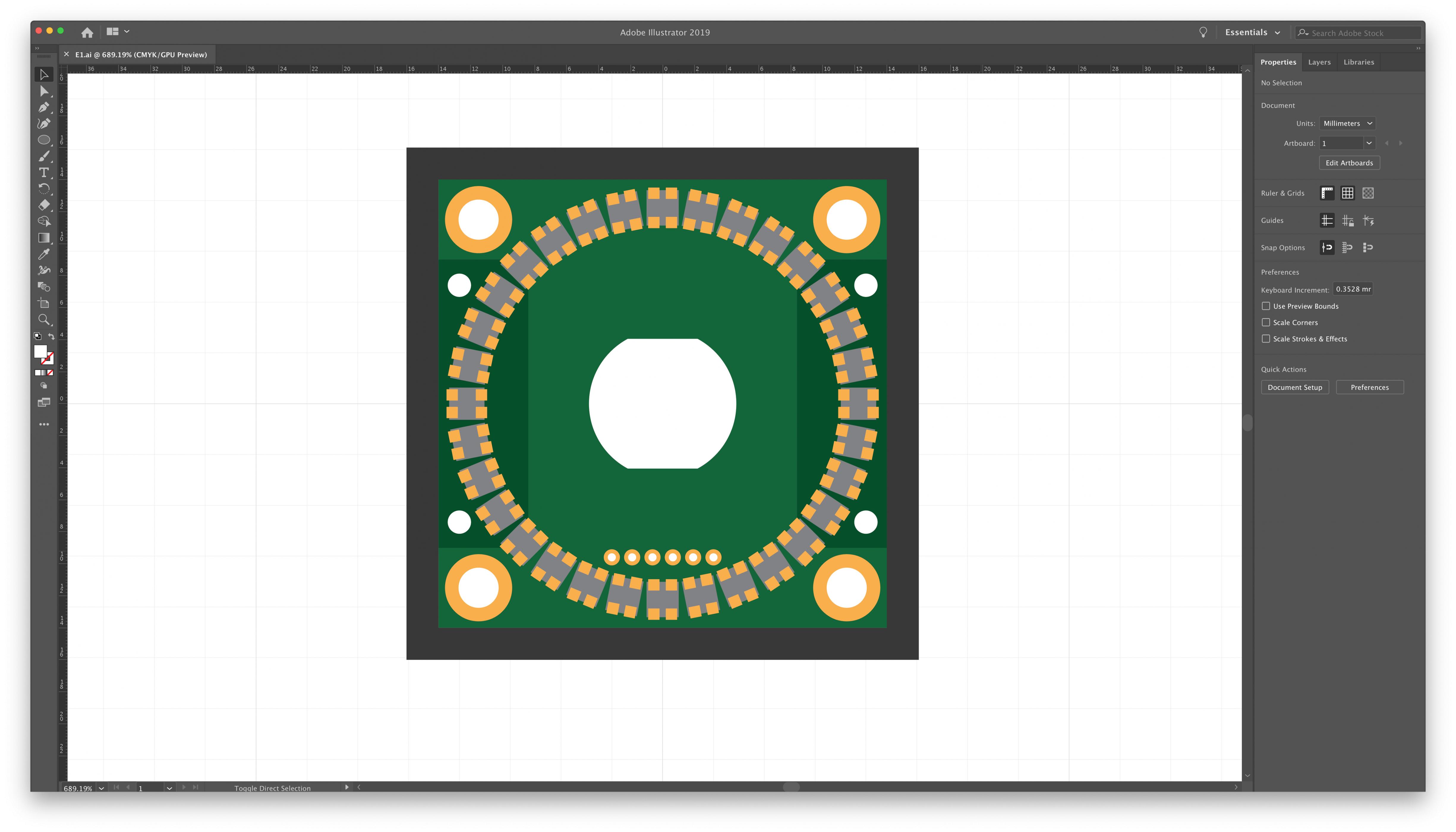

Encoder on board
Here is how everything would fit on the board. Again, it's a tight fit, but it seems like it's going to work...
Note: I'm doing all these sketches in Adobe Illustrator, because it's a lot faster than creating all the footprints for components that we might not need in the end.

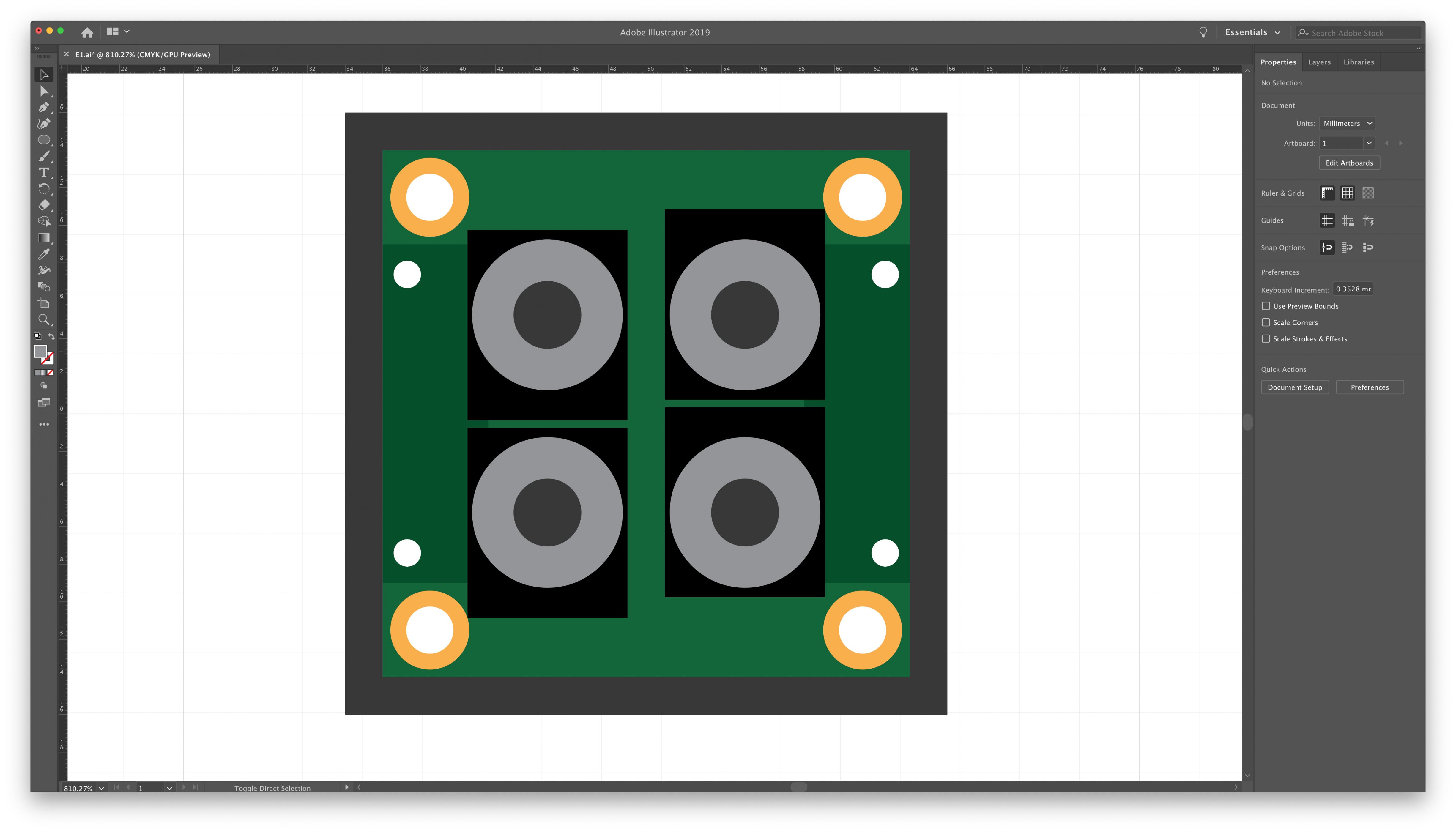

P4 Brick
As a proof of concept, here is a sketch for the P4 brick made of 4 Audio/CV ports, using the Kobiconn 161-MJ355W-EX TRS connector. The connectors must be offset in relation to each other if we want to preserve a regular pattern on the top cover, because they are not symmetrical, and because we can make them overlap the underlying Hirose connectors a little bit without their through holes interfering with the soldering pads of the Hirose connectors. Nevertheless, this goes to show that they would fit within our planned form factor. That being said, I really wish that we could space them apart a bit more in order to get a more regular pattern when multiple such bricks are used on a plate. With the current arrangement, the TRS connectors will be clustered in groups of four that might or might not reflect any logical arrangement with respect to the instrument that they are supposed to be part of. In fact, this is probably not good enough, but for the time being, it will do...

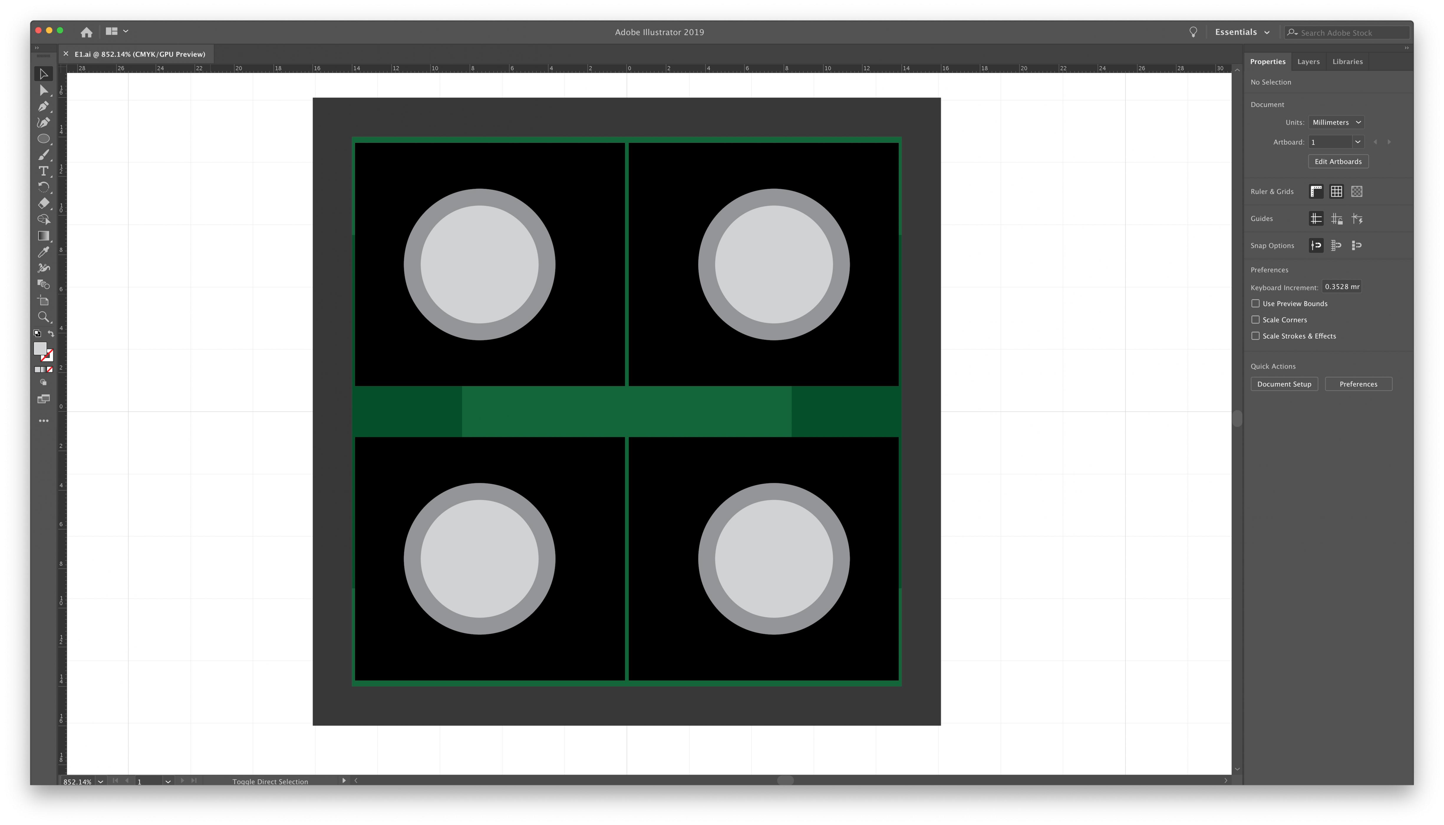

E4 Brick
This one is quite interesting as well. It shows a sketch for the E4 brick, which is made of 4 × 291V1022F832AB rotary encoders. These were selected because they are really small and expose all their pins on one side, yet provide 32 detents. What this shows is that they will fit, but they will obstruct the through hole for fastening hardware, and they won't leave any room for any components on the top cover (but none were required so far). In fact, there is probably enough room on the bottom side of the board to put the debouncing circuits and Schmitt triggers that were on the original design. Also, the current arrangement is almost perfectly regular, in the sense that encoders would be spaced almost evenly if multiple such bricks were to be mounted on a single plate. In fact, we could make this layout perfect if we were to go from 28mm × 28mm to 29mm × 29mm for the PCB dimensions. This extra mm would make the walls of our frames 0.5mm thinner, but it could add quite a bit of flexibility for many high-density bricks (increasing the diameter of the LED ring on E1 by 1mm for example).
What I should mention as well is that the encoders used for the E1 and E4 are now optical encoders, instead of the mechanical encoders that we were planning to use originally. These are quite a bit more more expensive (about $20 a piece for 1, $10 when buying 1K), but durability goes from 150,000 cycles to 1,000,000 cycles. And I also expect their mechanical feel to be subjectively better, but this will be tested this week by ordering some sample parts.

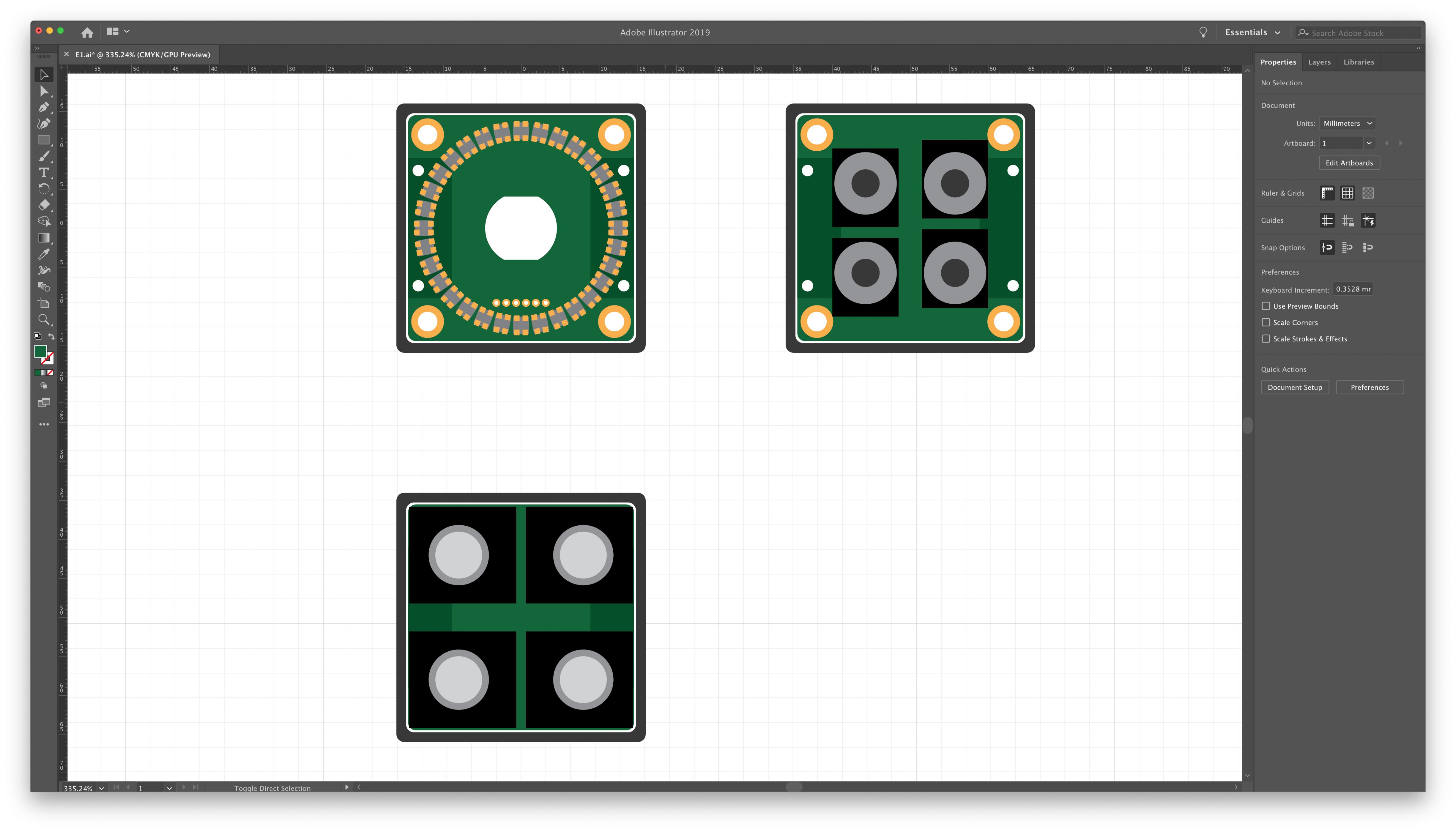

29mm × 29mm Boards
Here are what the boards look like at 29mm × 29mm. With this resizing, the E1 board looks a lot more manageable, while the E4 brick offers a perfect layout. Now I need to find better TRS jacks that would give us a perfect layout for P4 as well.

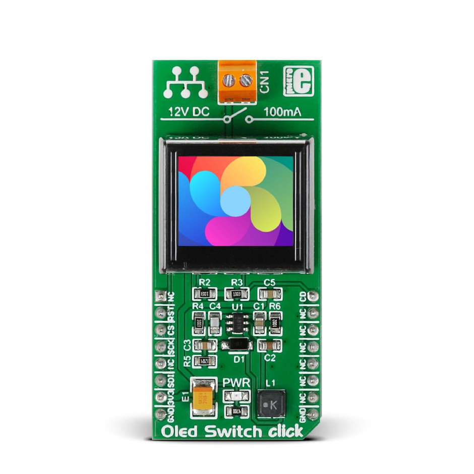

OLED Switch Click
Mikroe just released the OLED Switch Click built around the NKK Switch ISC15ANP4. We will give it a try.
