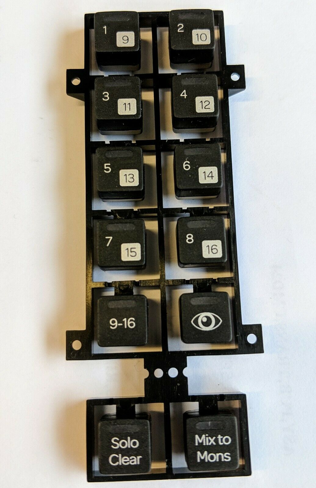

...buttons are needed for manually triggering repetitive actions, like playing a sound...
You might check out the buttons on MIDI beat box control surfaces at a local music store. Guitar Center in Sunnyvale has floor inventory of such things. The point is that one must be able to tap out a groove on a button used to play a sound, and to work well for that it must be possible to tap it very quickly with little movement, yet without any false triggering. Tactile switches may or may not be suitable depending on the particular switch characteristics.
Indeed, but the buttons I am talking about won't be used for that. Instead, what you are describing will be handled through pads, like the ones found on many MIDI control surfaces. That being said, I have not focused on bricks for these yet, for two main reasons: first, for the life of me, I could not find the right components for them, mostly because I must be doing my searches with the wrong keywords (pointers much appreciated); second, because I am planning to use a LinnStrument 128 on my reference setup (it provides 128 of these pads and comes with some awesome open source software; and Roger Linn is one of my heroes).

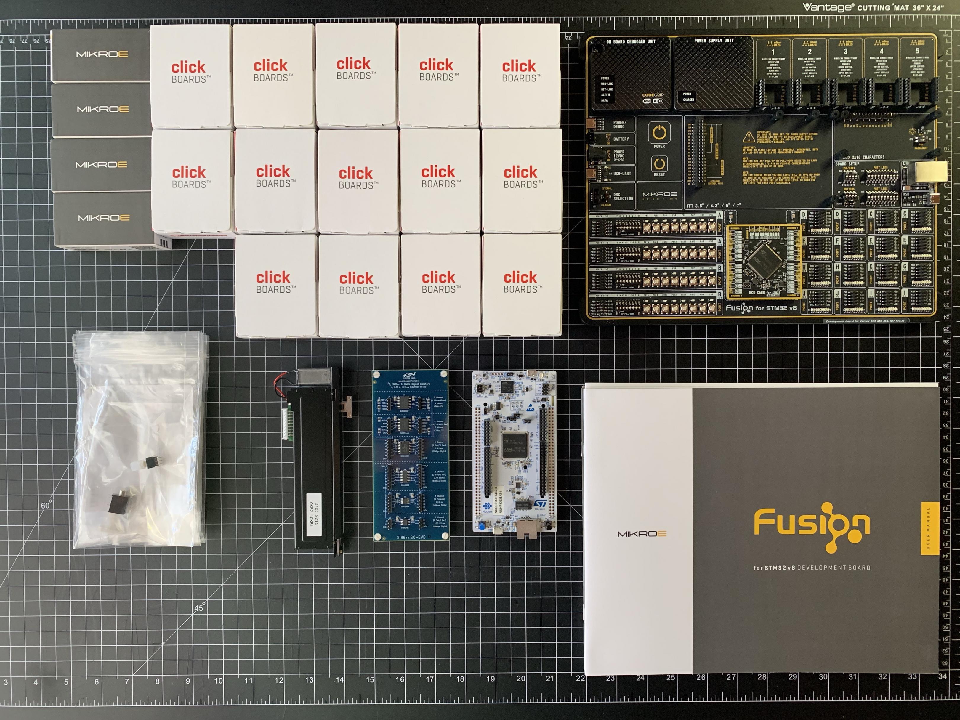

Development Kit
Santa Claus disguised as a FedEx delivery man made a stop at my place this morning...
- MikroE Fusion development board
- 18 Click Boards
- NUCLEO-H743ZI2
- Silicon Labs Digital Isolators
- Bourns PSP Motorized Fader
- Various Controls and Hirose Connectors
I am happy to report that the MikroE Fusion is absolutely first class. The quality of the construction is amazing. The whole thing is essentially a massive 3.25mm thick PCB. It feels really, really good, and it makes me want to build our USB grid using the same process. Also, the MCU card is 61mm × 61mm, which is perfect for what we need. Now, we just need to get the right MCU for the Thesycon U-Hear firmware, or build our own.
Time to play with all that stuff...
- 18 Click Boards
- NUCLEO-H743ZI2

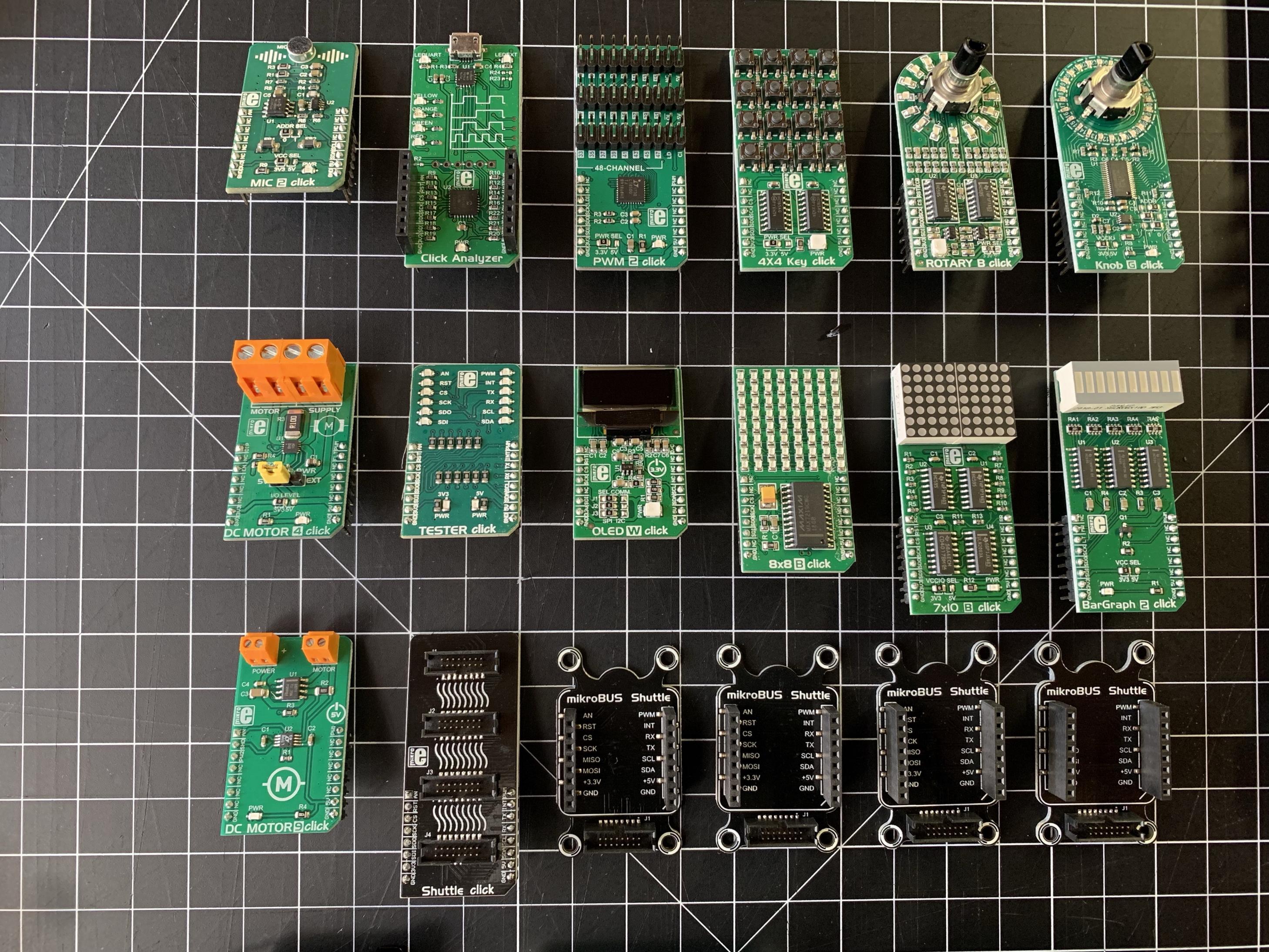

Click Boards
Here are the 18 Click Boards that we got. They are really, really well made.
And I was not sure whether they came with soldered headers or not. They do.
Having bricks in that form factor will be really awesome, not just for controls, but also for analog ICs. Being able to put together a complete analog synthesizer with vintage ICs using 9 bricks on a single OTO plate would be awesome. And combining 6 of these on a board (new name for "grid") should be a ton of fun...

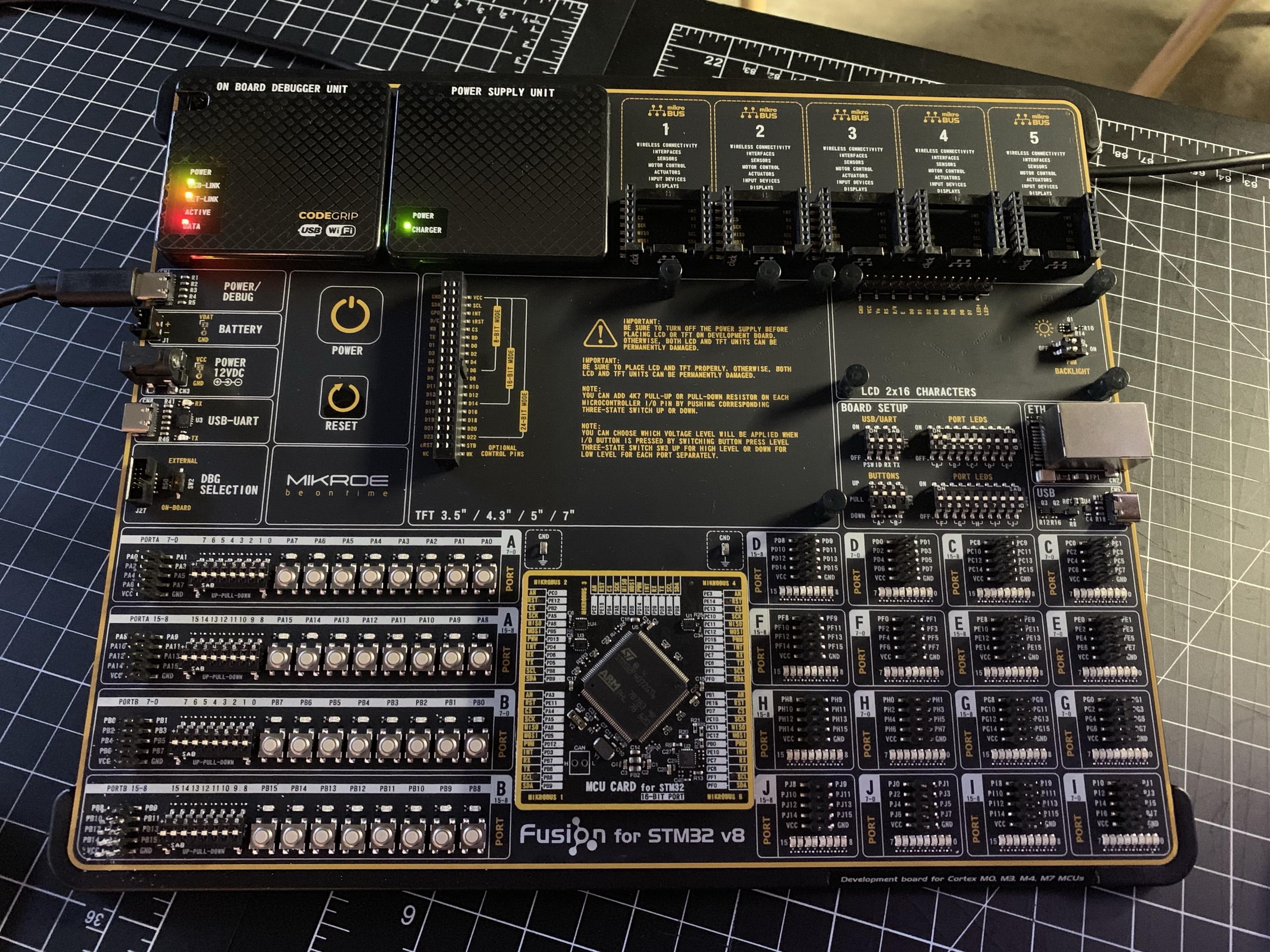

Mikroe Fusion v8 Up and Running
My Mikroe Fusion v8 development board is up and running. Since I have been using Macs for the past 20 years but did not want to take any chance with a virtual machine, I got a new PC running Windows 10. Now I need a compiler for the MCU, and I'll probably go for mikroC PRO, just to keep things simple. The large schematic printed on thick waterproof card stock is a really nice touch by the way... Mikroe originally started as a magazine and book publisher, and it shows: these folks know how to produce really good documentation for their products.
I've never used their IDE or compilers. For ARM MCUs I have used Keil many times in the past, they were purchased by ARM a few years ago. It's not cheap, so for a self-funded project I would look at using the STM32CubeIDE, which I think is Atollic TrueStudio that ST Micro purchased and made free for STM32.
I'm not saying the Mikroe stuff is bad at all, but I've never used it or know of anyone that has.
Great advice! I'm probably going to try a few before I find one that I like...

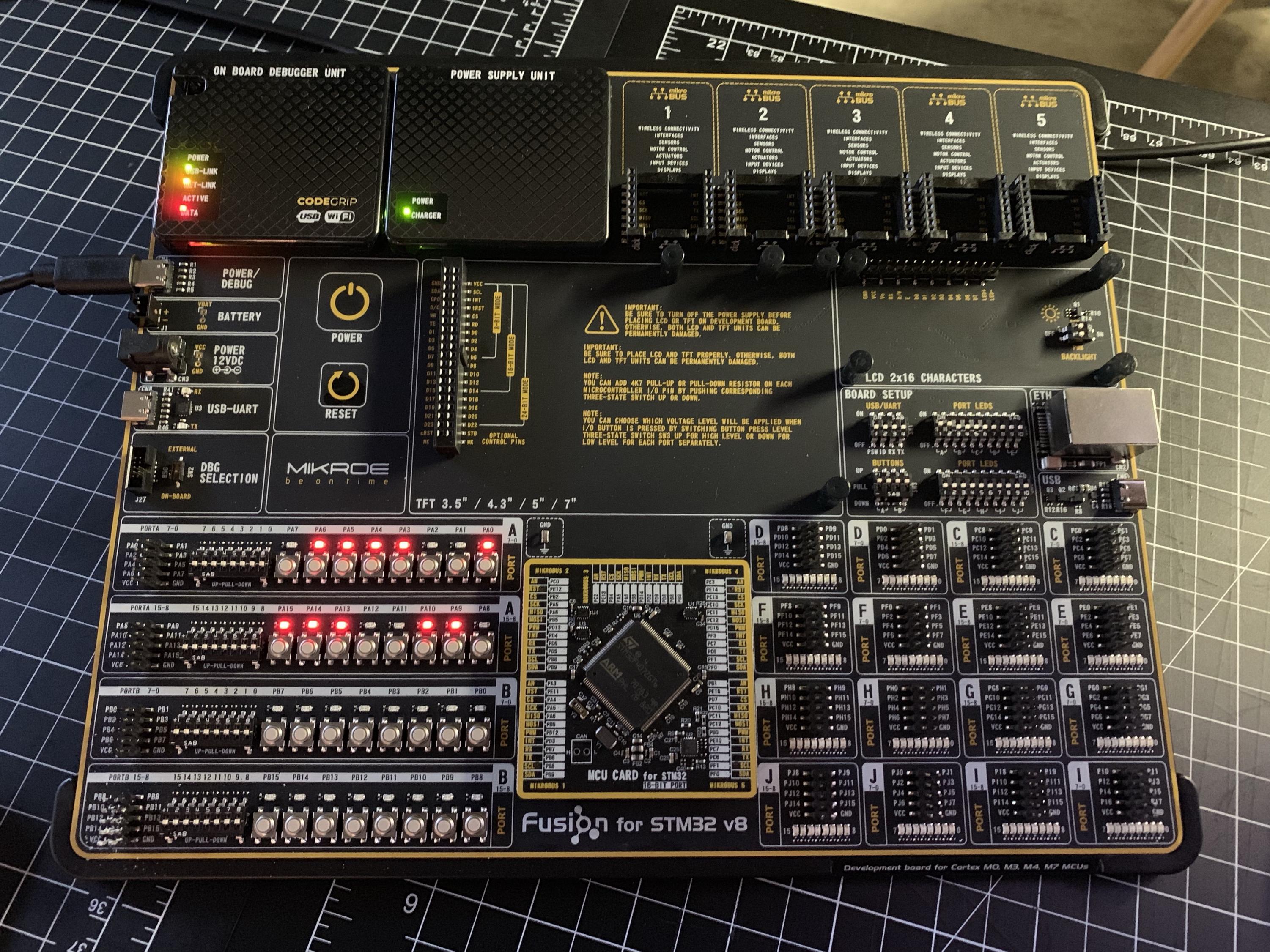

Blinking LEDs
LEDs are blinking, as they should.
The mikroC PRO IDE is a fairly conventional Eclipse-based IDE. A bit dated from a UI standpoint, but perfectly functional. The CODEGRIP Suite used to write on the MCU seems a bit flaky, but this might be due to user errors...
