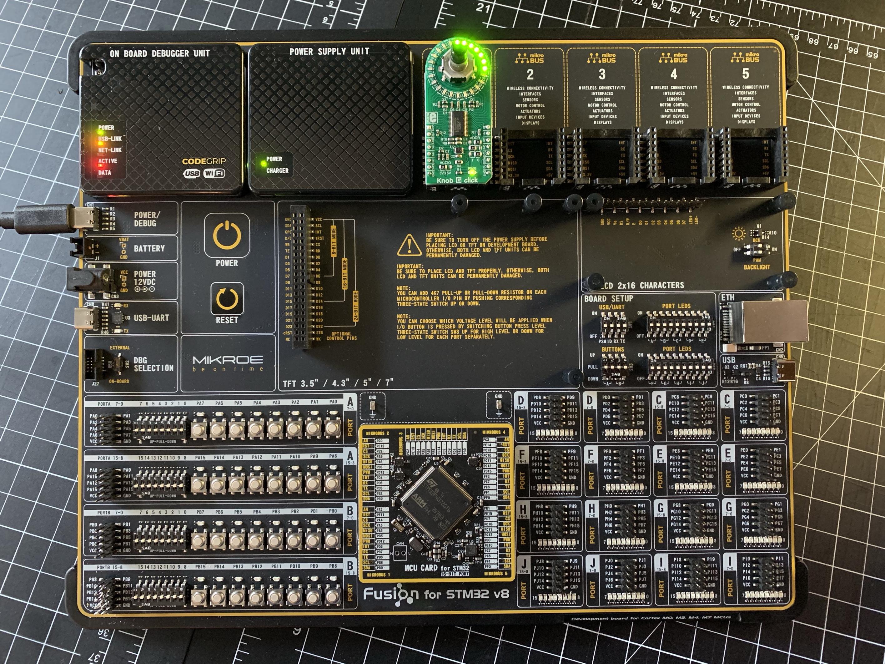

Rotary Encoder
Here is the Click Board which design we are planning to use for our E1 brick (single encoder with LED ring). The beauty of the MikroE platform is that each Click Board comes with a microSDK package available for 7 different platforms and for three different compilers (C, Basic, Pascal), alongside a sample application. This makes early prototyping super easy. The only challenges that I encountered were that I had to manually enter one path for a library, and comment out some logging commands for which an initialization variable could not be resolved (I am still trying to figure out why).
That being said, this little test shows that building our E1 brick won't be trivial, because with the sample code that I am using, the encoder easily skips some detents when rotated a bit too fast. I will play with different delay values, but this is a great example of the kind of challenges that we will face: this type of problem could come from the hardware, the protocol in use, the MCU, or the software, and fixing little details like that could keep us busy for a while. But this is all part of the fun I guess...

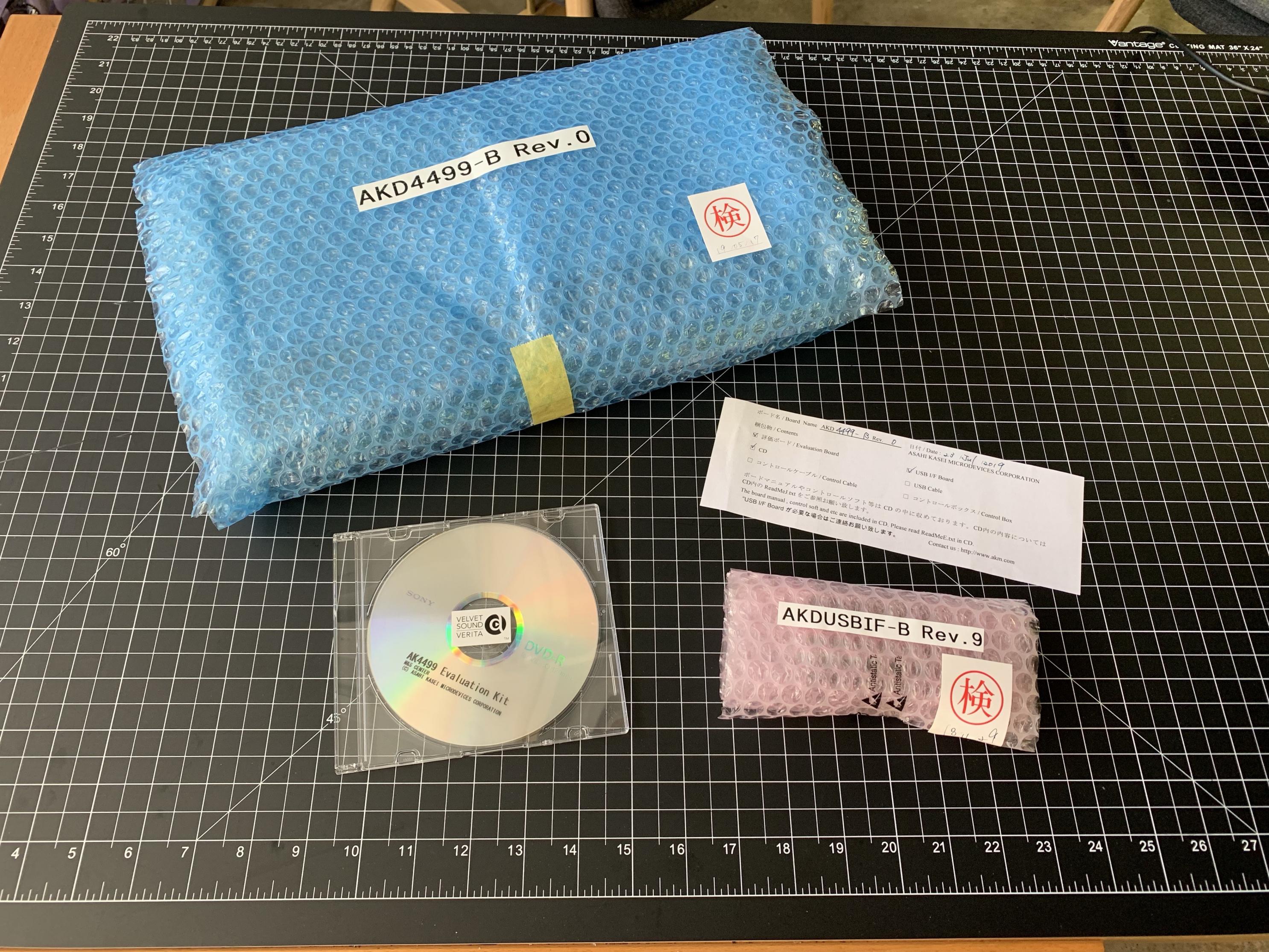

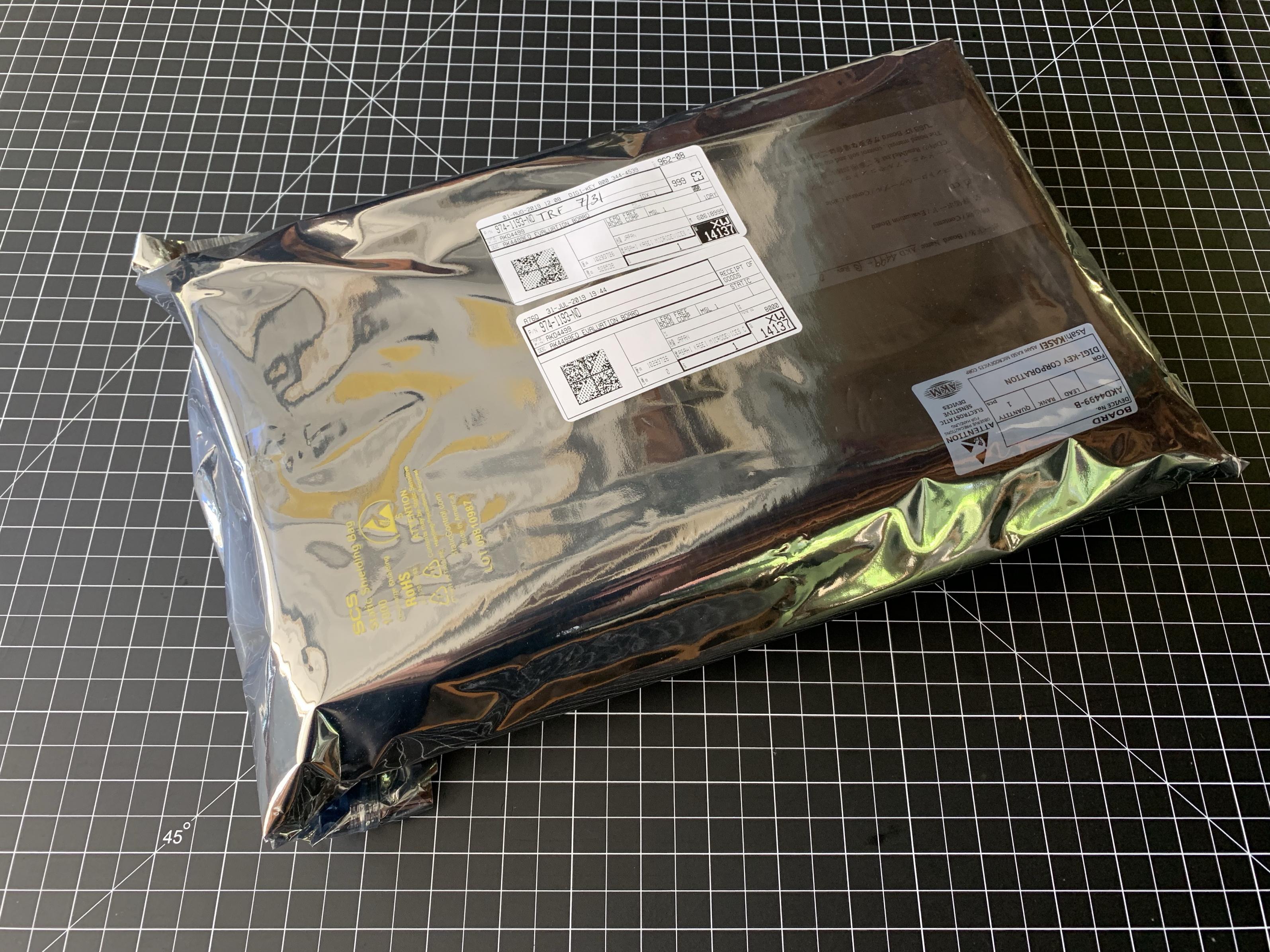

AK4499EQ Evaluation Board Received
I just received my long-awaited AK4499EQ evaluation board. The packaging is really well done, and the board is much, much bigger than I was expecting. It's also very well built, and it came with the AKDUSBIF-B interface, which I did not expect.
Now, I need to let it rest on my workbench for a while, because the last thing I want is to fry this baby with the wrong power supply...

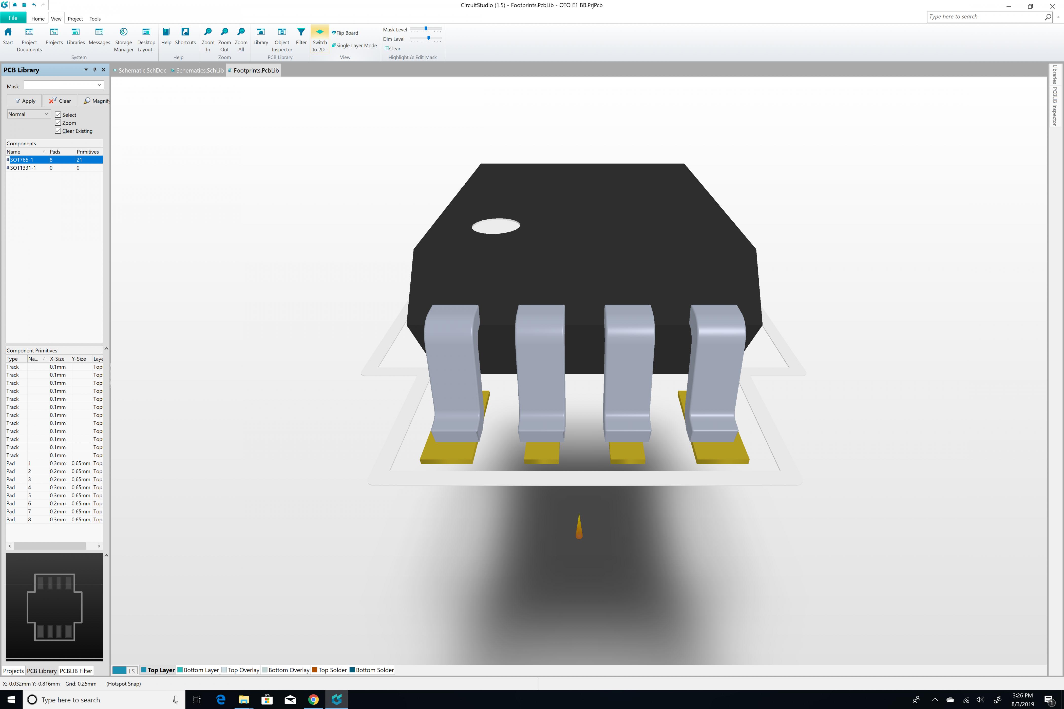

Altium CircuitStudio User Interface
I must say that I am really impressed by CircuitStudio's user interface: it's a lot more polished than anything I've used so far... And the level of configurability is great. I especially like the Inspector for editing multiple objects. This makes it a lot easier to create a custom look and feel for a component's schematic.

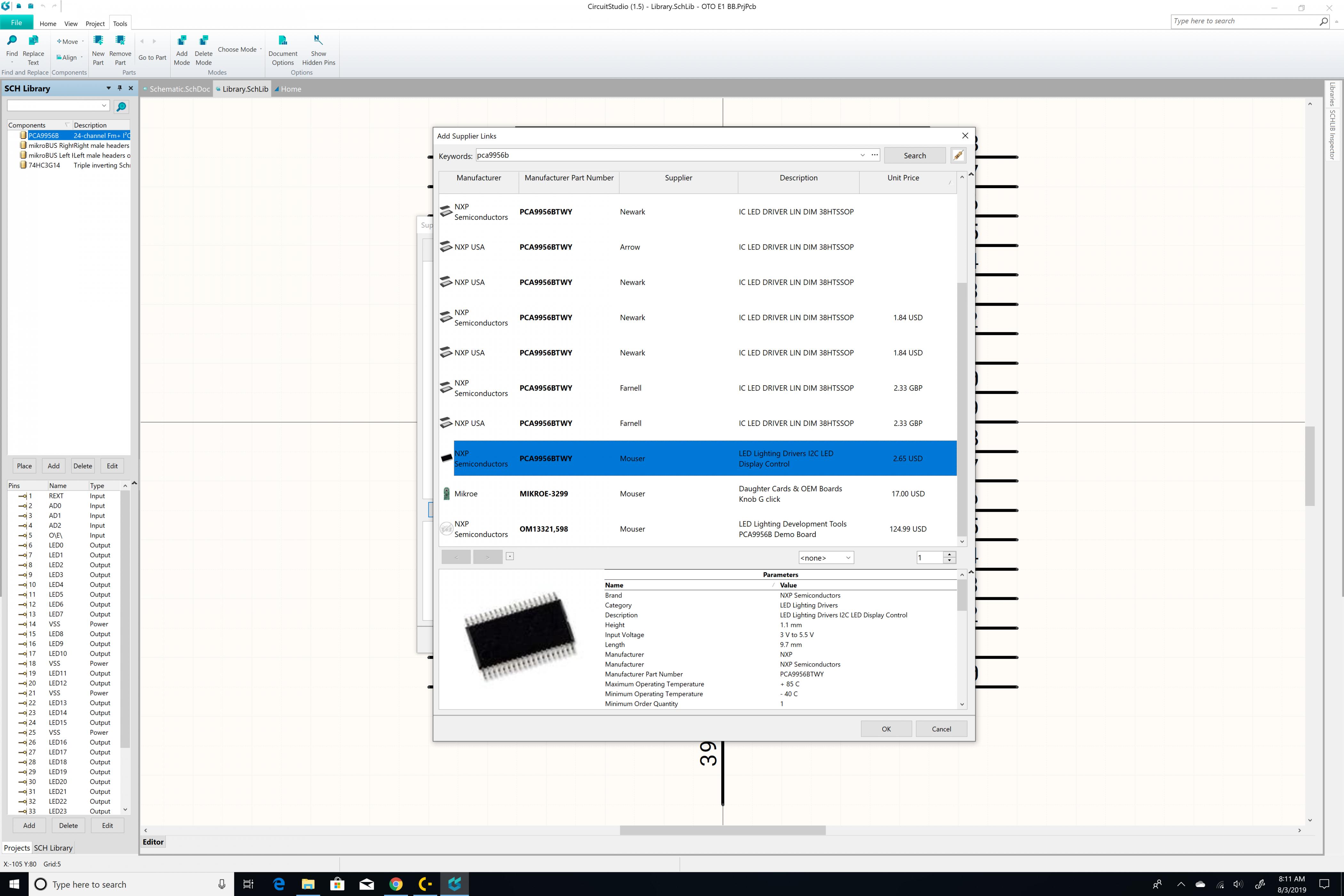

Supplier Integration
The supplier integration within Altium CircuitStudio is positively first class. Here, I am using it with Mouser, and it is making the creation of a BOM a lot easier than using a spreadsheet. Also, I am finding the official video tutorials produced by Altium to be quite effective. They're very short and super fast (you kinda need to play them in stop motion), but they allow me to get the job done.
So far, I'm loving it...

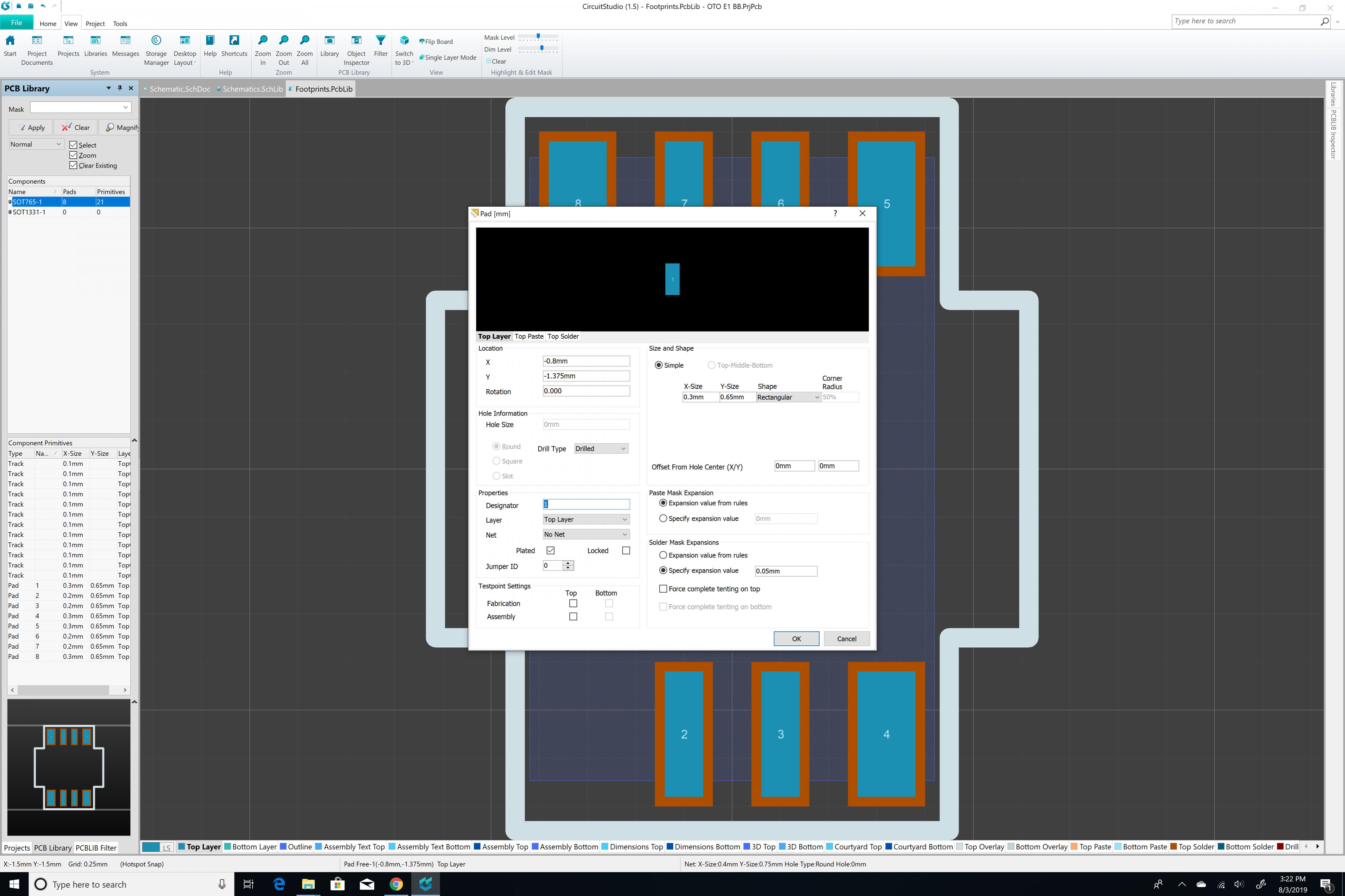

Question about solder paste and solder land
I am a bit confused about how to properly implement the footprint described on Page 3/5 of the following datasheet. For the bottom left pad, the solder paste area is 0.3mm × 0.65mm, while the solder land area is 0.4mm × 0.75mm. First, I am assuming that the solder land area is equivalent to the area occupied by the copper pad, but is that really the case? Second, how am I supposed to implement that in Altium CircuitStudio? I have attached a screenshot showing what I did, but it does not seem right:
