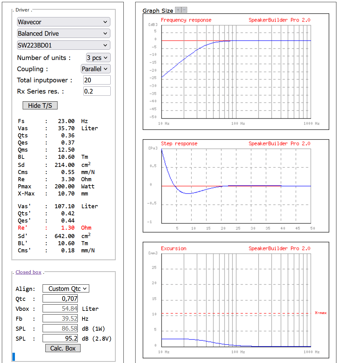

Wavecor SW223BD fits pretty well.... Cut-out is 223.5 mm. So that require some work to fit. It's a high mass driver and low sensitivity. But with 6 driver per side.... you should get plenty loud.
3 x 8 ohm drivers in parallel = 2.66 ohm. Do that again at the bottom, and you get around 5 ohm together, for your amplifier.

@digitalthor Thanks for the simulation!

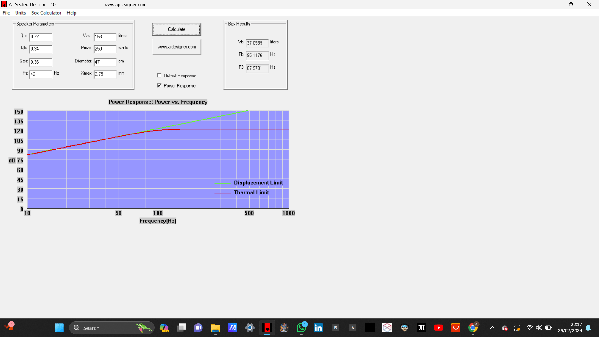

Here is the like for like Sim comparing the Eighteen Sound and Faital Pro... Very close on paper... Not so close in sound though!What do you think of this driver? https://faitalpro.com/en/products/LF_Loudspeakers/product_details/datasheet.php?id=101030204

Using the same input power and same Q, the Faital Pro has of course the same excursion (6 of either drivers will have the same Sd) and almost the same power curve/extension... The biggest difference on the graph is that the Faital Pro can be squeezed into a much smaller cabinet volume.
How audible will this be...? Not significant in my opinion.
But, what will be very audible and very clearly measurable and easy to show on a good CSD plot is the fact that the heavy coned Faital Pro (40.8g) Vs the light coned Eighteen Sound (17g) will sound muddy/blurry with less dynamics and impact compared to the Eighteen Sound driver.
Some people prefer the "audiophile" heavy coned sound type compared to the more "Pro driver" orientated sound with lighter cones... Just like some prefer ported/vented/BLH/ transmission line etc which are all time delayed / time distorted compared to a sealed low Q (ideally around 5 or 5.5) driver loading.
For me its a no brainer and easy to hear the superior life like sound from a Low Mms / High Bl ratio, fabric surround Pro driver in sealed low Q loading Vs the rest...
YMMV!

I would recommend using the Eighteen Sound 100% with a Q of 0.55... This greatly increases sensitivity ie now with just 100 watts input power (the driver well within its power limit of 280 watts) and still just 2.75mm cone travel you maintain 106 dB at 40 Hz from 1 speaker at 1 meter. A pair of speakers will give 109 dB before room gain... Thats very loud indeed!
The build quality of the Eighteen Sound is world class and will give many years of reliable low distortion accurate sound... Enjoy!

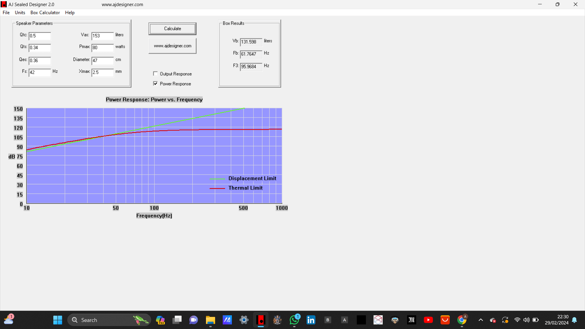

PS You can of course lower the Q even more and use up the extra cabinet volume... This will increase sensitivity and reduce cone movement so reduce distortion even further ie just 80 watts input and 2.5 mm cone travel still maintains 106 dB at 40 Hz.... See below:
