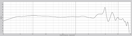

within +/-4db for 5 octaves……..widely available from a manufacturer producing drivers for over 40 years…….

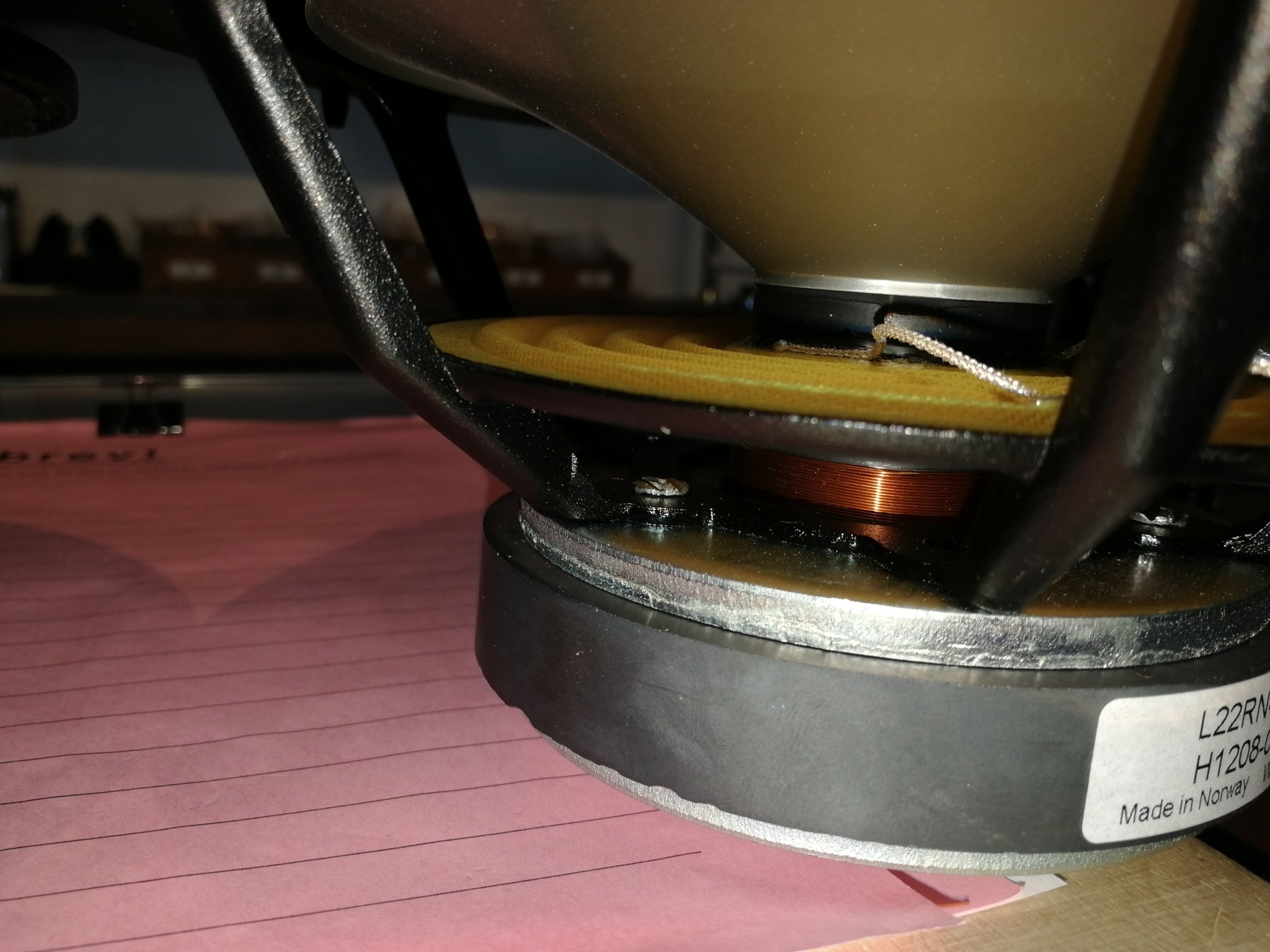

Im thinking sealed enclosure for the 8"s yes, Do you mean L22RN4X/P H1208 ? not that effective..
My vote goes for the Seas L22RN4X/P H1208.

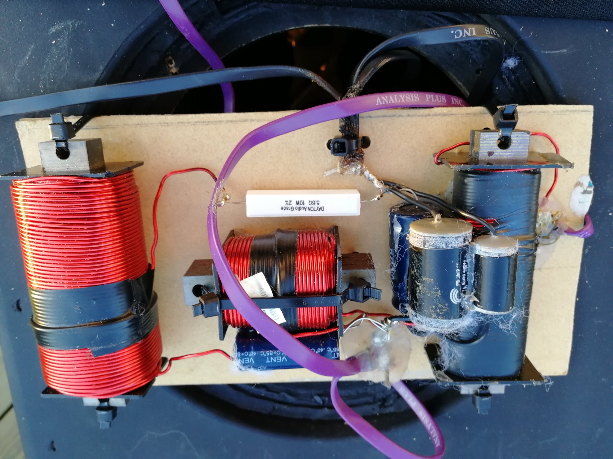

My hero Albert Von Schweikert (R.I.P) chose it among many tested, and he was a geinus in designing speakers inc xovers, and he used them in the upgrade for the VR-4 to VR 5-7.
Owned a upgraded pair for 20 years, and it uses 2 pieses H1208 per side in about 37 liter each reflex, and loved them
I also use the fantastic Mundorf ATM29 by the way, from 1850 hz.

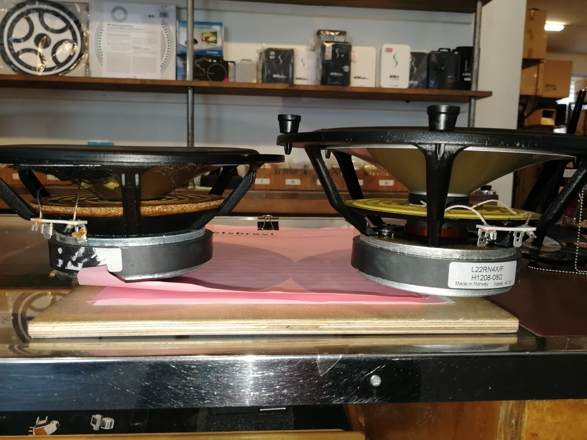

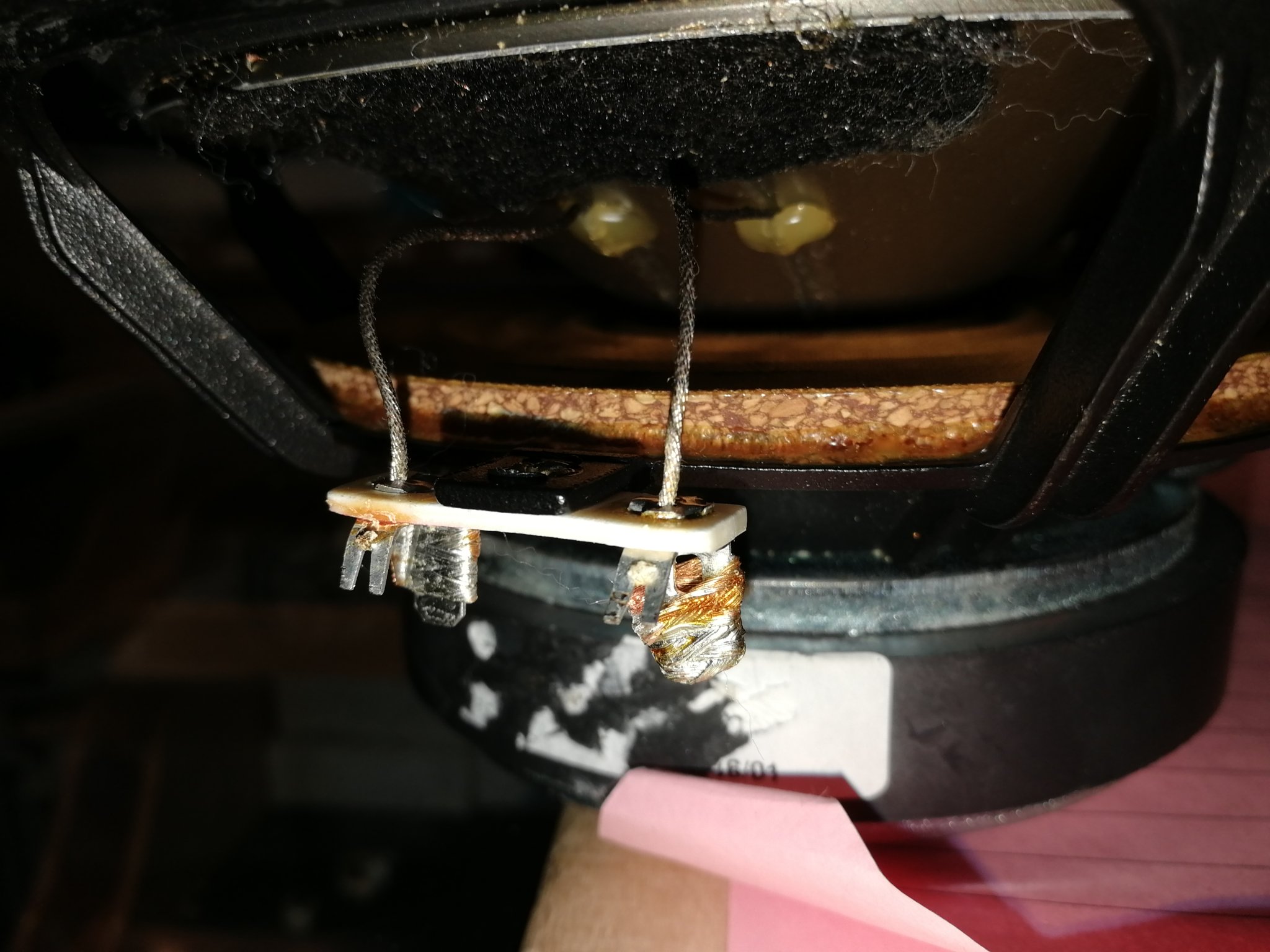

Here is old and newer version of the H1208, it´s quite different..

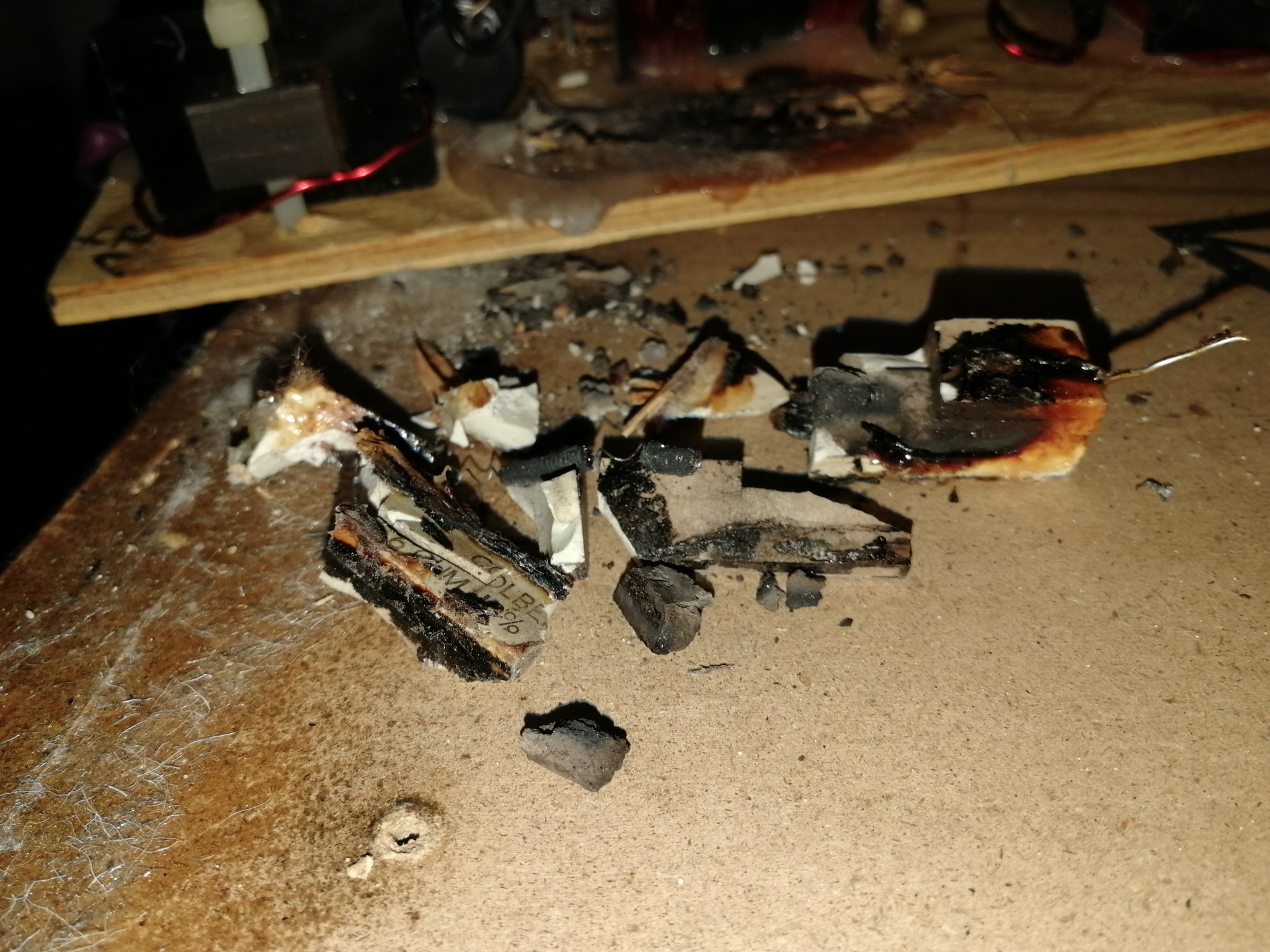

I blow 4 of them a 5-6 hour long wiskey-night, when the 5,6 ohm resistor say "god by", and the xover was glued like hell.
Albert used 3 coils for the filter.
(vart bor du i Sverige Theo ?)
Regards John

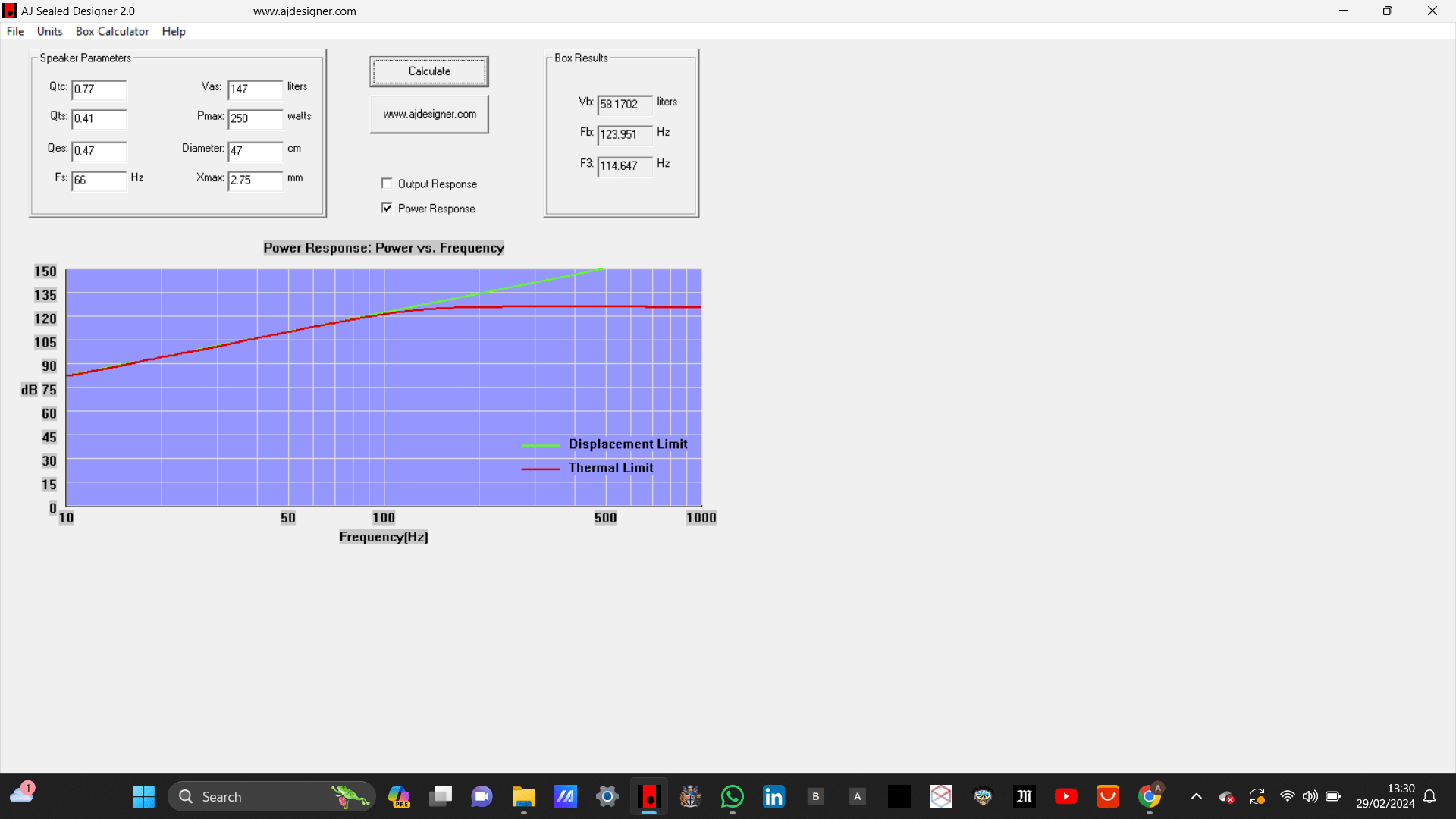

My suggestion is the Eighteen Sound 8 MNB 420 (16 Ohm) https://www.eighteensound.it/en/products/lf-driver/8-0/16/8nmb420
in 10 liters sealed with a Qtc around 0.77 (vary with available box volume) . A single driver Sim below... One driver holds 101 dB at 1 meter with 250 watts and 5.8 mm cone movement. Sd = 225 square cm.
With your amps and DSP you can easily Eq to cover the 40Hz to 300Hz band.
The have a superb low Mms (17g) to Bl (12) ratio of 1.41 with a fabric round so they have a super clean low distortion upper bass / low midrange performance ie the opposite of heavy coned/weak motor/rubber surround drivers in ported boxes with muddy male vocals and low end piano.
No need to worry about any SPL, Xmax or Eq / power handling issues with 6 of these per side... 6 drivers have an Sd of 1,350 square cm which is more than than a single 18 inch driver.
I have done a Sim and increased VAS and driver diameter appropriately showing the six drivers (each still in under 10 litres and same 0.77 Q) with the same 250 watts power. The 6 drivers will hold (continuous, not just peaks!) 111dB at one meter... !
A pair of speakers (twelve 8 inch drivers in total) will hold 114 dB at 50Hz.... And thats before any boundary reinforcement and line array throw advantage over point source (a single 18 inch driver).
Plus they can do this with just +/_ 2.75 mm cone movement... This is vital as the less a cone(s) have to move the less they distort.
As per my Sim with the six drivers Xmax is not an issue... One speaker (six eight inch drivers) holds 106 dB at 40 Hz, a pair of speakers (twelve 6 inch drivers) holds 109 dB at 40 Hz and this figures are before any room gain/boundary reinforcement which will typically be around 4 dB... All these figures are with just 2.75 mm cone movement.... Less than 50% of the drivers XMax... Size matters! 😉 🤣
