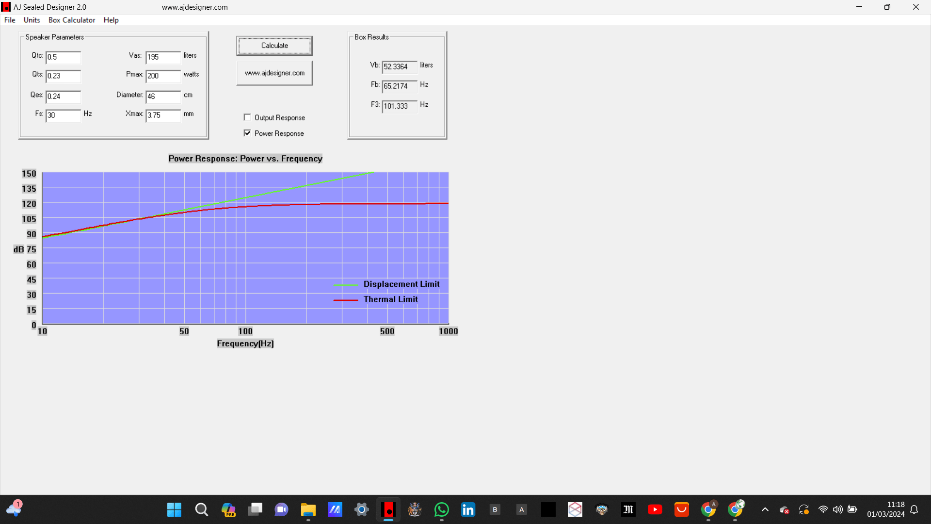

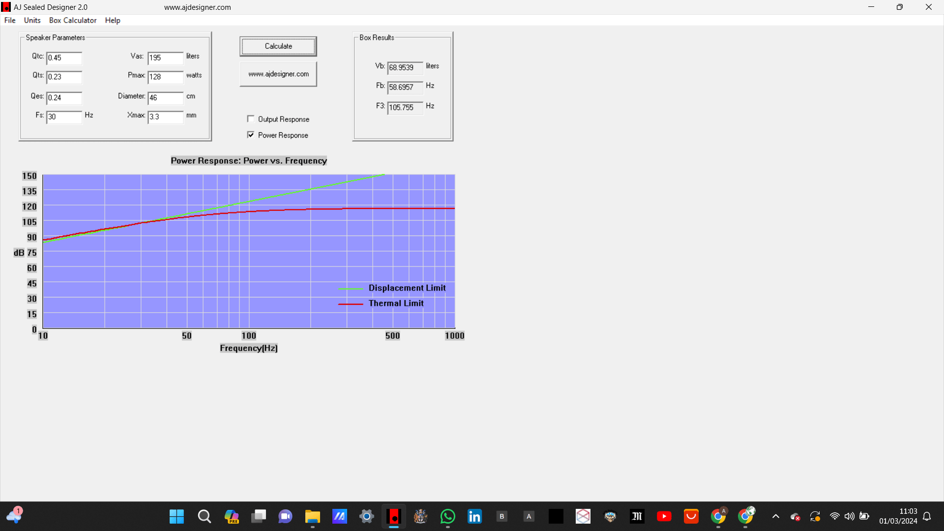

TheoSweden's cabinets obviously are designed for multiple small bass drivers which are great all the way up to 300Hz, but just for interest, here is a Sim showing what a nice ELF design (designed to operate BELOW box resonance) 18 inch Pro driver can do in a small (70 liter) sealed box does below 70Hz... Major advantages are low cost / simple sealed box, reduced driver cost and simple installation/wiring/8 Ohm load. Eq to taste and room position and you have killer bass...

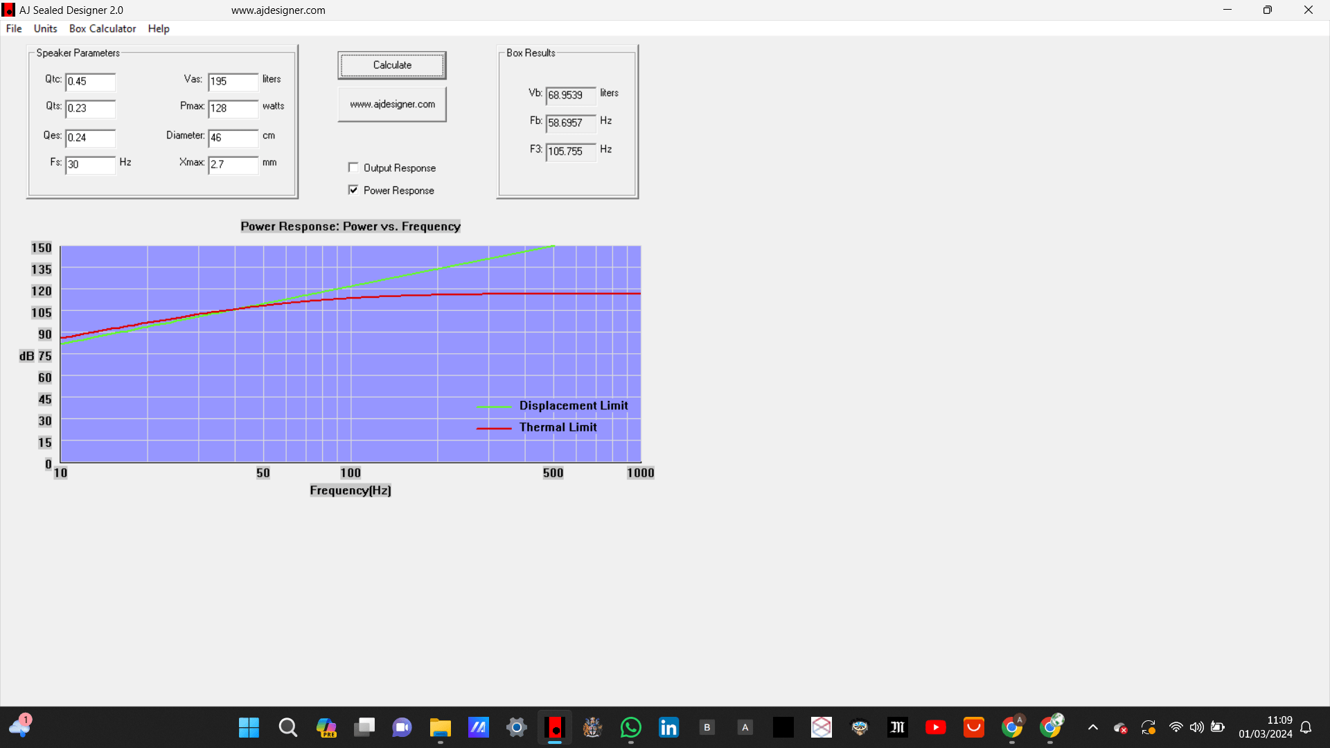

Using just 128 watts (less than 10% of the drivers AES continuous power handling 1,600 watts!!) and just 21% of the 13mm XMax (60mm travel before damage!) one sub holds the same 106dB at 40Hz with just 2.7mm cone travel. If you have a Kilo watt of Hypex type power available a pair (plus 3dB) in room corners (plus 6dB) can shake a 100 Kg sofa and the family sitting on it...!!

PS I am planning on building a pair of these sealed box ELF designs with a 300 watt into 8 Ohm power amp and DSP.
I have chosen a slightly higher Q to get the box resonance UP to 65Hz as I am crossing over at 65Hz... I lose a little bit of sensitivity but still only need 200 watts and 3.75mm cone travel to hit 104dB at 30Hz... A pair in the room corners.... OMG!

I think one of the reasons people don't immediately realize this is because the F3 is NOT the lower limit. With an F3 of 50hz you could likely have an F6 of 43hz and F10 of 38hz. (And probably higher output in an actual room, depending on the speaker placement.) Yes there is still plenty of musical content below 50hz, but it is not like the SPL drops to zero at 50hz.@TheoSweden, I agree completely. Any speaker with an f3 anywhere near 50Hz will sound very good on almost all music. Would a lower range sound better? Yes, for some music. But one will be very surprised how very good a 50Hz lower limit can sound. I make this statment from experience.

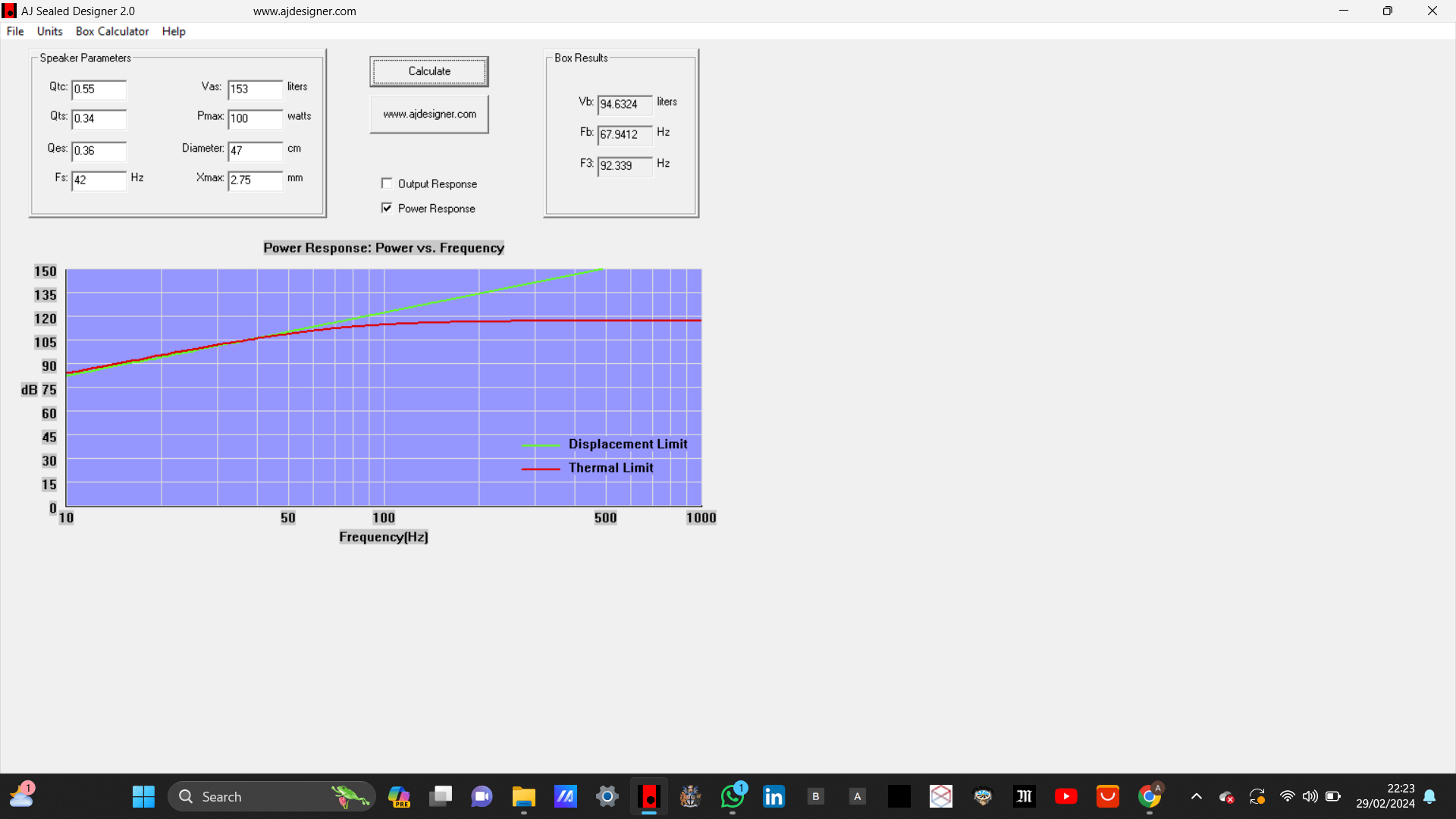

I would recommend using the Eighteen Sound 100% with a Q of 0.55... This greatly increases sensitivity ie now with just 100 watts input power (the driver well within its power limit of 280 watts) and still just 2.75mm cone travel you maintain 106 dB at 40 Hz from 1 speaker at 1 meter. A pair of speakers will give 109 dB before room gain... Thats very loud indeed!
The build quality of the Eighteen Sound is world class and will give many years of reliable low distortion accurate sound... Enjoy!
You have tried to convince me good but I must say I fear the high fs(maybe just preconception) and that I have to Eq much to be able get them to play deep.
I dont want my 18"s to play so high up in frequency..
