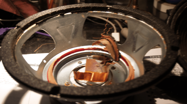

Good sounding bass guitar speakers when the pole piece hasn't shifted on the magnet.
Bought a used 8x8 with one pinched coil, another one pinched rolling it to the van..
If you ever plan to move your 8x8 cabinet again, put a bead of epoxy around the magnet at the front and back plate.

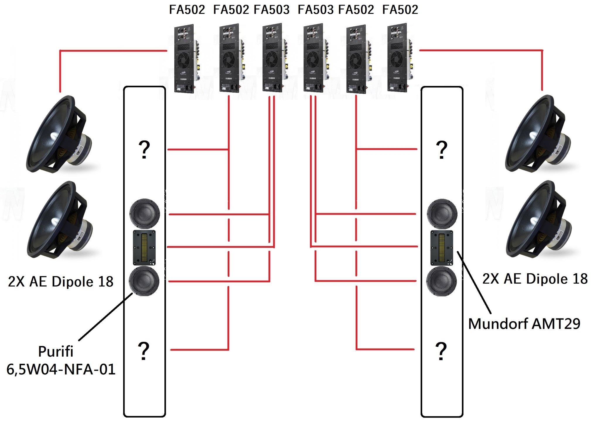

Thanks for all efforts guys, I soon list the thinkable drivers I have found. Until then I did a drawing of the system, this is how it looks.. Im not using the 100W channels of the 503s.

Now that you go through all the effort anyway - why the woofers from Purifi and not the dedicated midranges?
18" AE woofers??
I'd much rather have around 8" woofers in the towers and then add subwoofers with something like a 130liters closed cabinet and a RS390HF or something.... then put the subwoofers somewhere else than the mains, to take advantage of modal distribution.
18" AE woofers??
digitalthor.. please read the thread from the begining.
I have all speakers and amps, they have been used in many different builds before.
Now this is what I want to build this time, just need help with the ~8" drivers.
Purifi6,5 are exelent midrages if you didnt know.

What about Seas L22 with their 4 layer voice coil versions. 4 of them reaches F3 at 50Hz in around 70 liters closed, with a Q of 0,7. You could easily aim for a bit higher Q and then just pad them down a bit with EQ. And I would definitely go closed on the woofers, so that you get an improved impulse response, less trouble with phase and ease of integration with the subwoofers.
Sound imports want 1000 Euro for 8 of them... so that's well within the budget... And I'm not sure whether you will benefit from anything better below 250Hz, when it comes to driver quality.
You write that you have 4 FA502's - Are the FA503 already bought too, or are they just on the drawing during brain-storming?
@digitalthor : Uh, the L22 has no faraday ring or copper cap (at least a T-pole for the classic seas prestige woofers, or?), so I would not double the inductivity of that magnetic circuit with a 4-layer VC, distortions are not the lowest with that design. However, the driver is solidly made and shall shovel nicely and noisefree some air within a limited bandwidth in the fundamentals.
Year, that stack of FA50x is really overkill! I have a pair of FA503 for my living room 3-way system and think even that is overkill, a FA253 would have been enough...
@TheoSweden :
I don't think you need one 500W hypex channel per 18" free air woofer.
The 18" AE woofers I found are 8 ohm type or? The FA503 can deliver many clear current on 3-4 ohm loads, but has lower rail voltage swing that limits 8 ohm load performance to 350 W, in comparison to 250W per driver in a pair that has 4 ohm load in parallel. That's a bit more than 1 dB. Manufacturer load capacity is given with 150W. And despite the big long stroke sub, low Fs and high Qts will get the driver to xmax with two-digit power numbers in free air.
Same with the eight eight inch woofers (!): take 4 ohm type and connect them so per speaker the overall amp load is 4 ohms, so every low Fs, high Vas hifi diver in large volume will receive stable 125W which is more than sufficient.
You don't use the tweeter channels of your FA503s?
I know that the tweeter channel has little better SINAD than both other channels, as the used DAC in the plateamp has four channels by design, and Hypex decided to use two DAC channels in parallel for tweeter channel duty to optimize that specific performance. Also the HF100 tweeter amp module is optimized for high frequency operation. It gets the rail voltage from the 500W modules, so it is capable to deliver the peaks.
When speaking of 500W channels for the tweeter, and leftover FA50x modules that can be bridged, I think about using the available rail voltage swing for semi-current driving the mids and the tweeter with high ohm local current feedback series resistors. But I must confess, have no Idea how an air motion tweeter magnetic drive circuit may profit from current drive, and the Purifis are very low distortion as they are so there is not much to optimize...

@Kwesi
Yes headroom is a nice thing.
I think like you regarding heavy long stroke woofers, dont want them in this build.
Scan Speak 21W/8555-10 and Wavecor WF223BD02 looks nice and are great candidats I think.
Infact I have a bunch of Satori WO24Ps from another build but its tight on the baffle for this driver, we'll see.
I have used my AE woofers for many years now and they like to have power behind them I can tell you.
I have tried the tweeter channels before with other tweeters but I cant say I noticed any difference, I could try it again.
Your ideas are interesting but I think I use the amps like I do now. All speakers have plenty of power and the 8"s will have enough to.

Im thinking sealed enclosure for the 8"s yes, Do you mean L22RN4X/P H1208 ? not that effective..
Yes I have all amps since a few years, what did you think of? 🙂
Yup, I agree... but we're also only talking woofer duty here, below 250Hz. And that 4 layer VC can take some beating and push it easier in smaller cabinets. Always compromises - right 😉@digitalthor : Uh, the L22 has no faraday ring or copper cap (at least a T-pole for the classic seas prestige woofers, or?), so I would not double the inductivity of that magnetic circuit with a 4-layer VC, distortions are not the lowest with that design. However, the driver is solidly made and shall shovel nicely and noisefree some air within a limited bandwidth in the fundamentals.
Yes, L22RN4X/P H1208. I know they are less effective - you always lose something when going for smaller cabinets... but you already use less effective "midranges".... so - why not. And you are aiming for 4 x 8" woofers... which is quite a bit too.... especially with subwoofer supporting the very low end, so efficiency should be around 95dB for 4 woofers.Yeah the Purifis are not that sensitive but its better with 2 per side in that regard. Plenty power so it works good, atleast in open baffle as I use them now.
I thought.... why not the FA501 for subwoofers? Because I thought you only had 4 amps, and not 6 - like on the drawing.
You are right about that, and they are for sure good in price. Ill look more into them..
Understood. It has been good with 502s, more options for time delay etc when I have tried with subs everywhere in the room. And can stil be bridged
