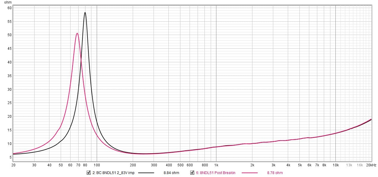

FWIW:
"Spec sheet, FS = 66Hz, Zmax at FS = ~50 Ohms.
Out of box, FS = 80Hz, Zmax at FS = ~58 Ohms.
Breakin routine, 10 minutes at 30Hz, 20V RMS, Excursion ~6mm
Allowed to cool 20 minutes. (Motor structure was warm to the touch.)
Broken in, FS = 68Hz, Zmax at FS = ~50 Ohms.
Measurement method, true voltage source impedance check, ARTA Steps 1/48'th octave. Drive voltage 2.83VRMS."

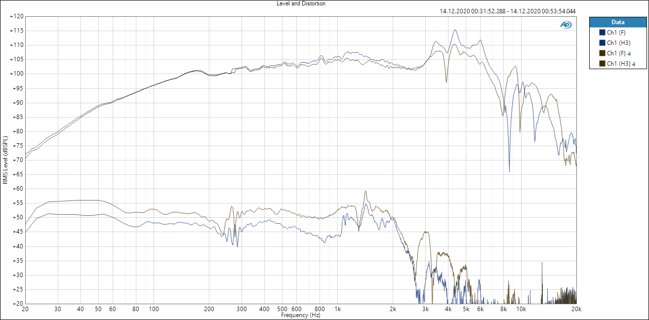

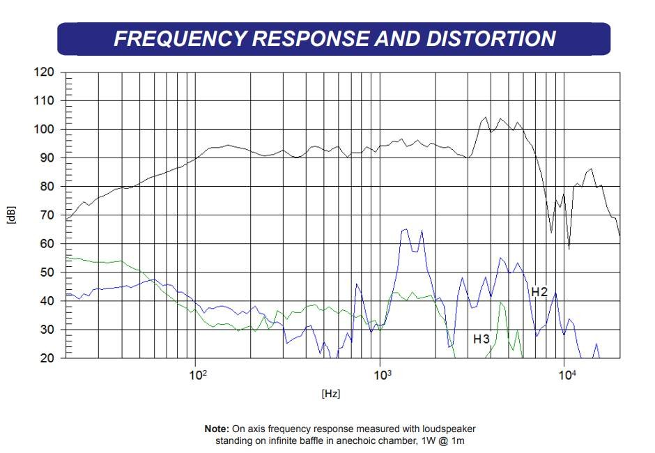

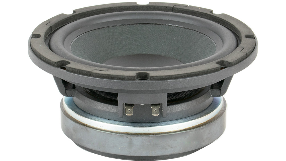

This Beyma, I assume?:
View attachment 1473914View attachment 1473921
What 'problem' are you referring to?
Yes. They changed the surround to a stiffer one without telling or changing the datasheet. The new driver measures very different - nicer in the resonant area but double the THD in the normal area. Also Qms went down significant and in my listening test the driver showed less detail in the music. Even the distributor didn't know and asked in the factory what's going on.
This looks like a severe surround reflection mode and its quite pronounced.
When I remember right it's just H2 from the membrane resonance (half the frequency of the resonance) - it will go away with a passive crossover or a series notch (Purifi paper).

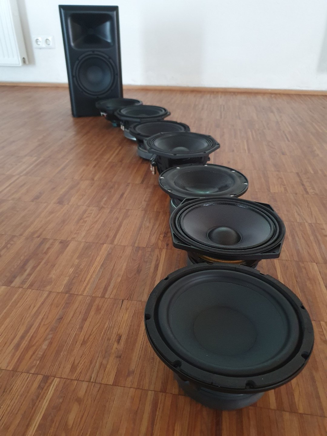

I wanted to build my cinema speaker with the Beyma and it took 7 samples of 8" until I found a new one which I was happy with.
@IamJF That's extremely frustrating. Consistency is everything. If you can't count on driver specs being accurate, the driver isn't useful IMO.
To evaluate a driver's purpose and usefulness, I always purchase at least 3 drivers to determine if it has sufficiently consistent properties when used in non-matched pairs.

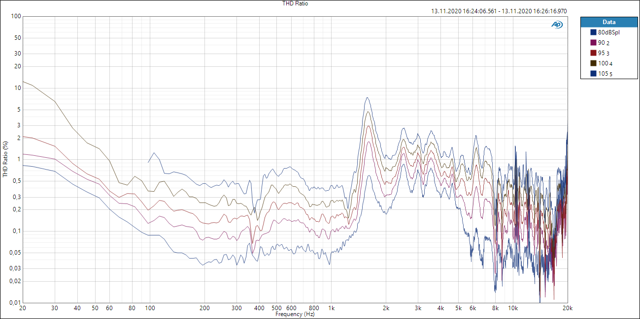

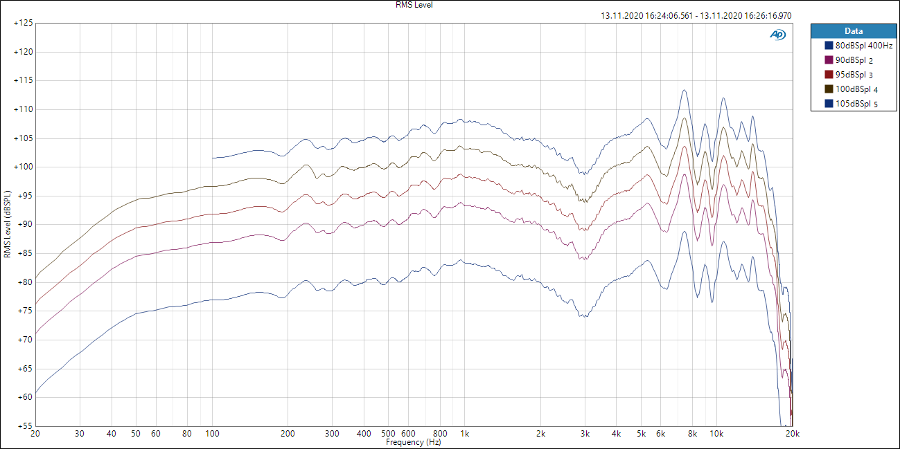

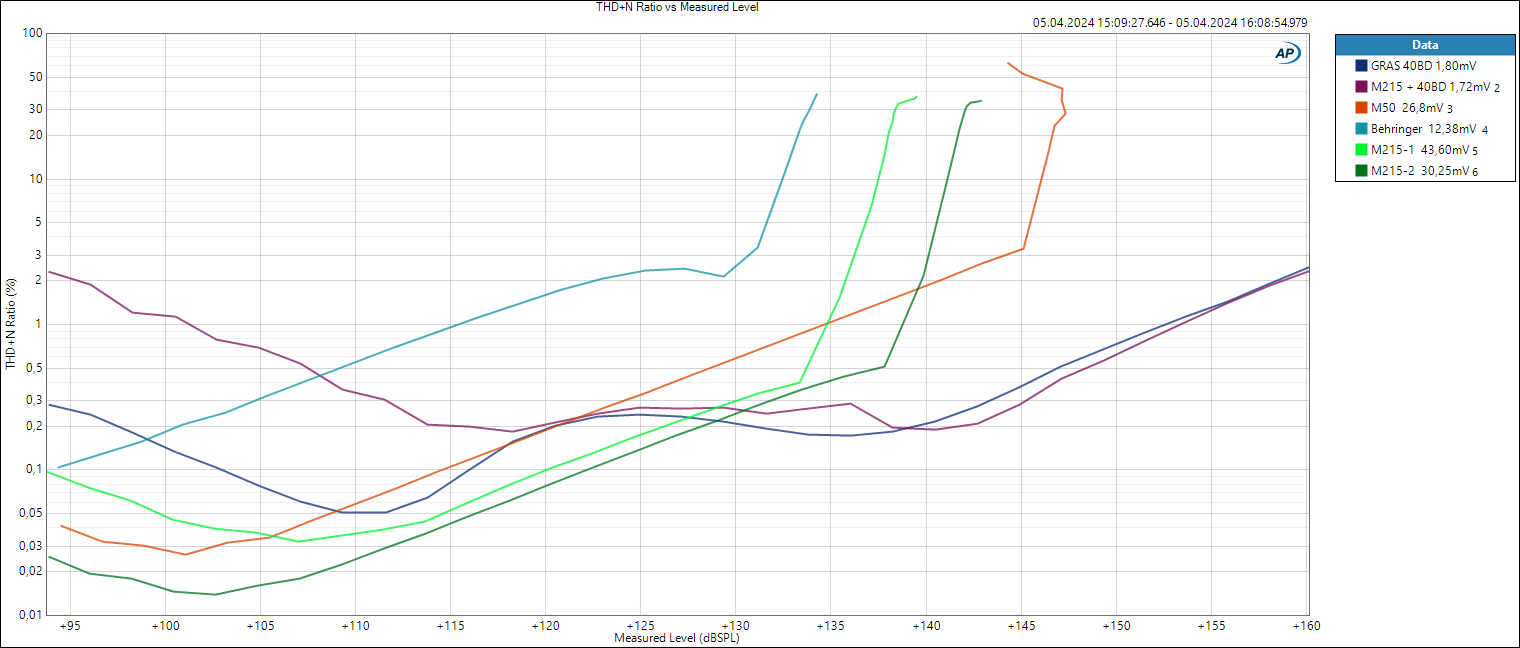

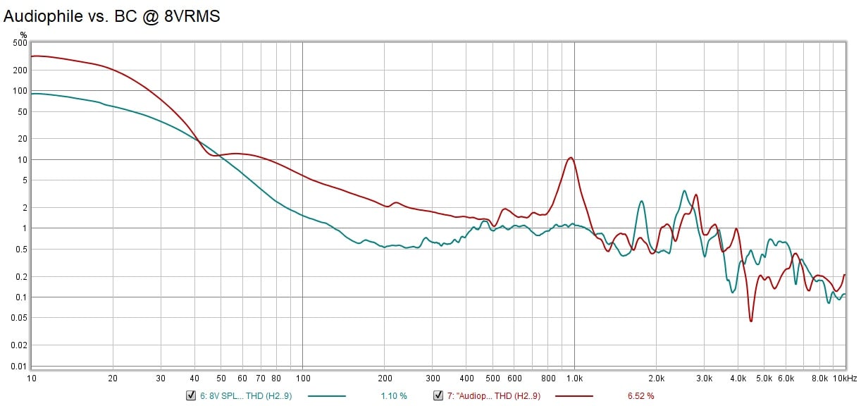

I respect Scott a lot for his work but these measurements ...The nearfield distortion tests at 2.83V, 4V, 8V, 16V RMS were done by Scott Hinson.
That's rubbish. A condenser microphone doubles H2 (which is dominant) every 6dB of SPL.He included a warning:
"Do not attempt to do nearfield distortion tests like this unless you understand how loud nearfield SPL measurements can/will be."
In this case the SPL at ~1/4" from the dustcap was in excess of 150dB.
A special purpose high SPL Josephson microphone was used (C725, US$ 10.250,00), capable of measuring 165dB @ 5% THD.
This was about 15dB under that so the microphone distortion should be under the noise floor of the measurement.
A studio microphone is specified at 0,5%, measurement microphones sometimes with 1% THD. But 5% ... That's 2,5% at 159dBSpl, 1,25% at 153dBSpl, 0,5% at about 145dBSpl. When he had 150dBSpl during the measurement ... the mic THD will likely have some influence.
Here some measurements from measurement microphones at 1kHz:
A GRAS 40BD has about 2,5% THD at 160dBSpl and would have 5% THD at 166dBSpl - costs about 2k and is really no special mic. One of the B&K 1/4" has even less sensitivity and would probably get in the 2% THD area at 165dBSpl.
Scott also tortured the driver with 10 tone test signals in a 100°F (38°C) garage for hours and compared it to a 7" high-end woofer, probably something in the range of a Scan-Speak Illuminator or SEAS Excel:
I know the ScanSpeak 8" drivers and NO WAY the B&C tops them at "normal" levels. Maybe Purifi is a little better.

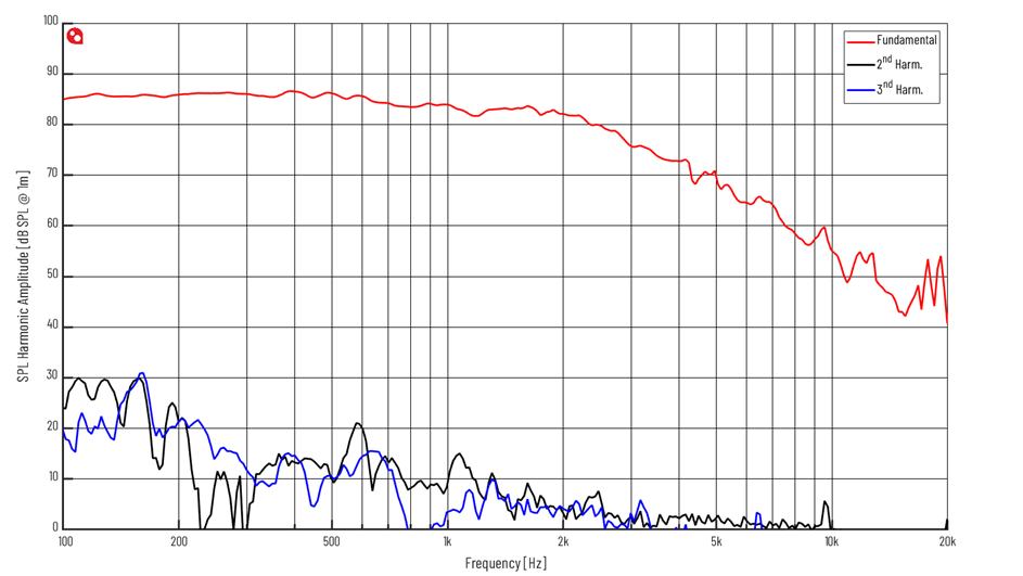

This is the metal membrane 8" 22W/8857T00:
8Vrms is 9dB louder as 2,83Vrms. Sensitivity is specified 86dBSpl/2,83V, so at 8Vrms we land at the 95dBSpl curve (@400Hz). THD is below 0,2% in a wide range. Even at the limit what they are able to deliver (about 25V) they stay below 1% THD - these are exceptional drivers!
I'm sorry to say but either these measurements are not reliable or the driver is in terms of THD just average. But I would not trust these measurements.
More losses due to increased damping in the suspension.

I used a few of them for an industry project, had 1-2 in spare and did my measurements and a prototype. Then ordered 3 new ones - and these had the changed rubber surround. No way to get the old ones. The complete project ... back to the start.@IamJF That's extremely frustrating. Consistency is everything. If you can't count on driver specs being accurate, the driver isn't useful IMO.
But at least I detected the PA-driver low SPL strange behavior of some drivers and know a lot about 8" drivers now 🤓
Btw, the old 8P300 had a Qms of 15-20! The new one less than half ... and nobody cared or noticed.
