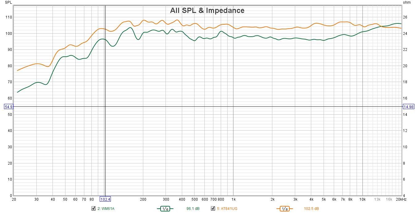

That looks bad 🙂, not even close to what I am hearing and measuring. Maybe my driver measurements are wrong? After all, I was using uncalibrated WM61 of unknown origin - can't remember where I got it from anymore, and I hear there are lot of fakes floating around.View attachment 1254049

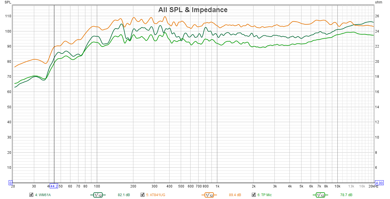

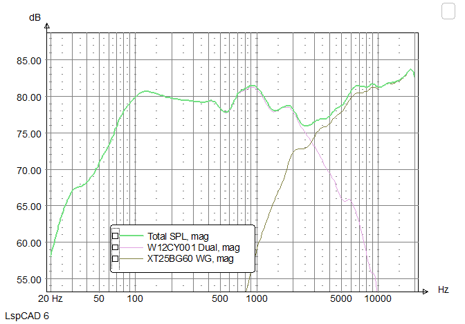

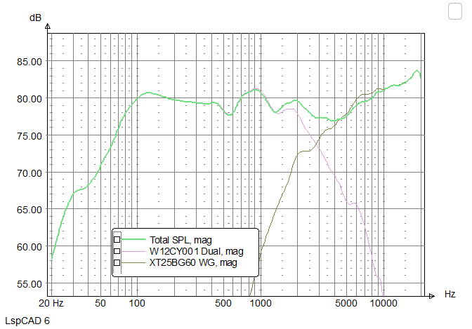

The Phase is not correct with this design TBH. IF I flip the polarity we do not see a deep null, just a droop.
Inverted Tweeter:
If you want to hear what these speakers can really do, it's time to build a new xover 🙂

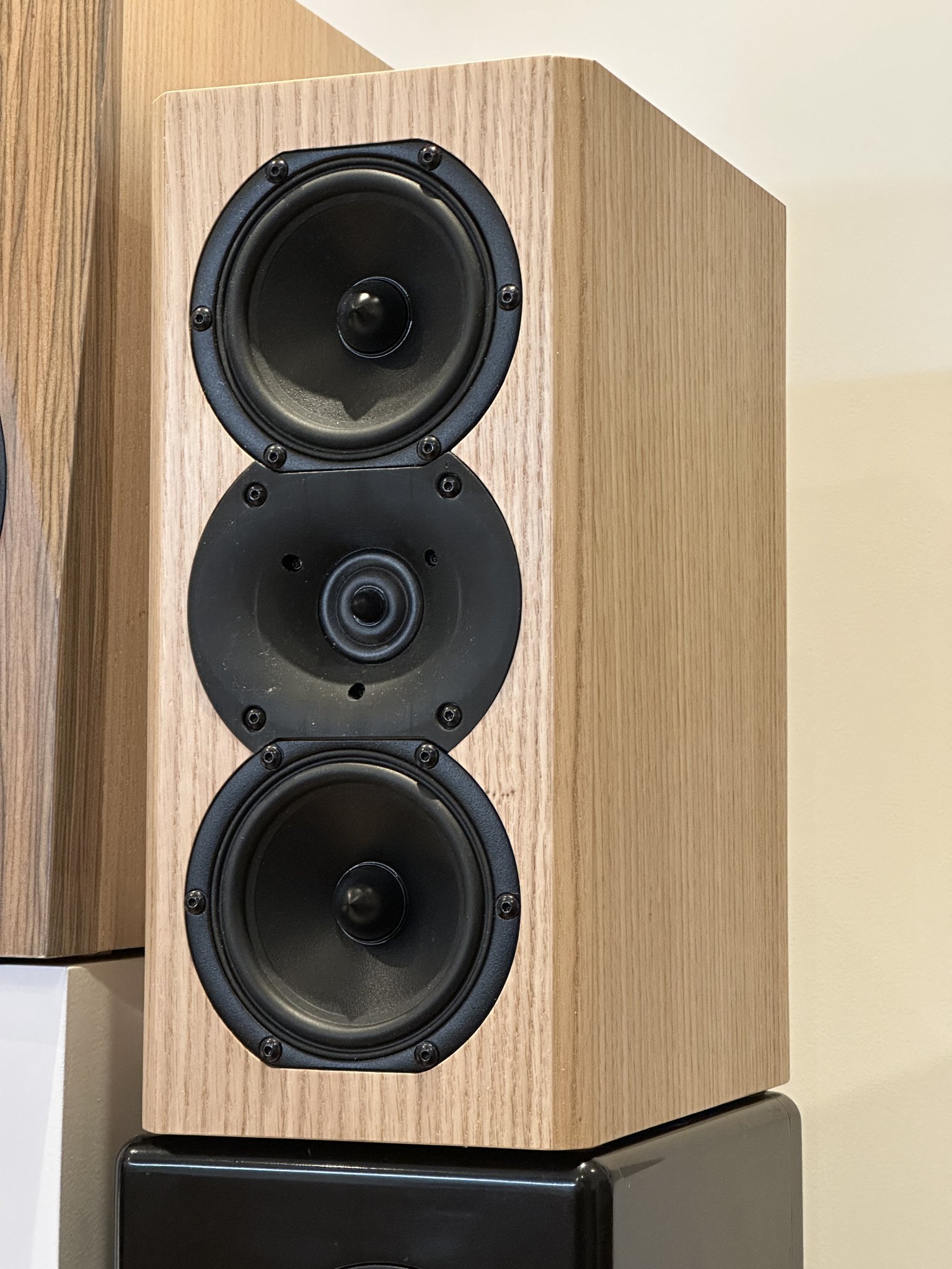

I guess you'll have to take my word for it - it cannot get much better than this. It beats all other designs in the picture in at least one discipline. DXT has lowest extension followed by ZRT and ZD5, but the mids (voices especially), highs, definition and precision of the sound stage - it's all right there, coming from those tiny boxes. I'd rather redirect my next effort into a sub to complement them in the only area they are lacking. And, maybe a little chamfer on the sides, just in case there is a small diffraction happening on the baffle.
It could be the non-calibrated, hand-held mic as well...?I recommend using a 5dB scale for this kind of thing. 10dB is too course because our ears are far more sensitive.
Your result looks pretty smooth. The only thing that bothers me is the 3 to 4dB broad hump between 4KHz to 10KHz. That is due to the waveguide.
It looks bad mostly because of the scale. It actually mimics your results pretty closely in the 1KHz - 10KHz range. I don't want to be an *******, but also I want to be honest with you - It's good that you are enjoying the speakers as they are, however they are being crippled by a crossover with poorly aligned phase and a mid-range bump.That looks bad 🙂, not even close to what I am hearing and measuring. Maybe my driver measurements are wrong? After all, I was using uncalibrated WM61 of unknown origin - can't remember where I got it from anymore, and I hear there are lot of fakes floating around.

I've provided you anechoic data from identical drivers including the waveguide and a mic you can trust. If you use that in your simulations you will see what the speaker is doing without the question of room reflections, lack of a mic stand etc..
