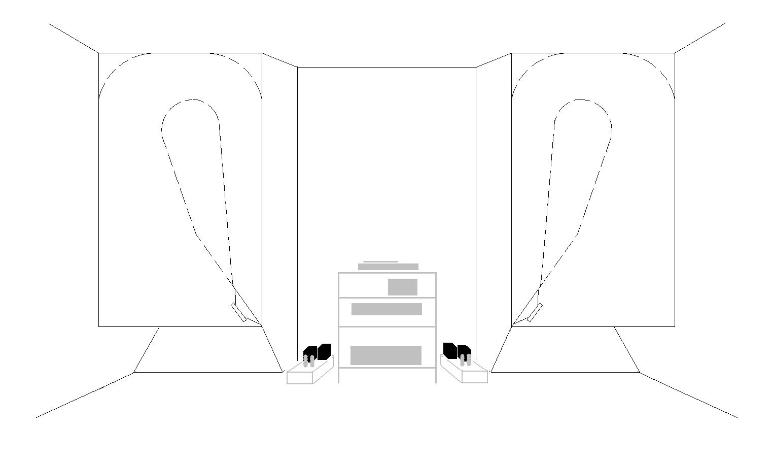

Bring it in under the house and bend the horn to come up through the floor. Cover the hole in the floor with industrial open mesh grid/flooring.
I think that is what you might call overshot the mark
all you need is to take 1-2 feet from your room
build a cheat wall
it should be plenty space for two bass horns
maybe also consider the woofer

with a room 5m wide and 3m height, take just 500cm
the two mouths could easily be like 1m x 3m, at side walls
each horn could easily be 6meter long, with only one fold
thats what I actually suggested for a 'smaller' horn 😀

This is exactly what I have been thinking of doing, Using the last metre or so of a dedicated room to integrate bass horns. Keep the ideas coming🙂
oke, i see a few different styles.
personaly, i think the corner system that Epa shows whill work for me.
are there better drawings to be found?

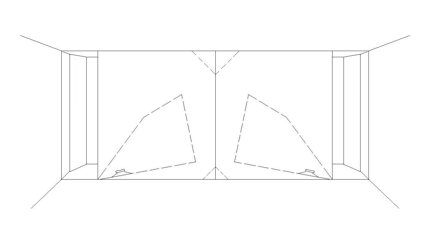

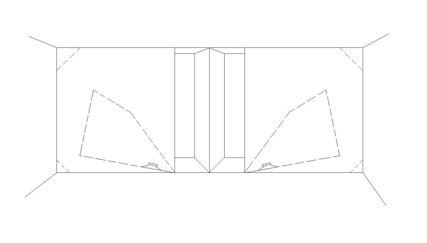

looks like a tapped horn
yes a tapped horn(tqwtp)
its the top one of the pic.it uses 0,35 m2 floor space
the bottem one is a th ,its a bit bigger and louder.
its moddeled with the bms 18n 860(x-max 19mm).
havent actualy bild them🙂
if you planning to bild them i could provide details
