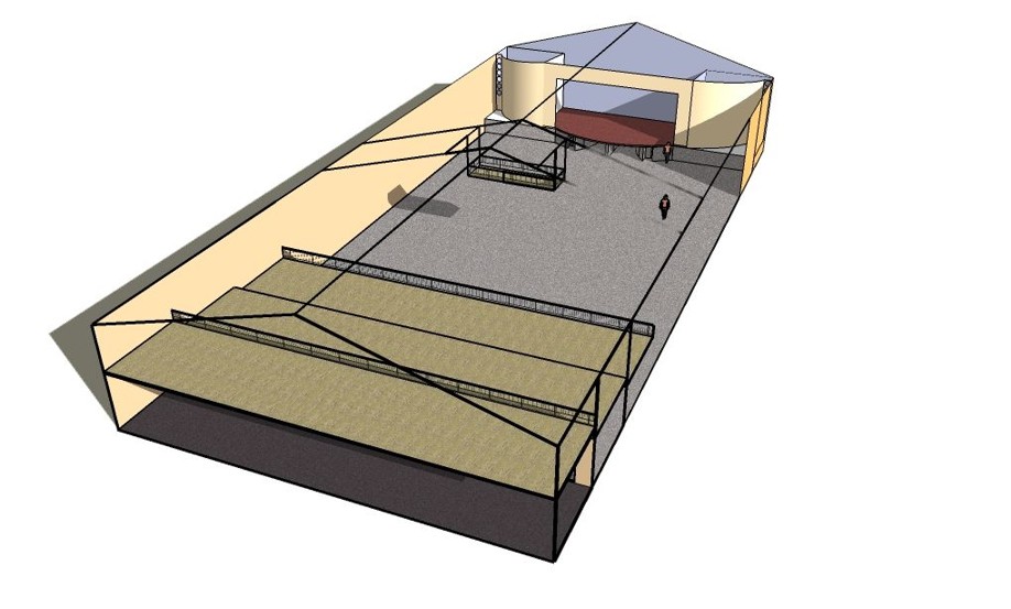

Planning to build the largest horns in Africa, would appreciate any help regarding calculations/plans. they should fit below a concrete stage 9m x 6m x 1m, available speakers Eminence Omega 18". Any advice?

Alibaba:
It would be nice if some of the audiofellas on this forum will help you with the design of your new subs. But we would need some more info:
*What is the positon of the stage (such large horns are highly directive, so we should get the dispersion characteristics correct, the system as a whole should have quite similar dispersion characteristics in all passbands to ensure a natural sound).
*What kind of materials do you have access to and what is the thickness of the wall (need that to make a CAD drawing)?
*How many Omega 18 drivers do you have?
*Is the depth of the stage 9 or 6meter?
Just did a quick simulation with two Omega 18 drivers and got a quite impressive result on a 9m long straight horn which could be placed beneath one half of the scene. At 22Hz the drivers simulated a large displacement, so you will need a notch there or a dynamic EQ to prevent too large excursions. If you do not have such prosessing power available, the maximum effect would be about 400Watts for two drivers (still out of Xmax values, but not Xmech, so that should sound just fine at 22Hz, that is my experience at least😉 The sound pressure at 1000Watts had an average of about 135dB half space from 18-100Hz which also should be a perfect passband for the horn.

At present, there is only a steel framework, walls will be concrete blocks 200 mm thick
Position is at one end of the room (50 m x 24 m)
The planned stage width is 9m, depth is 6, solid concrete above the existing concrete floor. I thought we could fold them like the Royal Device horns, only that the mouths could be placed adjacent to each other, or - if they have to be straught, we could use the entire width of the building (24m). Diagonally that gives a length of about 13 m for each?
The system still does not allow me to send e-mails, otherwise i would've sent some preliminary drawings.
135 dB is more than OK, but if you think, mor drivers are needed, it's okay with me.
What about mids? should we build those too, or it's ok to attach several 2x15" (2x12"?) commercial cabinets?
Thanx in advance

Yes, they can't go under the floor but under the stage itself.
