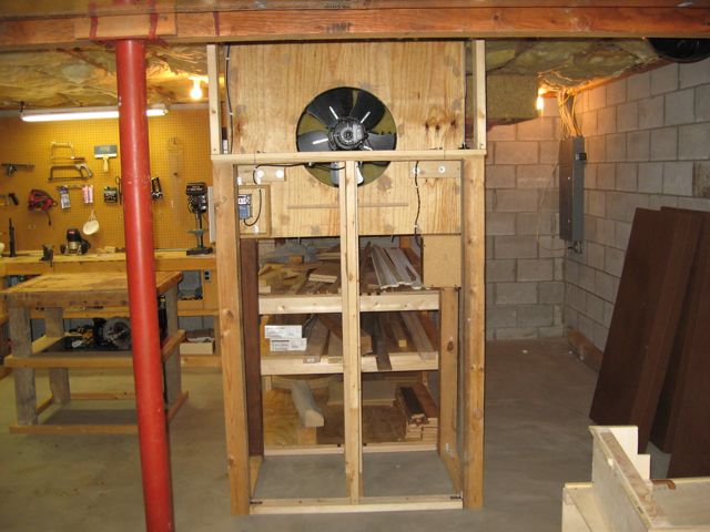

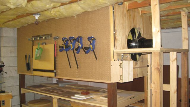

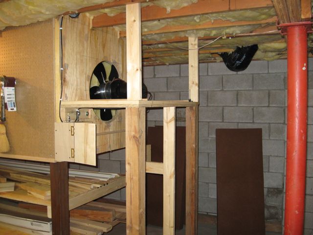

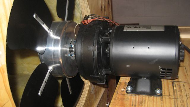

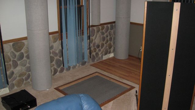

The enclosure for the Rotary subwoofer
I built the enclosure for the rotary subwoofer, which included
modifying the floor for the opening. The rotary subwoofer is
Eminent technology TRW-17, designed by Bruce Thigpen. There
have been numerous diy builders that have been trying to build
a rotary subwoofer, but no one has been successful so far. The
amplifier for the rotary subwoofer is designed by Marchand
Electronics, with input from Bruce Thigpen. This small amplifier
is rated at 200 watts and is used to modulate the fan blades.
The real power comes from the ac circuit that rotates the
fan motor, and the rotary subwoofer will produce over 110 db at 5 hz!!!
Wow! Did you build the unit that modulates the fan? What kind of db is it produce?

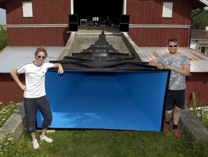

More pics from Norway! 🙂
12 meter høyttaler fra låven - Arkiv - Drammens Tidende
Is Eminince LAB 12 an ok driver for this type of horn? I was planning a Labhorn but I am want to reach lower than 35Hz.
http://www.eminence.com/pdf/LAB_12.pdf

how large does the chamber behind the fan (aka your basement) need to be in order for the rotary sub to work properly?
Room sized with return air plenums all soundproofed to reduce the air noise created by the 800 rpm fan.how large does the chamber behind the fan (aka your basement) need to be in order for the rotary sub to work properly?
A Lab 12 would work well, but folding a bass horn is a far more efficient use of lumber than a straight horn.Is Eminince LAB 12 an ok driver for this type of horn? I was planning a Labhorn but I am want to reach lower than 35Hz.
