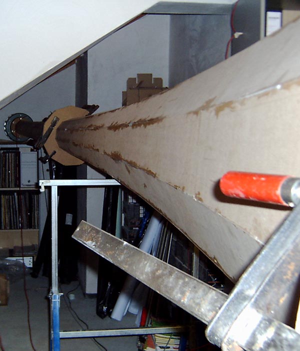

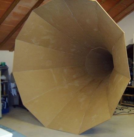

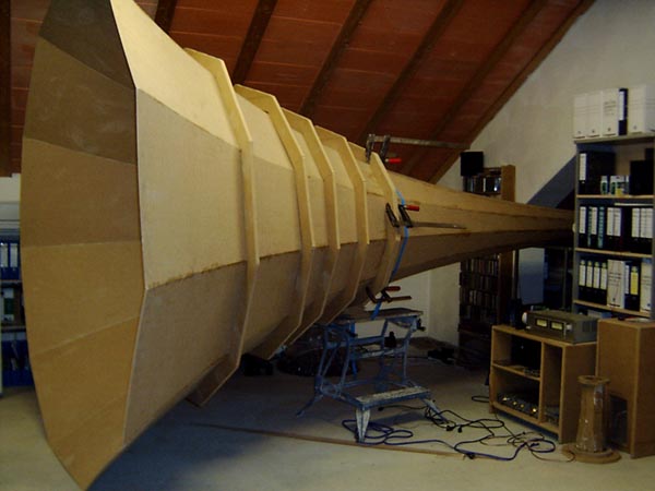

Walter,
Just gotta love the looks of that horn 😉
probably sounds good too.
Is this your horn?
Details?
cheers 😉
Is this your horn?
Details?
cheers 😉
Nice woodwork Walter🙂
Is it a fullrange compression driver you are using?
Please bring in some specs😉
