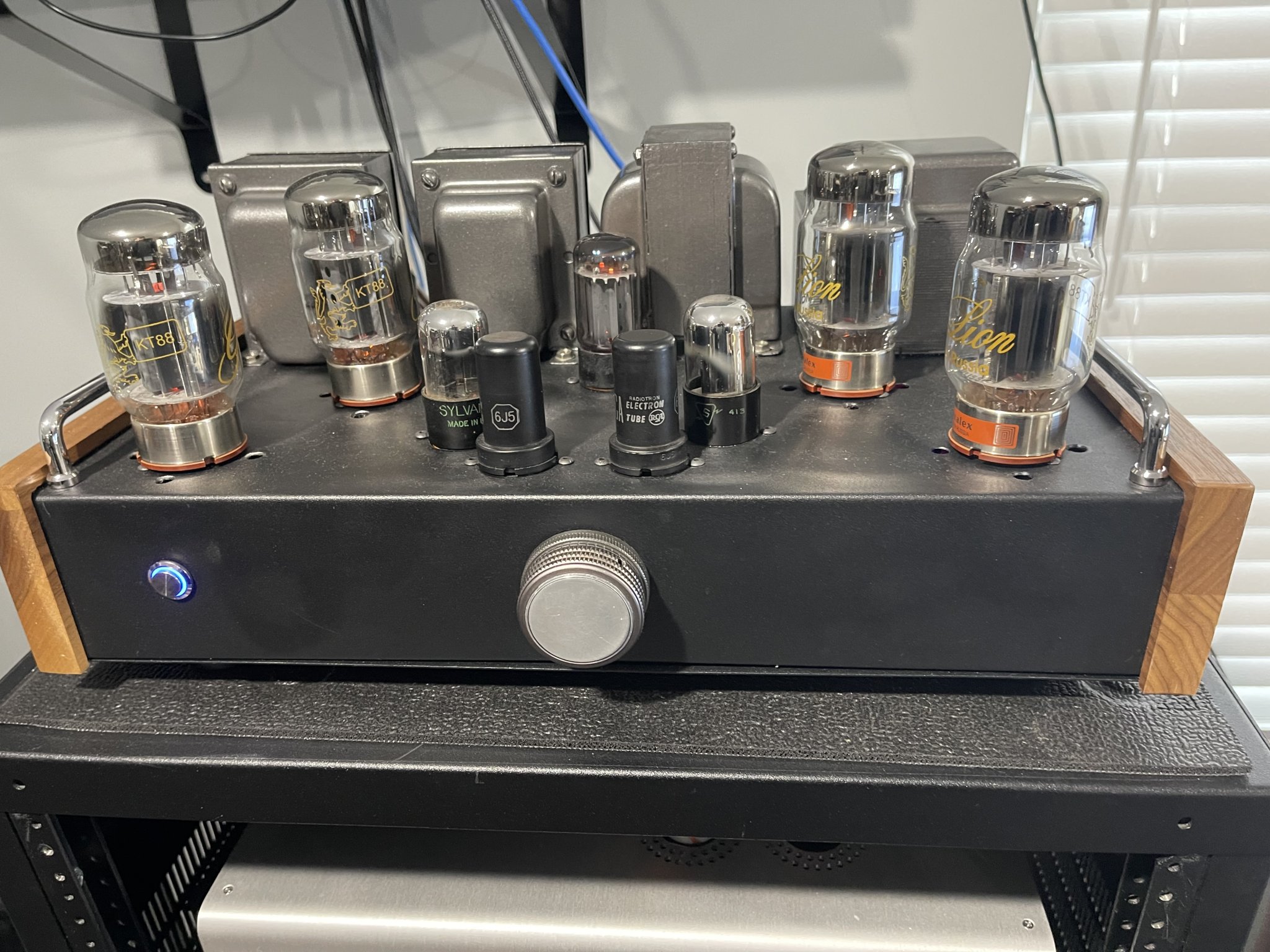

After lot of trial setups, finally I have narrowed my gear as budget 300B SET(Chinese) as final stage/Power AMP feeding with a Parasound Preamp (200Pre).
All I can say is there is a good difference in the tube sound compared my previous Class D Leema Elements. And I love this difference and I am keeping it.😬
So this SET has 2x 6SN7 as Front stage which I might consider rolling to the aforementioned tubes by @andyjevans i.e. CV6 or 7193 depending on the sound signature I want.
Current tubes are probably Chinese makes and finds it to be a little bit shrill sounding on some tracks. Main 300b tubes are psvanes.
I would like to get a sound signature with bit of warmth and a little added bass. I normally prefer warmer sound than shrill and sharp.
So out of the two tubes mentioned on this thread such as 7196 and CV6, which would be suitable for my target sound signature ?
~RJ

7193 is more sharp to my ears. CV6 is a smoother and nicer sound. A little better than a 6SN7, though a 6SN7 is a good choice as well. I like the angled anodes versions best, even over the older T anodes.

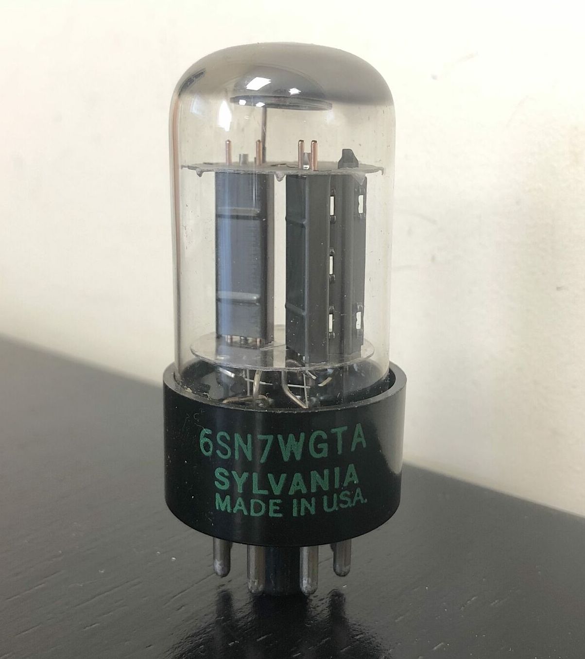

I always go for cylindrical plate over flat plate. The same reason why I prefer two 6J5s instead of one 6SN7. By default cylindrical plate is typically black plate instead of grey so I look for round and black... unless you have mesh plate, which is even better.I like to think it's the cylindrical plate as opposed to the flat in the 6SN7's.
I tried about 28 different 6SN7 and the above angled plates sounded better than all the rest. The flat ribbed plates were least interesting. The older T plates were good as in Bad Boys but I preferred the angled plates. I found it was all in the plate structure, not the make or year.

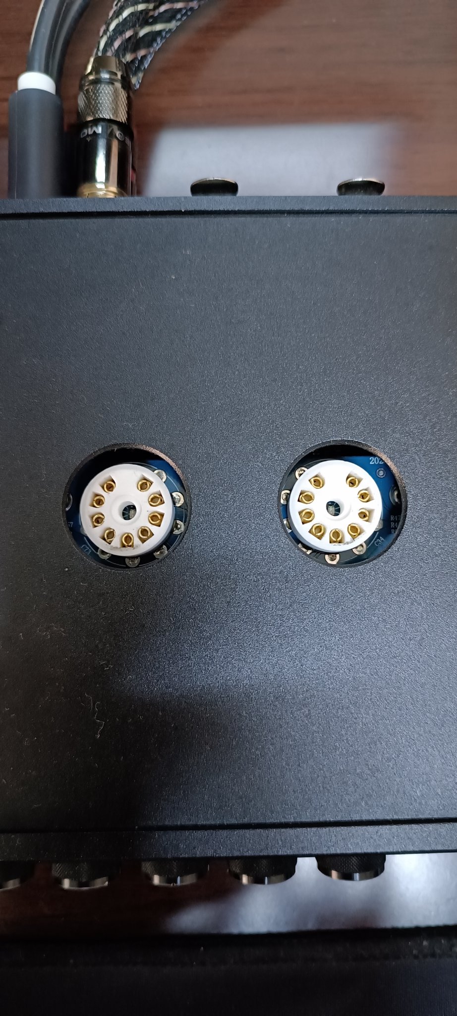

Just new in here..
I currently have a Douk Audio Dual-Tube Preamp which has a B9A base, where both the sockets are close to each other as shown in the Pic.
So my concerns are :-
1st of all is it even technically possible to roll the tubes to the 7193 ? If so then it should be 7193 tube for each channel i.e. a total of 2 tubes would be sufficient ? Or i will need dual for each channel so a quad setup ?
Regards.
~R
I also reached out to Douk audio to ask and waiting for response.
