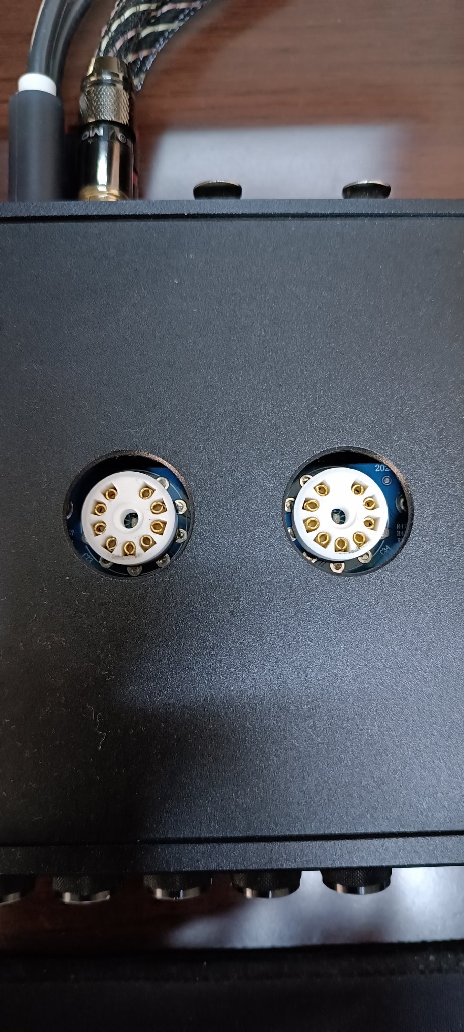

Hello there,
Just new in here..

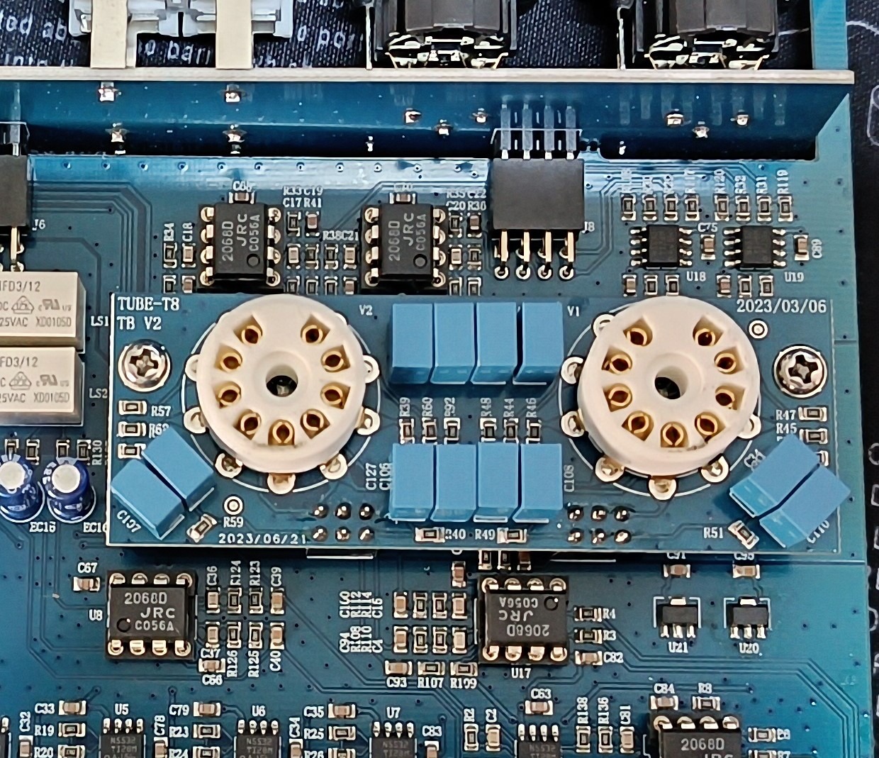

I currently have a Douk Audio Dual-Tube Preamp which has a B9A base, where both the sockets are close to each other as shown in the Pic.
So my concerns are :-
1st of all is it even technically possible to roll the tubes to the 7193 ? If so then it should be 7193 tube for each channel i.e. a total of 2 tubes would be sufficient ? Or i will need dual for each channel so a quad setup ?
Regards.
~R
I just received the same one. The T8 Pro. It states it can use 6sn7 tubes but it needs an adapter to use. Now my question is. Does it need the 12.6v or 6.3v version of the 6sn7 to 12au7 adapter?
I also reached out to Douk audio to ask and waiting for response.
