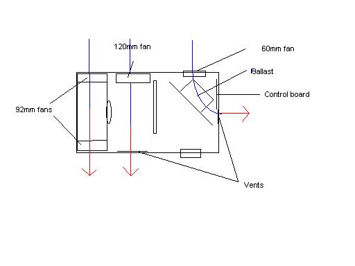

i will put some vents and the front 92mm ones with filters to stop light (might restrict air flow hmm)
and then i will try pass some hot air through the light box
I am not redoing the box unless i really need to
i plan to put the ballast behind the mirror somehow!!! lol

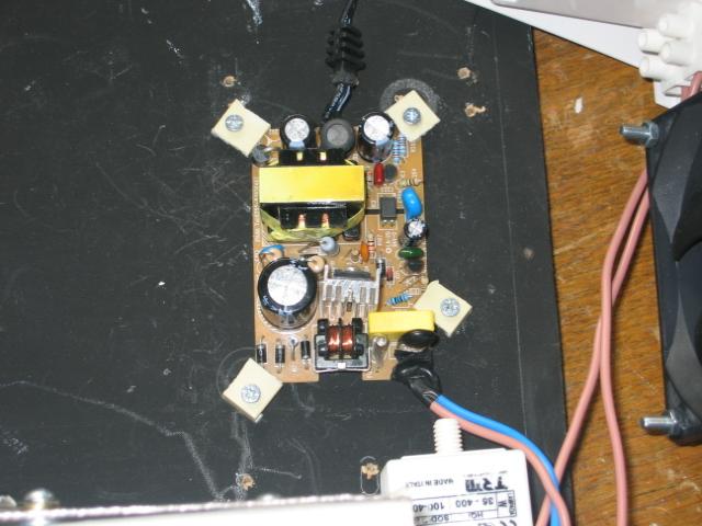

cut part of the ballast off 😱 and it now will fit behind the mirror leaving zero room for the lcd controler 😛
need to stop forgeting to add the the picture 😡
only problem is that the vga port and composite port which isent fitted yet might be in the way of the ballast leavinbg less room

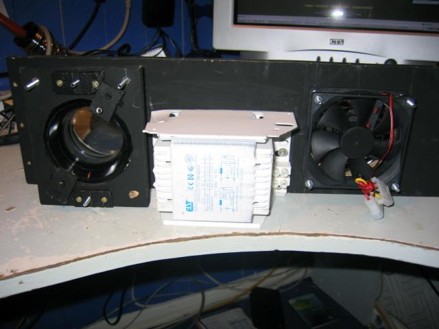

update on where i will be putting the ballast
it will go in the space inbetween the frensel and front so there will still be room for a 60mm fan on top of it and vents at the front 🙂
just needs a bit of a trim hehe
should be fine i hope 🙂

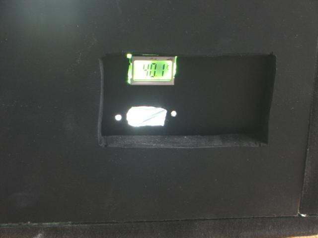

temp after 30 mins of it being on with 3 fans running
it hovers between 39-41 which i think is ok really but not sure
suppose for a 400w its not to bad at all 🙂
i still need to put a 60mm fan running over the bulb which might take the temperature down a bit even more and put a air director on the air out bit from the light box as the 2 fans pulling air in are pulling some hot air from the light box which isent a good thing really

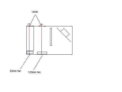

well after an hour test last night
i was hitting temps such as 44 🙁
which i wasent very happy with
so this morning well afternoon because i had a lie in lol i temp put a 120mm fan at the top of the case extracting air from the front of the light box
and the temp never went over 32oC in a 1hr test so i am happy with that i will be mounting the 120mm where the 92mm at the front is and mounting the 92mm at the top
if temps still get to high then i will change the top fan to a 120mm but it would have to be a low profile one
