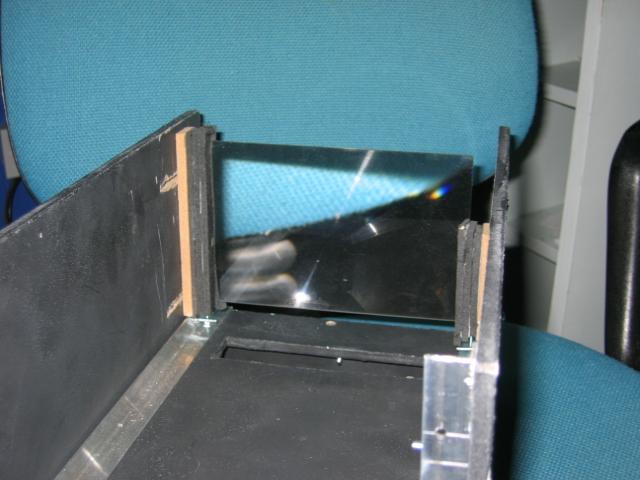

I am sure I have seen this design before just can't remember where .. 🙂 😉
Good job by the way looks good..

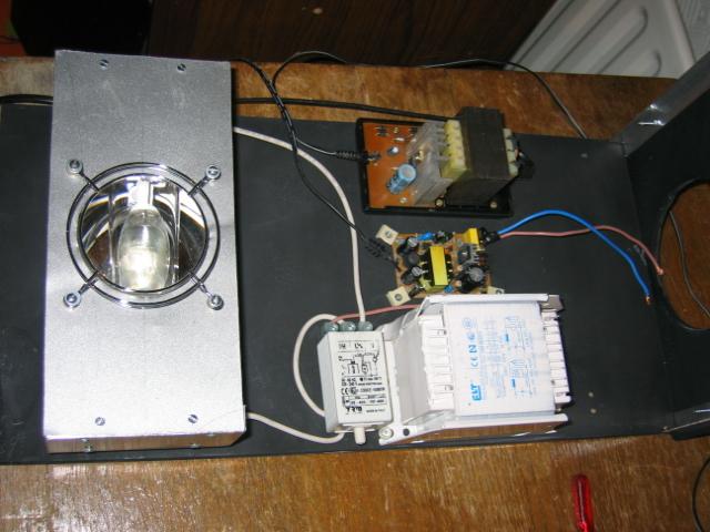

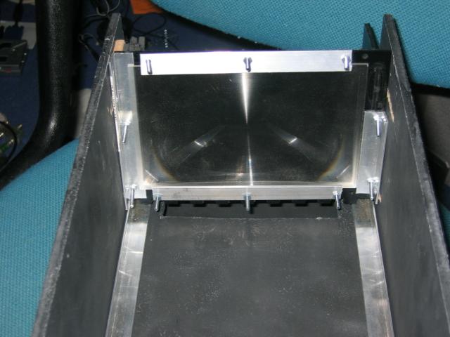

Just worried if a little bit of heat gets on the double sided tape it might just fall out hmm
I would be more worried about my fresnels and lcd if it gets that hot
This is cheap double sided tape 🙁 only stuff they had it is useless so i might have to use glue instead atleast that way it wont half stick

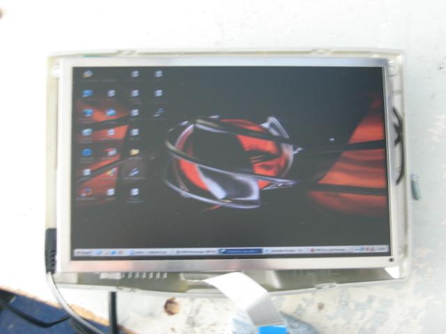

Just powered the projector up using my scrap lcd and it all seems pretty much lined up and displays a nice clear box lol
Might have some real results today
